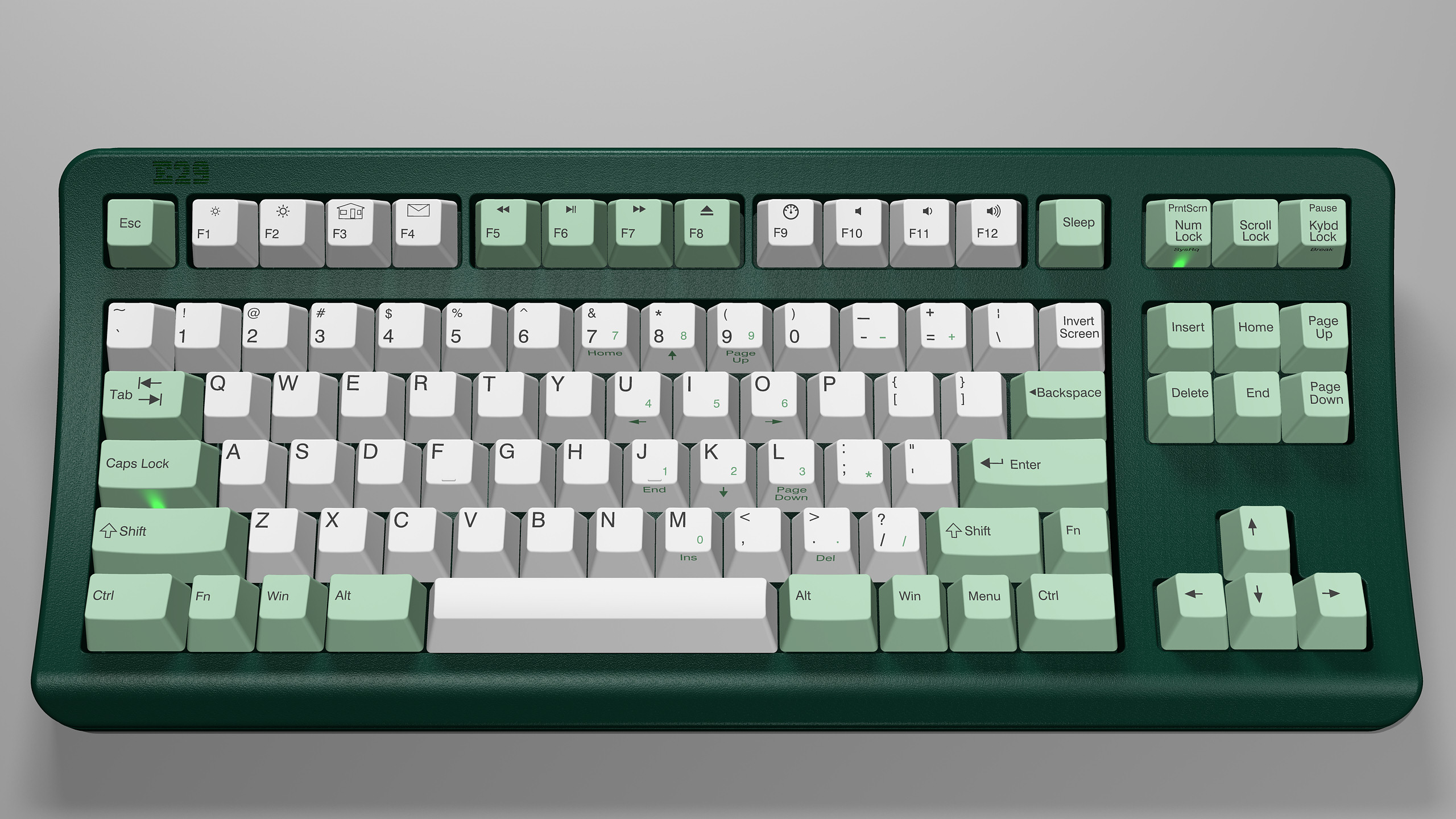

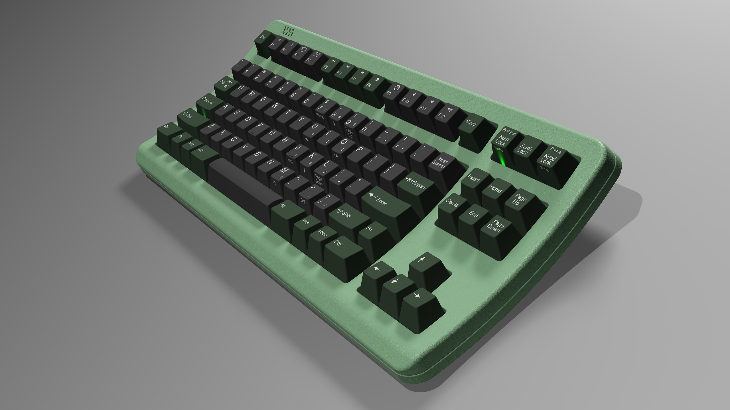

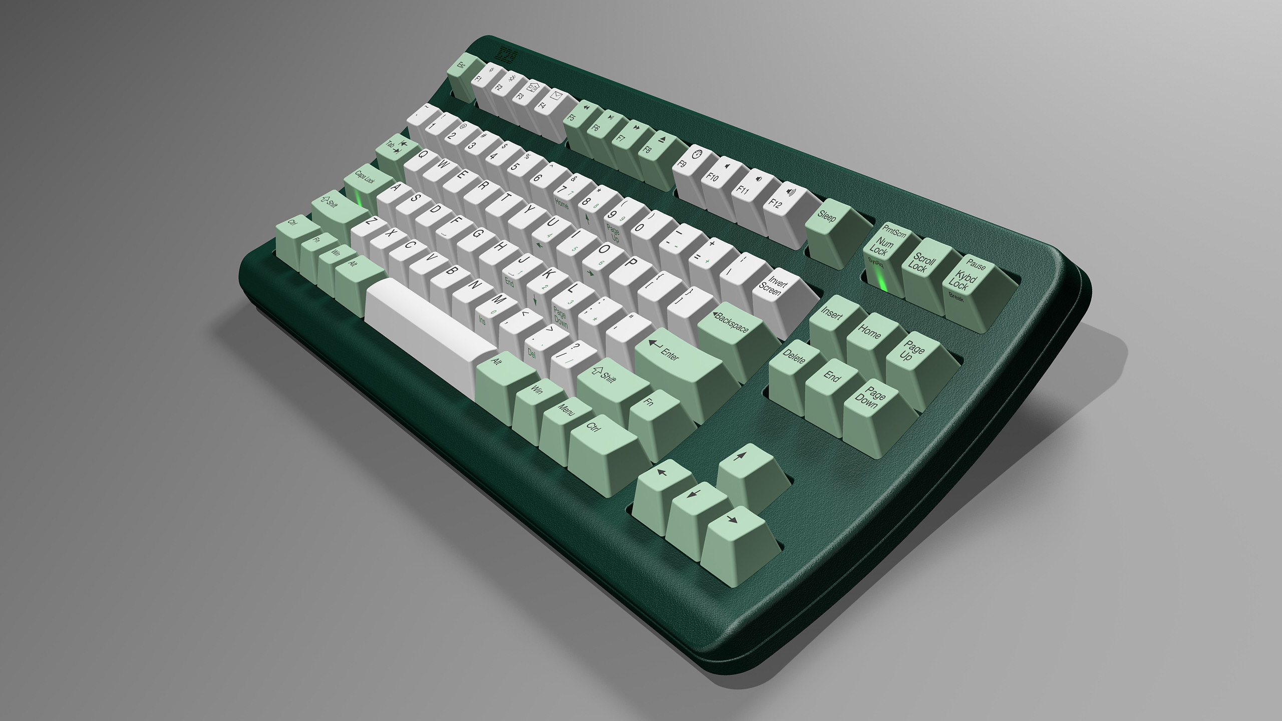

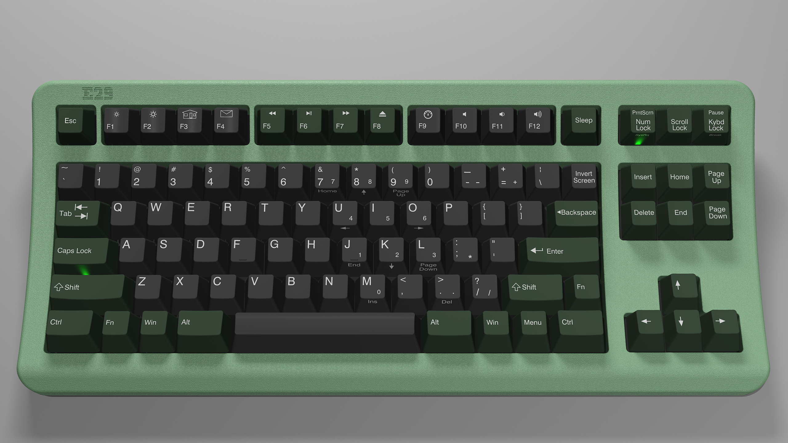

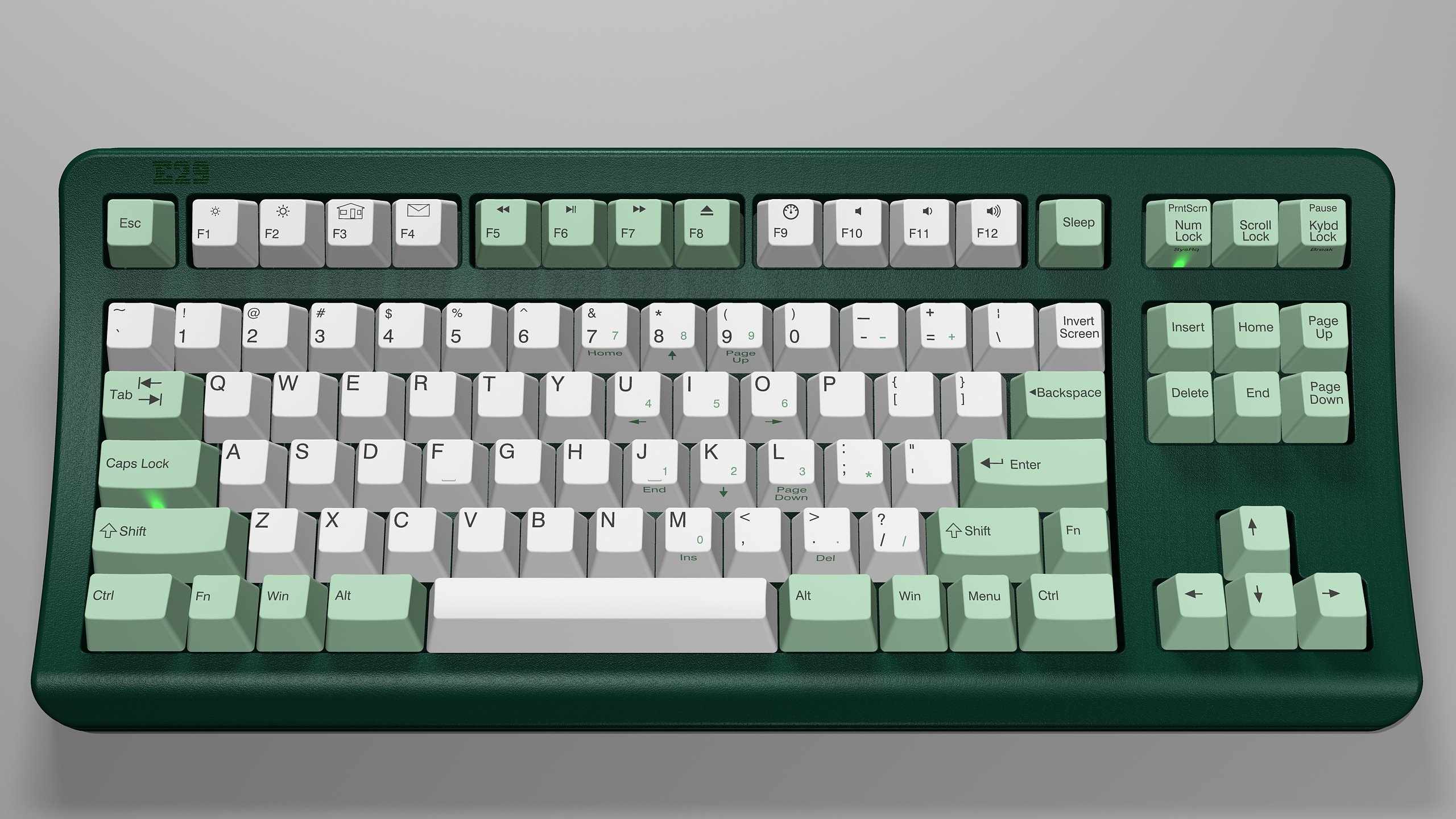

After answering M'er Forever's question, he was kind enough to put together some renders in color schemes of my choosing. I'm not much interested in anything smaller than the SSK, so instead of one scheme and two layouts, he did two schemes of one layout. Complete with custom engraved logo.
First, something closer to the previous renders, with just a *bit* more green to them:
I thought these looked great, and I may try to put this scheme together on one of my modded "SSK's".
But, as I learned to type on a selectric a long time ago, I have a certain affinity for that look (and how those keys felt, and buckling spring is closest to that). So I gave him a picture of an IBM Selectric typewriter and some personal preferences, and he put together this:
(What can I say, I like green)
I like the first scheme a lot, but I this second one is phenomenal, and likely never to be possible due to getting light legends on dark keys on a buckling spring keyboard is next to impossible as far as I know.
But if it ever is, I'm making this second keyboard.
Thanks M'er Forever for the time taken to put these together and answering my questions and nitpicks. These look great.
Posted: 07 Jan 2014, 20:13
by Muirium
Matching case colour with lights makes for a nice touch. I'd have gone for a reflective metal top with piano-like ebony mods and ivory alphas, which might have been a bear to render!
Posted: 07 Jan 2014, 20:23
by E TwentyNine
Muirium wrote:Matching case colour with lights makes for a nice touch. I'd have gone for a reflective metal top with piano-like ebony mods and ivory alphas, which might have been a bear to render!
M'er suggested a anodized aluminum case but I suspect that would take more than just changing colors in the model.
As far as ebony mods and ivory alphas, I have that already - see my avatar. I wanted to see something different: :D

Posted: 14 Jan 2014, 11:18
by Kurk
The separate NumLock key makes sense. Does it also activate the internal numpad? How would one switch between the numpad numerical functions and its cursor navigation functions?
How is that realized in original IBM SSKs? I think you have to press shift to momentarily switch to the cursor functionality...
What is the function of the Invert Screen button? I couldn't find it in the thread and, obviously, it is not obvious :?
