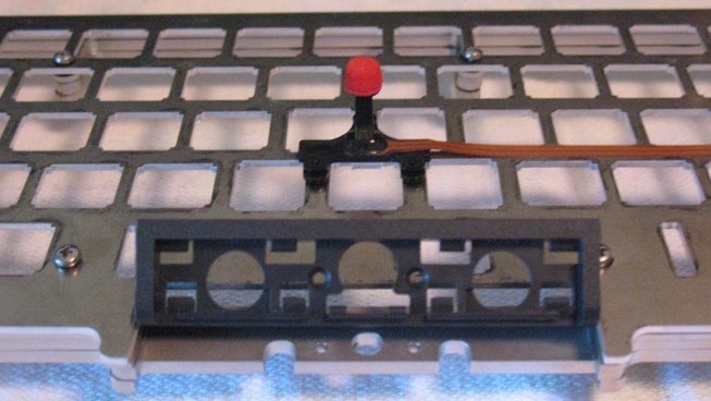

The shipment arrived today. Thanks, matt3o! Everything looks good and I am impressed at how some of the detailed features came out, like the small screw holes cut into 3mm aluminum. I think the keyboard will be difficult to assemble since the layers will require some coercion to line up and at the same time I'll be trying to get wires to lay in there right. But that challenge is a long way away. :-)
Here's a pic of the TrackPoint. I'm happy it lines up very well, since it was a difficult piece to measure with just a ruler. I'll have to shave off parts of the MX switches, but that was unavoidable without increasing the key spacing. I turned the G, H, B, V, and N switches 90 degrees to give a little more room for the screw holes and avoid having to cut out necessary parts of the switches.
So far I've found one measurement mistake I made, and it's a pretty big one. I think it is fixable though. The notches for the left and right mouse buttons are way off. They should be lined up with the large circles of the black plastic frame in the pic below. Don't know what I was thinking. :oops: I will have to cut or drill through 3mm aluminum to fix it.

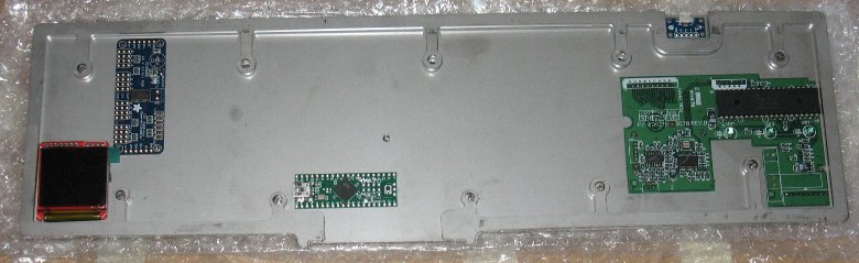

Here's a bonus picture of the bottom layer with the components laid out.
Overall I'm happy with the parts and excited to get started putting this thing together. Still waiting on some fasteners but everything else is ready to go. :)

mtl wrote:So far I've found one measurement mistake I made, and it's a pretty big one. I think it is fixable though. The notches for the left and right mouse buttons are way off. They should be lined up with the large circles of the black plastic frame in the pic below. Don't know what I was thinking. :oops: I will have to cut or drill through 3mm aluminum to fix it.
If the layer you need to drill is aluminum, despair not! You can drill it like butter. So I wouldn't consider that a big mistake at all!
Keep us posted with the progress of you great project.
PS: remember to insulate the base!
