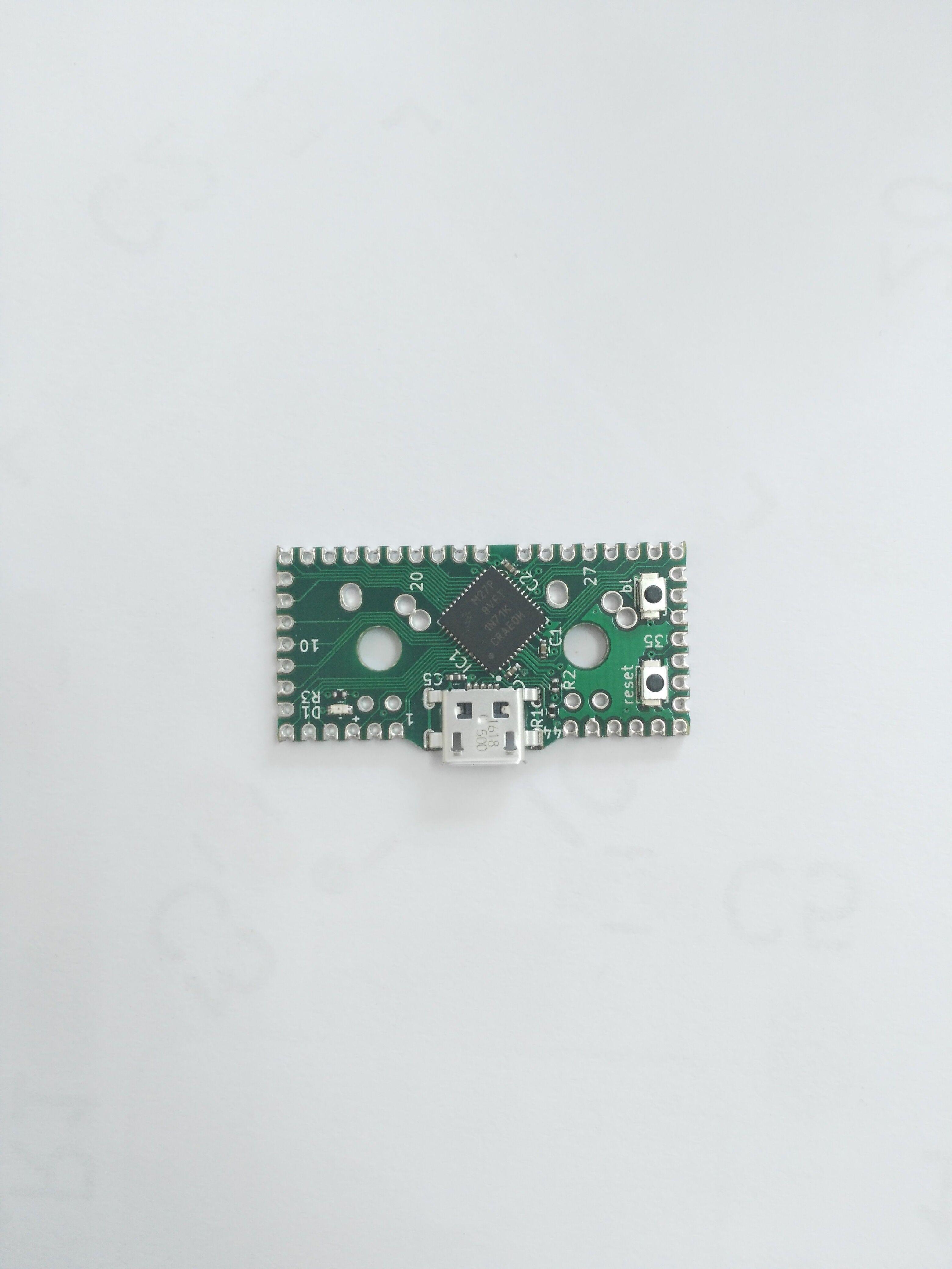

They are finally here. I had no time yet to play with it but I get a weird output by dmesg
[34422.565667] usb 1-2: new full-speed USB device number 14 using xhci_hcd
[34422.700298] hid-generic 0003:15A2:0073.000E: hiddev0,hidraw7: USB HID v1.00 Device [Freescale Semiconductor Inc. Kinetis Bootloader] on usb-0000:00:14.0-2/input0
[34424.411211] usb 1-2: USB disconnect, device number 14
- Location: Finland
- Main keyboard: ergoDox
- Main mouse: zowie ec2
- Favorite switch: brown
I think that is already a pretty good sign that the board itself at least functions, on some level, as it stays active for a pretty long time considering that it manages to do a handshake with the computer. Have you tried pressing the bl and reset buttons simultaneously when the board is plugged in? First push bl, then reset, then raise reset and last raise bl.

I tried to reset but it just disconnects after few moments, but I have a feeling this is normal for a firmware free board. we have an LED, right? On which pin is it again? I can try to burn a very simple blinking program.

still fighting with the development environment
What do you guys use?
- pandp
Teensy Loader, Command Line
https://www.pjrc.com/teensy/loader_cli.html
or
https://www.pjrc.com/teensy/loader.html
or
- Location: Finland
This is not a teensypandp wrote: Teensy Loader, Command Line
or
I have not set up a compilation environment for this board yet, but I prefer a plain arm-gcc setup.
You will probably have to follow one tutorial to set up the compilation environment & compile some example program and another one to use the rom bootloader for flashing. You should take extra care when setting the 'flash configuration area', which is part of the program binary you upload to flash. If the 'flash configuration area' is not set properly, it is possible to brick the chip so that you need a swd debugger to un-brick it.
