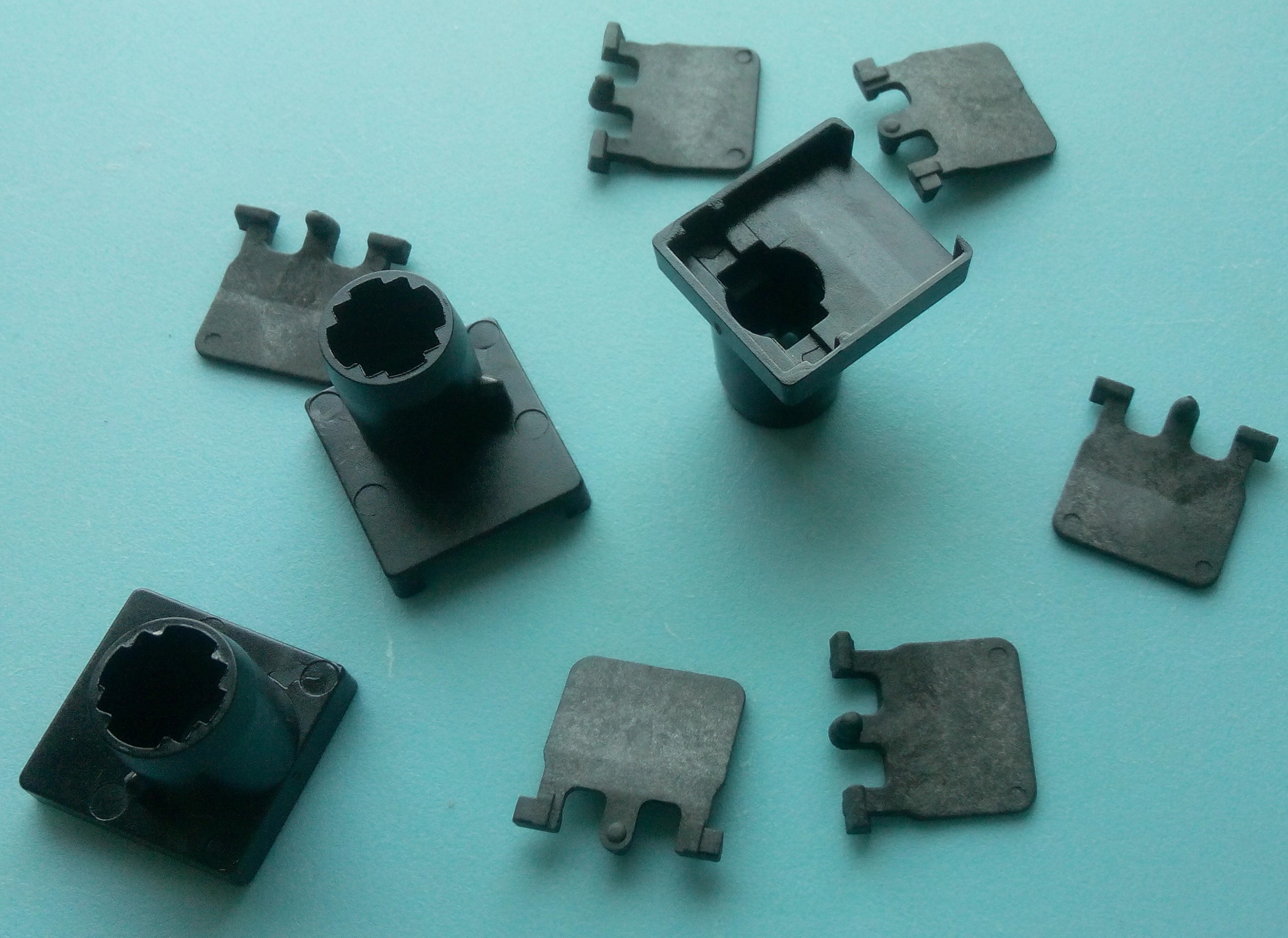

The barrel and flipper molds are finished - here are the very first brand new injection molded production samples of barrels and flippers from the new molds! Once the cases are made, the F62 and F77 prototypes will be just about finished!
first new barrels and flippers.jpg (1022.92 KiB) Viewed 6626 times

Looking nice! Did you get any testing done? Does the material work ok?
