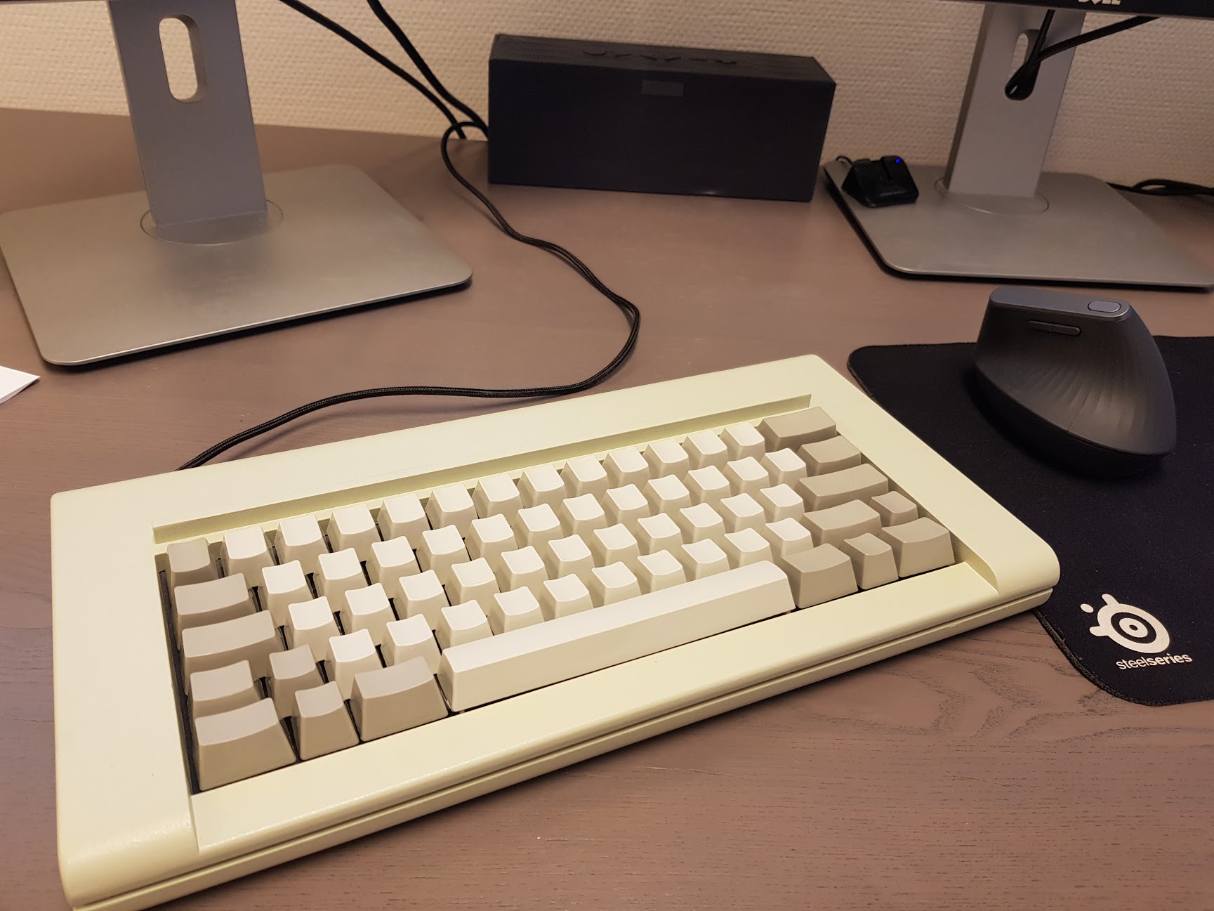

by Twst
Package arrived! Big thank's to Joe!
Shipping was suprisingly fast, even with a delay with the postal service and considering the times we are in - it took only 9 days shipping all the way to the north of Norway.
Gave the F62 a split left shift and it has already been put to work at the office.
Keys are supersmoooth and both the feel and sound is perfect. Even better than my XT and AT.
The F62 in paticular has such great heft and is easily the best keyboard I have owned.
Have them both flashed with pandrew's firmware fix, and have no issues at all. The F62 is running with threshold at 131 at work on my Dell, but I had it at 129 on the Thinkpad at home. So it defently behaves somewhat differently across computers.

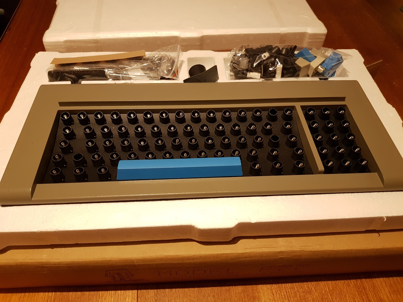

I am happy to report back after getting a new-in-box Model F XT (chassis) from Redmaus that the key feel of modern Model F is very similar to Model F XT. If I have to find a difference, I would say the XT to be a bit stiffer, not to mention the monster spacebar. If I am going to get a third Model F, I probably would pick the F62 over XT for the more modern and economic layout. Modern Model F also has a higher quality case.
Redmaus has been super helpful in helping me navigating the whole thing. I would recommend people to buy from red market as well.
