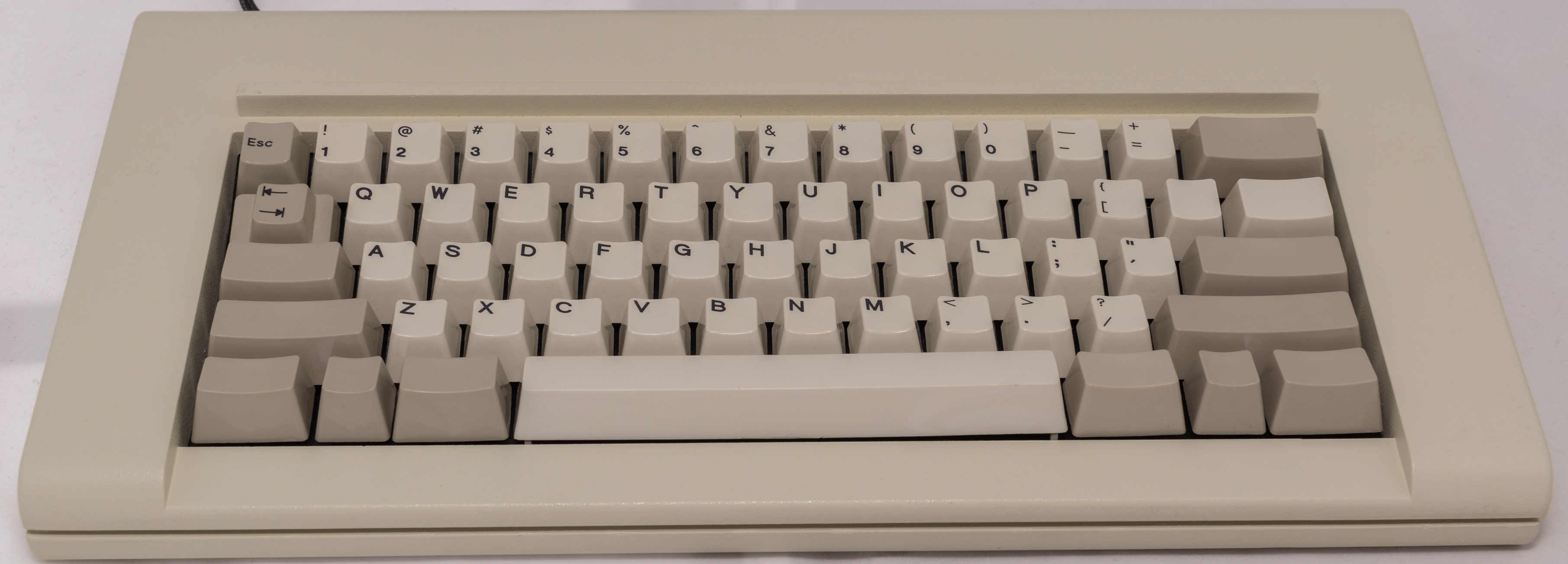

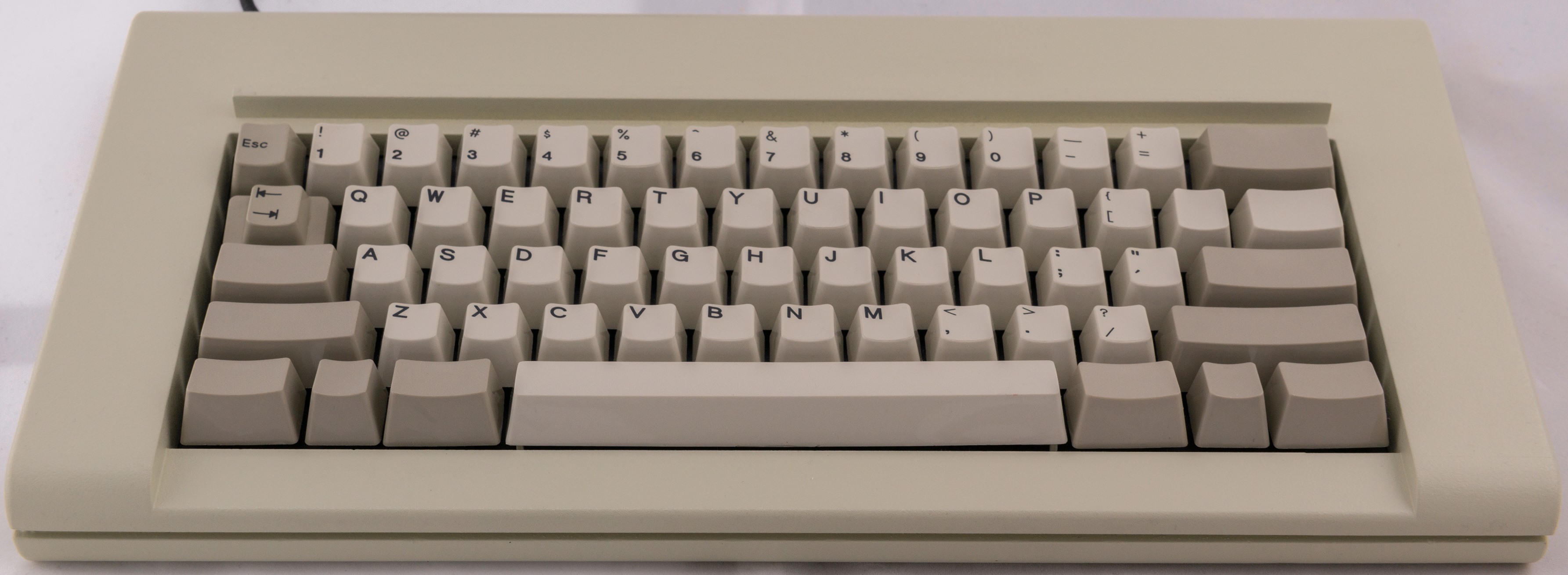

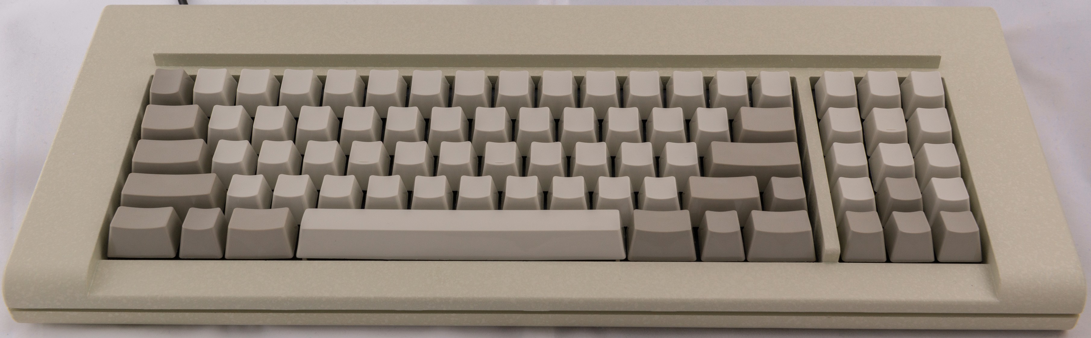

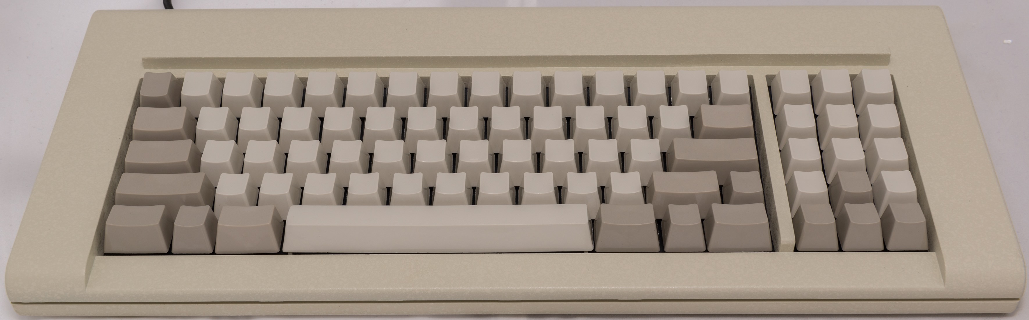

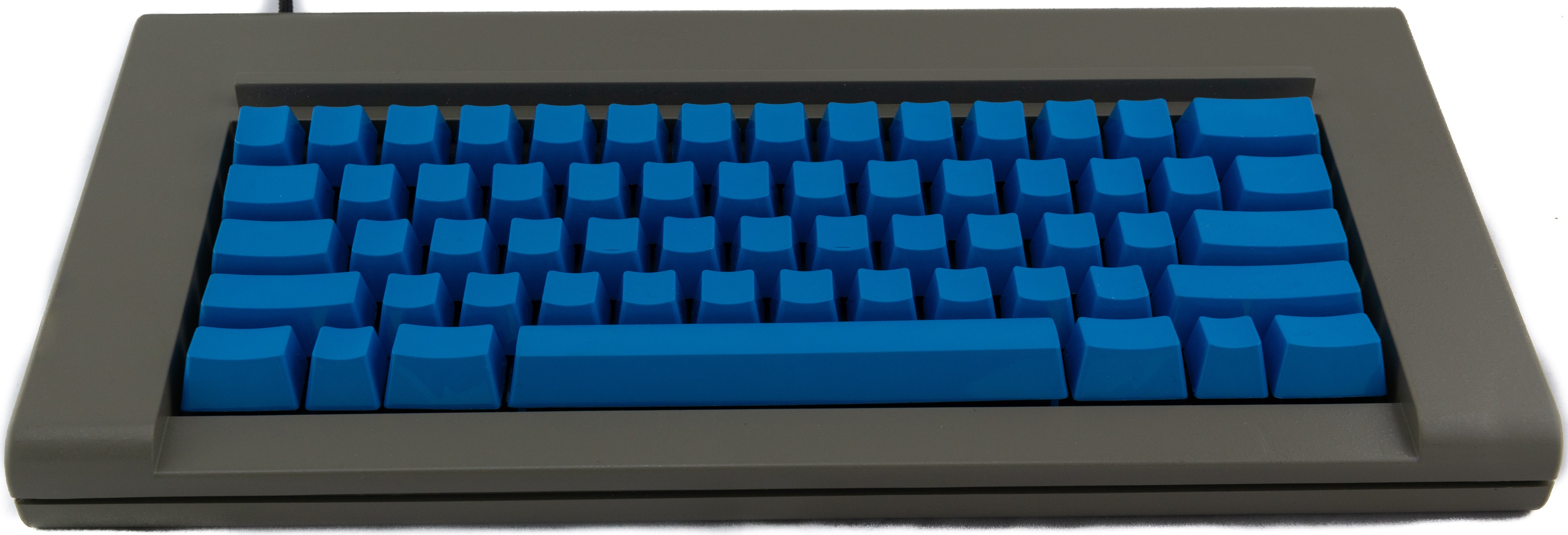

And here are some unique variations of keyboards that have gone out in recent weeks:
The first keyboard (first two photos below) has original IBM XT keys installed, with blank keys for the non-XT keys.

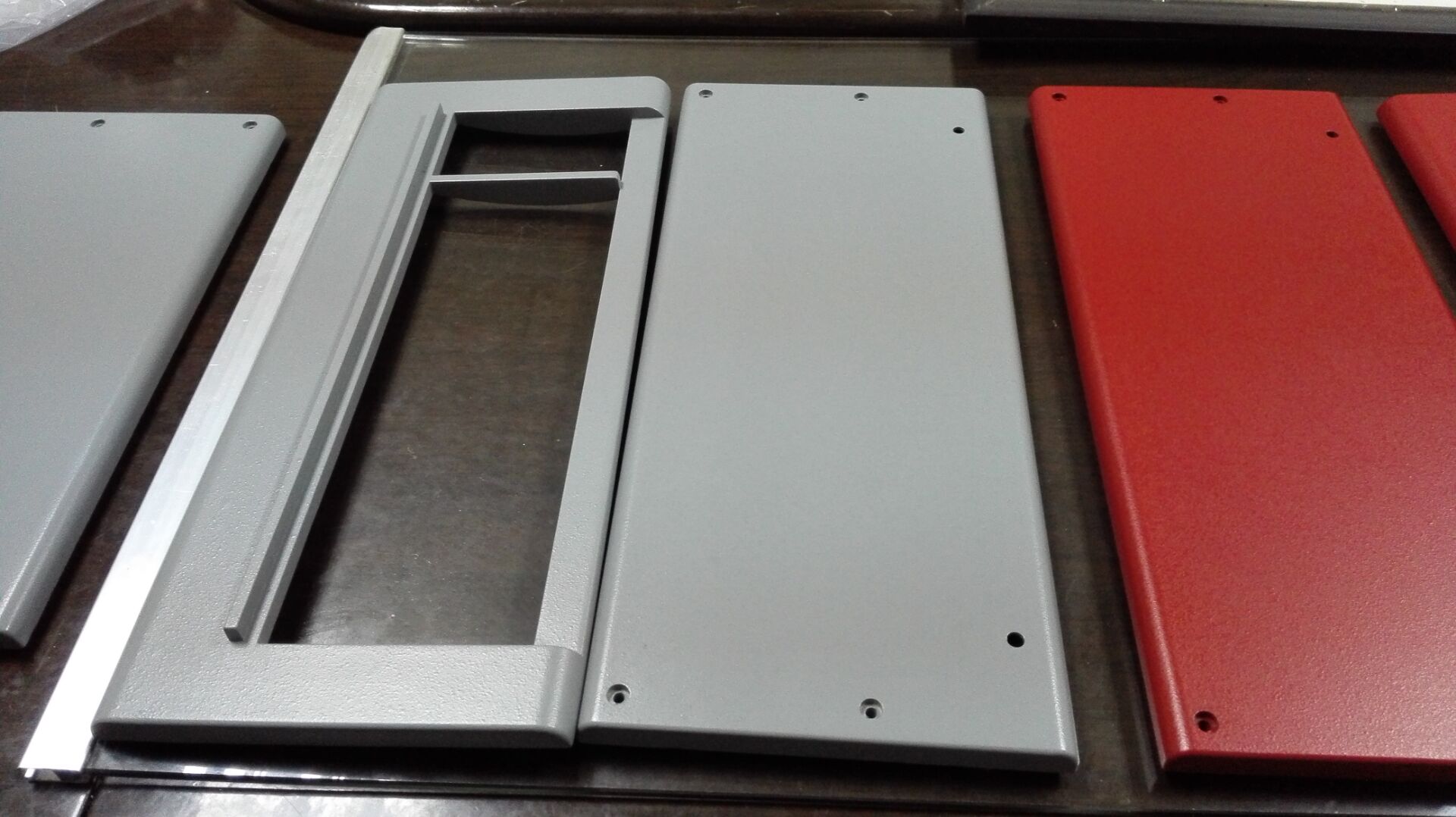

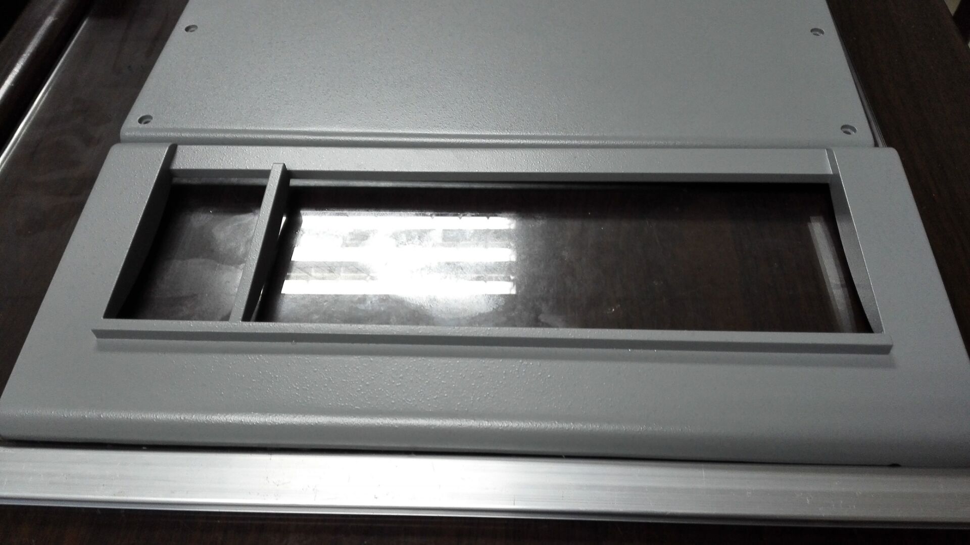

Not yet on a shipped keyboard - would anyone like to be the first silver gray order to ship (split right shift, unprinted keys or no keys only)? Feel free to PM me.
Below are some earlier photos of the silver gray cases:

Ellipse wrote: 06 Mar 2020, 16:21 Not yet on a shipped keyboard - would anyone like to be the first silver gray order to ship (split right shift, unprinted keys or no keys only)? Feel free to PM me.
Looks great, I'll love having it on my desk. Also red was an option? Super cool

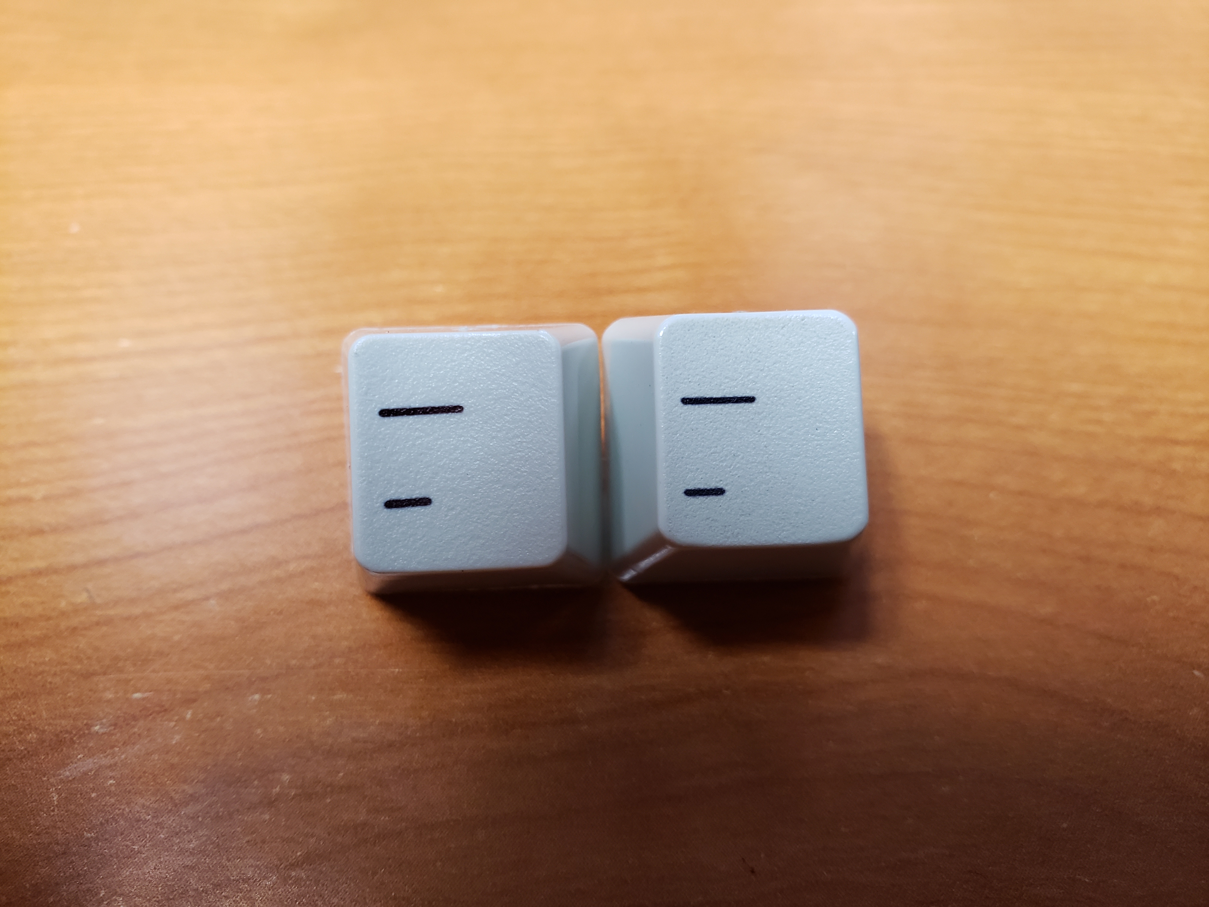

Dye sublimation update:
I have successfully completed the dye sublimation setup! Below is a photo of the first sublimated key with the new setup. These are among the best results in any tests so far.
Upon close evaluation with my Meiji EMT stereo microscope, the sublimation is close to that of my favorite F122 from 1984. But I do not think we are yet at the point to do the comparison "can you tell the difference between which is new and which is the original?" as with the keyboard case finishes a while back (I think some people can tell the difference below). So the below photo is not indicative of the production legends.
As a recap, the decision to dye sublimate the keys myself was because of the lower quality and high unit cost of the sublimated samples I received as well as the industry professionals telling me they no longer have the equipment they used for key sublimation (in some cases) or are unwilling to sublimate non MX keys (in other cases). The goal was XT quality sublimation for one piece Model F keys. I failed to achieve consistent sublimation results over the past 10 months of testing and had been circling back and forth with a number of sublimation industry professionals, engineers, and one of the original Model F keyboard production supervisory engineers who has been a significant help to the project.
I've had to redesign and switch out much of the setup. I built some of it myself and had some of it built in the US while the CNC milled jigs were done in China. In the end I had to apply advice from different industries and online forums discussing a few industrial processes to get it to work. Even the smallest things caused trouble (one example: I thought one of the sensors was bad but it just didn't like switching power supplies so I had to get a linear regulated PS). My initial control panel setup involved analog devices only but that wasn't sufficient, so I had to design and build a digital control panel.
Hopefully I am not announcing success too soon (!); the next steps are additional sublimation tests to evaluate consistency of results, fine tuning the sublimation parameters, and then tests of a full key set and front printed keys. If all goes well I can order the sublimation transfer sheets and begin mass sublimation. Thanks again to everyone for being patient with this final part of the project.

tentator
08 Mar 2020, 00:23
left original, right ellipse
(what if I win? :))
But result is astonishing close!!

I'm guessing left Ellipse, right Original, I'm taking the stuff on the right cap as being small bits of dust accumulated over decades.

ZedTheMan wrote: 08 Mar 2020, 00:58 I'm guessing left Ellipse, right Original, I'm taking the stuff on the right cap as being small bits of dust accumulated over decades.
Ya I'm going with this too :D

tentator wrote: 08 Mar 2020, 00:23 left original, right ellipse
(what if I win? :))
I agree

Right Original, would be my vote.
08 Mar 2020, 02:40
left Ellipse, right original

My bet is that the left key is the original - the legends are a little thicker and less fuzzy around the edges.
That's based on me zooming in on the picture, I would have difficulty telling the difference if I saw these caps on two keyboards side by side.
If I am wrong, and the left is the new keycap, then I would be very pleasantly surprised :D

Nice job Ellipse. My vote is left Ellipse, right original.

Left Ellipse, Right Original.
I think the left side looks a little tilted, but I'm sure this will be fixed in the final product.
