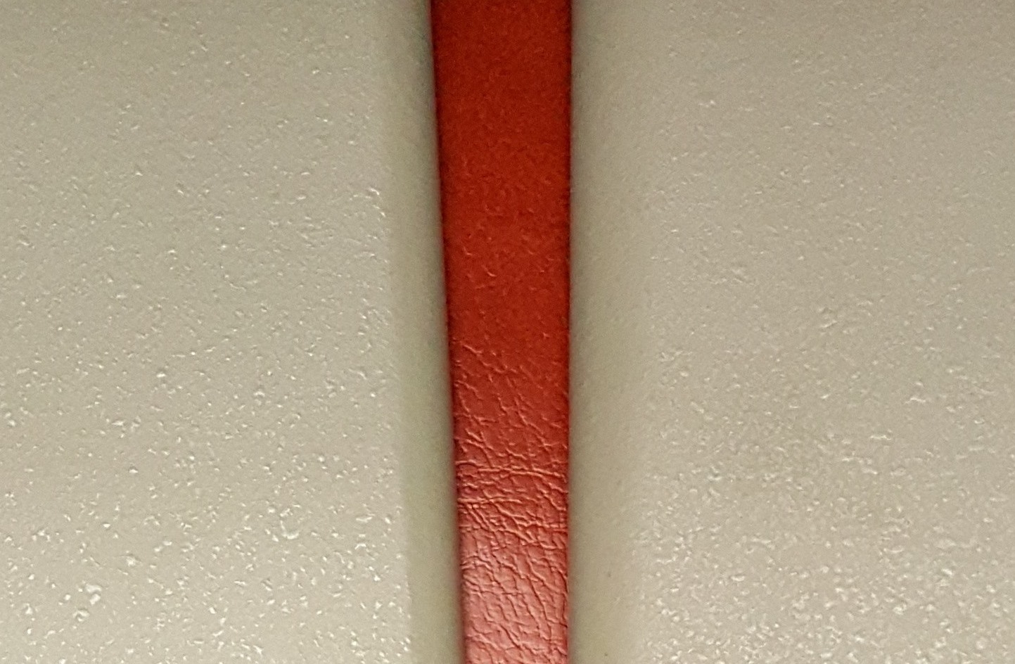

Thanks TheLagMaker for your detailed review and notes on the xwhatsit Linux configuration.

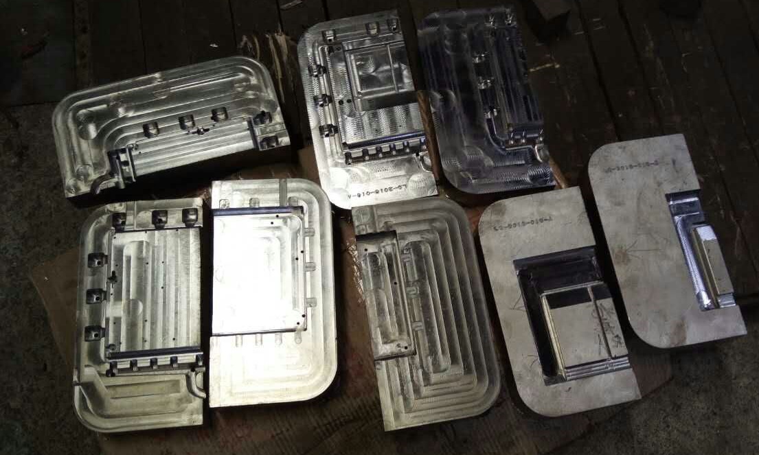

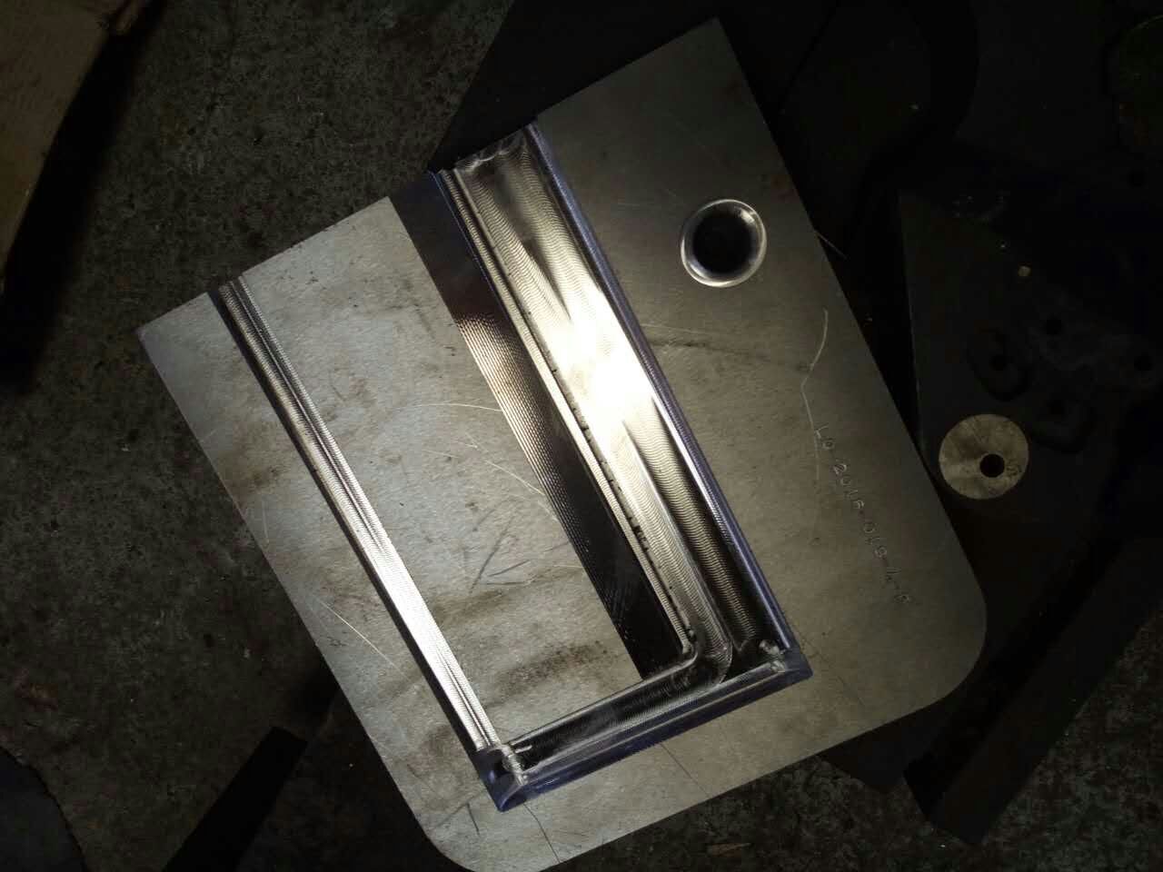

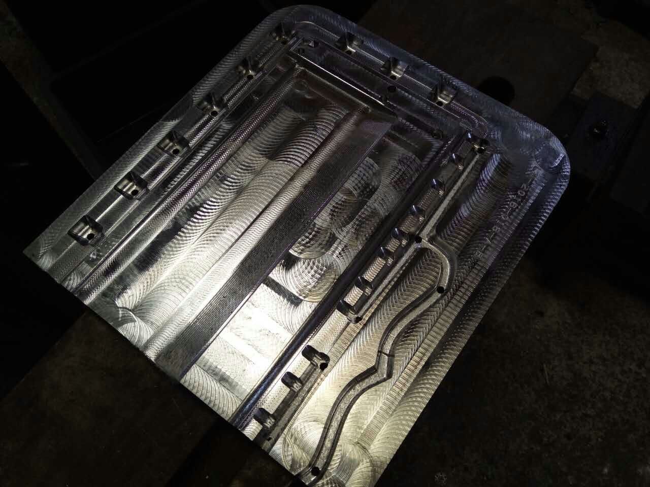

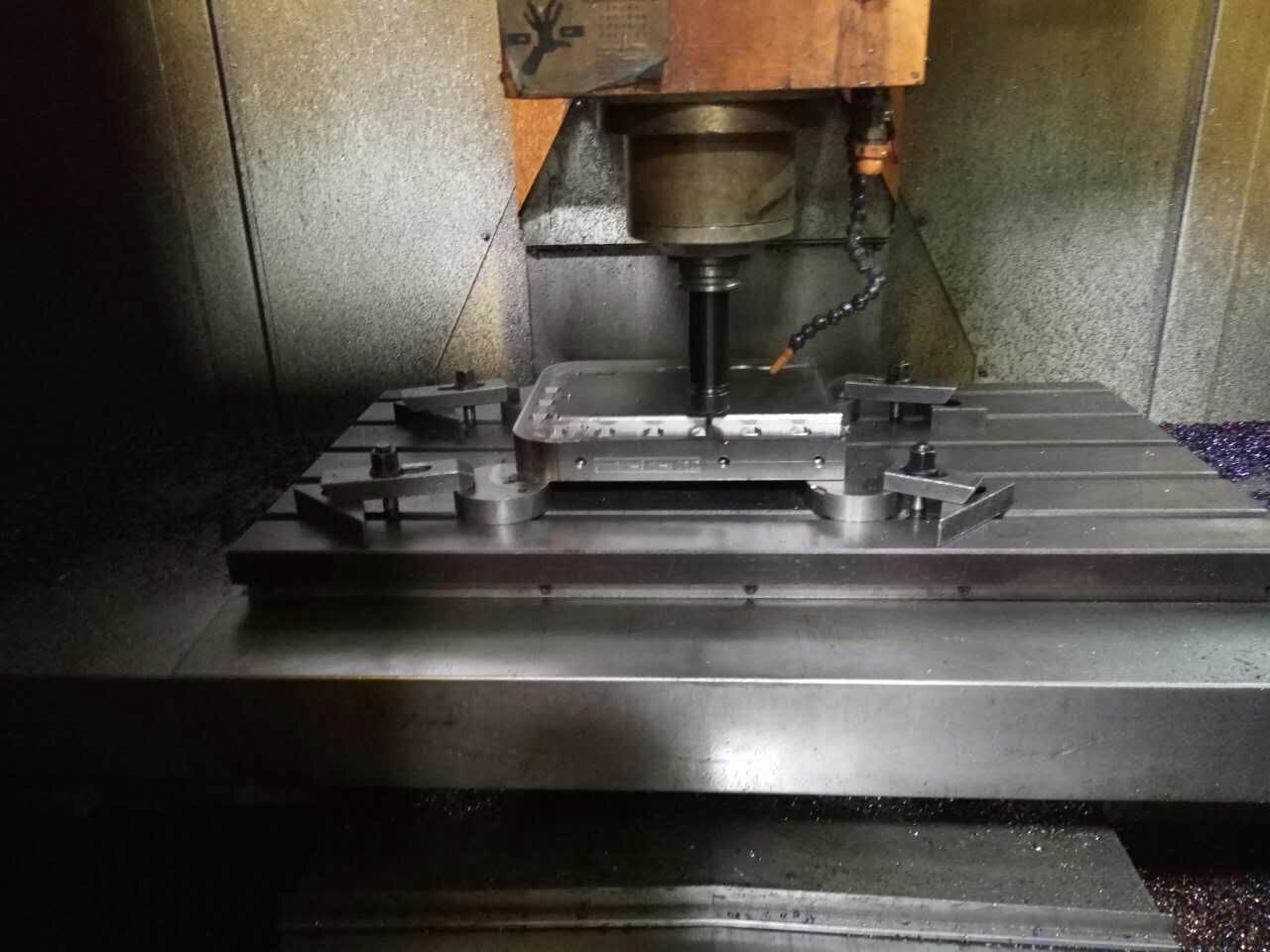

I have asked the factory to look into the issue of the lines on some of the cases.
webwit is correct that the molds were designed so that the F62 and F77 molds could be shared. The molds used in this project cost more than a luxury car (!) so we have to save on costs where possible.
I hope they can remove this line for the final round in the secondary/finishing operations before powdercoating.
Below I am re-posting some photos from 2016 of the creation of the die cast case molds.
Regarding the beige color, having examined and restored dozens of original Model F keyboards over the years I have found that different runs of Model F keyboards have slightly different beige colors (including the early powdercoated plastic F122 cases). The beige color I approved is close to one of my original F77 keyboards (as shown in the home page of the project web site with the caption "can you guess which one is the original and which is the reproduction?").
I would say that the off-white/beige finish is my favorite of all the Model F color options!

Ellipse wrote: 11 Feb 2020, 22:54`webwit is correct that the molds were designed so that the F62 and F77 molds could be shared. The molds used in this project cost more than a luxury car (!) so we have to save on costs where possible.
So considering the case first of all I'm impressed how close this is to the original. Colors are spot on. Structure of paint is very close, only slightly different but not in a bad way. Btw your F62 is even heavier than the original! All in all this is more than I ever wished for. Considering the mold line.. hmm, the inside doesn't matter, and the outside artifact is only on a small area and visible only in certain light/angle... but I guess the fix would be the paint? If only the paint or first layer would fill the line, it would be invisible.

Those are insert lines from the zinc casting process, and if the insert lines are protruding out of the surface (positive emboss) can be removed with additional buffing/grinding process but needs to be done carefully so as to not create more imperfections (irregular buffing marks) that will show up after powder coating. Another way is to post-process it using a CNC machine, that will be more precise but at added cost.
It isn't surprising to know that they are sharing inserts in order to save on the mold. Molds do really cost an astronomical amount of money. I know because I work in the industry (but aluminum instead).
What about the 2nd ("the early bird"?) round - the cases are already in production and will not be fixed?

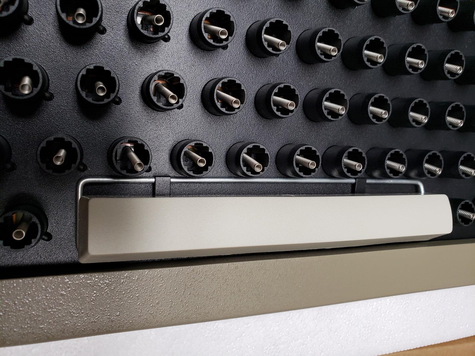

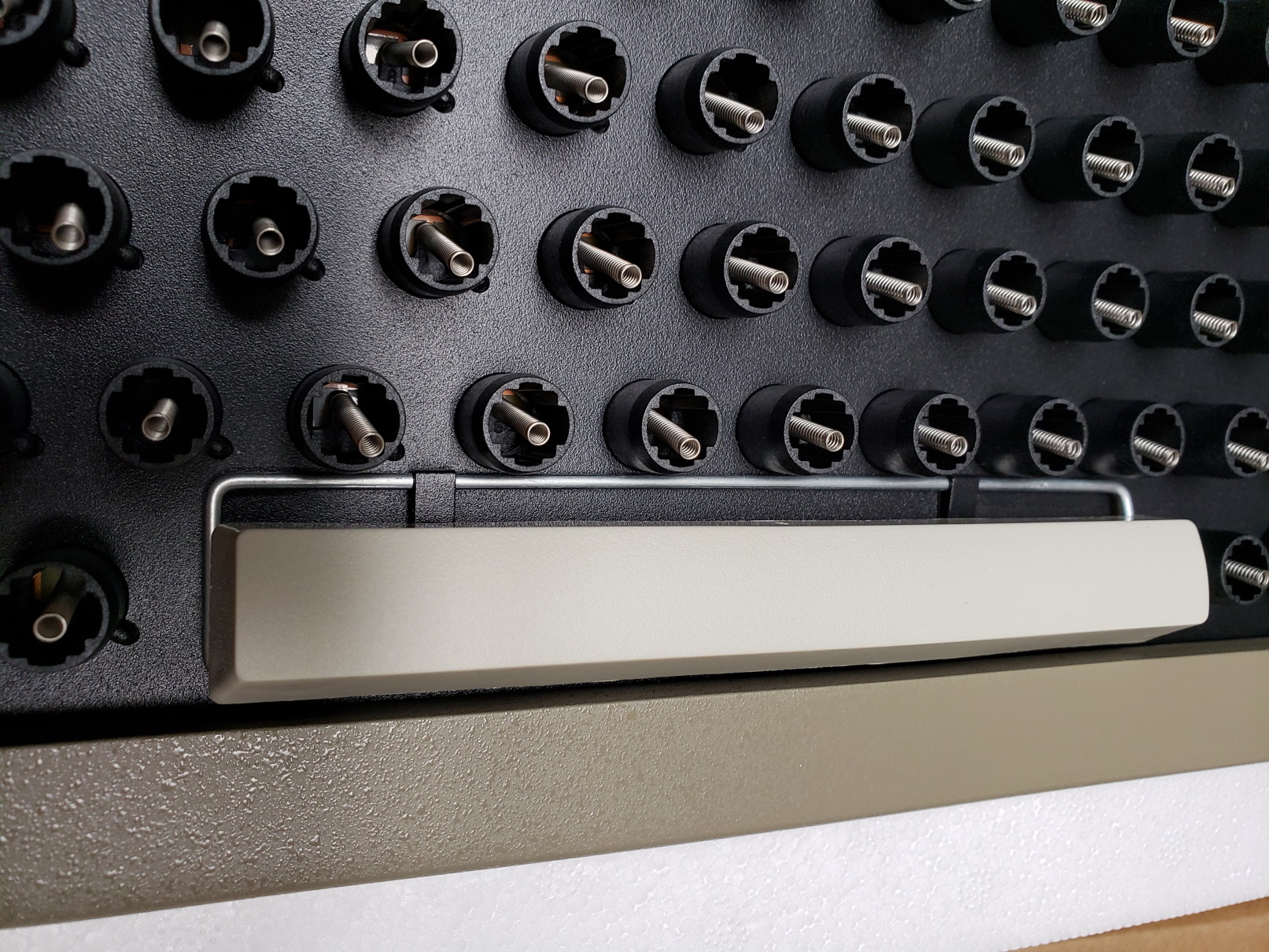

Finally got a proper spacebar for my F77, after a month of using a beat up old M bar with a missing wire.
But annoyed to discover that the period key makes contact with the stab wire and makes the spacebar vibrate. Luckily it doesn't trigger the spacebar but I wonder if this is happening to anyone else.
Re: F62+F77 orders now open! New Kishsaver+Industrial Model F Keyboards
Posted: 27 Feb 2020, 04:56
by dotcom
The spacebar vibration was happening with my new F77 as well. I was able to resolve it by applying a single layer of electrical tape around the spacebar stabilizer in the areas where it rests against the tabs.

Mattr did you install the space bar inside the space bar tabs? Or is it resting on top? Sometimes by mistake the space bar does not "catch" inside one or both of the metal tabs and it is difficult to see after the keys have been installed.
The space bar wire should not be in contact with any key. I have found that sometimes the wire needs small bending adjustments for some keyboards to optimize performance - this can change the ease and sound of pressing the space bar. Too much change can cause it to become stuck though.

Ellipse wrote: 27 Feb 2020, 06:17 Mattr did you install the space bar inside the space bar tabs? Or is it resting on top? Sometimes by mistake the space bar does not "catch" inside one or both of the metal tabs and it is difficult to see after the keys have been installed.
Yeah I did, fully seated in the tabs but that key hit ever so slightly. I actually solved it by stuffing some notebook paper into the tabs which gave the key clearance, while also getting rid of the spacebar rattle. Now it feels great, even though one could call it a bodge fix. It's probably just a slight issue with tolerances with my unit.

Thanks jasburbak for the detailed review. I am glad that these keyboards will be used as daily drivers all around the world!
I have added visual representations of the layouts and function layer to each of the four product pages to help everyone choose.
And here's my note on the beige color from a few weeks ago: viewtopic.php?p=459699#p459699
In addition to the methods described in the "QC secrets" for fixing buzzing springs, I have found that sometimes just stretching the spring and then reinstalling the key reduces the buzz - the buzz may have to do with a length of spring slightly too short for a particular key, as well as a spring end that should be a bit closer to the flipper nub.
