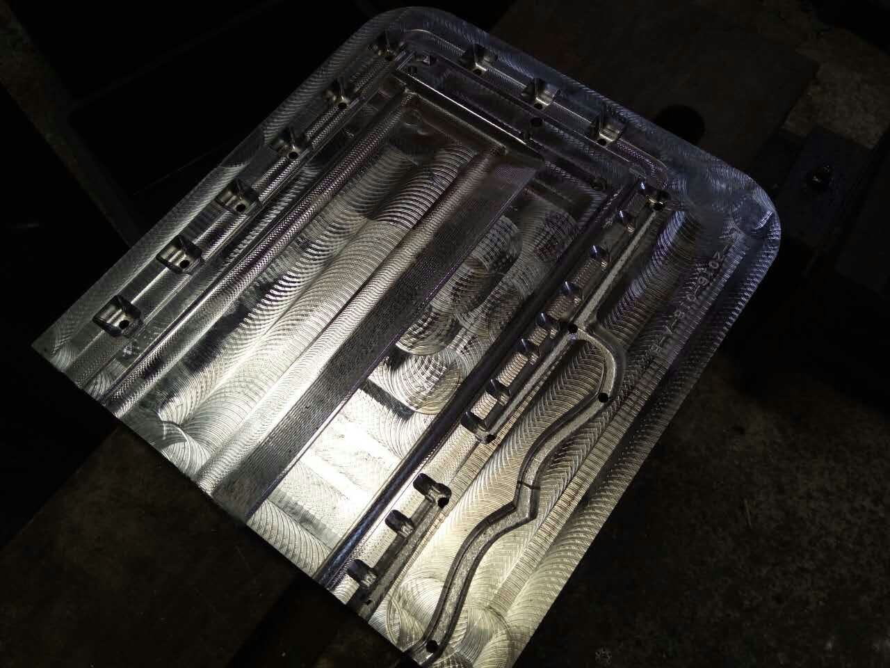

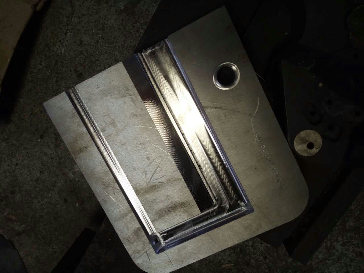

Thanks TheLagMaker for your detailed review and notes on the xwhatsit Linux configuration.
I have asked the factory to look into the issue of the lines on some of the cases.
webwit is correct that the molds were designed so that the F62 and F77 molds could be shared. The molds used in this project cost more than a luxury car (!) so we have to save on costs where possible.
I hope they can remove this line for the final round in the secondary/finishing operations before powdercoating.

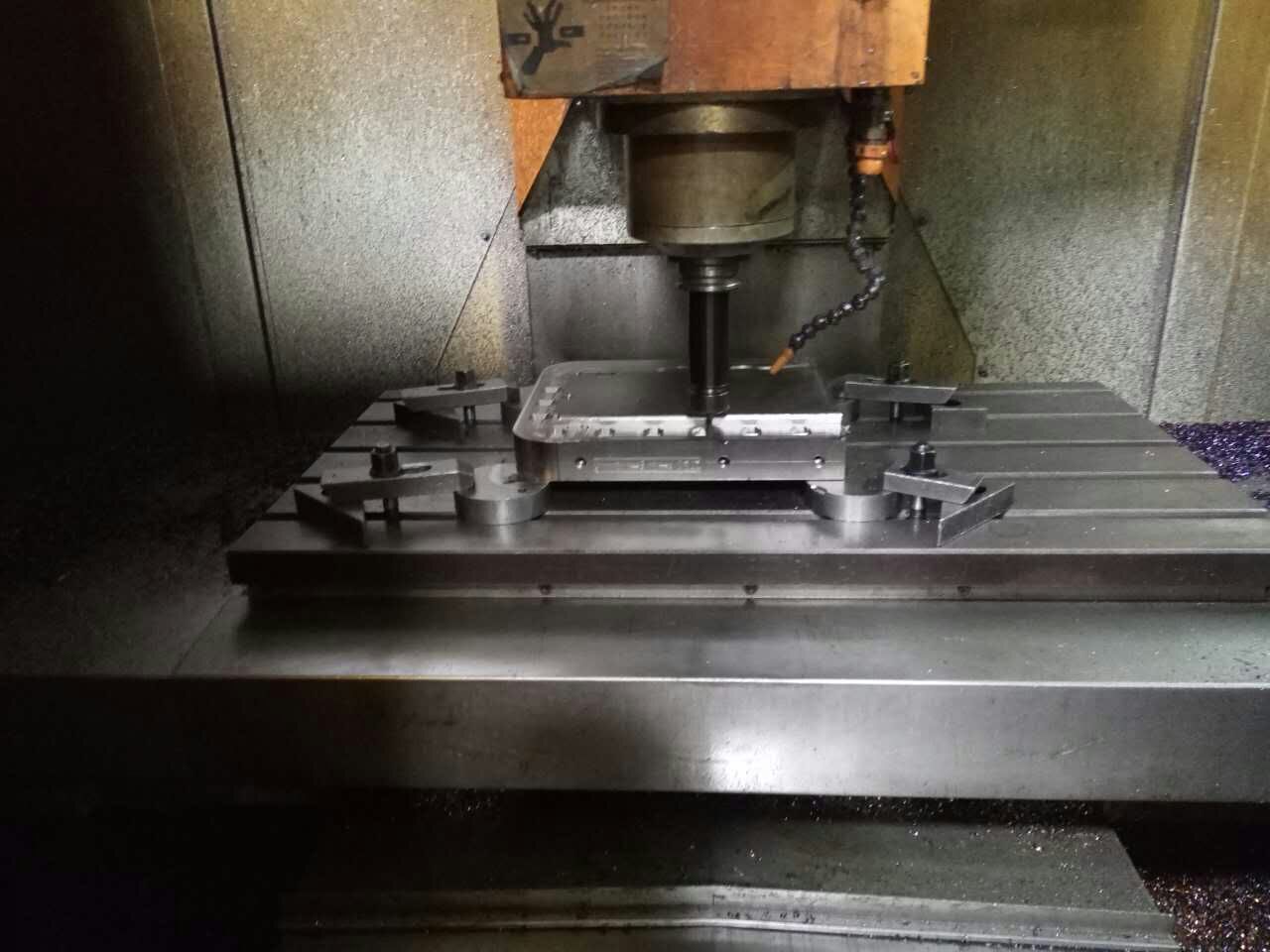

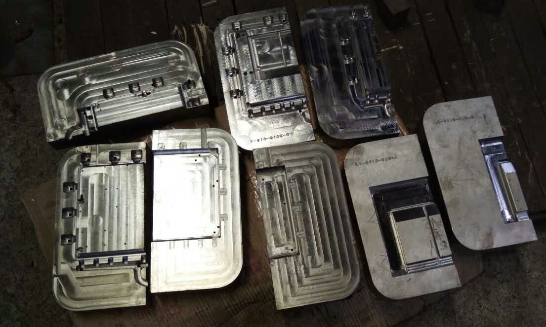

Below I am re-posting some photos from 2016 of the creation of the die cast case molds.
Regarding the beige color, having examined and restored dozens of original Model F keyboards over the years I have found that different runs of Model F keyboards have slightly different beige colors (including the early powdercoated plastic F122 cases). The beige color I approved is close to one of my original F77 keyboards (as shown in the home page of the project web site with the caption "can you guess which one is the original and which is the reproduction?").
I would say that the off-white/beige finish is my favorite of all the Model F color options!
die cast zinc case mold production first stage (1).jpg (109.57 KiB) Viewed 16646 times
die cast zinc case mold production first stage (2).jpg (159.46 KiB) Viewed 16646 times
die cast zinc case mold production first stage (3).jpg (100.61 KiB) Viewed 16646 times
die cast zinc case mold production first stage (4).jpg (174.45 KiB) Viewed 16646 times
20170522_205720 - Copy.jpg (287.35 KiB) Viewed 16646 times

Those are insert lines from the zinc casting process, and if the insert lines are protruding out of the surface (positive emboss) can be removed with additional buffing/grinding process but needs to be done carefully so as to not create more imperfections (irregular buffing marks) that will show up after powder coating. Another way is to post-process it using a CNC machine, that will be more precise but at added cost.
It isn't surprising to know that they are sharing inserts in order to save on the mold. Molds do really cost an astronomical amount of money. I know because I work in the industry (but aluminum instead).

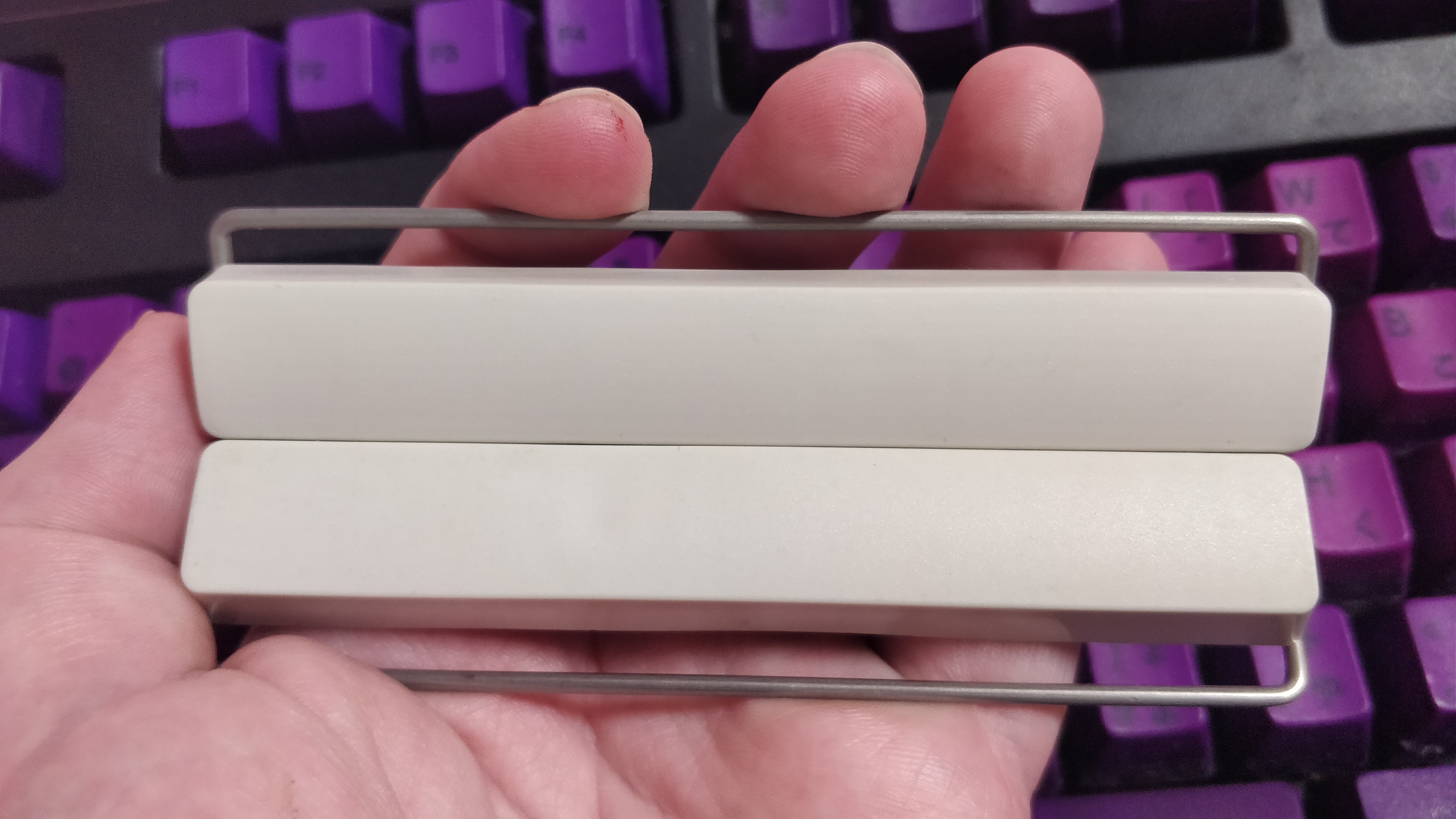

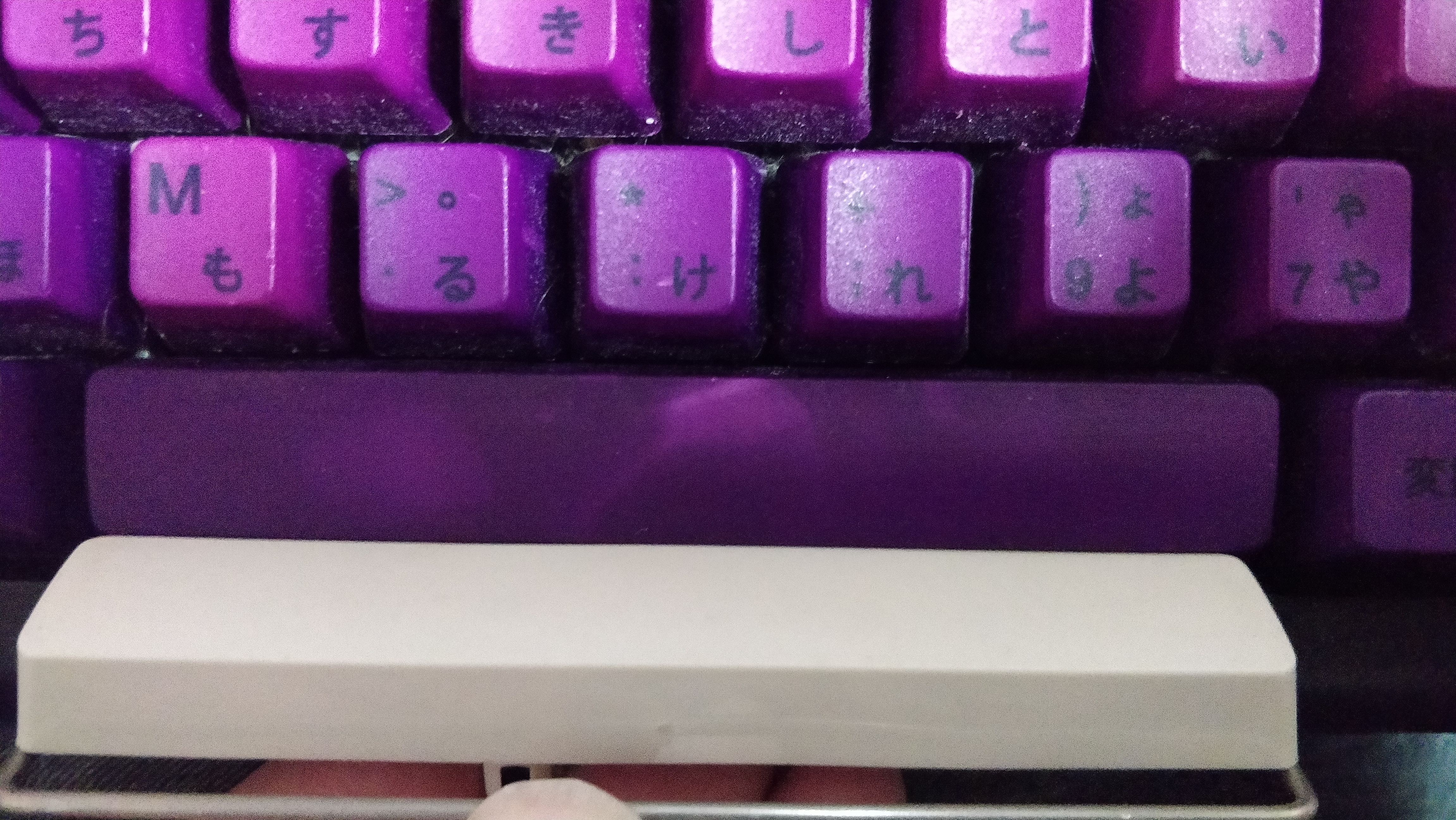

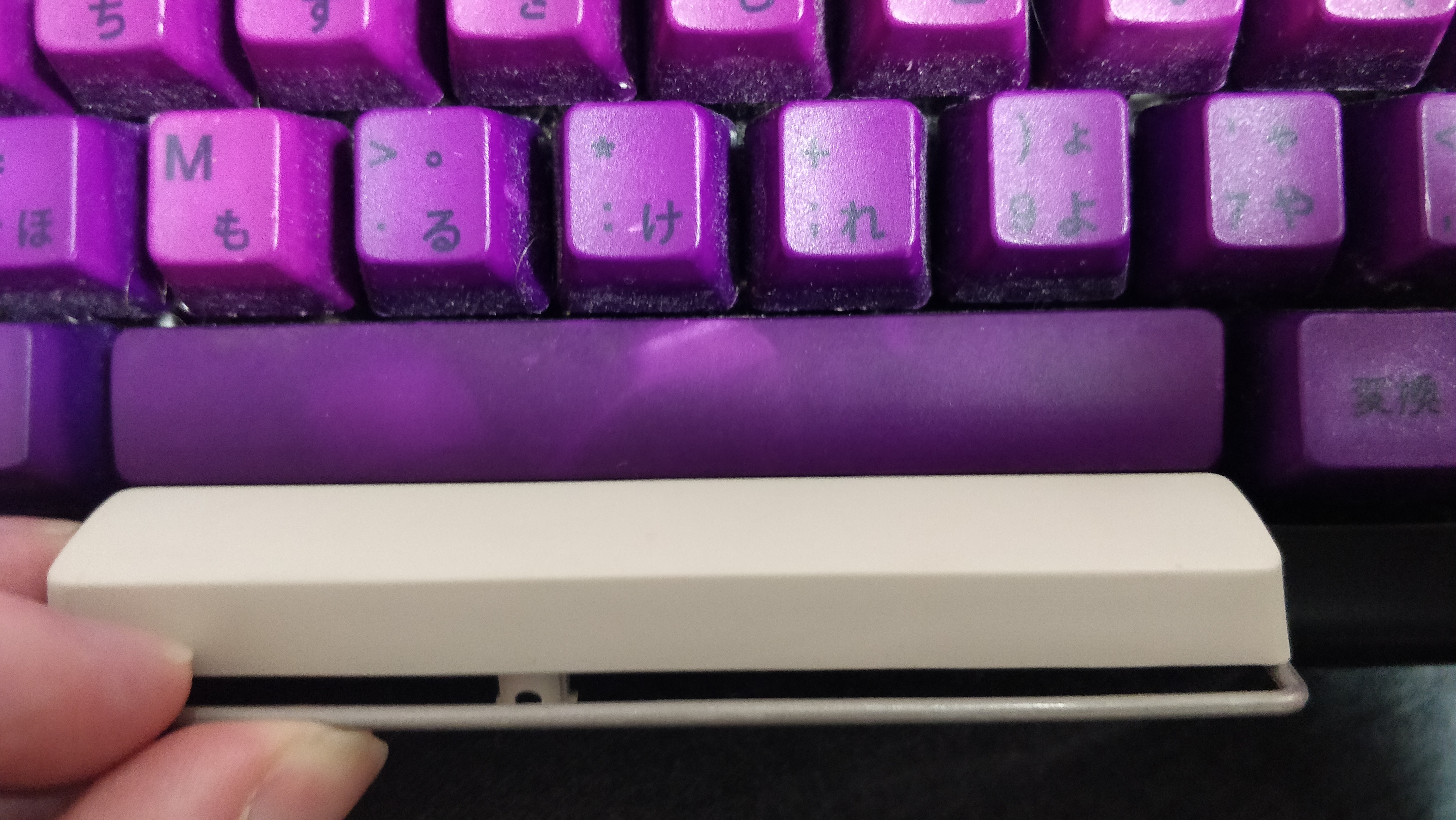

Regarding the previous discussion about shorter space bars, I picked up some from unicomp, and the old space bar is slightly shorter than the new one. Perhaps this would fix the issue with the 1.25 width key.
Unfortunately I don't have my F77 yet to test it with. My main keyboard at the moment is a JIS unicomp, and that seems to have the new space bar and a 1.25 key.
Here are some photos showing the space bars compared to each other, as well as my Unicomp JIS.
Old space
Old space
New space
New space
Both spaces
Both spaces
wcass
18 Feb 2020, 01:26
So, "old" is slightly smaller than "new". Do you have a caliper?
Perhaps "old" is 5.5u (104.5 mm nominal) and "new" is 5.75u (109.25 mm)?

Thanks for sharing pictures PRIPARA_PLAYER! I bought the new one and I suspect that I should be getting the old one.
wcass, it would make sense if the old is 5.5u, so that the other key would be a 1.5u instead of a 1.25u.
At what point did you measure the spacebar? At the bottom length?
wcass
18 Feb 2020, 20:57
daijoubu wrote: 18 Feb 2020, 02:57 wcass, it would make sense if the old is 5.5u, so that the other key would be a 1.5u instead of a 1.25u.
Yes, flat across the base of the cap.

Thanks! And that smaller space corresponds to the Small - Pre 7/2013 space bar from Unicomp?

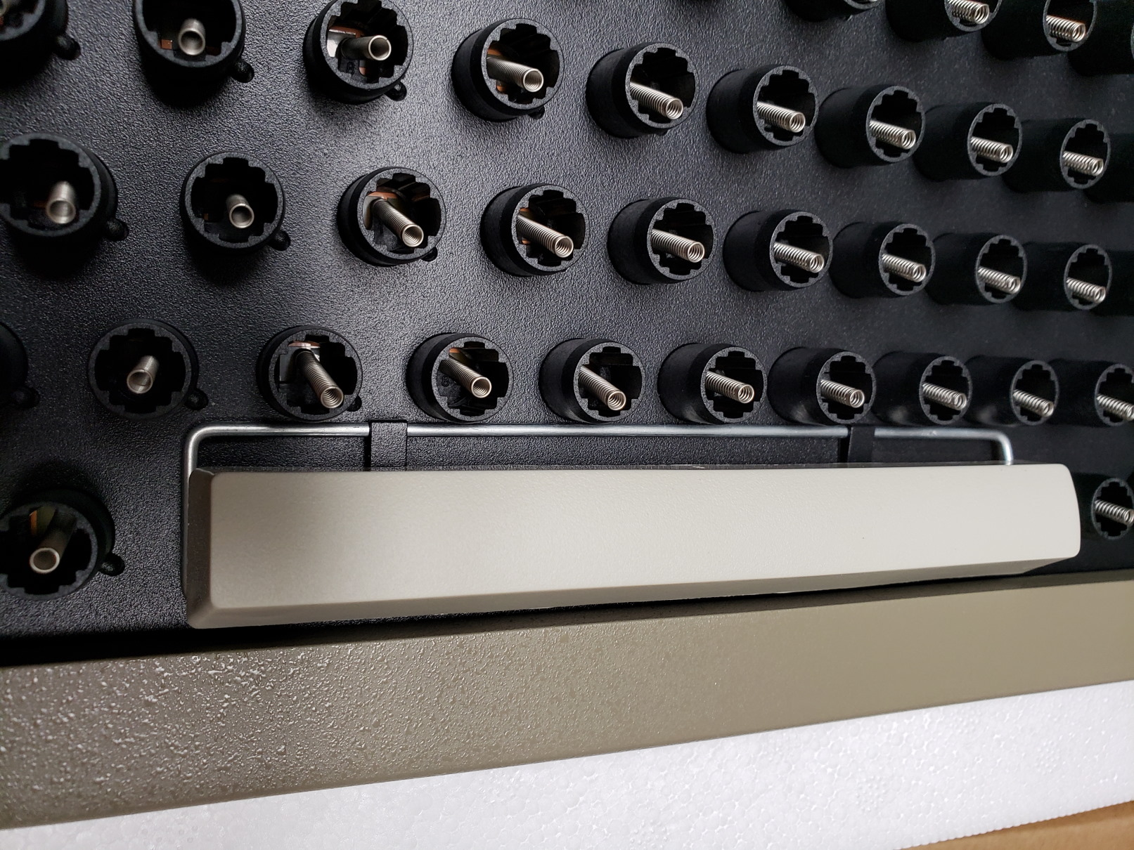

But annoyed to discover that the period key makes contact with the stab wire and makes the spacebar vibrate. Luckily it doesn't trigger the spacebar but I wonder if this is happening to anyone else.

The spacebar vibration was happening with my new F77 as well. I was able to resolve it by applying a single layer of electrical tape around the spacebar stabilizer in the areas where it rests against the tabs.

Mattr did you install the space bar inside the space bar tabs? Or is it resting on top? Sometimes by mistake the space bar does not "catch" inside one or both of the metal tabs and it is difficult to see after the keys have been installed.
The space bar wire should not be in contact with any key. I have found that sometimes the wire needs small bending adjustments for some keyboards to optimize performance - this can change the ease and sound of pressing the space bar. Too much change can cause it to become stuck though.
correct space bar.jpg (622 KiB) Viewed 14209 times
Yeah I did, fully seated in the tabs but that key hit ever so slightly. I actually solved it by stuffing some notebook paper into the tabs which gave the key clearance, while also getting rid of the spacebar rattle. Now it feels great, even though one could call it a bodge fix. It's probably just a slight issue with tolerances with my unit.
