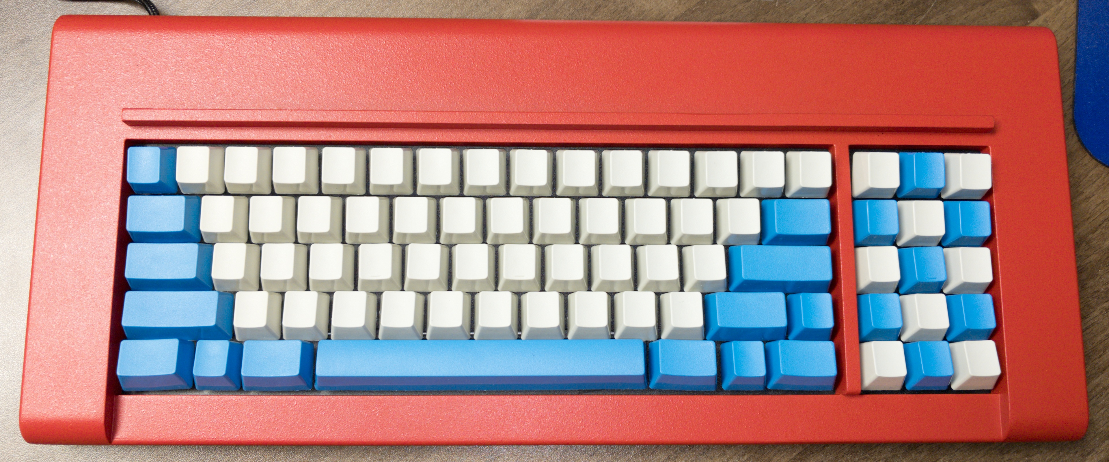

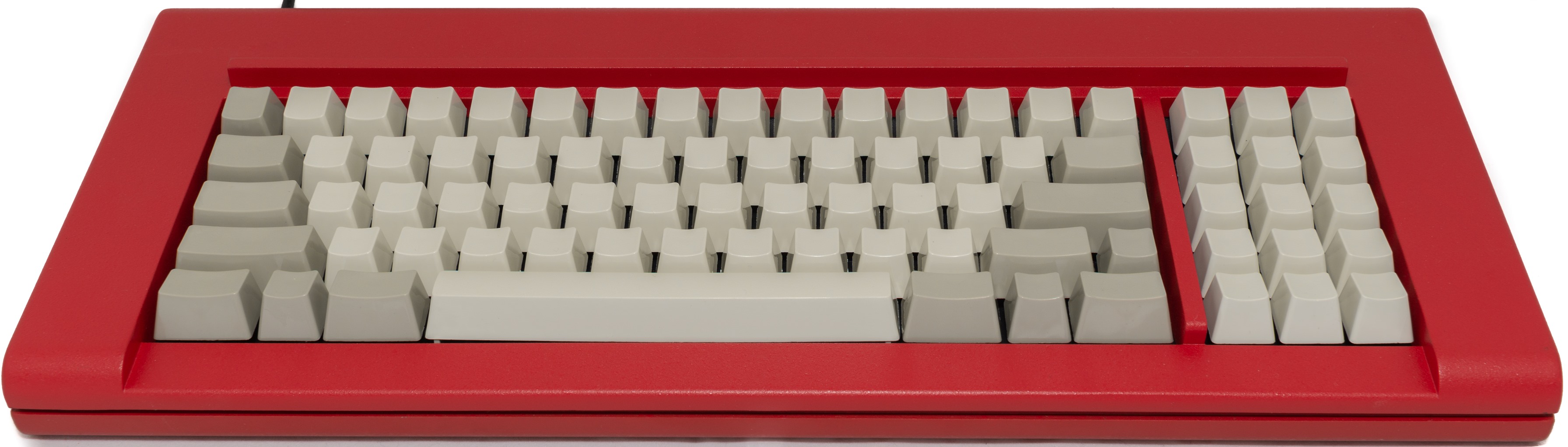

The latest batch of new variation keyboards:
Here's an imgur album of all the variations so far - it will be updated with new variations as they are photographed:
https://imgur.com/a/gw8FOl0
Both blue variants (plus the classic case limited editions True Red and Silver Gray) are still available to order but I only have a few left.
consolation
22 Jan 2020, 22:39

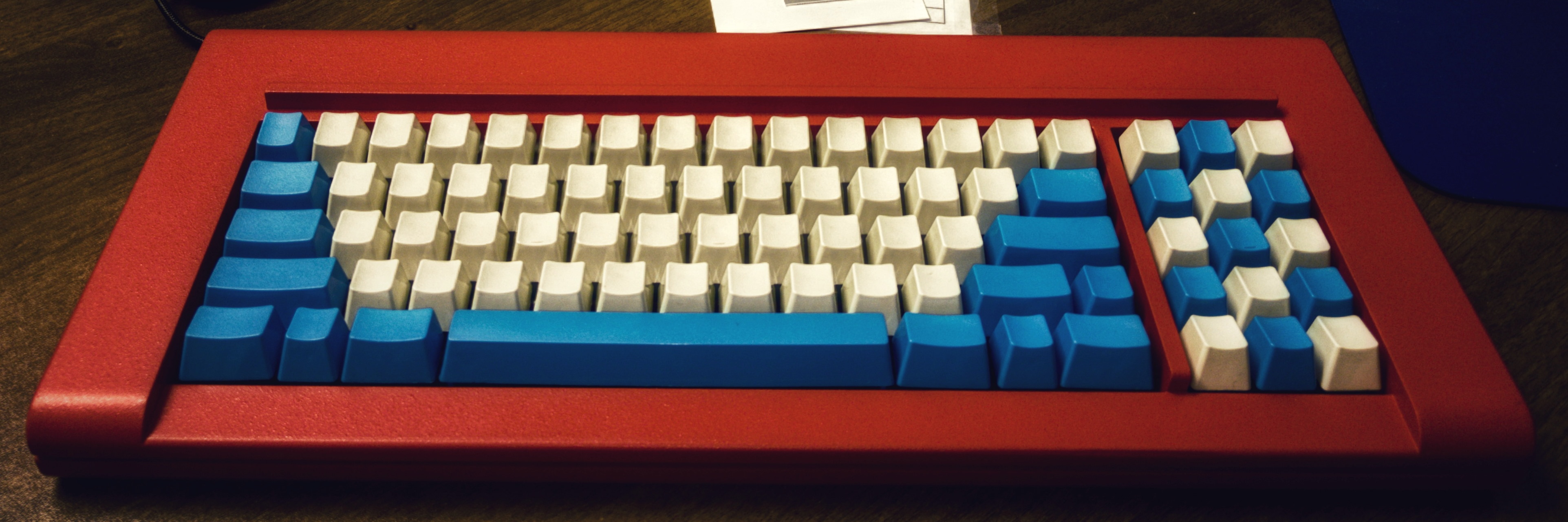

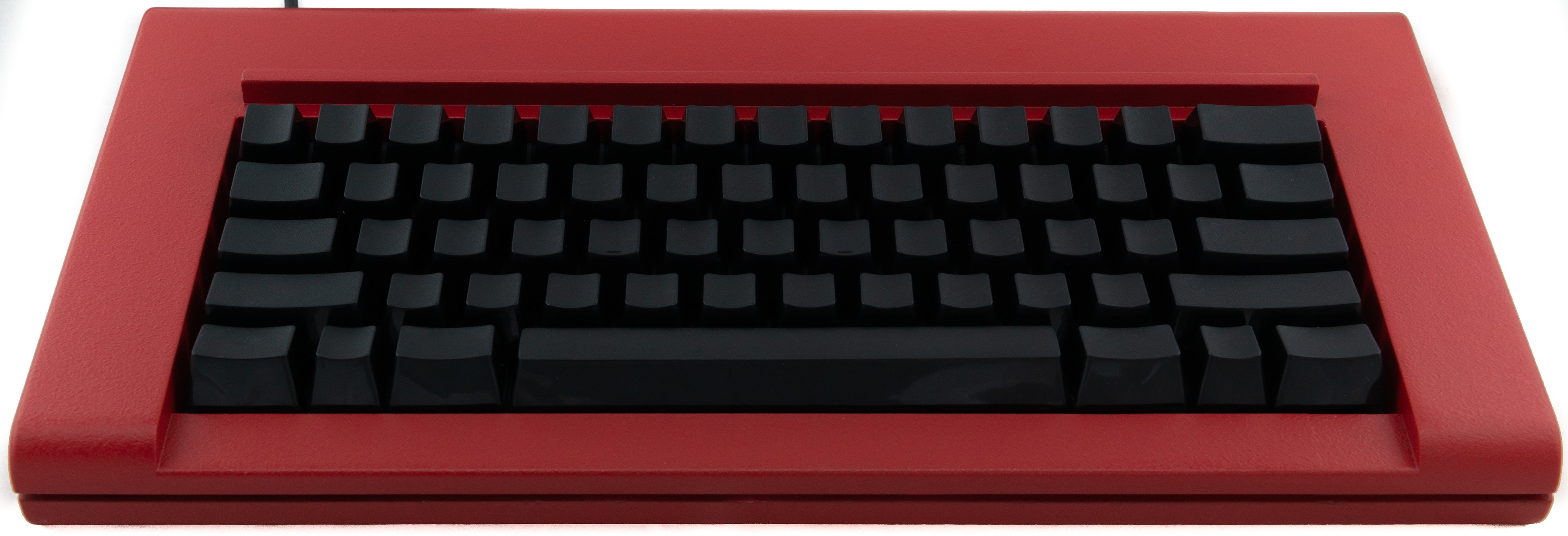

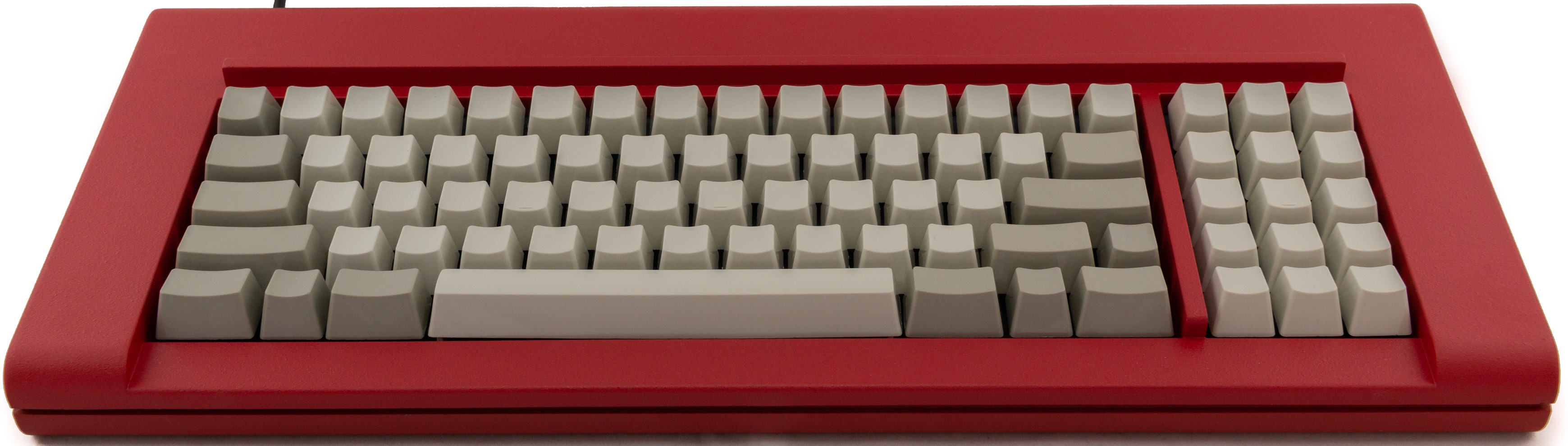

starting to regret not going for an F77 in red.... that looks awesome.
robo
22 Jan 2020, 22:41
Couple pages late here, but yeah, users burning out circuits doing mods they don't really understand, and paying the correct and legal customs fees, are not things the seller should be responsible for.
Oh yeah, and the red case looks amazing... I was skeptical from the early photos but that looks awesome.

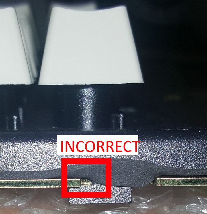

My F77 arrived recently and everything from the packaging to the build quality to the switches are all first rate. The key feel is absolutely wonderful and makes my Unicomp feel like walking through deep snow compared to gliding on ice with the Model F. Reading force curve graphs and user descriptions of the differences between M and F switches doesn't prepare one for how elegant and sublime the capacitive buckling spring experience really is and I have little doubt that the Ellipse version is at least the equal of the originals.
I do have one stubborn switch which refuses to trigger reliably despite numerous cap re-seats. It will click properly on some presses but then feel like the flipper gets stuck in the down position on others. I did watch your video on cap installation and have been keeping the board vertical BTW. Figuring that I may have to crack the plates open, I opened up the case and found that the plates were not assembled properly or had moved during shipping. The corner with the bending tab which locks the plates together was not as compressed as the rest of the assembly and the tab was missing paint in several places as if pliers were used to bend it without protection for the finish. I was able to squeeze and re-bend the tab to get things where they should be but have not gone back in to fix the errant switch or to double check that my fix is still in place.

Glad your keyboard arrived Zed! Sorry I did not catch the inner assembly error. And thank you for the kind words.
Yes you are right that there will be issues if the inner assembly tabs are not in contact with each other. The below image shows an incorrect assembly with a gap between the tabs. I've had plates slide apart when the locking tab of the top inner assembly was not in the correct position.
20190322_130207 - Copy.jpg (137.86 KiB) Viewed 12867 times

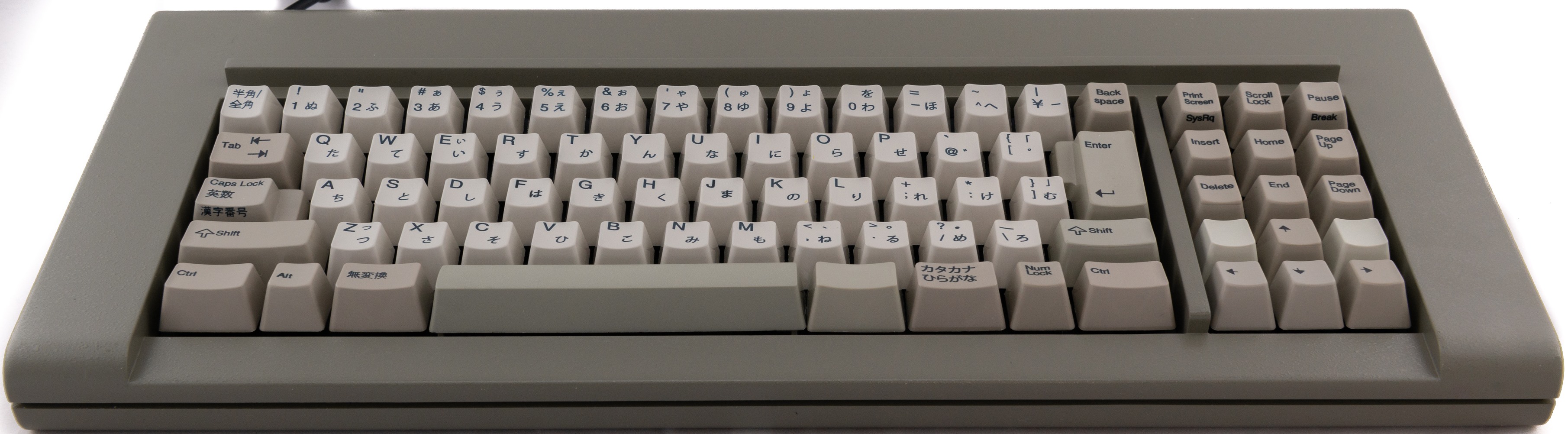

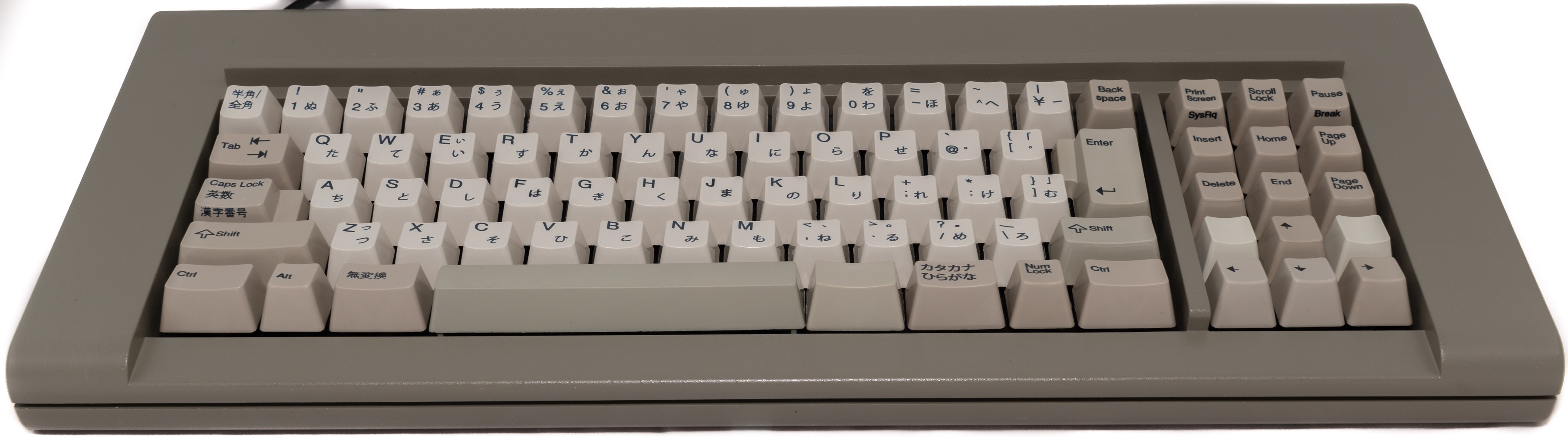

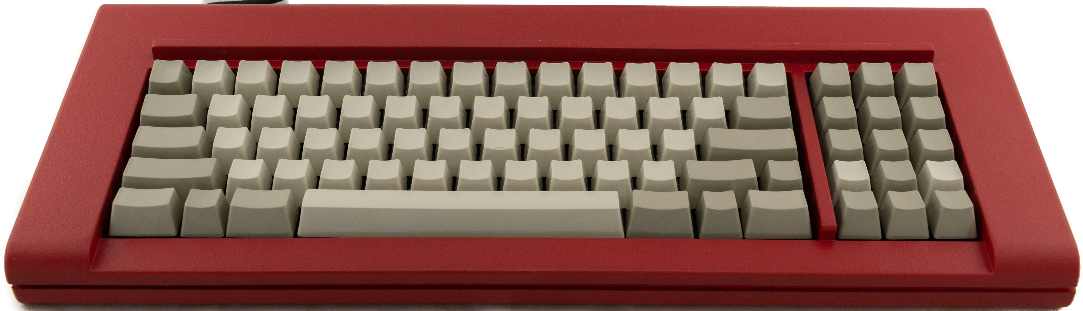

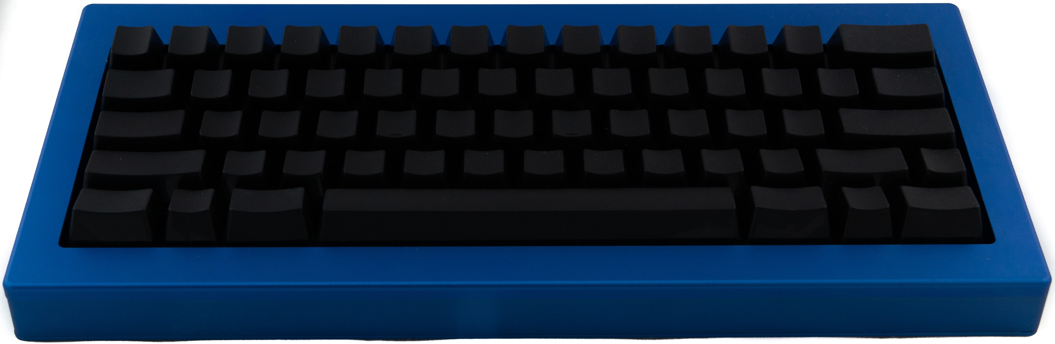

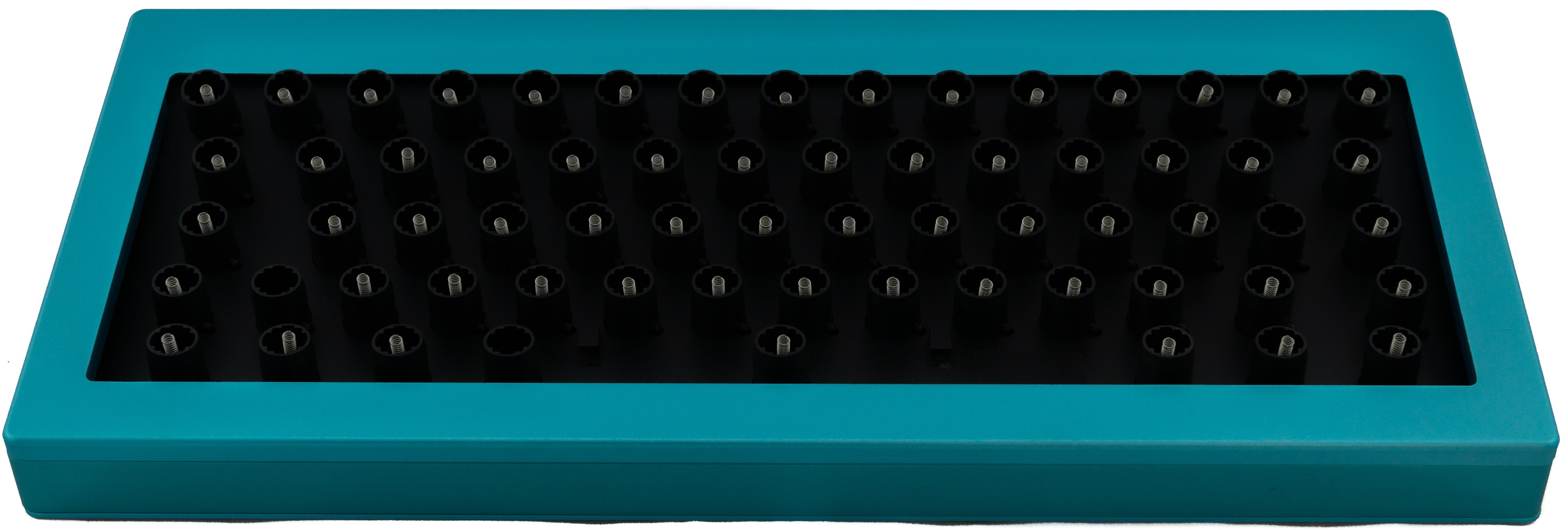

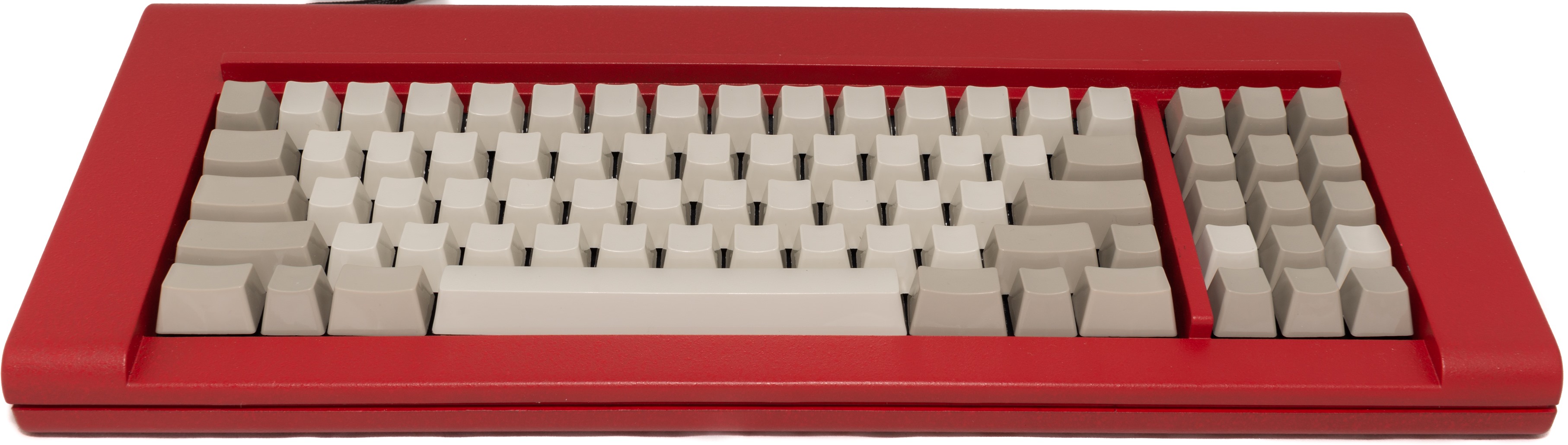

Below are some more photos of unique variations. The JIS set below is Unicomp's set - this keyboard shows off the medium space bar option not available as a factory option (I don't have any pearl shorter space bars but included a full size pearl space bar for this keyboard just in case). The final two photos are an F77 keyboard customized by a customer who permitted me to post them.
I have to redo one aspect of the dye sub setup after inconsistencies in the most recent round of testing (some decent, sharp results and some poor results with nearly identical settings). I will post more updates when I have them as always but we are still a month or two away from the majority of these keyboards being ready to go out.

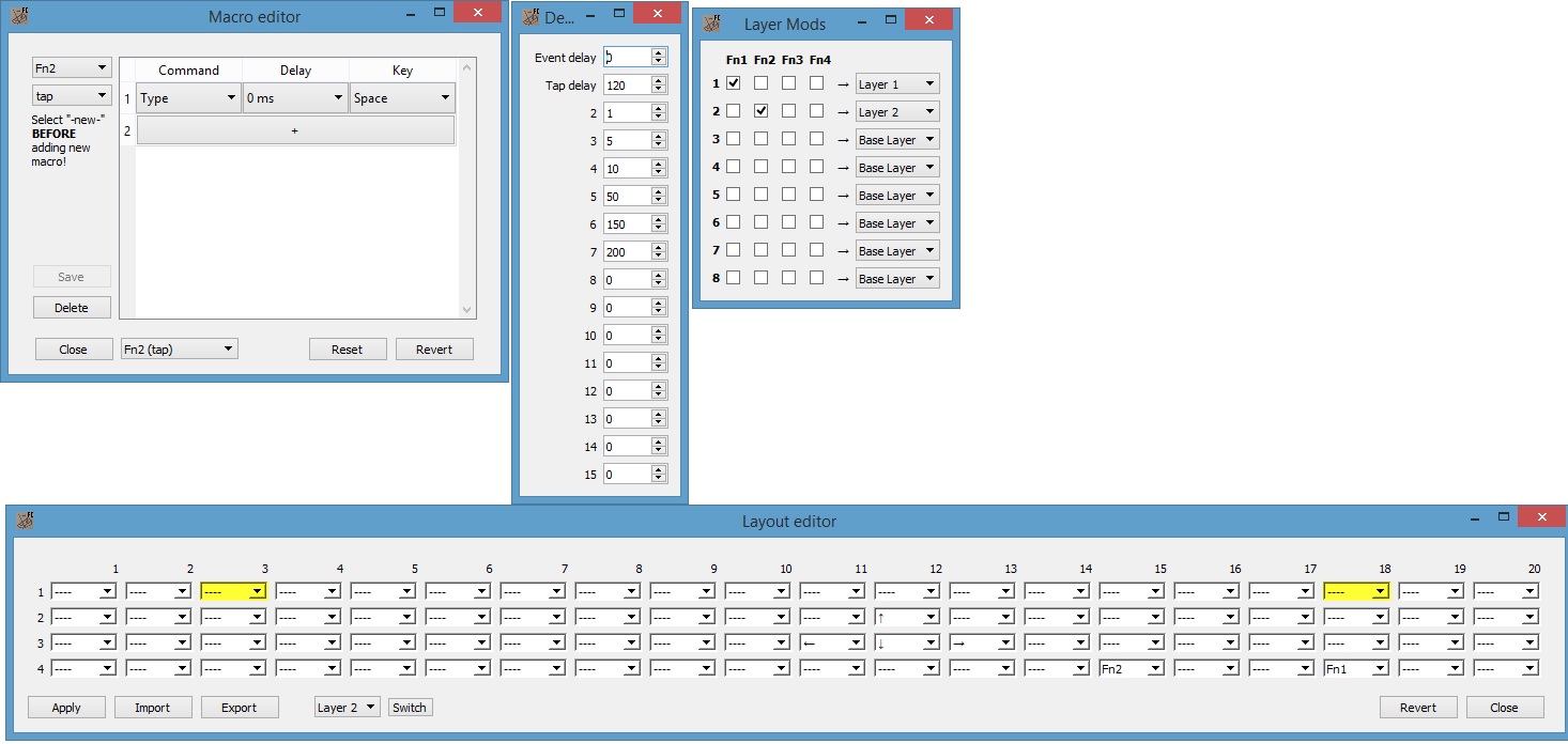

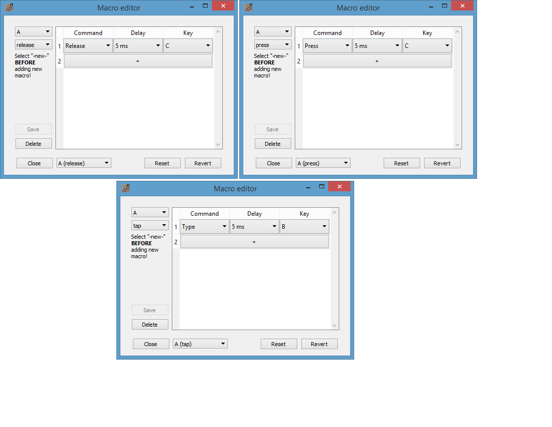

DMA wrote: 19 Jan 2020, 06:00
tentator wrote: 18 Jan 2020, 23:11 Also the sentence were you say "So you couldn't use space for Fn" does not sound reassuring..
How about "So, now those are fixed", 5 lines down the page? :D
Hi DMA,"

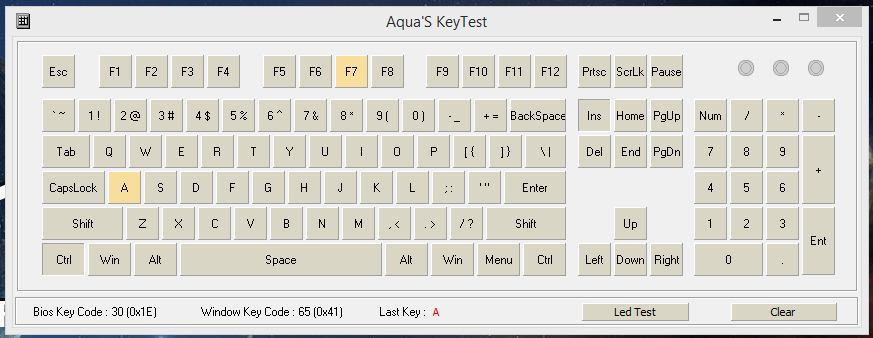

you basically said you have fixed it but I downloaded again latest trunk that included the sentence "so, now those are fixed" but even if testing it many times it really does not seem to work.
Maybe you can see what is wrong:
First I tried to define two macros about key 'A' (one for press and one for release) so that it actually would press and release key 'C' and this seems to work (a part from some minor bug in the GUI visualization right after you define the macro, the drop downs next to the close button seem to display info of the other macro). Just to confirm that I correctly define and save the macros, they stay persistent also after unplugging usb.
Then finally I defined the "tap" macro about key 'A' so that it actually would "Type" key 'B' but this seems not to work at all.
Actually while debugging it with the Aqua test I saw that for some strange reason also the F7 key gets pressed for a fraction of a second.. not sure if this could give you some hint about what's happening, but definitely it does not seem to me that the "tap" macro works..
This now is just an illustrative test but I tried several others as well.. including trying to implement the famous "space-fn" without results..
I do believe that you can reproduce the same behaviour on your side: do you see something that could explain this?
Thanks in advance,
tent:wq

Unclear what you downloaded. Did you go to repo, clicked "download", copied config.h to the new location and built? If not - all bets are off. "Latest firmware, latest utility" is the name of the game.
We are hijacking the topic, but I never promised 4 keys for a price of one.
Let's not go all theoretical tho and get down to practice.
Space, which doubles as Fn on a long press (..come on, how would you do right alignment if you can't just hold the space bar until autorepeat kicks in? But I digress.)
There is no "Long press" macro, because it's unnatural. I'm not going to judge people for how long they keep their keys down.
There is a "tap" macro tho. Not the most natural of things, but it's there.
So your base (the one in layout) key is Fn (no "Long press", remember?), and your "tap macro" is "type Space".
I _strongly_ recommend defining Fn keys on base layer and keeping that position in ALL other layers "transparent"/"none" or the same Fn. Transparent is better - less chance to screw up.
I tested that and it works. I'm not rich enough for a beamspring - so it's tested on a Topre I found in a garbage bin.
If anybody wonders - what happens under the hood is when you press and release base key within "tap delay" (specified in Delays) AND NO OTHER KEYS GO UP OR DOWN WITHIN THAT INTERVAL - it eats base keypress AND release, and enqueues tap macro content instead.
"Enqueues" means exactly that. The macro commands are placed into USB output event queue with future timestamps.
If you specify a 60-second delay, you can continue typing* - but one minute later something will happen in parallel to what you were doing at that time.
Not sure what will happen if you tap several times - it's a 256(?)-event circular buffer, so you firmware shouldn't crash but there will be Fun, guaranteed.
*) I hope I ignore those generated events for macro triggers, but I honestly don't remember.
well yes I even created a new dir, cloned with git, and edited config.h so that it has correct switch, rows and cols indeed.
I'm using the d:\...\CommonSense-GIT-LAST\CommonSense\8x24.cydsn\ subproject to be precise.

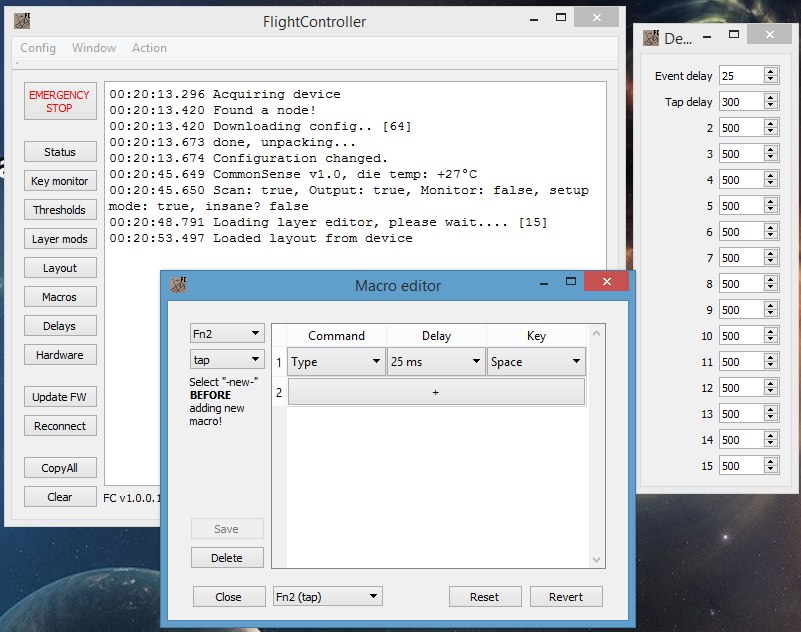

DMA wrote: 04 Feb 2020, 06:48 Space, which doubles as Fn on a long press (..come on, how would you do right alignment if you can't just hold the space bar until autorepeat kicks in? But I digress.)
usually this is done with tapping the space two times in a row, that will make autorepeat the space.. but yeah, I could live without it probably :)
DMA wrote: 04 Feb 2020, 06:48 There is no "Long press" macro, because it's unnatural. I'm not going to judge people for how long they keep their keys down.
Ok doing exactly that but it still does not work: basically what happens is that the tap macro seems to never be called.. I also tried to set the tap delay to 250ms but still it never triggers.
This is current situation:

It is not a sound approach to _test_ things on a speed you can't see when you have alternatives.
There is a reason new planes taxi first, then speed-taxi, then make a single loop over the field with wheels down, and not go for a ceiling-AND-speed-record run straight off the slipway.
So, for tests:
* Delays: ALL delays 500ms at least, 1000 recommended.
* Make sure your autorepeat delay is longer than any of the delays configured - or run Aqua Key Test in foreground.
* Fn keys enabled on base layer.
* ALL higher layers are EMPTY ("-----"), with an exception of a single matrix position which has "A" on base layer, "B" on Layer 2 and so on.
* The USB device is handled by the host, not forwarded to some virtual machine. We are not debugging VirtualBox USB forwarding here.
Generally:
* event delay 20ms at least - at zero milliseconds updates will go out in adjacent USB packets, 1ms apart. May work, may not, who knows.
* tap delay of less than 300ms is unrealistic: keys have inertia, hands have inertia, brains.. well..
I can press same model F key twice in 15 milliseconds, but that doesn't mean I can do that when actually typing, never mind doing that trick with space bar - the heaviest key with a heaviest stabilizer on the keyboard.
..as for "GUI visualization bug".. best I could come up with. That's macros' madness shining through. Things like "there is no keyboard at firmware level, it's all host with multiple keyboards connected to it."

DMA wrote: 05 Feb 2020, 03:09 * Delays: ALL delays 500ms at least, 1000 recommended.
Done, but still no tap gets activated
DMA wrote: 05 Feb 2020, 03:09 * Make sure your autorepeat delay is longer than any of the delays configured - or run Aqua Key Test in foreground.
you mean autorepeat defined in my os?
DMA wrote: 05 Feb 2020, 03:09 * Fn keys enabled on base layer.
Not sure what you mean.. but is what you saw in my previous post's screenshot ok?
DMA wrote: 05 Feb 2020, 03:09 * The USB device is handled by the host, not forwarded to some virtual machine. We are not debugging VirtualBox USB forwarding here.
It's a non emulated windoze, no vm..
DMA wrote: 05 Feb 2020, 03:09 Generally:
Both changed.. no improvement..
DMA wrote: 05 Feb 2020, 03:09 ..as for "GUI visualization bug"..
Yeah that's a minor thing, when you enter the macro window i just select first the -new- on the dropdown, then the macro i want to see/edit and i see again the correct values.
