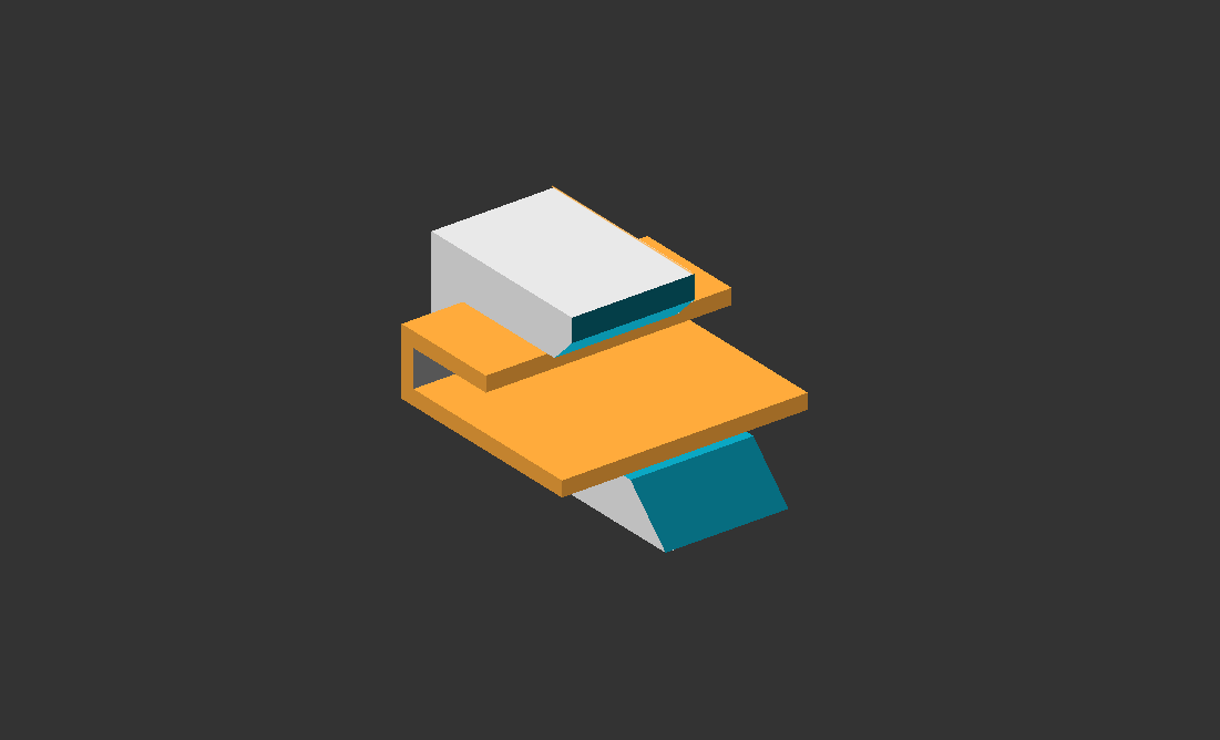

Attached is a quick mockup of the F adapter sleeve I mentioned previously for the stabilizer clips. The 90 degree angles would be closer to 95-100 to retain outward extension against the stabilizer clip
F sleeve adapter in orange

lot_lizard wrote: Attached is a quick mockup of the F adapter sleeve I mentioned previously for the stabilizer clips. The 90 degree angles would be closer to 95-100 to retain outward extension against the stabilizer clip
This is perfect.

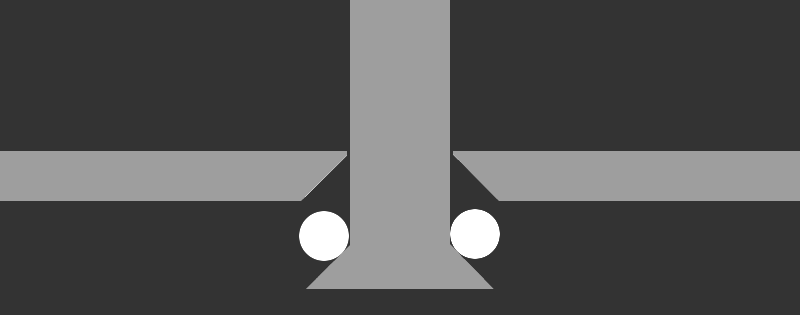

lot_lizard wrote:
Adding the o-ring around the portion of the screw that holds the bottom plate (the countersink) reduces any vibration transfer between the plates.
How is this not moot with a nice fresh mat separating the plates and bedding the barrels?
I can see the point on the Model M, I think I even tried it once.
Posted: 20 Jul 2016, 15:03
by lot_lizard

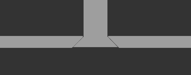

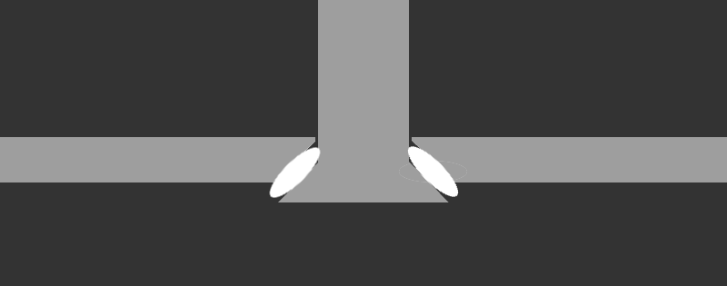

pyrelink wrote: I would appreciate a diagram if not too much effort for you. I am currently imagining these o-rings functioning like washers on the counter sunk side of the plate? Making the compression a little less stressful on the plates and the screws, and insulating the screw from the other side of the plate. Makes a lot of sense actually. What are the size of the o-rings you are planning, and did Phosphorglow actually use an o-ring on every single one of the screws/bolts on your bolt modded board?
The previous picture of the screw with o-ring was taken from Phosphorglow's photo archive of the recent build. The airline board in the photos is mine, and was used on it. Some crude mock-ups below, but everything should be to scale
As we would be today
Addition of the o-ring
Under compression
Under compression
