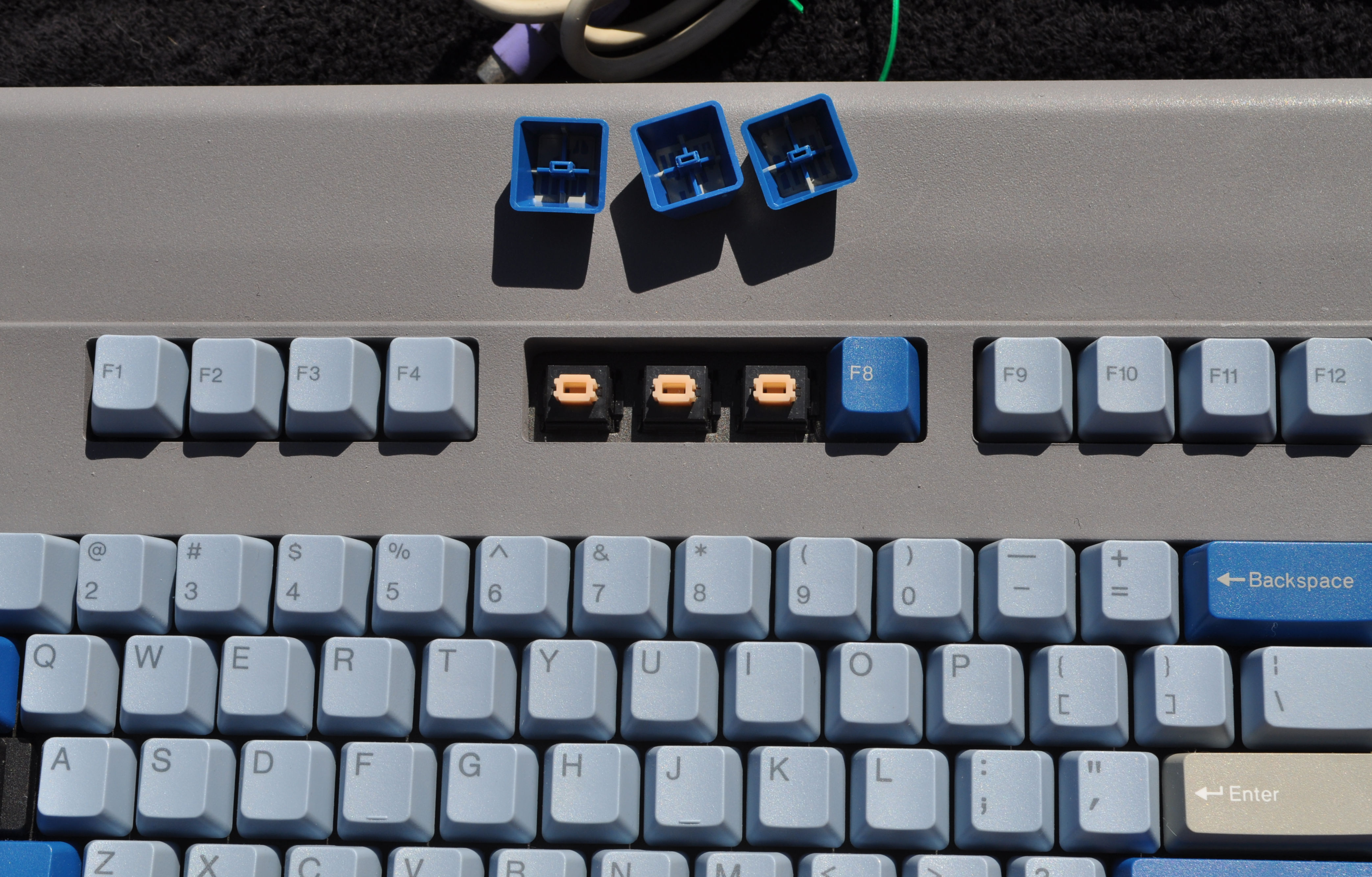

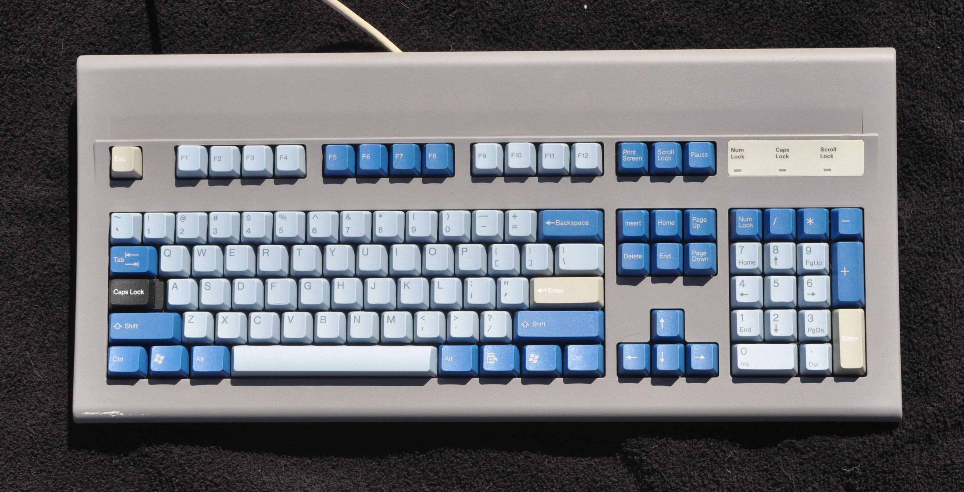

My newest frankenboard. Dell AT101W. Swapped out black Alps with salmon Alps switches. Grey painted case, w/matte clear enamel finish. New double-shot Tai-Hao blue & grey keycaps. Waxboil. Paper mod. If you squint, you can see the key mounting plate. Sanded, repainted with hammered black paint. Matte clear enamel finish.
I polished off the white mark in the lower left of the keyboard before I posted this on ebait -- and before I destroyed my camera lens. It amuses me that the grey finish I added is robust enough to scratch some other surface.
I bought the black caps lock key from Tai-Hao, separately from the blue & grey key cap set. Dells have that funky stepped caps lock key and Tai-Hao didn't have one in the correct color.

How did you stabilize the spacebar? When I tried Matias stabs, the spacebar became wobbly in yaw direction.
- hellothere
- Location: Mesa, AZ USA
- Main keyboard: Lots
- Main mouse: CST2545W-RC
The Dell spacebar has two "guide pillars" on it and those fit into two plastic "sockets" on the keyboard. That makes spacebar wobbling almost non-existant. A lot of keyboards used one or two of these pillars and sockets. Omnikeys and Apple Standard Keyboards come to mind. The Tai-Hao spacebar cap doesn't have them: the space where the pillar would be is a cross-mount hook (or, in Tai-Hao terms, a "fixed stem") socket.engr wrote: 05 Sep 2023, 21:23How did you stabilize the spacebar? When I tried Matias stabs, the spacebar became wobbly in yaw direction.
I used the hooks, loops, and stabilizer wire from a set I bought from Tai-Hao and they work better than using the Dell parts, but it's still wobbly. The proper solution would probably be to dye the Dell space bar and use that and the sockets, but I've got no experience dying stuff. I did some preliminary investigation into dying plastic and found too many chemicals hazardous to my or my animals' health. I'm still interested in learning, though.
I don't think that brand new Tai-Hao Alps sets that came out either this year or late last year have spacebars with the pillars. There's nothing on the Tai-Hao website that says anything one way or another.

That looks really nice. The color combo works much better than I ever would have expected. Yummy.hellothere wrote: 05 Sep 2023, 21:14 My newest frankenboard. Dell AT101W. Swapped out black Alps with salmon Alps switches. Grey painted case, w/matte clear enamel finish. New double-shot Tai-Hao blue & grey keycaps.

There are some guide posts out there that poke into an MX mount. I added one to a Tai Hao spacebar by gluing a carved down MX cap to the bottom side. You have to get it exactly right, location and angle. I got lucky, it worked perfectly the first time. Some spacebars have two, but one is enough.engr wrote: 05 Sep 2023, 21:23

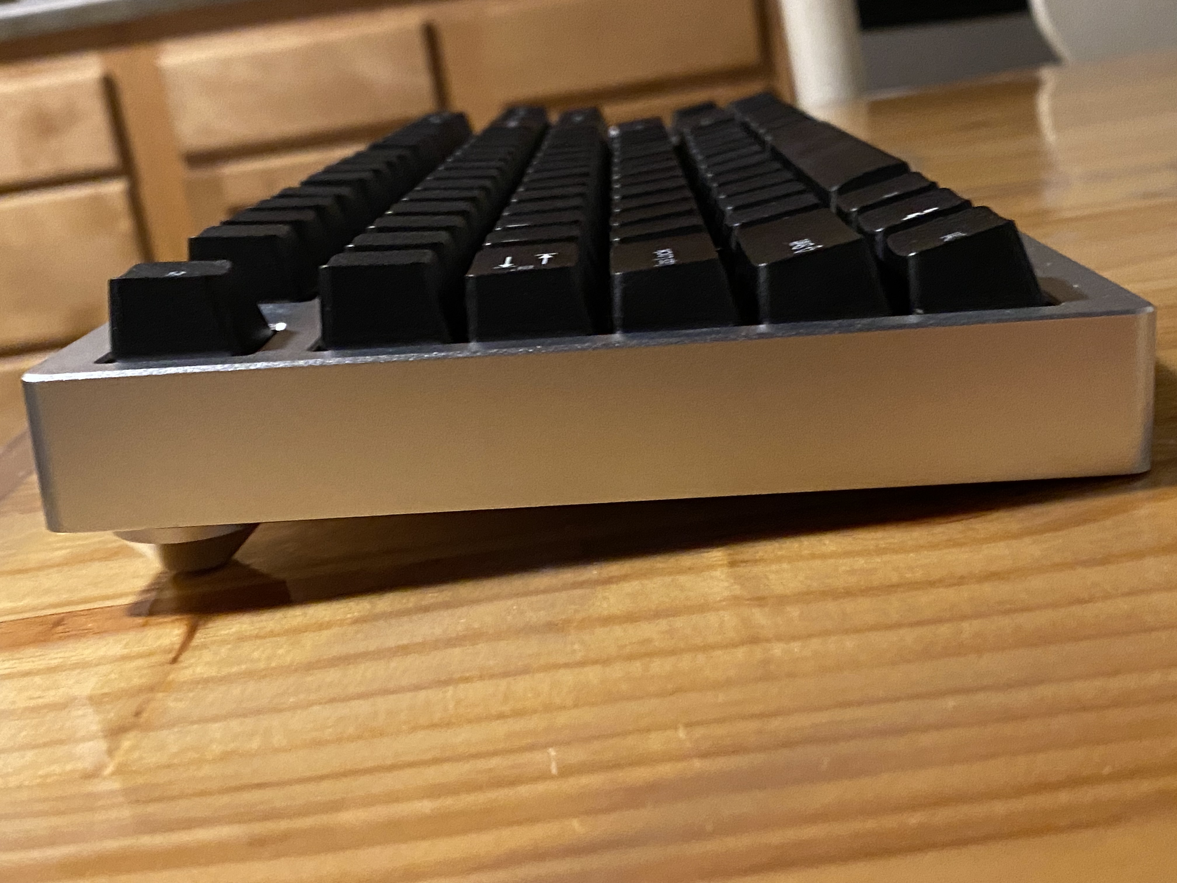

I've done this on my own V80, but it was annoying to desolder all of the matias switches since they used crappy solder. A good solder gun or lots of flux will get the job done though. The board's held together with clips and one screw, so you'll need something thin to open it up.engr wrote: 01 Nov 2023, 19:43 Does anyone have experience transplanting Alps into a KBParadise V80 Keyboard?
I have one with Matias clicky switches, and I want to try transplanting some NOS white or blue Alps into it. Unfortunately, KBParadise no longer sells DYI kits for these.

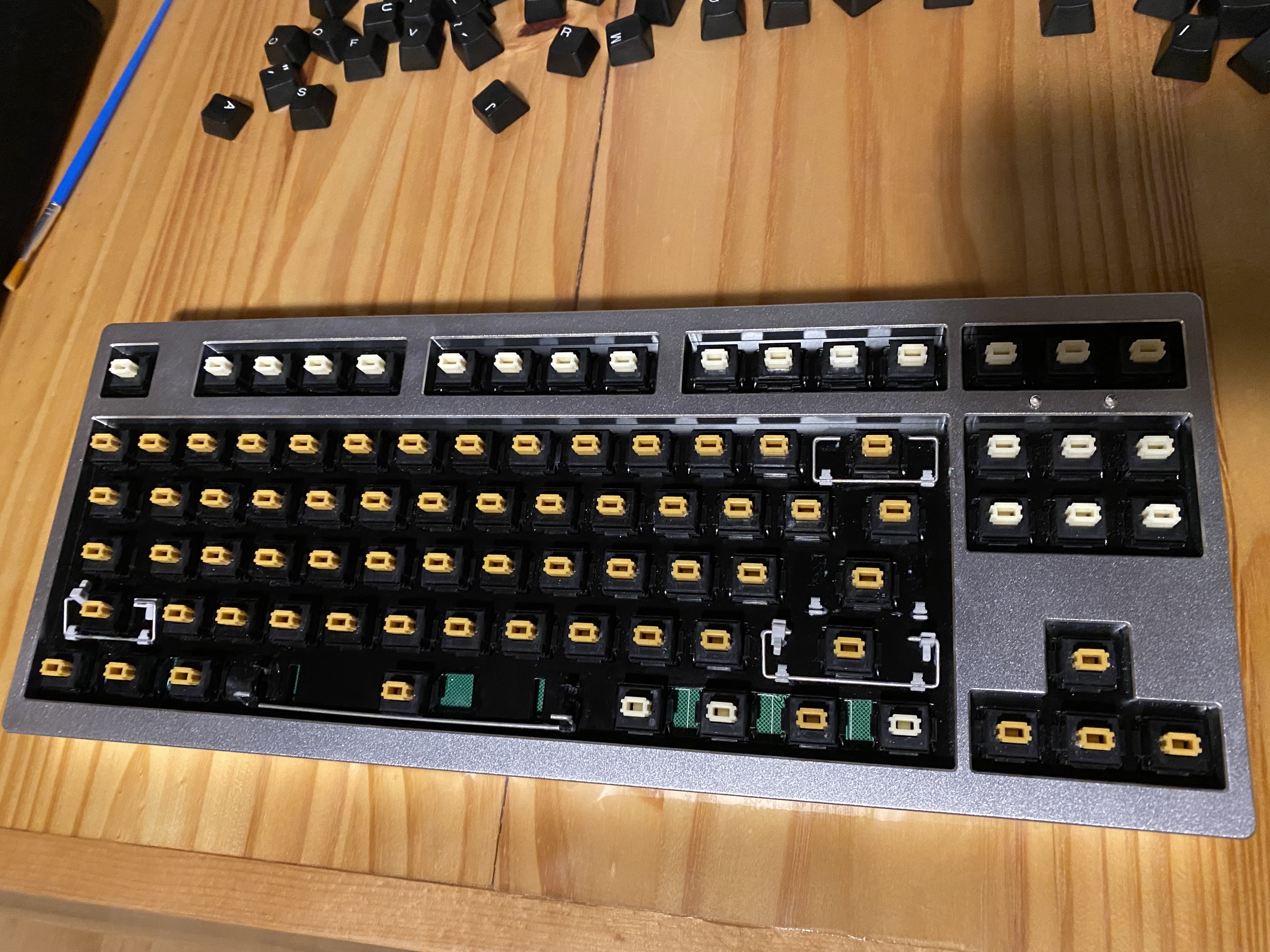

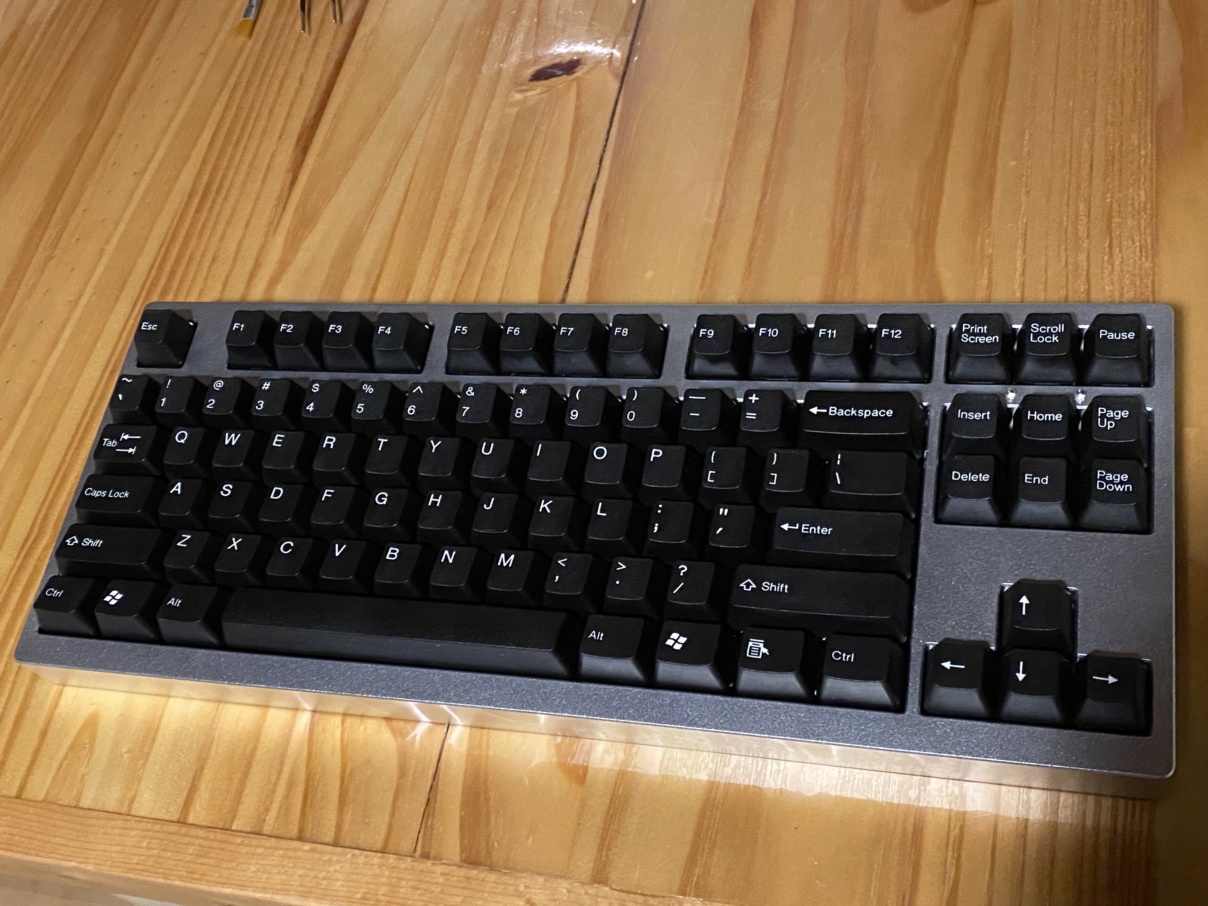

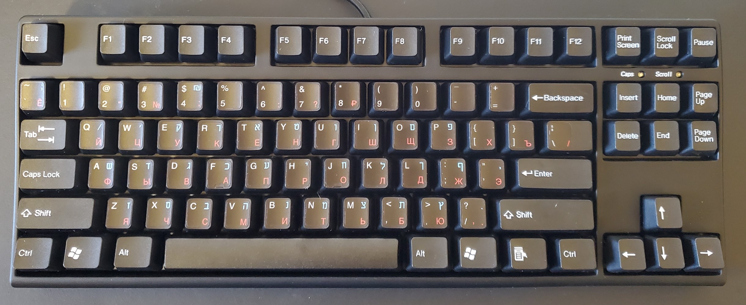

If you're decent with a solder sucker and a soldering iron you'll be alright. They are a bit of a pain honestly, the solder they use is tin junk. I just heated the solder, sucked it up, then soldered the joints again with good leaded solder, then sucked up that. You still end up with pins that want to stick to the pads with the most minute amount of solder, that's where I struggled the most, solder wick and flux didn't help much for whatever reason.engr wrote: 01 Nov 2023, 19:43 Does anyone have experience transplanting Alps into a KBParadise V80 Keyboard?
Here's the product though, I felt that it was worth the trouble. When I built it a few years ago there weren't any real options for custom alps boards like there are now.

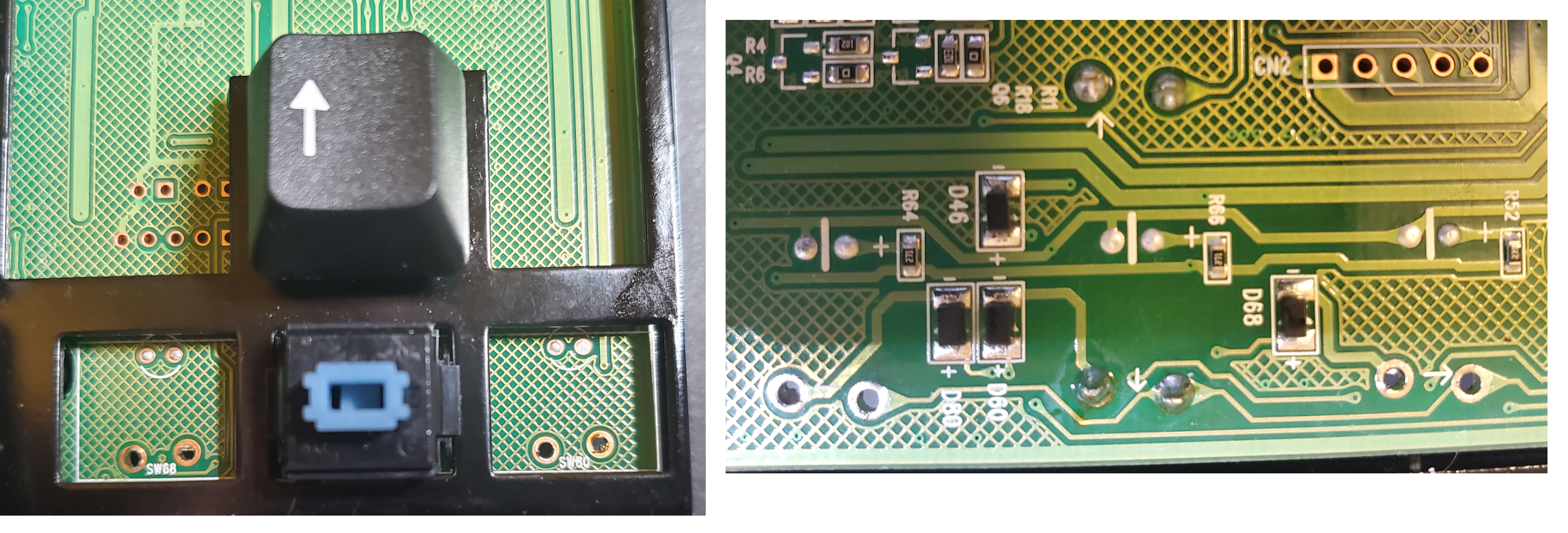

Wow, you guys weren't kidding, that solder is horrible. With tons of flux and a good tin-lead solder, it looked like I got it all out, but unfortunately small amounts of it were still inside the copper through-hole sockets, so once I pulled the switches out, pieces of these sockets came out with them...Vito300 wrote: 02 Nov 2023, 06:38 They are a bit of a pain honestly, the solder they use is tin junk. I just heated the solder, sucked it up, then soldered the joints again with good leaded solder, then sucked up that.
So now I have three switches that don't register (not the switches themselves, but their locations on the PCB).
What's funny is that the PCB traces look perfectly well connected to the pads on both sides.
Ugh. Is my board toast now, or is there a way to fix those through-holes?
- sockets.png (4.91 MiB) Viewed 24079 times
You can solder in jumper wires directly to the switch legs, I've done it before on a couple of boards with dead pads.

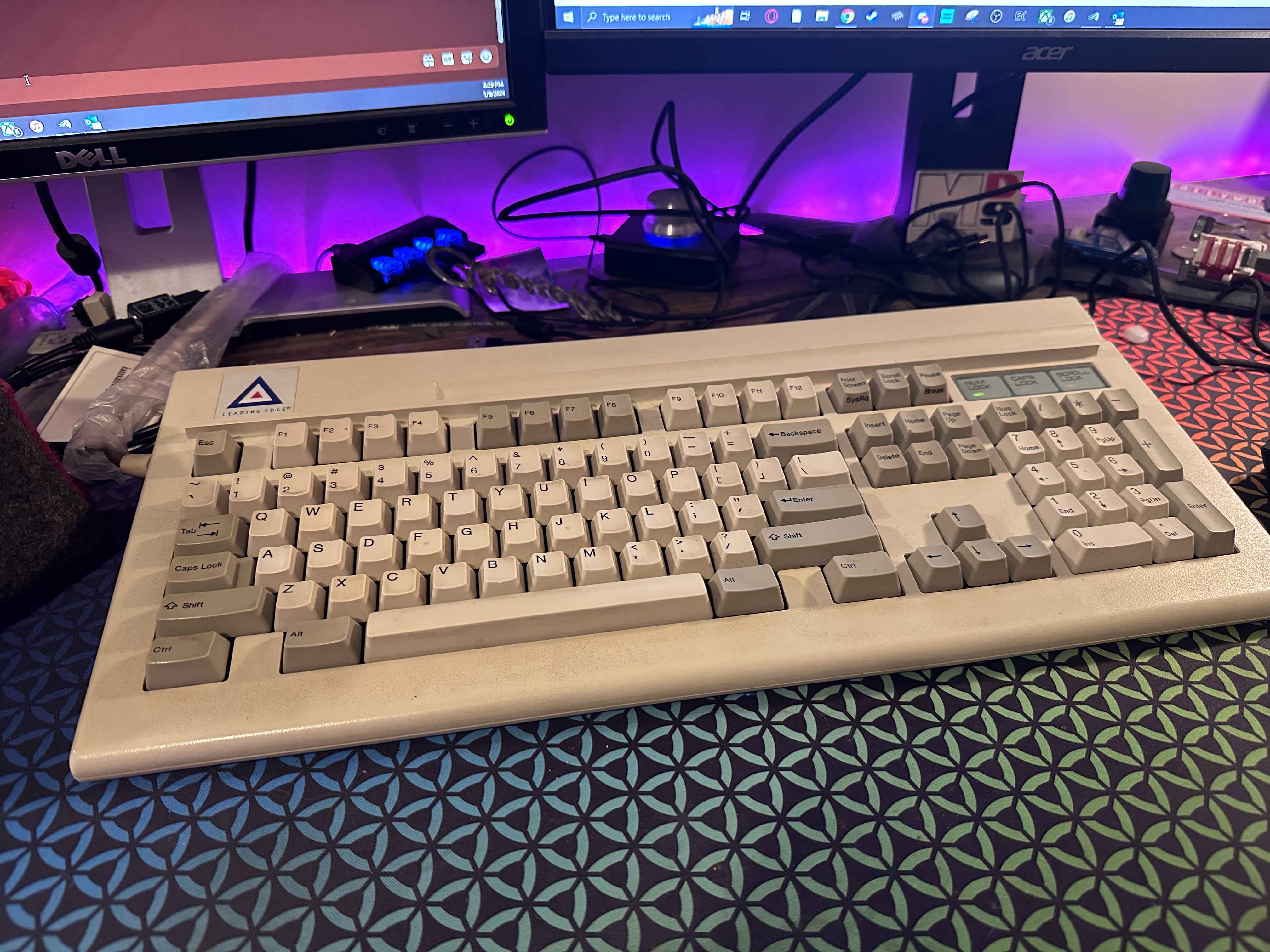

Hi! I am new here and registered to post and share my appreciation of an old Alps keyboard I bought a few months ago. The keyboard is a Tai-Hao Fame 5539-5.
It is yellowed but quite clean for its age. It has a steel bottom plate and steel switch plate and relatively heavy for a compact keyboard.
The keyboard works with no issues testing it in MSWord and in MSExcel on a Windows 10 PC with no PS/2 port. I used a Belkin F5U119-E PS/2 to USB converter together with a DIN to PS/2 adapter cable.
I am into retro PCs for a few years now and this is one of my lucky finds and very happy with it. All the pictures below and on Imgur album show the condition of the keyboard as I got it.

Very nice keyboard! I like the Focus layout and function key label. I wonder if it was made by the same manufacturer as Focus?

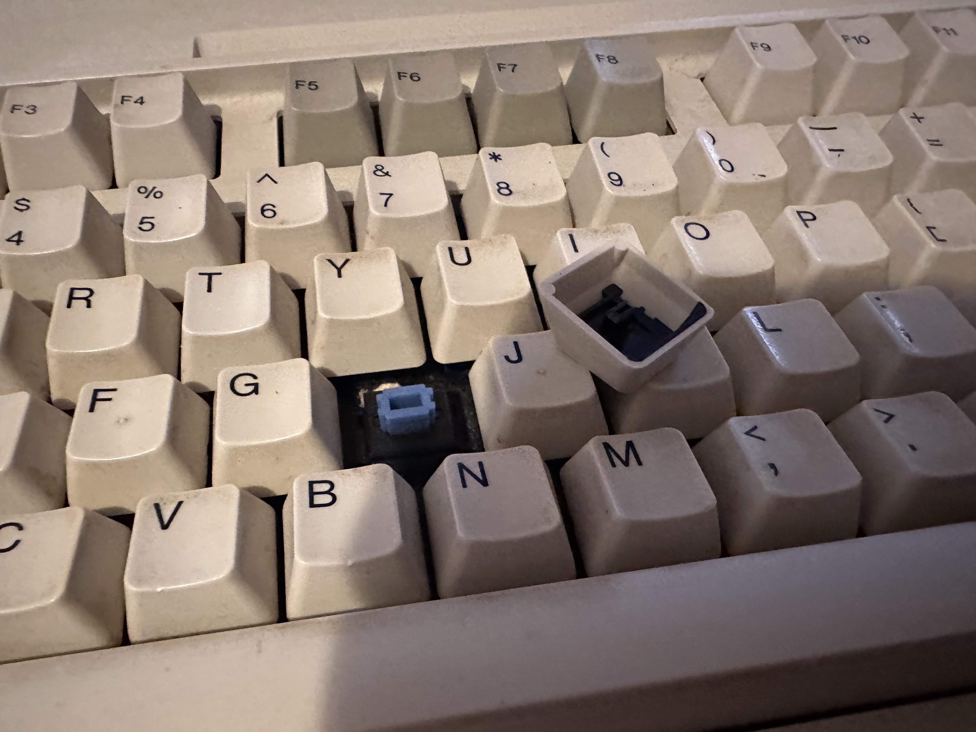

thought I'd add onto this. I love alps, and have tons of boards with them. none can beat my newest addition however, of a DC-3014.

Thank you!thefarside wrote: 17 Jan 2024, 18:15 Very nice keyboard! I like the Focus layout and function key label. I wonder if it was made by the same manufacturer as Focus?
I also really like the aesthetics of the Focus layout. I personally prefer the BAE key over the straight ANSI Enter key on my modern office-style keyboards. It is easier to hit and its big size and unique shape serve as a reference for me to locate adjacent keys on that side of the keyboard.
The experts here established links between Focus and Northgate but no similar link between Focus and Tai-Hao.
- Polecat
That is a great find and a beautiful keyboard. The weird curved case threw me the first time I saw one in person. I had to look at it a long time to convince myself it was actually built that way on purpose.
The stabilizer on the spacebar looks like an early Focus one, but the stabilizer and guide pin on the BAE key is quite unique (at least to me). Nothing like Focus or Northgate. It's likely that many of the Taiwanese keyboard manufacturers shared suppliers, but I don't know if anyone today knows exactly who built what. Tai Hao is still around, and mostly sells keycap sets. Northgate was a U.S. reseller that sold keyboards and computer systems built by other companies, including Focus, even though they designed the later keyboards themselves. Focus has or had an assembly plant in Taiwan and later China (and a few keyboards that were labelled "Assembly in U.S.A.") but they probably bought at least some of their parts from other manufacturers. So these companies did different things, in different places. To learn the whole story we need to learn who actually manufactured the different pieces and parts, and who assembled them into an actual product, and then who put their name on them and (re)sold them?
For instance, I just found a reference to "Staff", a name which appeared on some early Monterey keyboards. Turns out that was a marketing name used by Monterey themselves, for computer systems as well as keyboards, in "more than 40 countries worldwide", from about 1984 to 1987. We had wondered about that here in the past, but I finally found an official explanation. The same reference says that Monterey would put a different brand name on their products for remarketing companies who were interested.
edit: the "Staff" info is from the _1987 APC Hardware Buyers Guide_

As far as I know the spacebar has the more common Cherry type stabilizer.
The BAE key stabilzer appears to be a Costar type. It has the Costar cross-type hook to attach under the keycaps. Tai-Hao however used the smaller Alps type bottom hook to snap in to the switch plate instead of the bigger Costar type bottom hook.
Though the keyboard works fine as it is now, I plan to get 10 pcs each of the above top and bottom hooks and 5 pcs 2u wires to complete the stabilizers later.
I am a newbie so could not comment on the interlinkages between the keyboard makers as of now.

Great board, btw. Blue Alps truly sing in a solid chassis.
I was expecting the keyboard to have Tai-Hao Aruz switches because of its serial number and seeing the examples of TH-5539-5 on Deskthority. This is when I was waiting for the keycap puller I ordered online to arrive. It was a pleasant surprise finding out it has Blue Alps and how clean it is considering the age.

Thank you for the information on the stabilizers. Early Focus (and Northgate) keyboards had a BAE key with a horizontal Alps-style (rectangular inserts) stabilizer wire, and a guide pin on the upper part of the key. Later Focus (but not Northgate) keyboards had two stabilizer wires on the BAE--one vertical, and one horizontal, and no guide pin. That change was sometime between 1989 and 1991. I've never seen a BAE like yours on any other keyboard.
The early Focus and Northgate keyboards used a Cherry style stabilizer on the spacebar like yours, but that was changed to an Alps style setup around 1988-1989. As much as we want this stuff to be simple, it just isn't the case.
If it helps, Tai Hao sells an Alps style stabilizer kit for a very reasonable price, and their customer service is absolutely first class.
