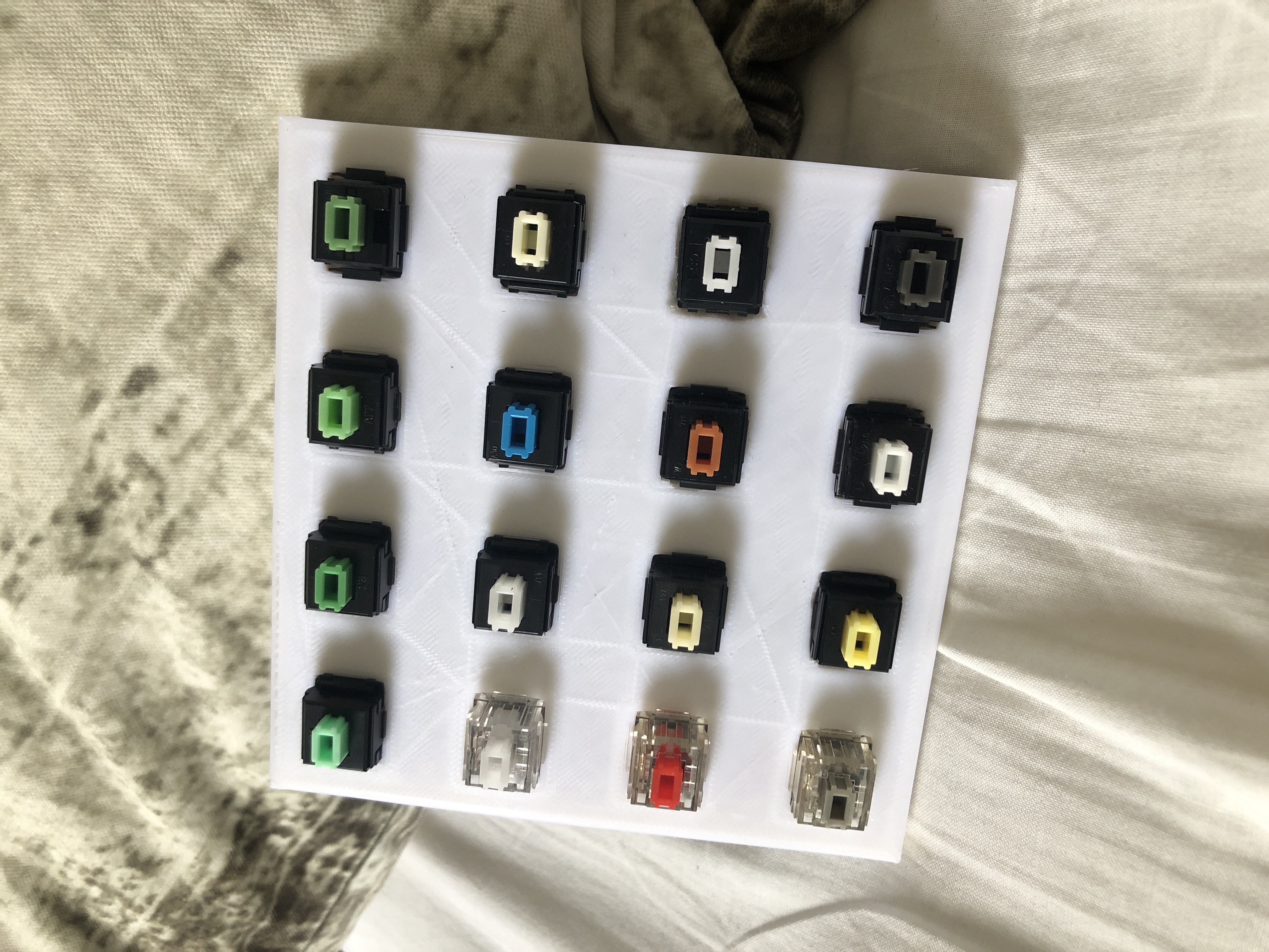

I finally filled it :)
there are a lot of clones but some real alps in there.
favourites so far by order: brown, blue's, oranges
