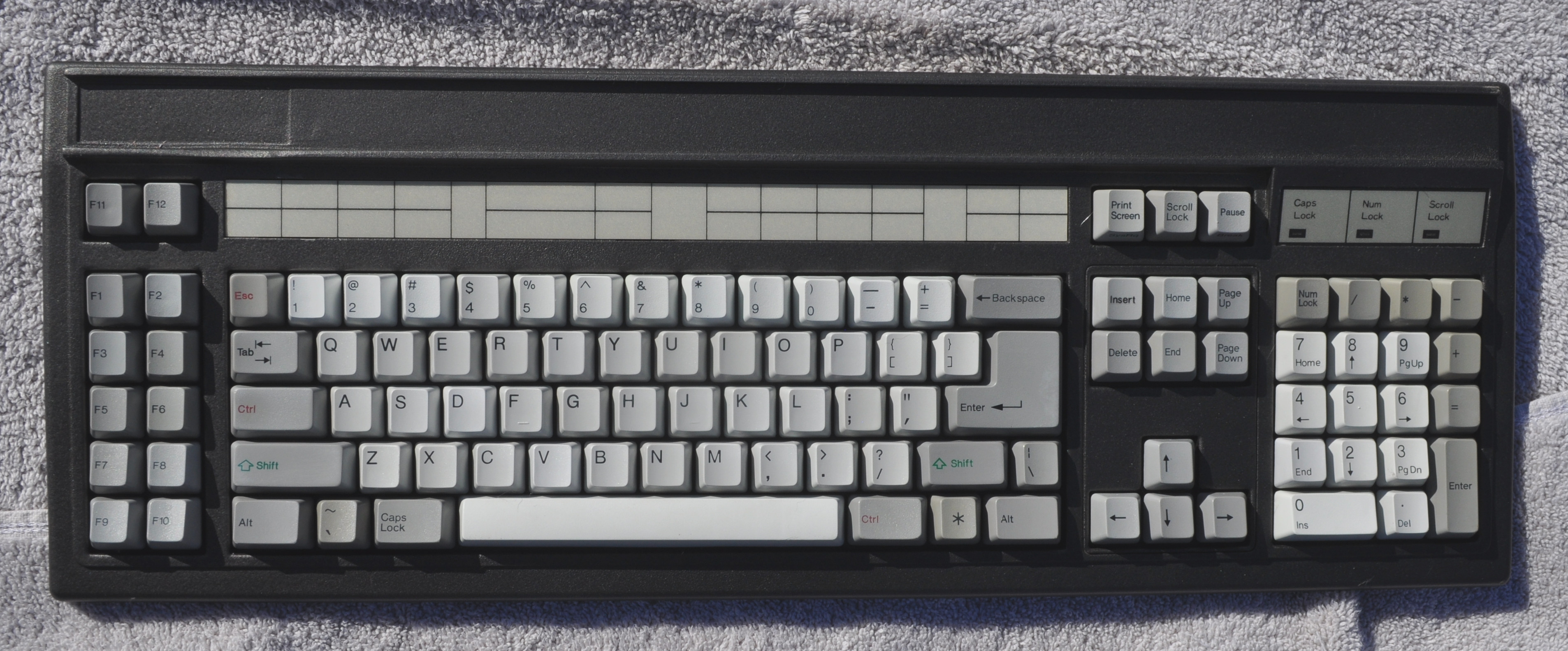

Keyboard: Northgate OmniKey. Same era as the "Gold Label" ones.
Paint: Rust-Oleum primer. Rust-Oleum Granite Grey. Rust-Oleum matte clear enamel finish.
I don't have a pic of the mounting plate, but it was painted with Rust-Oleum filler primer then finished with Behr Hammered Black.
Pics taken on an iPhone SE 2020, outdoors.

This is one from the lot of 6 OmniKeys that I bought about 2 years ago or so. All of them had significant rust (the reason for filler primer) and, in the case of this one, some rather bad cosmetic damage -- in addition to about an inch of human hair wrapped around the switches. Some of the keycaps were damaged, so while this keyboard has mostly Focus-branded-keyboard double-shot caps, I can't guarantee all of them are from OmniKeys. The switches are, though.
I retr0brighted the caps. Switches were ultrasoniced and boiled. Wax-boil mod. Lock light label was just masked, not removed, for painting.
Keyboard feels much better than I expected.

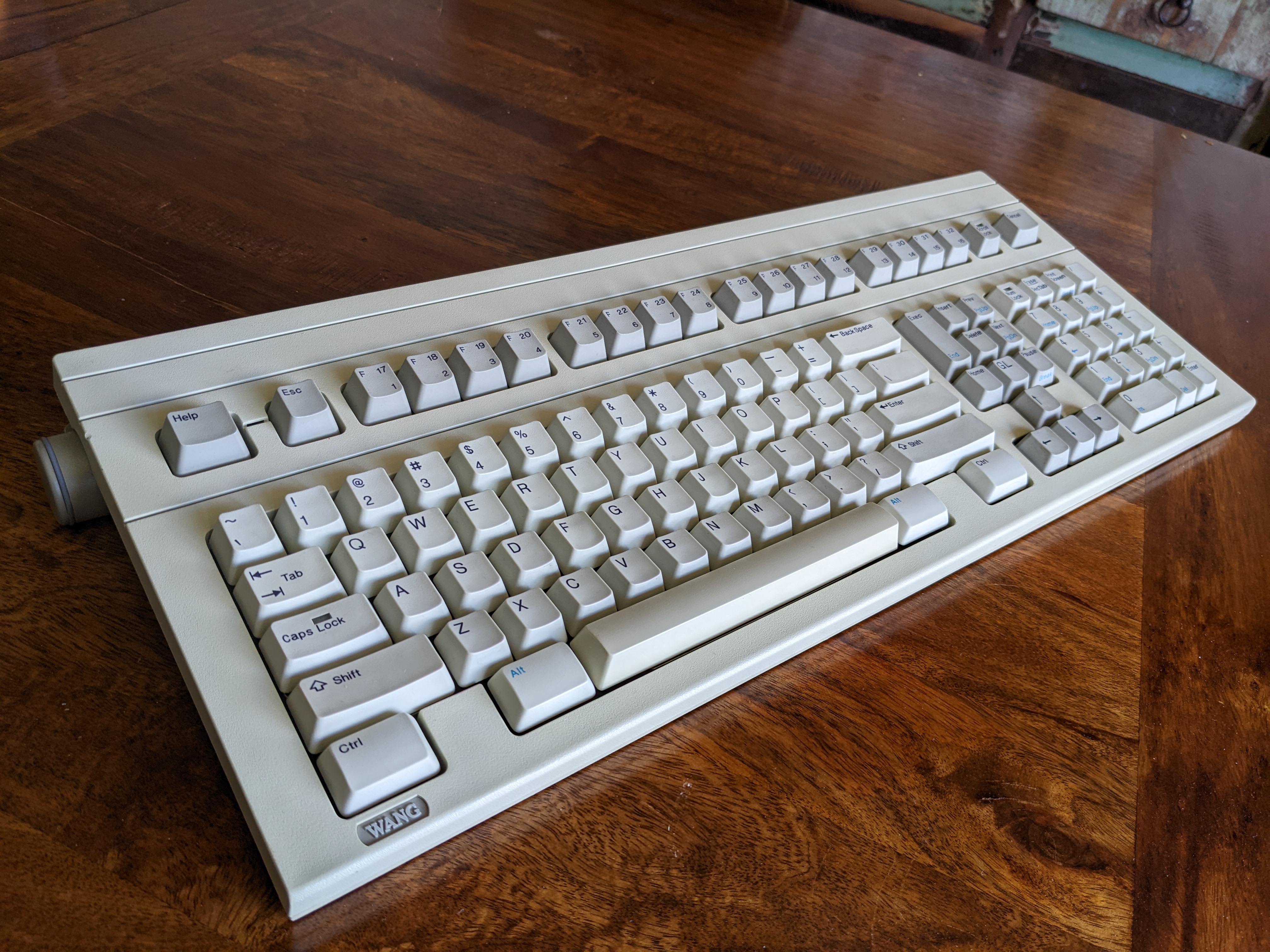

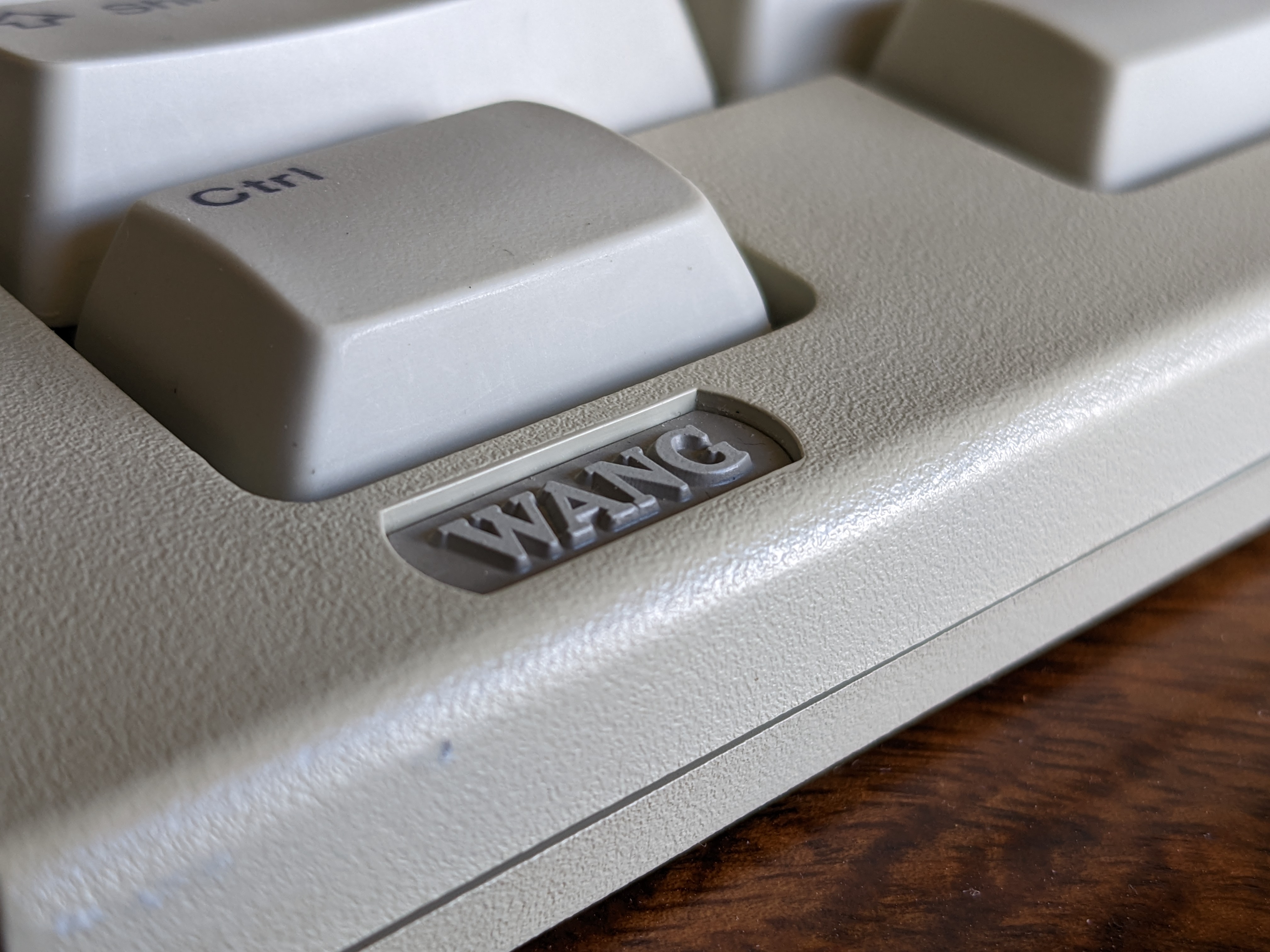

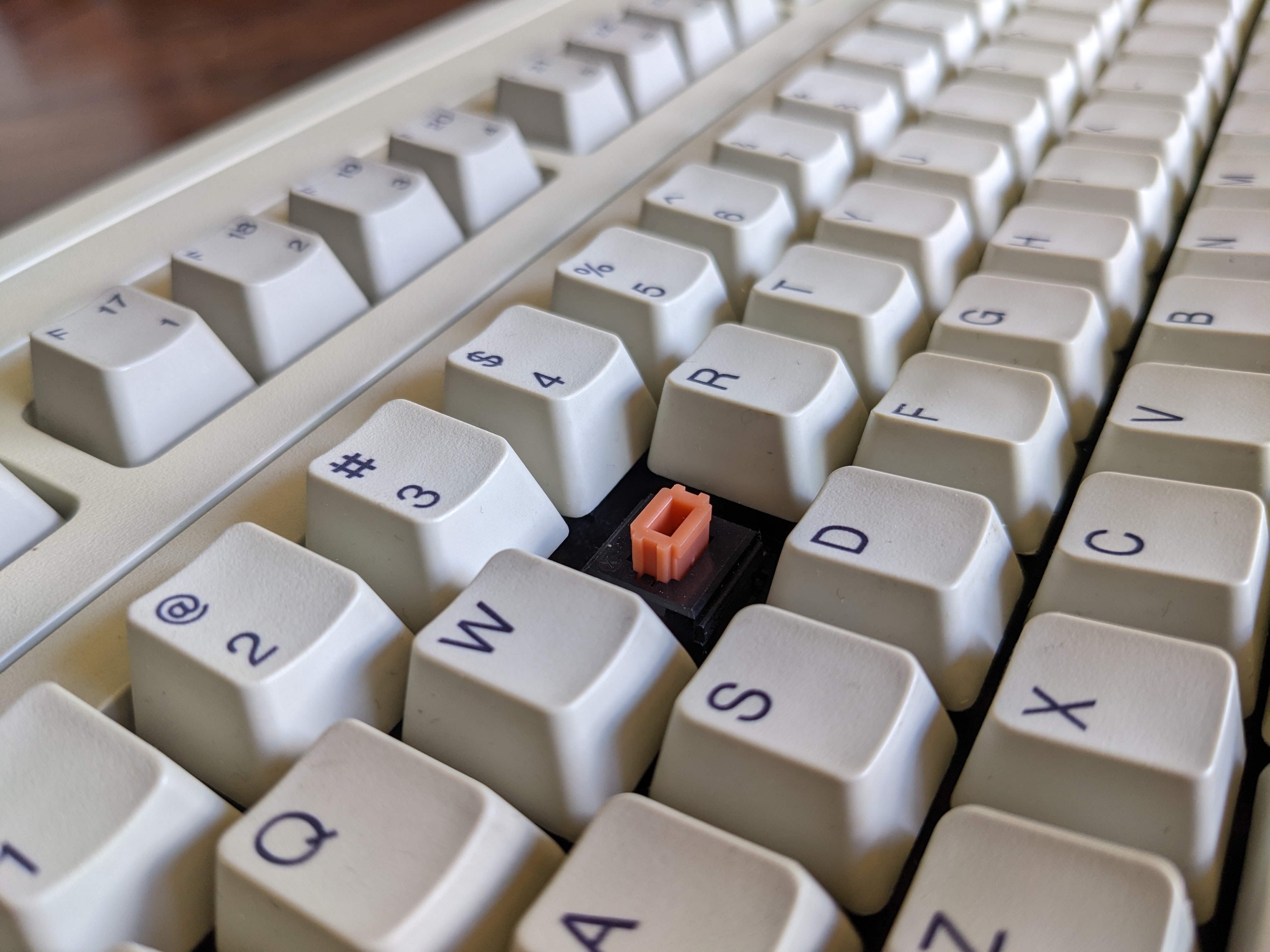

Finally got my hands around a big Wang!
Terrific condition.
I'm gonna do some hi res scans of the Word Perfect shortcut strips which I removed for aesthetic reasons.

Lucky you! :lol:
As far as Wangs go, that’s aye pretty.
I’m typing on newly acquired blue Alps just now, so I’m fair giddy too. ;)

Pretty decent Wang you got there! And with the best Alps Switches inside ;)

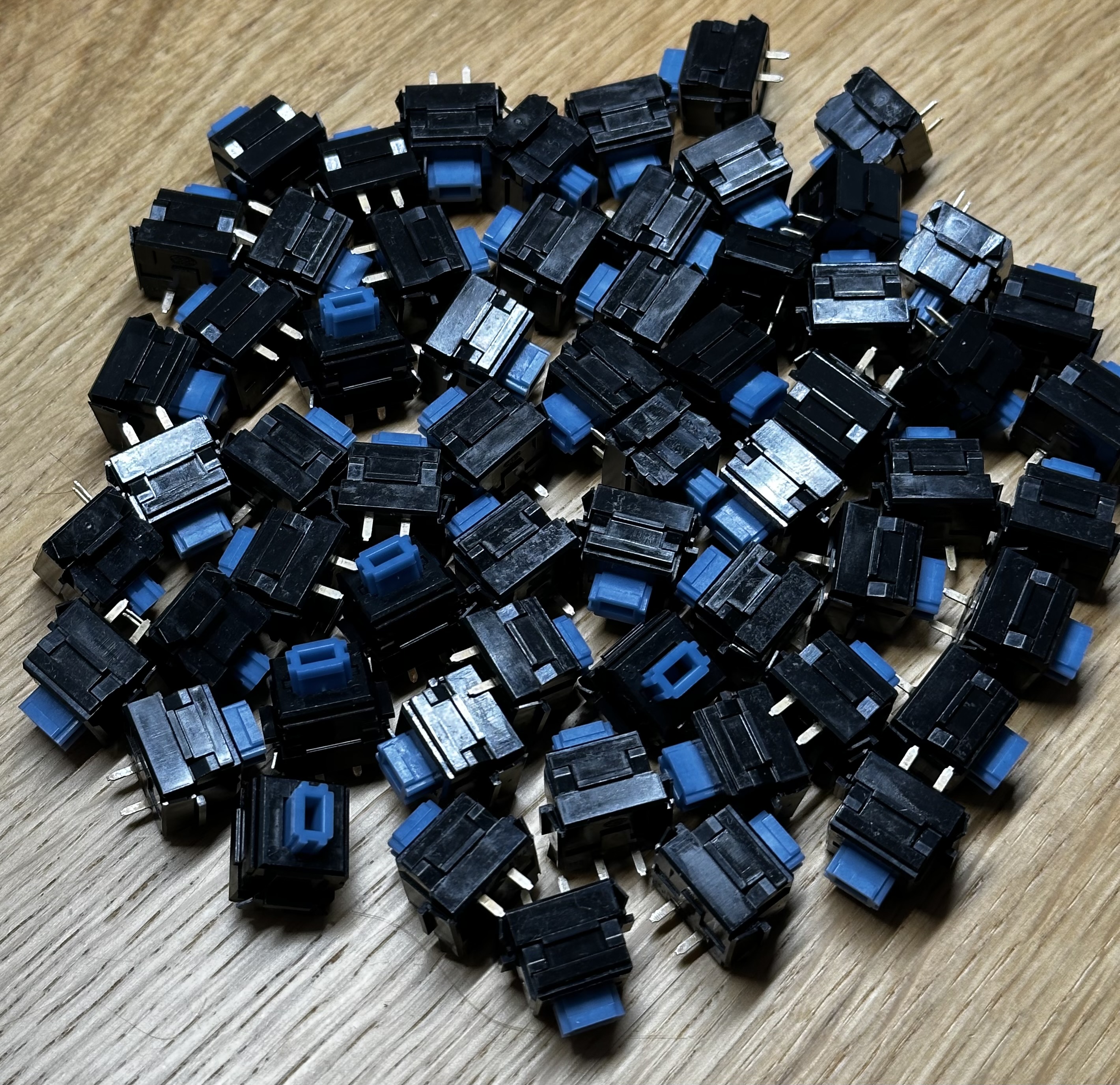

Just received a bunch of NOS Blue Alps. I have only compared them quickly with my heavily used but cleaned Blue Alps and the difference is there. To get a real world idea of how much this difference manifests I will solder them into a PCB and will also put the used switches into it for comparison. Will report back, once I have tested it more in depth.

We drool with jealousy.

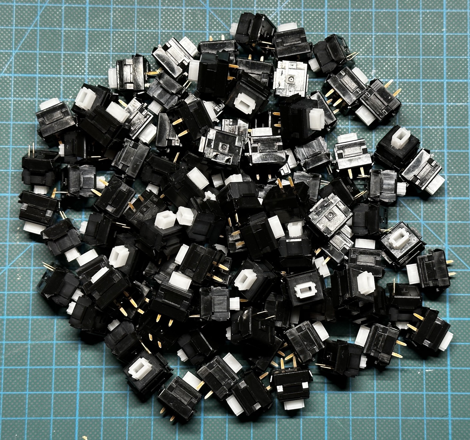

Just received a bunch of NOS White Alps. I couldn't find any Orange Alps so far, so if anybody has seen any NOS Orange, please let me know.
