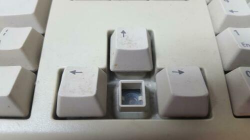

Anybody recognize this odd ball who use usb for plugging into a macintosh era imac g3 and use some alps style pin socket position ?
Re: IDENTIFY THE KEYSWITCH thread
Posted: 24 Apr 2021, 13:24
by Muirium
The halo and wings really takes those legends up to another plane…
