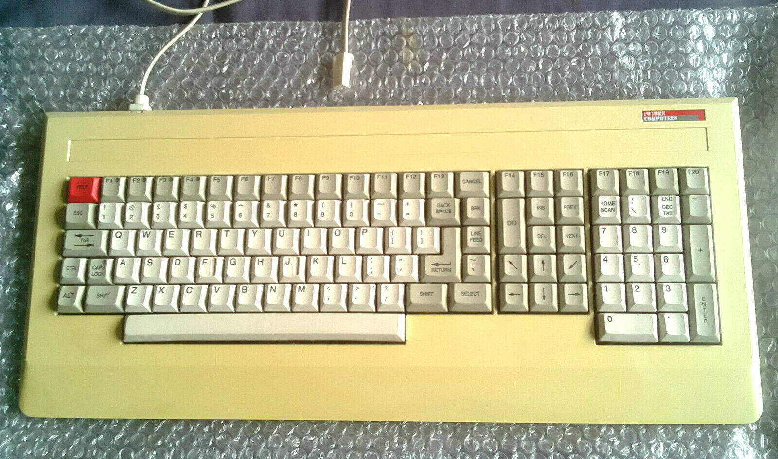

I recently bought this on ebay because it has ITW Magnetic Valves but other than that, there seems to be no information on it. The model is Future Computers FX30. Has anyone seen anything similar to this? I'm assuming it's a re-branded keyboard but I can't quite figure out which model.
22 Jun 2019, 14:44
Yeah, I've seen those before, but no rebrands as far as I'm aware.
Aran.E99
22 Jun 2019, 16:22
I guess I've seen seen the same model before then - it looks very familiar but I can't put my finger on it.

Regarding the Future FX-30: It arrived today so I took the back off to check the PCB for information. The rear side is branded with Cortron and the top side is branded Future Computers (GSK 8410). The bottom plastic (ABS) plate is what I can only describe as unnecessarily fucking thick. It measures 5mm at the thinnest point and about 6mm on the bottom and top lip... I'm still yet to find more information on it but I have a feeling that it is Cortron-made.

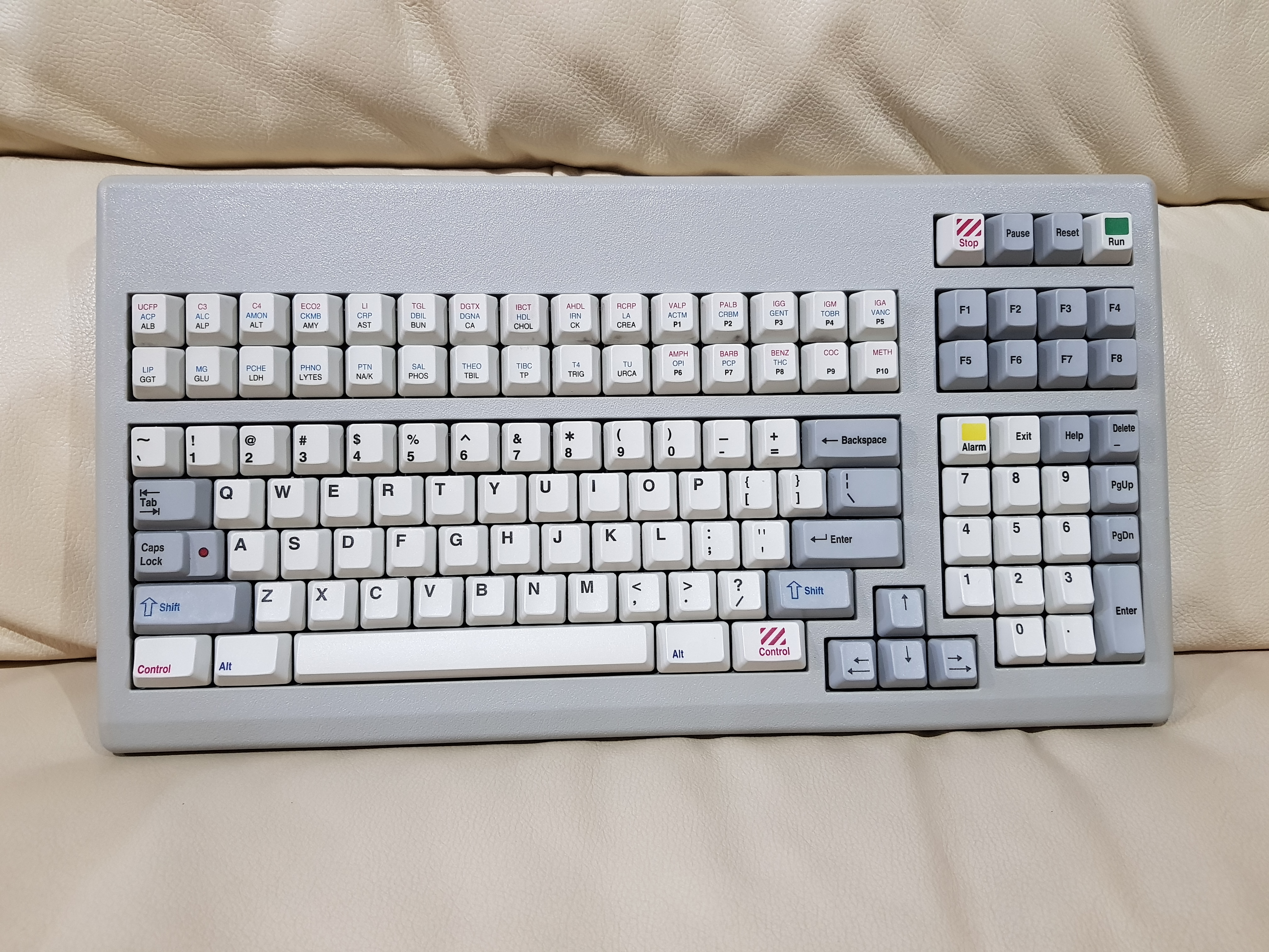

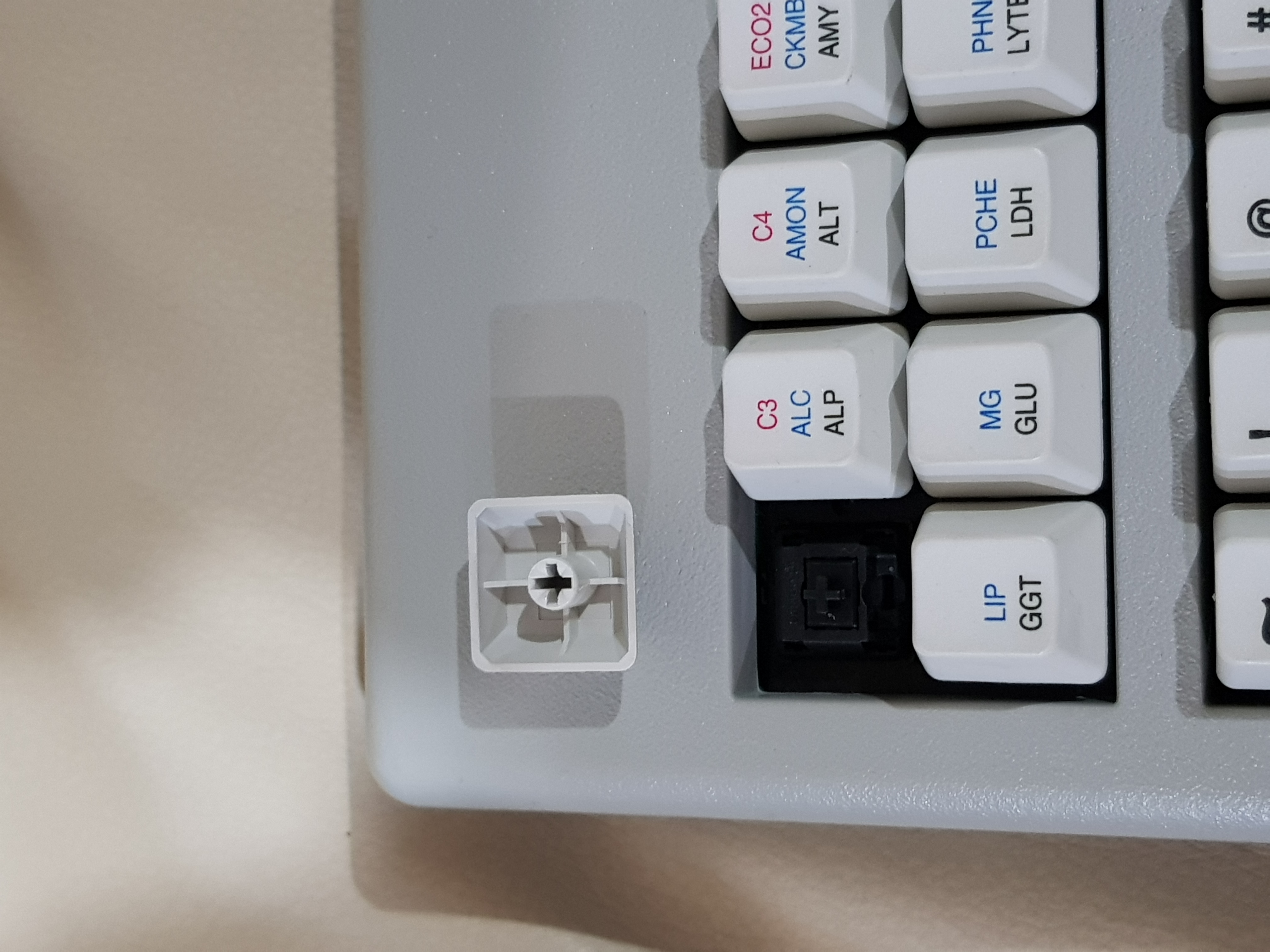

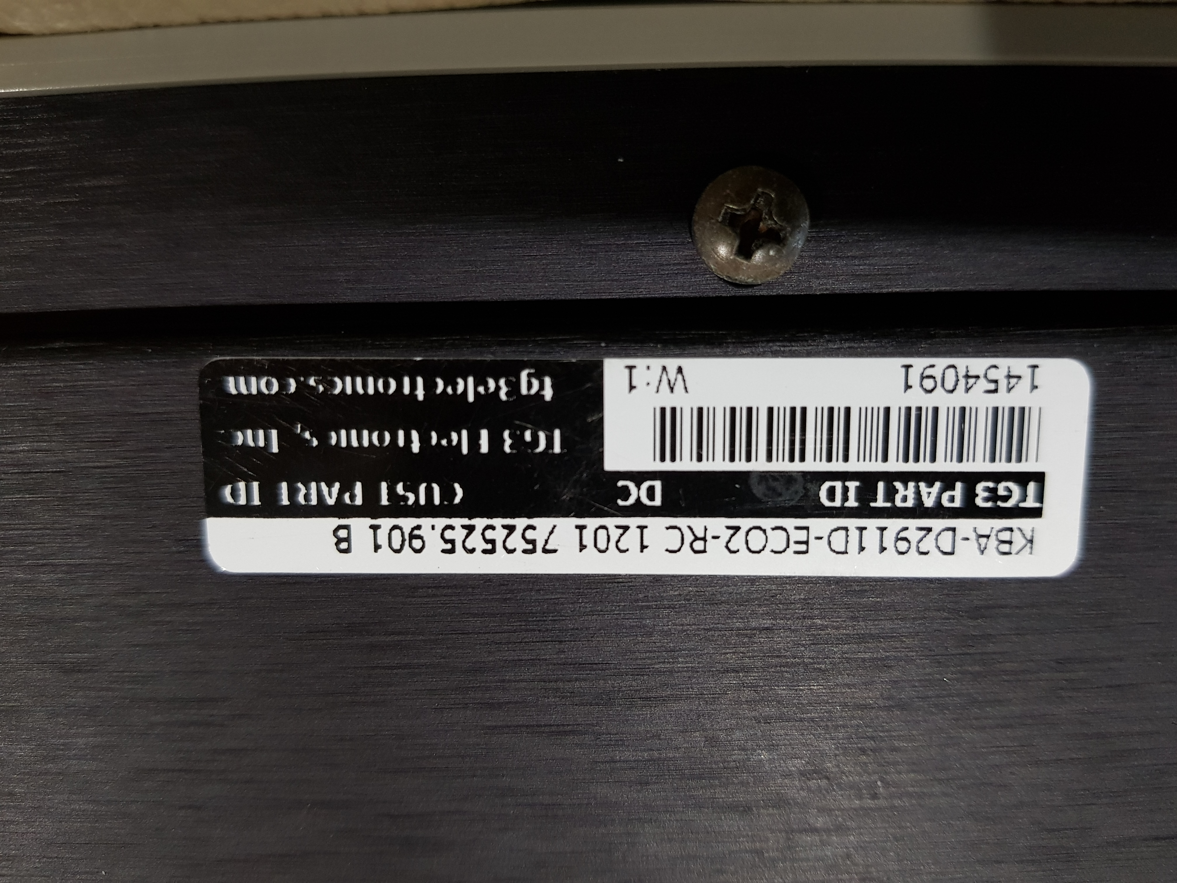

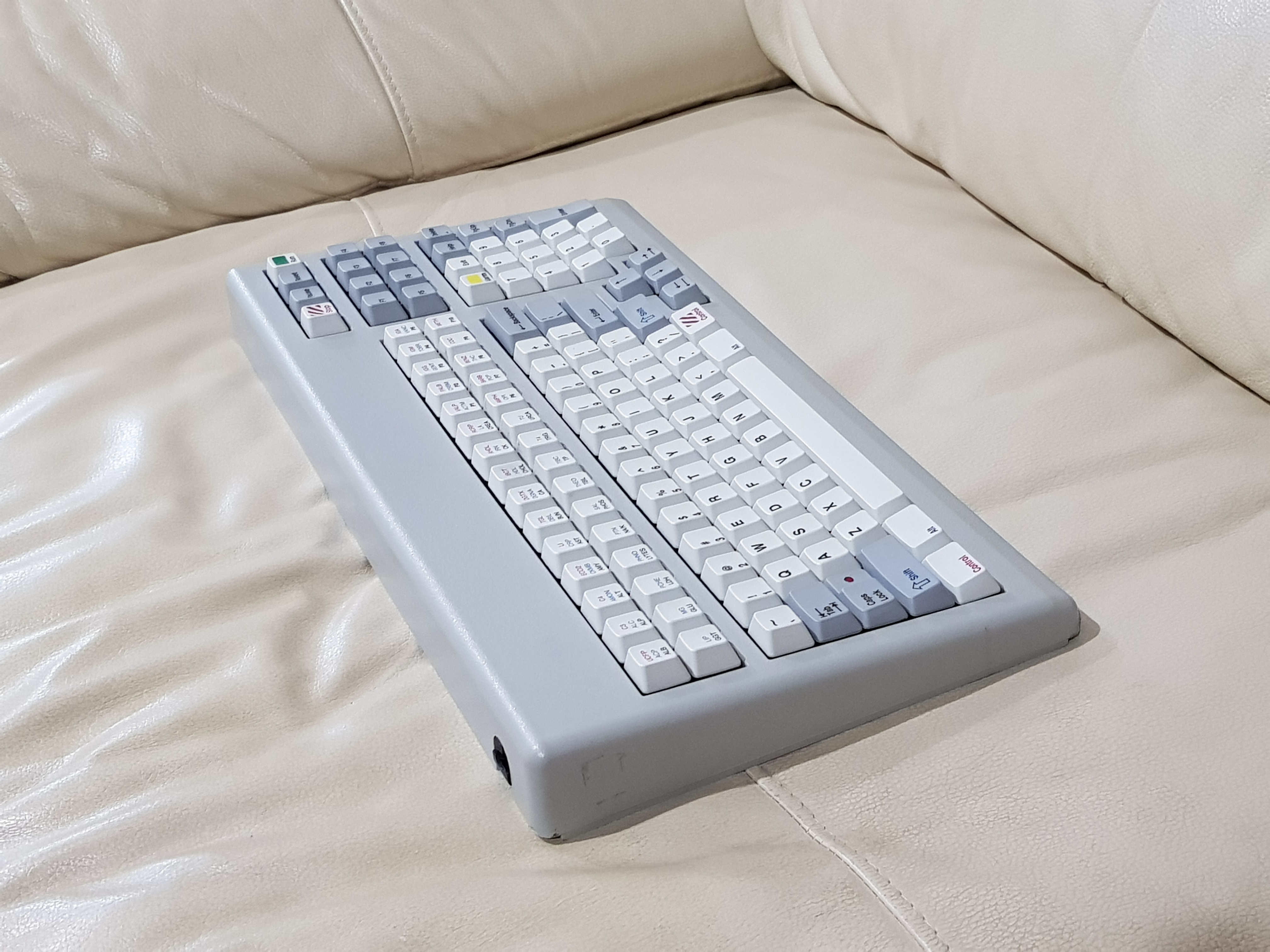

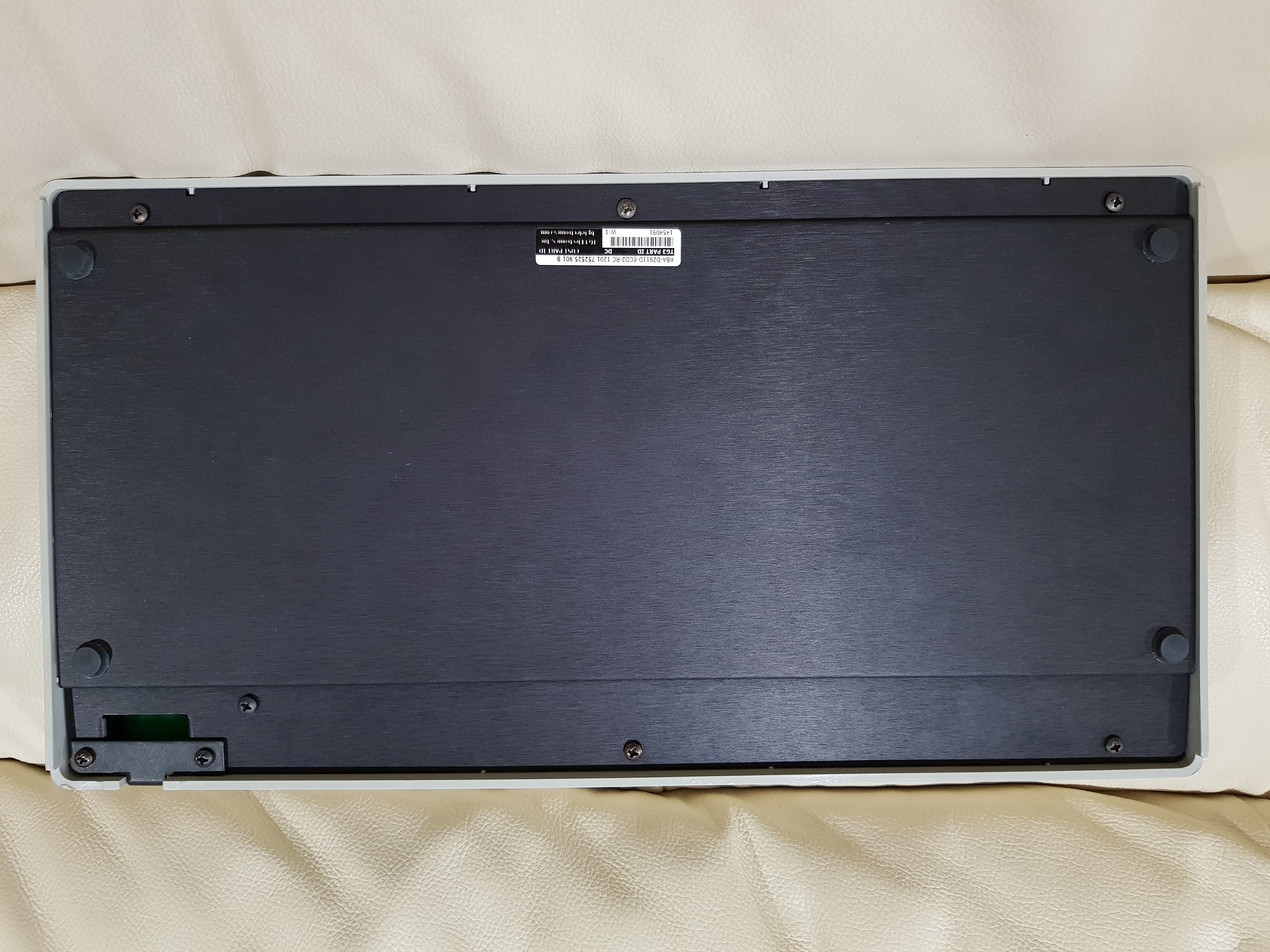

03 Jul 2019, 21:24

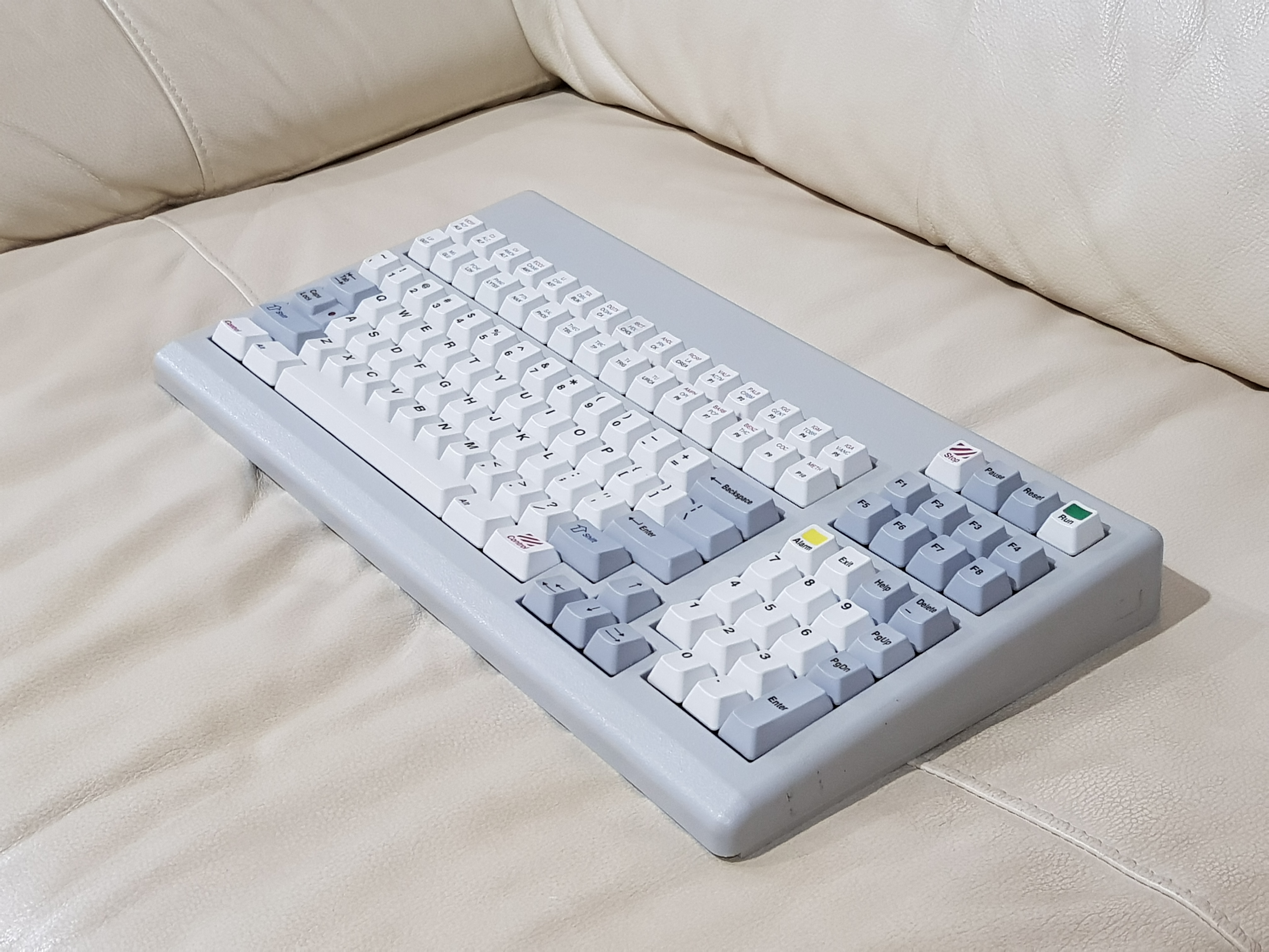

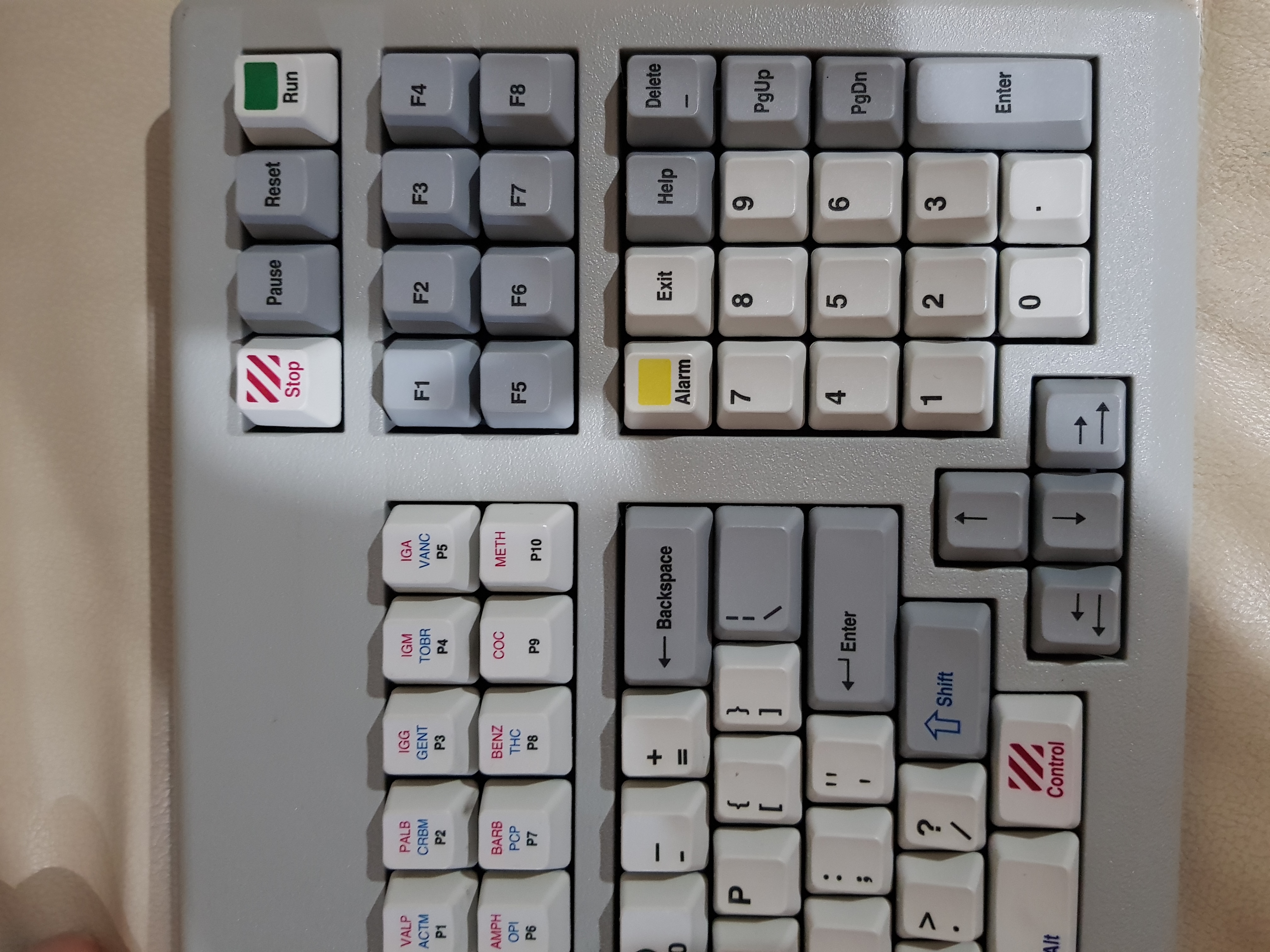

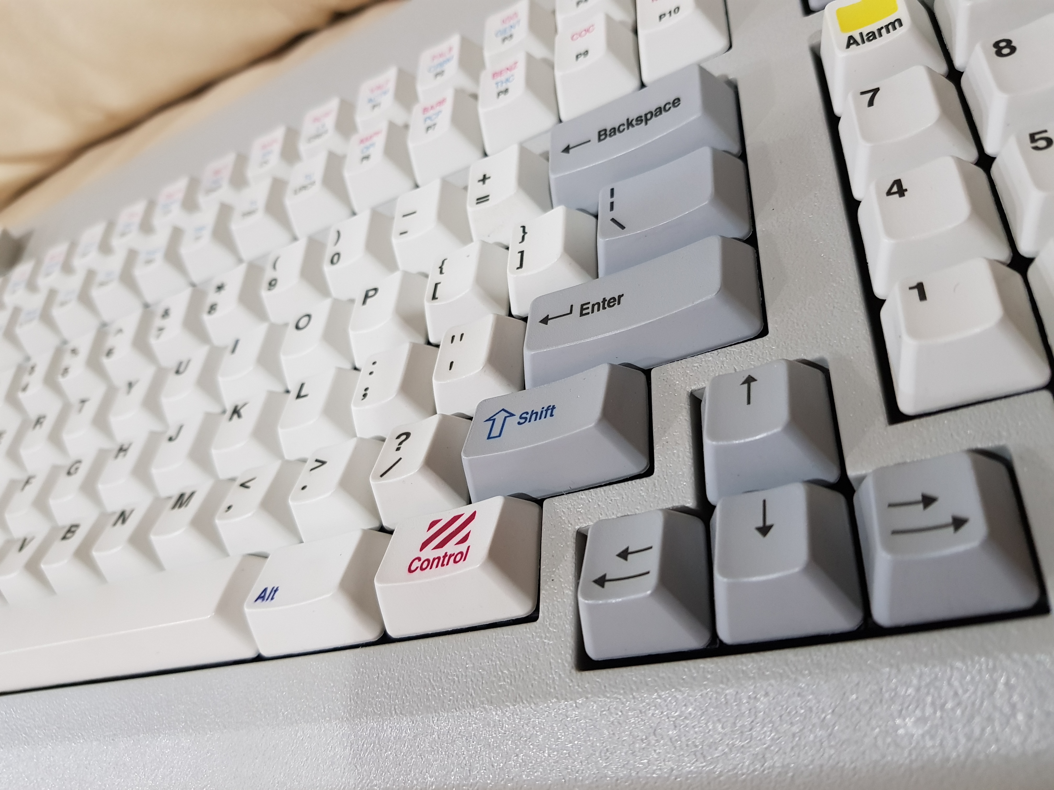

Just got my hands on this beauty. The previous owner said it had been kept in his home for ages, not sure where it came from exactly, but was probably attached to some kind of industrial machines that his family used to operate. Made by TG3 Electronics, switches are Cherry blacks, keycaps are dyesub pbt (or at least feels like pbt), cherry profile. It looks to me like some custom made keyboard for some machines (custom keyboards are part of TG3's service after all), but if anyone here can tell me anything more about it, like what sort of machines it could came from based on the legends, I'd really appreciate it :)
Myoth
03 Jul 2019, 21:55
They are DCS keycaps, from Signature Profile, so they're not Cherry profile.
I reckon they are keyboards from hospitals, as they feature multiple keycaps with molecules on it. Surely you can make out what COC, AMPH, METH, THC, OPI, PCP, etc ... no ? ... well .. maybe that means I shouldn't either :lol:
