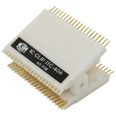

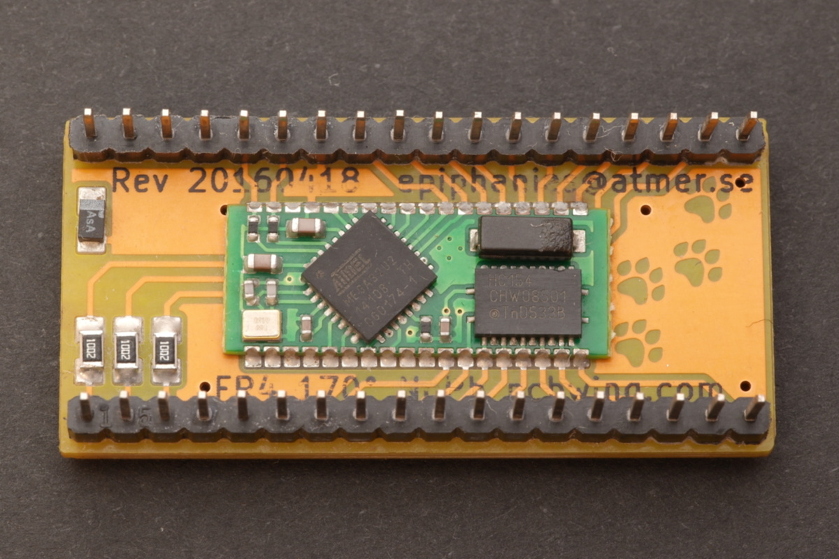

For what it's worth. Here it is, my latest masochistic mistake...
It does work, and with more practice assembly may be a smoother experience. I made more bad decisions on the board it goes onto, but those should be possible to correct. This one is a bit beat up from endless touching up...
Does anyone know if there are test clips like this with 1mm pitch? I should have known to stick with something imperial =P

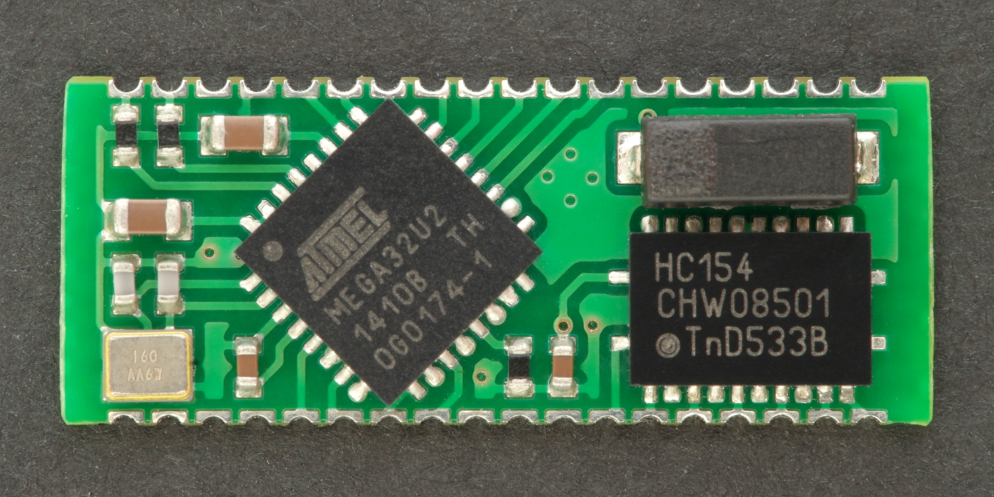

BTW I remembered now that the Chinese already have an atmega32u4 board, flat solderable onto a bigger PCB, with (I think) 1.27mm pads: Kimera Core. While great for a PCB project, I wouldn't want to solder wires to these pads directly. Solder bridges and cold joints galore...
