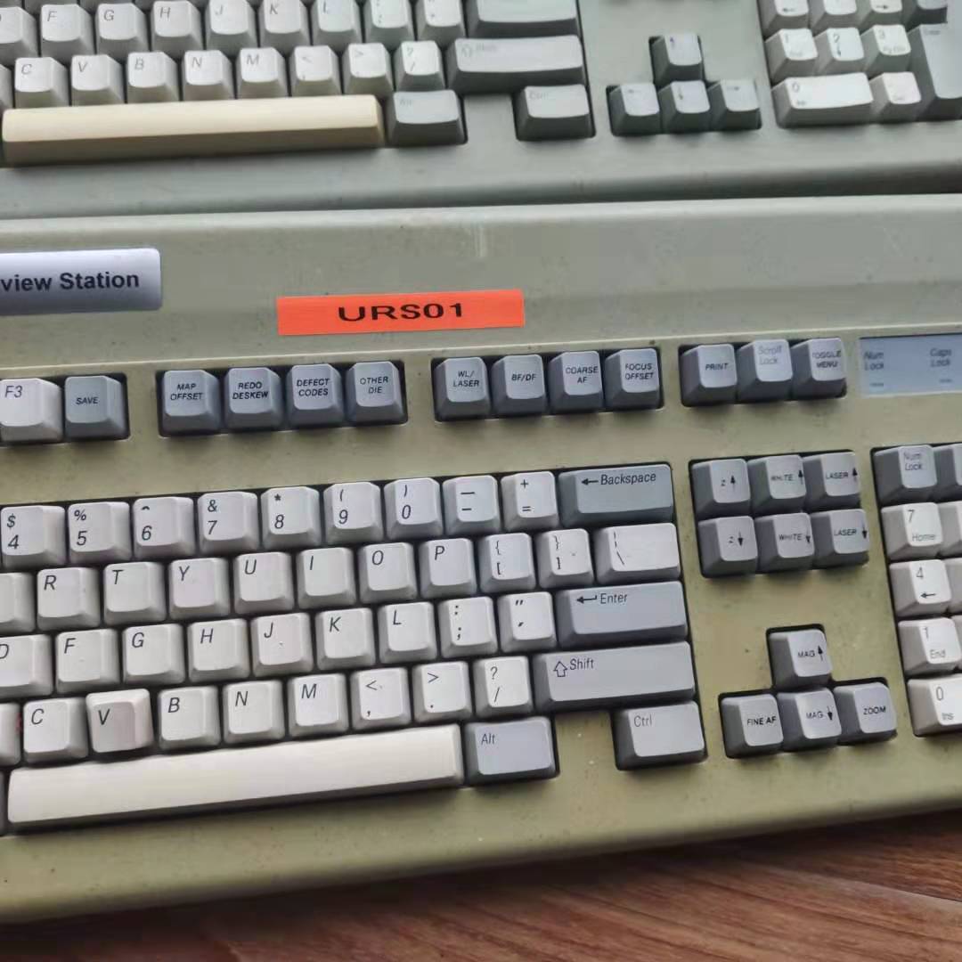

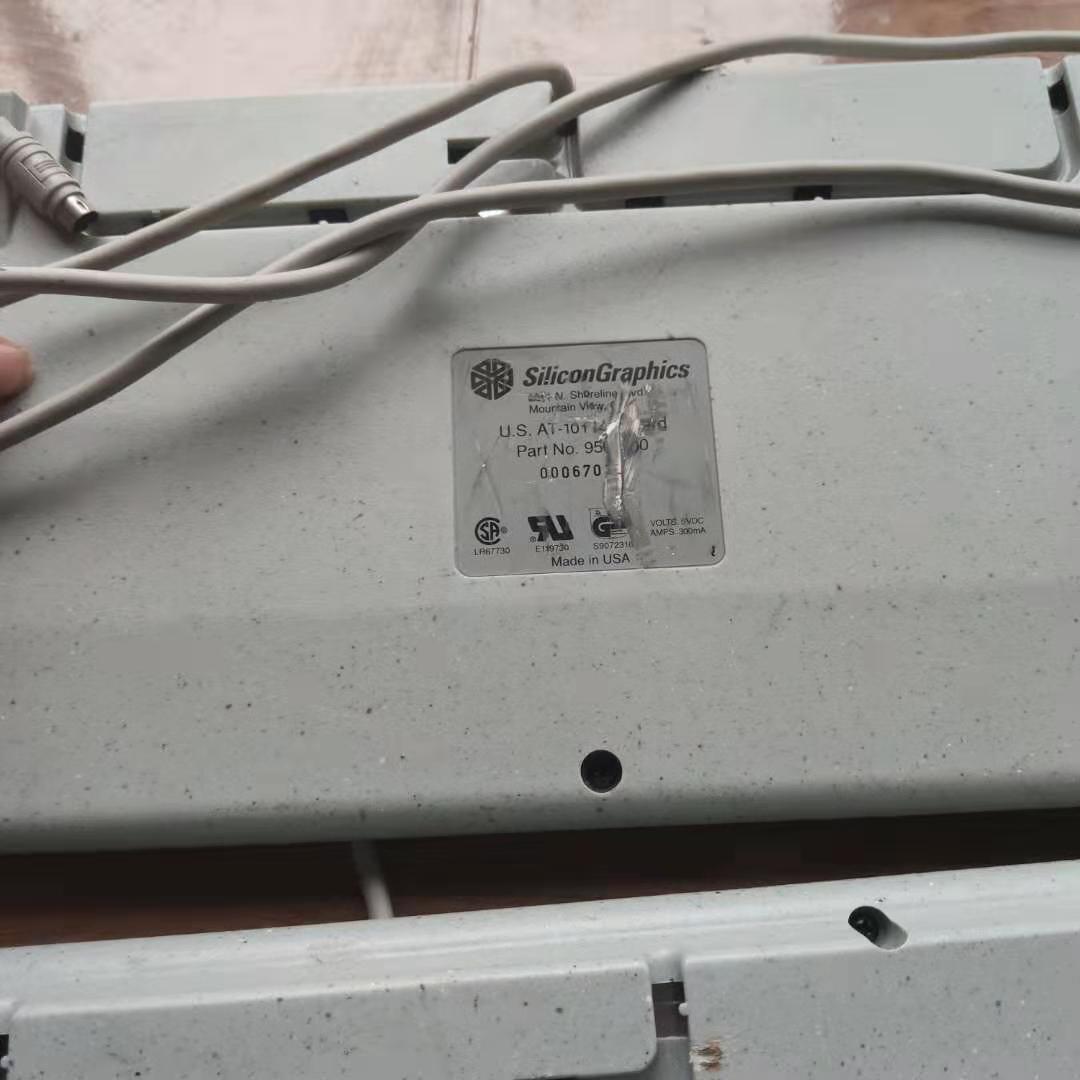

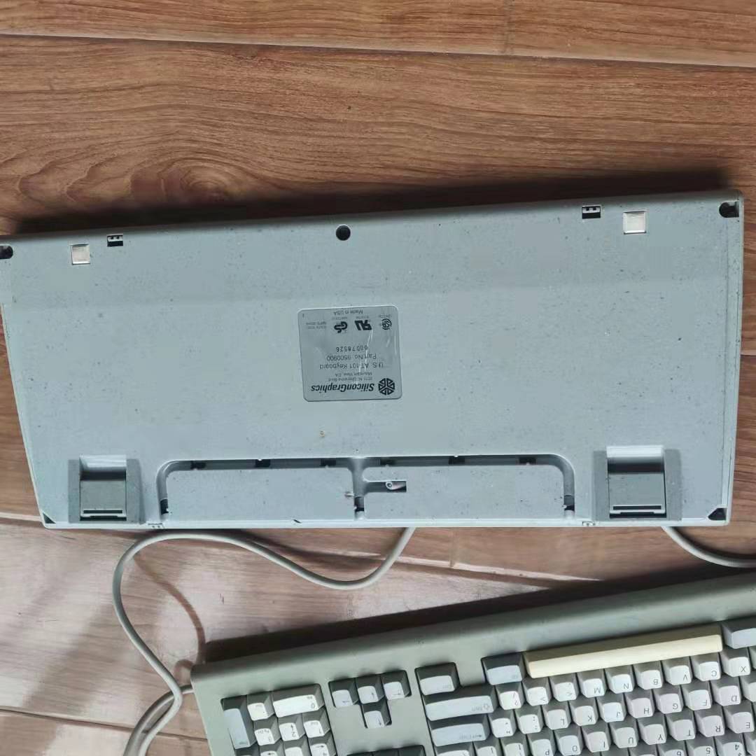

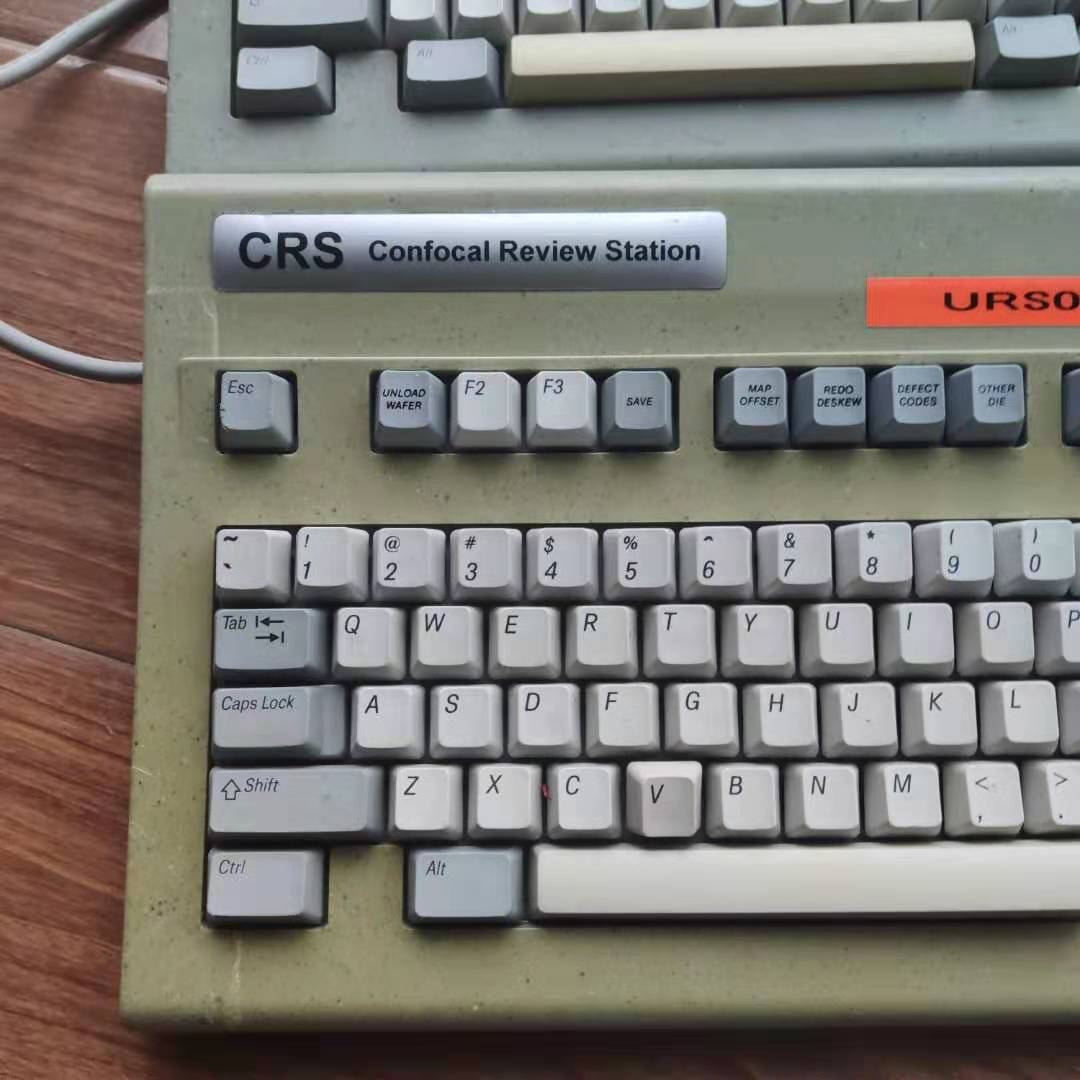

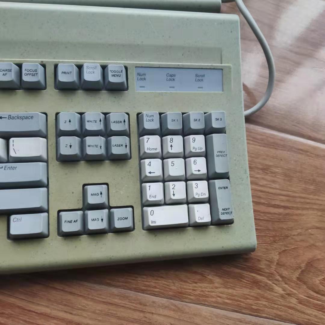

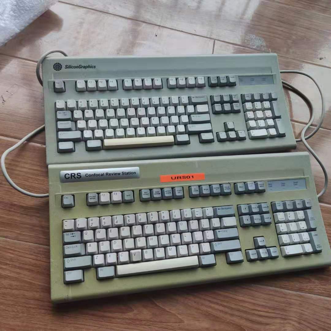

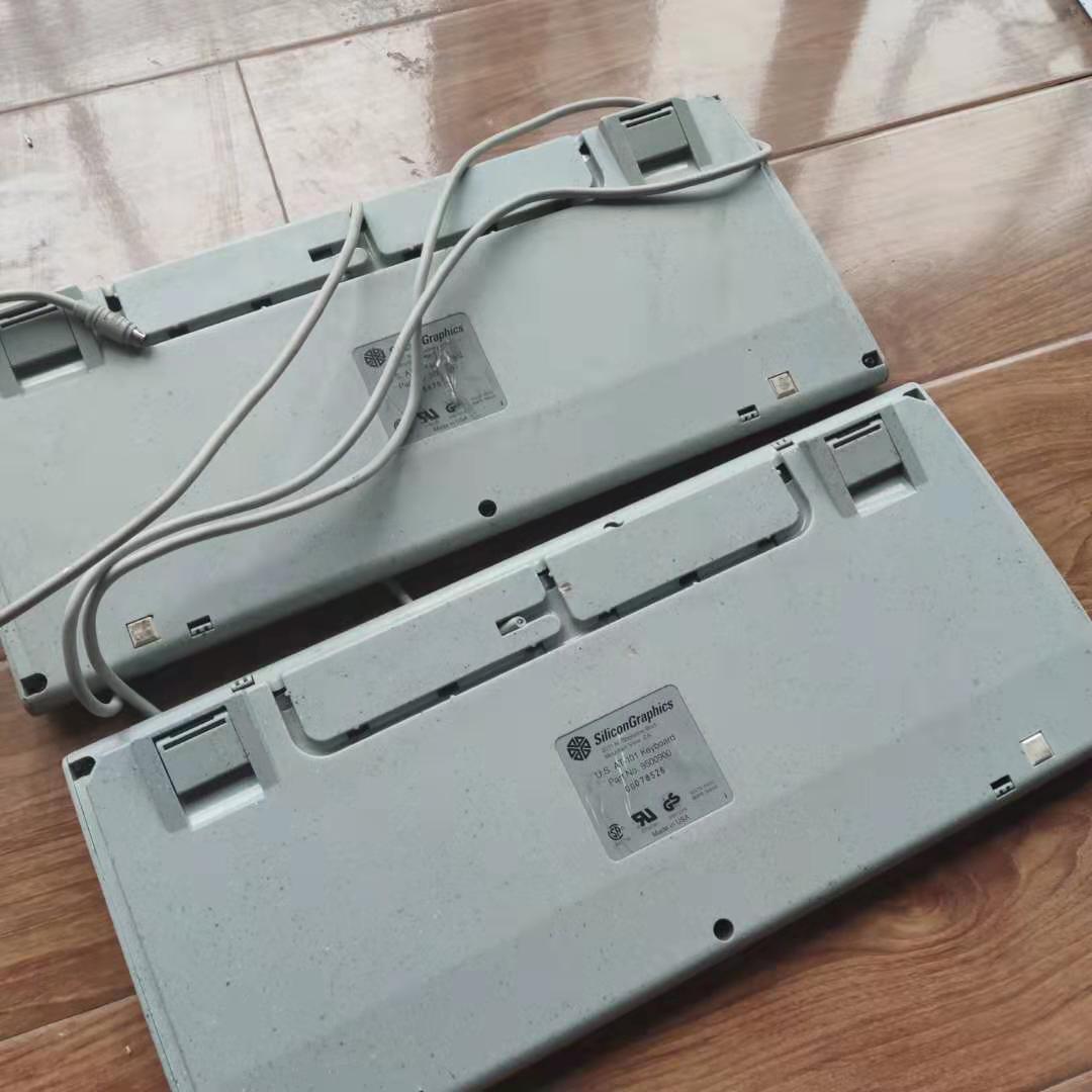

sgi crs keyboard,i got 2 sgi keyboards from Xianyu
- 微信图片_20200110171834.jpg (98.57 KiB) Viewed 12153 times
- 微信图片_20200110171830.jpg (119.39 KiB) Viewed 12153 times
- 微信图片_20200110171824.jpg (97.4 KiB) Viewed 12153 times
- 微信图片_20200110171821.jpg (111.22 KiB) Viewed 12153 times
- 微信图片_20200110171817.jpg (106.04 KiB) Viewed 12153 times
- 微信图片_20200110171813.jpg (103.69 KiB) Viewed 12153 times
- 微信图片_20200110171809.jpg (81.54 KiB) Viewed 12153 times

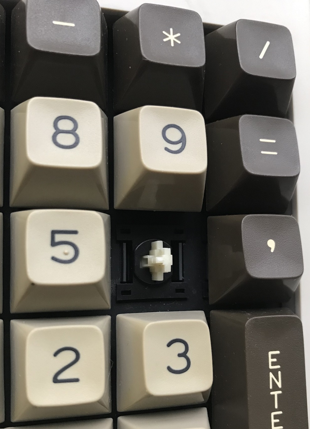

I found cool NTC keyboard NTC Kb-6551 EA with Alps SKCM White switches. (pine)

Bamboo SKCM WhiteNeK wrote: 12 Jan 2020, 01:45 Can anyone tell from this photo if the switch is ALPS (pine?) or a clone? It's a dark photo and turning up the levels in GIMP doesn't help.

Thanks. How did you spot it?

Nah, I'd not spend that kind of money on it, for what it is.
As for how I spotted it: I guess it's mostly just a lot of experience with Alps. When you get used to the differences between the two main types of top housings, it becomes a little trivial.
Basically, the slits are fairly obvious on pine, but bamboo can be misleading sometimes, so I understand the confusion. Another big tell for bamboo, is that, by that time, Alps started using mostly opaque white sliders whereas the old sliders were a bit translucent.
I'm sure you can easily tell which is which here.
