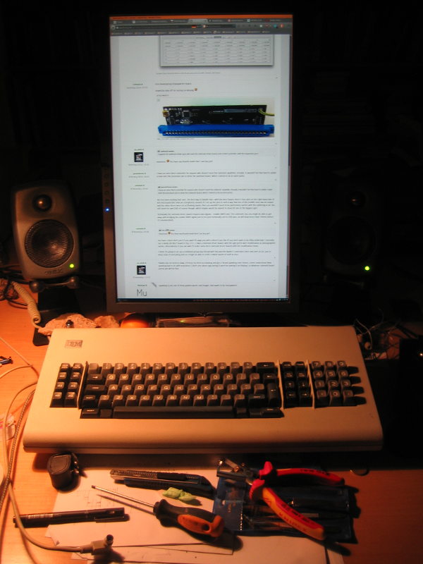

Posted: 11 May 2014, 02:08
by nourathar
xwhatsit wrote: Well done! One more beamspring dinosaur clunking away :D
And another one:
It being a rainy saturday afternoon, I finally got around to soldering the other two rev 3 boards I had the parts for, and putting one in my 3727. This time it was pretty painless; the soldering and uploading and configuring just worked ! The 3727 is even better to type on; it feels much more solid and high-quality, even though the 5251 doesn't exactly feel sloppy at all. I only have one key that sticks down once in a while (physically, that is), so that will be a good excuse to open it up (again).
Which leaves me one Rev 3 board, but am I right to think that I might be able to use that controller in my Kishsaver, using the new firmware and some creativity to connect the leads ?

Posted: 11 May 2014, 02:14
by xwhatsit
Nice job! I see you have a 5251 and a 3727—the 3727 is my favourite too, it just feels smoother and tighter somehow. I wonder if they're all like that?

by nourathar
xwhatsit wrote:Nice job! I see you have a 5251 and a 3727—the 3727 is my favourite too, it just feels smoother and tighter somehow. I wonder if they're all like that?
weird thing is that the keyboard mechanically looks very much the same between the 5251 and the 3727, and still it feels different..
xwhatsit wrote:Unfortunately it won't work in your Kishsaver—I had to start design a new board etc. for Model Fs (and also beamspring displaywriters). This is because the Model Fs and Displaywriters have a 16x8 matrix instead of a 23x4. So you need double the analogue stuff (so an extra LM339 and all the associated stuff).
If you want a Model F board I'm about to put up all the details regarding that today hopefully (well, once the lawns are mowed and I've fitted a new clutch cable and....), with links to the board on OSHPark and a proper BOM.
ok, apologies for not following that thread better; i'll order that new board once it's up on OSHPark, I guess i'll have most of the parts still anyway..
and..
thanks again for doing this !
