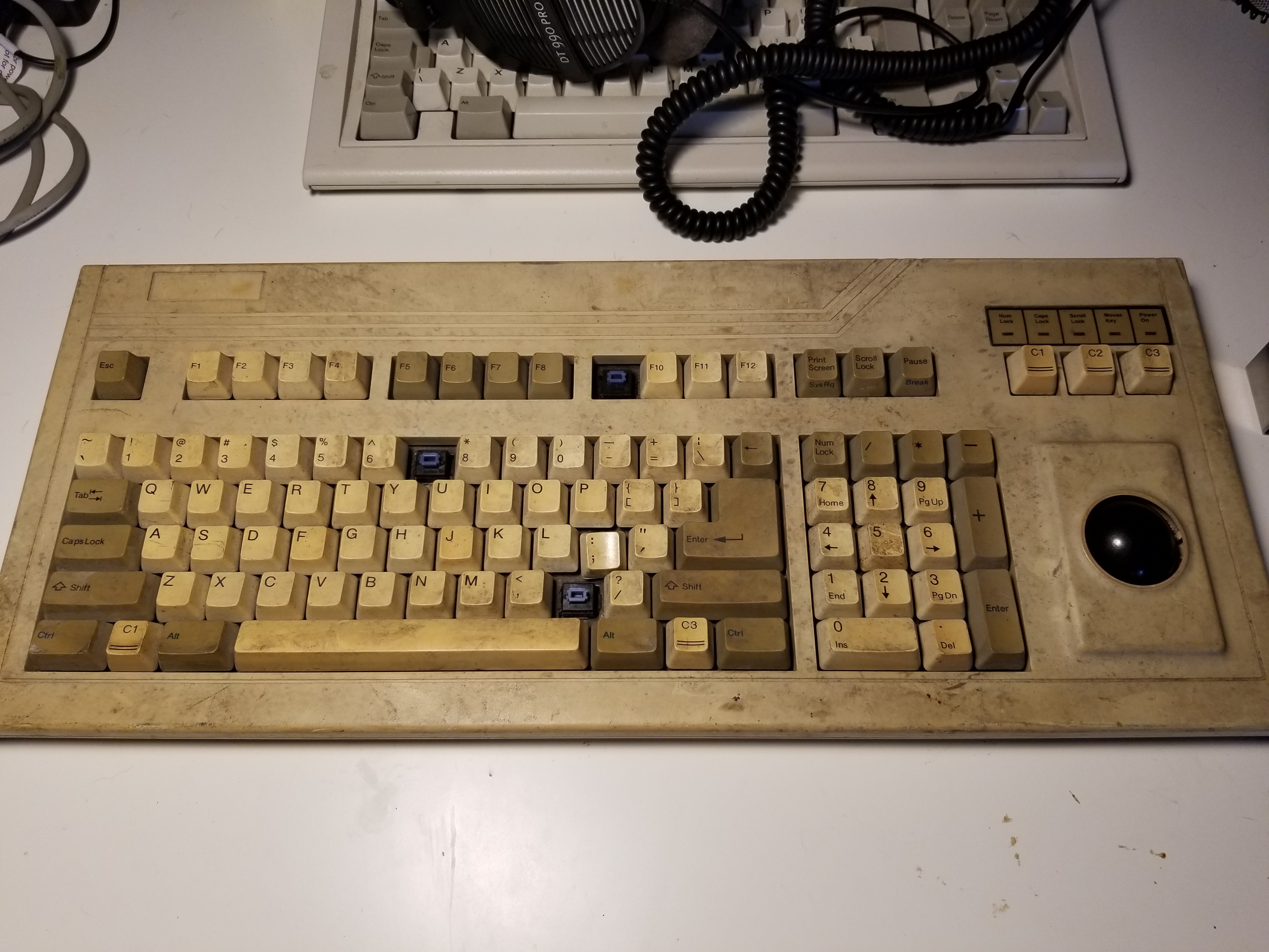

Pretty cool SKCM Blue keyboard in a compact F77-like asian layout with an integrated trackball(similar to the Rabbit 286 with blue alps minus the trackball). Despite it's dirt and mucked up case and keycaps, the internals are surprisingly clean and it feels nice(not great) and consistent enough to type on without wanting to slam this keyboard into another dimension. The implementation of the trackball isn't ideal(sits on top of a sensor but isn't locked down well). It has macro keys above the trackball, which I assume are the "mouse key" that are shown in the lock lights. Also doesnt have blockers like on most keyboards of this era(wkl) but instead has another set of macro keys. Don't know if I have the time to do a full restore(cut cable), so if anyone wants to tackle this project let me know and I can give more info.

When I saw the photo I got excited and thought for a second Zeal was releasing their own Alps clones.waldorf120 wrote: 21 Aug 2019, 20:39 I dub thee "Nexios"! Nexus sliders in Matias housings with respective springs and leaves. They are super tactile although the click leaves don't always click in them. Some of the nexus sliders are too big for some of the Matias top housings, the tolerance is really tight, but most fit well and the lubricant that Matias includes with their switches helps to keep the sliders moving smoothly. The top housings do have to be filed but only slightly, it probably takes about 20 seconds per housing to get them large enough to accept cruciform mount caps. I tested with Signature Plastics SA and GMK caps. Of note I found that I did not have to shave the stems of these to avoid breaking the SP or GMK caps. I used Nuclear Data and Terminal respectively.
Then again they would probably be $5.00 a piece or something if that were the case.

I'm honored my work was good enough to be mistaken for Zeal's!abrahamstechnology wrote: 24 Aug 2019, 05:17When I saw the photo I got excited and thought for a second Zeal was releasing their own Alps clones.waldorf120 wrote: 21 Aug 2019, 20:39 I dub thee "Nexios"! Nexus sliders in Matias housings with respective springs and leaves. They are super tactile although the click leaves don't always click in them. Some of the nexus sliders are too big for some of the Matias top housings, the tolerance is really tight, but most fit well and the lubricant that Matias includes with their switches helps to keep the sliders moving smoothly. The top housings do have to be filed but only slightly, it probably takes about 20 seconds per housing to get them large enough to accept cruciform mount caps. I tested with Signature Plastics SA and GMK caps. Of note I found that I did not have to shave the stems of these to avoid breaking the SP or GMK caps. I used Nuclear Data and Terminal respectively.

Haha dmn yours does have blue Alps xD . I gambled on a NOS one of those a while ago but it turned out to have Alps clones. Not sure which ones off the top of my head but they're actually surprisingly good. Congrats on your SKCMAG find though!Guchay wrote: 24 Aug 2019, 02:37 Pretty cool SKCM Blue keyboard in a compact F77-like asian layout with an integrated trackball(similar to the Rabbit 286 with blue alps minus the trackball). Despite it's dirt and mucked up case and keycaps, the internals are surprisingly clean and it feels nice(not great) and consistent enough to type on without wanting to slam this keyboard into another dimension. The implementation of the trackball isn't ideal(sits on top of a sensor but isn't locked down well). It has macro keys above the trackball, which I assume are the "mouse key" that are shown in the lock lights. Also doesnt have blockers like on most keyboards of this era(wkl) but instead has another set of macro keys. Don't know if I have the time to do a full restore(cut cable), so if anyone wants to tackle this project let me know and I can give more info.

This appears to be a keytrak. Shame it's not the oddball one with the FAME-style Cherry profile keycaps. Nice find though! Very surprising that it feels as good as it does for you, but I've been host to boards that have looked better but felt worse as well as boards that have looked worse but felt great. Nice.Guchay wrote: 24 Aug 2019, 02:37 Pretty cool SKCM Blue keyboard in a compact F77-like asian layout with an integrated trackball(similar to the Rabbit 286 with blue alps minus the trackball). Despite it's dirt and mucked up case and keycaps, the internals are surprisingly clean and it feels nice(not great) and consistent enough to type on without wanting to slam this keyboard into another dimension. The implementation of the trackball isn't ideal(sits on top of a sensor but isn't locked down well). It has macro keys above the trackball, which I assume are the "mouse key" that are shown in the lock lights. Also doesnt have blockers like on most keyboards of this era(wkl) but instead has another set of macro keys. Don't know if I have the time to do a full restore(cut cable), so if anyone wants to tackle this project let me know and I can give more info.
Certainly a quirky keyboard that isn't quite my cup of tea, mainly because of the trackball implementation. If I had it, I'd likely hand it over to someone who could appreciate it more, salvage the blues from it for a project (not really into building with blues as much as I am having vintage blue alps boards anyway), or salvage the caps if they were Cherry profile.
