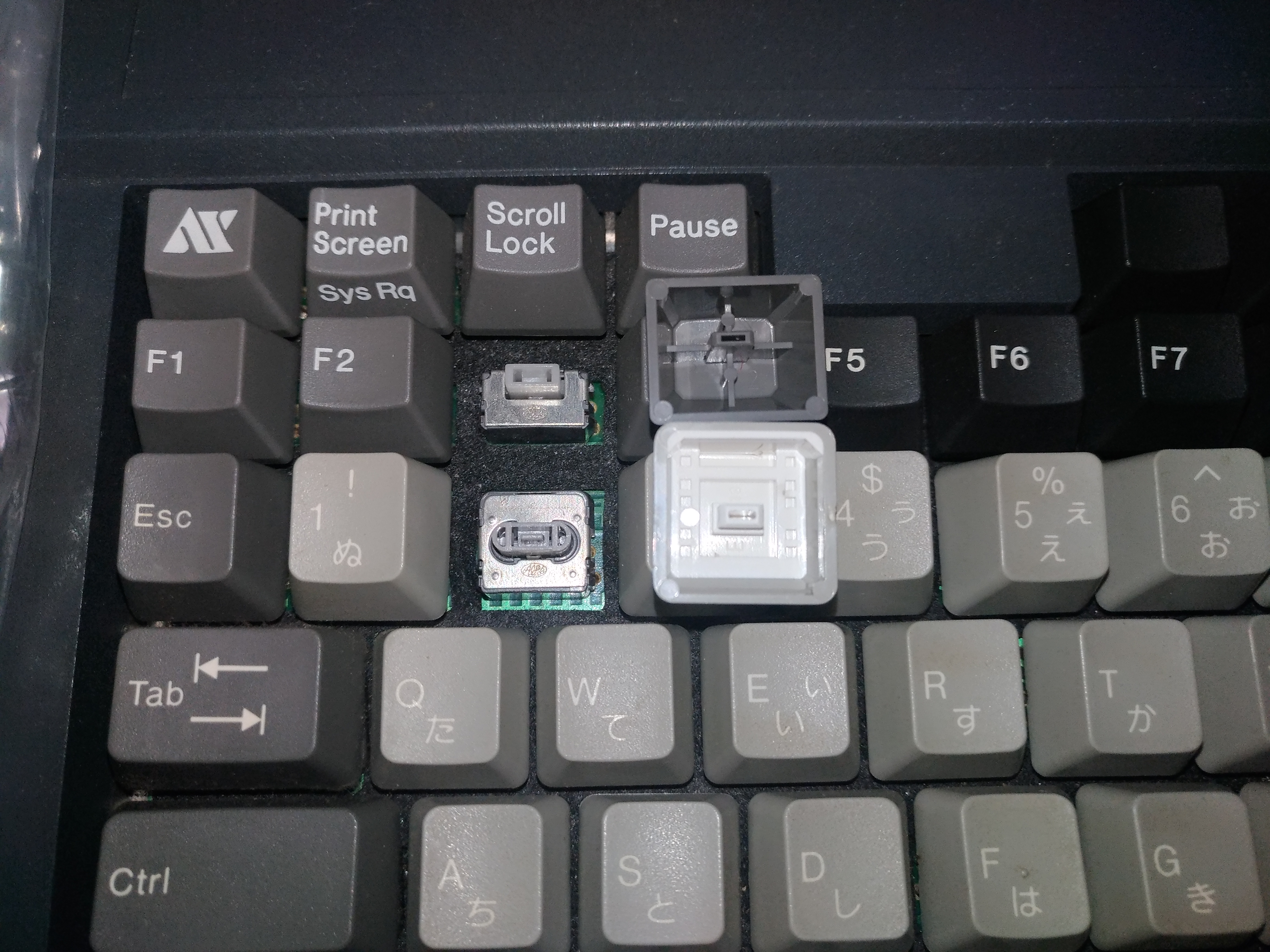

Last buy, future keeb build. :)
I also looking for somebody who gonna help me with convert that keeb to usb (i have empty module of that keeb so pc not gonna be useless)

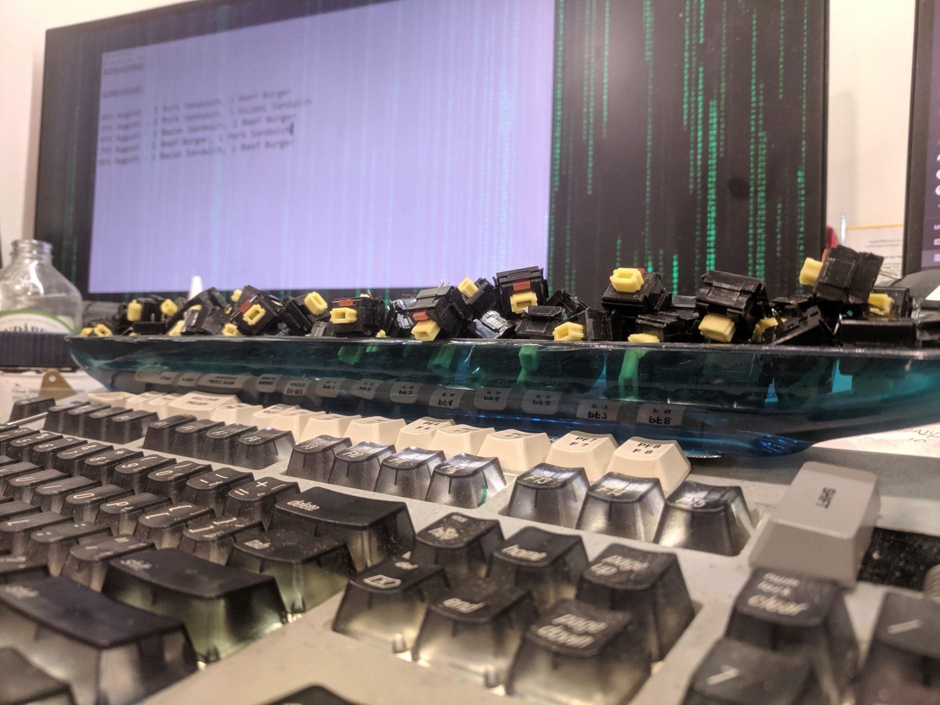

I've disasembed all of my orange alps with help from chyros (thanks btw :D) while I'm waiting for my ultrasonic cleaner to be delivered. I was wondering what I should put in the ultra sonic cleaner. I have read that you should not clean the sliders because it takes off the factory lube, but I cannot see any on them right now. I alps bought some dupont dry lube. Should I use that? I've read really mixed reviews with lubrication on alps. should I clean the springs or the tactile leaves?

Rezene wrote: 05 Aug 2019, 04:48 I've disasembed all of my orange alps with help from chyros (thanks btw :D) while I'm waiting for my ultrasonic cleaner to be delivered. I was wondering what I should put in the ultra sonic cleaner. I have read that you should not clean the sliders because it takes off the factory lube, but I cannot see any on them right now. I alps bought some dupont dry lube. Should I use that? I've read really mixed reviews with lubrication on alps. should I clean the springs or the tactile leaves?
I'm doing an experimental piece on Alps lubrication exactly to try and prove or disprove what does and doesn't work. I've got it scheduled for late september though, so it'll be a little while longer.
In the meantime what I CAN tell you is that if you sonicate anything, be sure to at least END with a good rinse of deionised water. Most people just sonicate in it to begin with, or use something like Decon.

Chyros wrote: 05 Aug 2019, 10:35
Should I put anything else in the sonicator like soaps or leave it just water
Re: Alps Appreciation
Posted: 05 Aug 2019, 16:00
by Chyros
Rezene wrote: 05 Aug 2019, 15:51
You can use slightly soapy water if you want, just leave it in the inside container (don't put it in the bath). Just don't forget to rinse thoroughly with deionised afterwards.

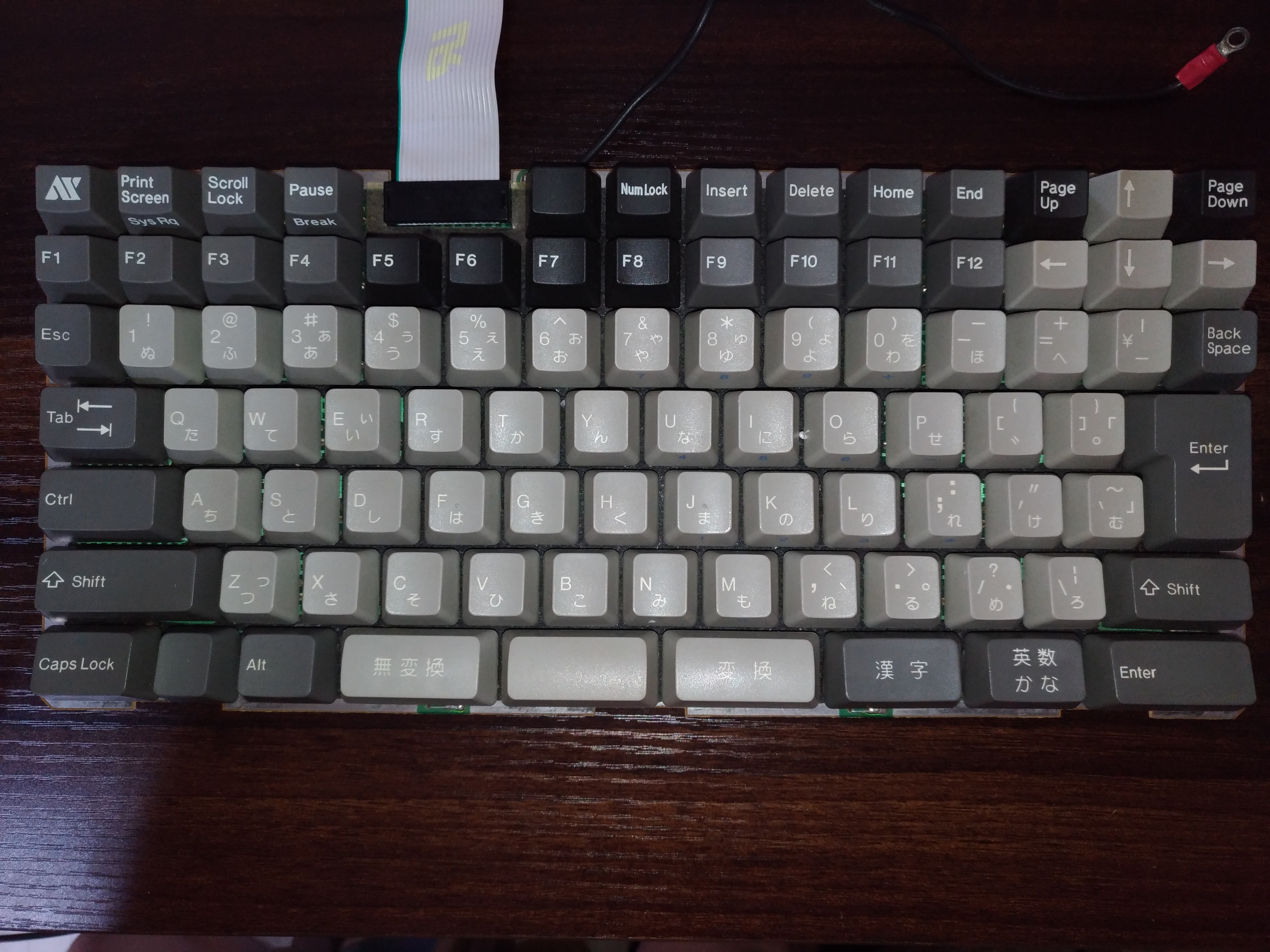

Im relatively new to alps boards, whites being my first ever alps switches and here is my board with some before and afters. Its an Alps made AT102.
Its a really nice board before i got it i was using a gateway 2000 and before that a corsair k70 and i can already say i prefer the White alps to the cherry reds in the k70.
As i said im a beginner with alps boards i gave mine a once over and opened a few switches that felt scratchy.In the future i may plan to fully dismount all the switches as i would like a project and the corroding mounting plate gives me the incentive, i was planning on stripping its paint but i was not sure what to replace it with and also maybe change the switches to blue alps .
Suggestions gladly considered :D
