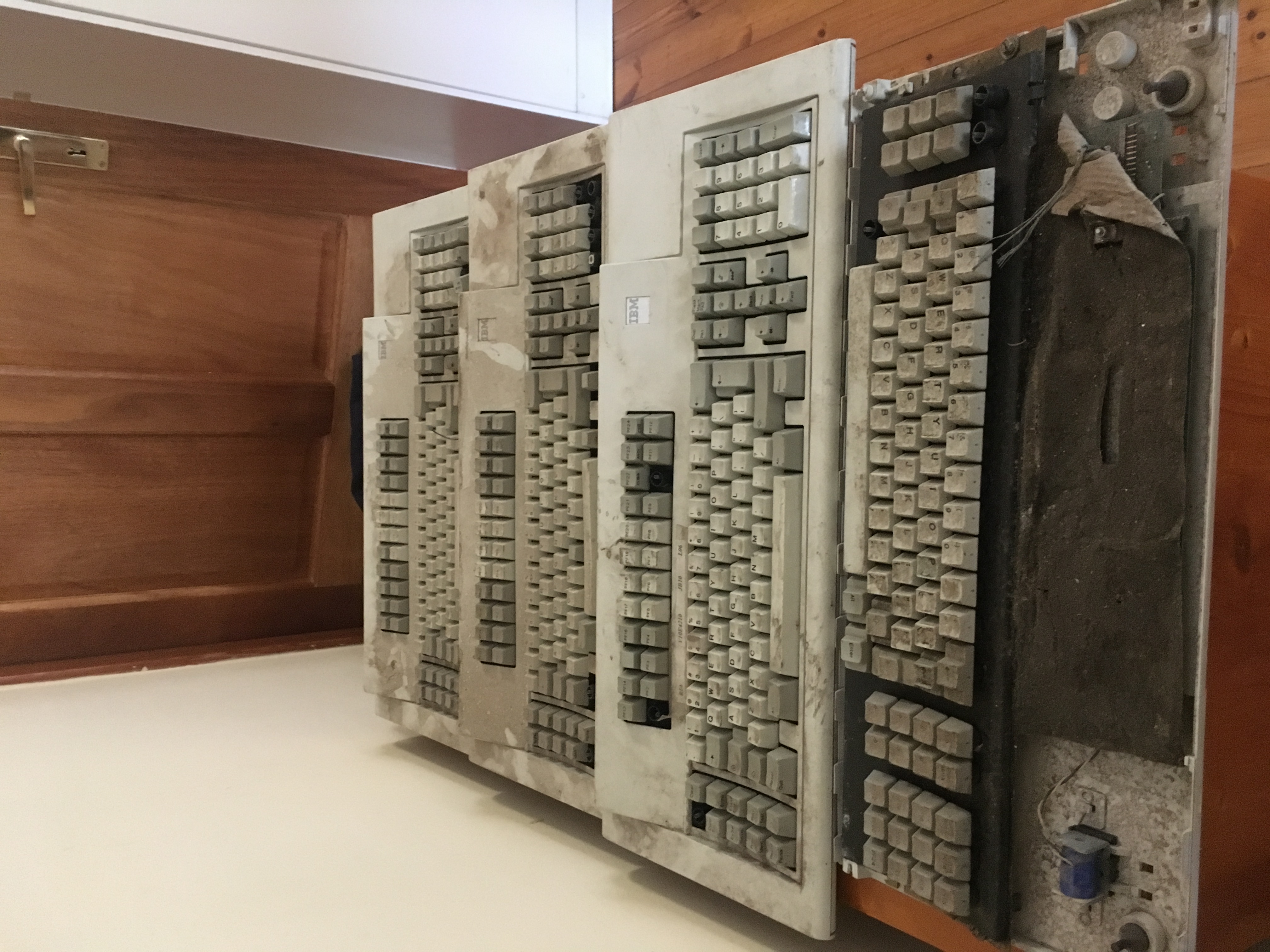

A colleague found three IBM model M keyboards and some unidentified (and worse for wear) keyboard in a house that is being torn down. They're 122 key terminal model M's, with two having stickers at the back still, model 1390702, manufactured in the UK in 1988. Did these use AT connectors, since the cords have been cut from them all.
They're obviously dirty and did get wet as well. I'm hoping that I can at least get one of them to work again, if not all three. Am I being overly optimistic?

Posted: 20 Nov 2018, 18:50
by Pumaeggs
twasa wrote: A colleague found three IBM model M keyboards and some unidentified (and worse for wear) keyboard in a house that is being torn down. They're 122 key terminal model M's, with two having stickers at the back still, model 1390702, manufactured in the UK in 1988. Did these use AT connectors, since the cords have been cut from them all.
no, they more likely used RJ-45 style connectors, but you can very easily build an internal soarers converter to make these work with USB. I would say disassemble all 3 of them completely, including removing the rivets and separating the barrel plates. i'd say chances are between the 3 of them you have enough parts to get one or maybe two of them working again. Bolt mod is basically essential at this point seeing as they are water damaged.
Posted: 20 Nov 2018, 18:53
by Myoth
they did use a DIN5 connector, but they used IBM's Terminal language, which is called 270 degrees DIN, soarer should be fine to convert them. and No, you're not being overly optimistic, they're very common boards so there is a lot of documentation and stuff about them, you won't have a problem converting/cleaning them :)
Posted: 20 Nov 2018, 19:52
by twasa
I finally got to open one (after we had a power cut) and it actually looked fine apart from the fluff and grime one would expect from 30 years. I'm glad that Soarer would be fine to get some operational again. Bolt modding is a bit of an issue, since finding the required screws or bolts here in South Africa seem to be difficult, given the sizes. I'm looking forward to learning though, never having soldered anything before. Thanks for the feedback.
Posted: 21 Nov 2018, 06:04
by Darkshado
That fourth one is a Model F, 87 key terminal board, see wiki/IBM_Model_F#IBM_3178_Keyboards
Posted: 21 Nov 2018, 16:12
by twasa
Thanks Darkshado. That's indeed good news. I'm hoping we can find the top cover still.

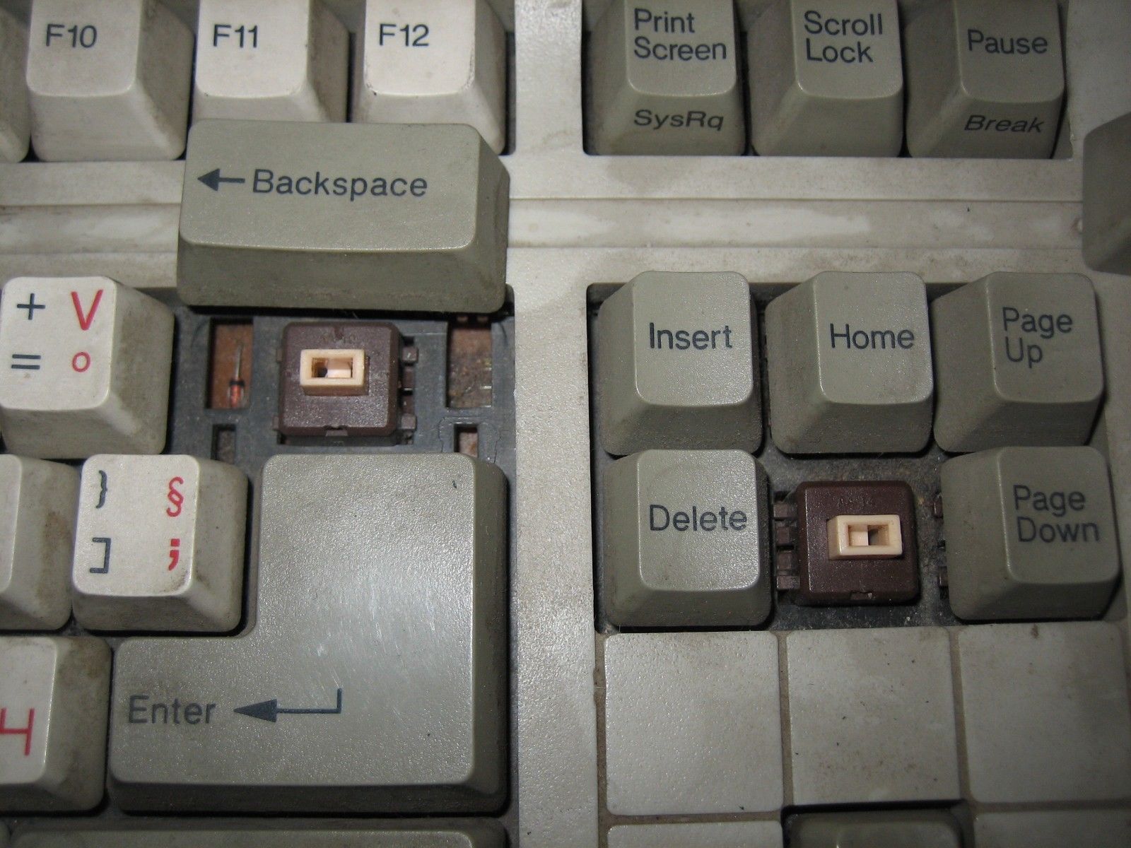

has anyone got an idea of what that is ? I can recognize the Acer font, and the page down is rotated. Could this be White Alps or Semi-mech Acer switches ? does anyone know ?Image

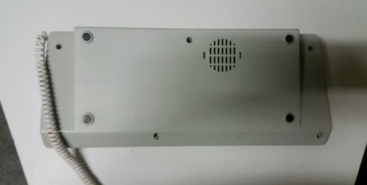

Posted: 30 Nov 2018, 23:29
by JP!
Just bought this one on eBay from a seller in Bulgaria. Alps clone perhaps? I read AA 14.
Posted: 01 Dec 2018, 01:24
by zrrion
It looks like a kpt type clone.

Posted: 01 Dec 2018, 02:16
by JP!
zrrion wrote: It looks like a kpt type clone.
I really think you are on to something. The case really similar to board I have with blue KPT's.
Some more pics:
Posted: 01 Dec 2018, 16:55
by uttindar
JP! wrote: I really think you are on to something. The case really similar to board I have with blue KPT's.
Looks like Podworld 292 keyboard. wiki/Podworld_292
Posted: 01 Dec 2018, 19:07
by JP!
From that I found an example of one just like the one I bought.
https://geekhack.org/index.php?topic=7073.0
