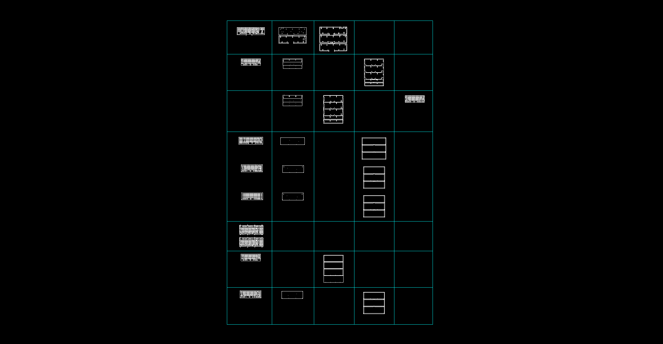

FINAL version!
columns are material/thickness.
1) alu 1.5
2) steel 1.5
3) steel 3
4) alu 3
5) steel mirror finish 1.5
rows are users
Download the DWG from the first post and confirm your order!
Remember that you are the sole responsible for your design (even if I designed it for you). I can't give any guarantee that the keyboard is going to work.

02 Sep 2013, 16:11
Any chance of a final.pdf as well? I can't even figure out how to scroll in DraftSight (no joke) and its PDF export isn't working properly for me either. Haven't managed to get a good glimpse of my design on this big canvas yet!

Okay, confirming row three. We are good to launch!

You might want to update the OP with the layout order, too. I'm listed as #2 but my layout is 3rd down from the top on the .dwg for submission.
-[°_°]-

mtl
02 Sep 2013, 18:20
matt3o wrote:Download the DWG from the first post and confirm your order!
Row 1 looks good. Thanks, matt3o!
-[°_°]-
02 Sep 2013, 18:34
3 OK
4 to go

-[°_°]-
02 Sep 2013, 18:52
yes already updated. your board is 100% steel.

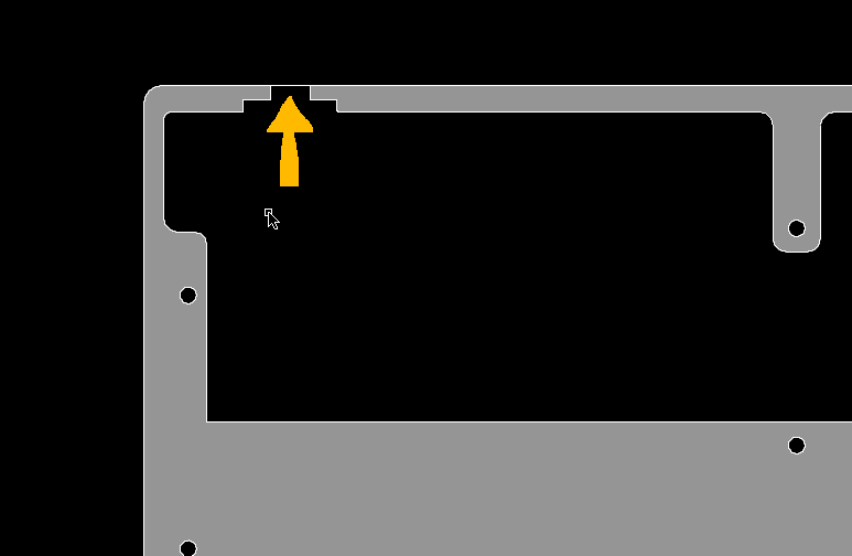

I noticed a little tiny something. This is the top of my mezzanine layer. I added shading to make it clearer where the metal is. The line I've highlighted is a bridge to nowhere:
Screen Shot 2013-09-02 at 07.32.46 pm.png (3.57 KiB) Viewed 4549 times
The other keyboards' port holes are all on layers which are adjacent to other layers on the sheet. My mezzanine however is next to open space. Should the line be there at all? Perhaps the mezzanine should swap places with the base layer just below it on the sheet.
Would now be a good time to ask for 5 mm radius corners on the keyboard instead of the current 3 mm? (Answer: YES! It is a bad time!) Would it make the steel too thin at the corners, especially in the mezzanine? Just a thought! I can live with 3 mm. I just took a ruler to my Apple keyboard and saw that 5 mm would match.

02 Sep 2013, 23:30
Muirium wrote:I noticed a little tiny something. This is the top of my mezzanine layer. I added shading to make it clearer where the metal is. The line I've highlighted is a bridge to nowhere:
thanks for pointing that out, I'll fix that but it's not really an issue (ie: it is going to work with or without it :) )
Muirium wrote:Would now be a good time to ask for 5 mm radius corners on the keyboard instead of the current 3 mm? (Answer: YES! It is a bad time!) Would it make the steel too thin at the corners, especially in the mezzanine? Just a thought! I can live with 3 mm. I just took a ruler to my Apple keyboard and saw that 5 mm would match.
I'll make a try tomorrow, but I suspect 5mm is too wide.
02 Sep 2013, 23:44
Thanks again Matt. It's a fine design in any case, I'm just challenging you again!
