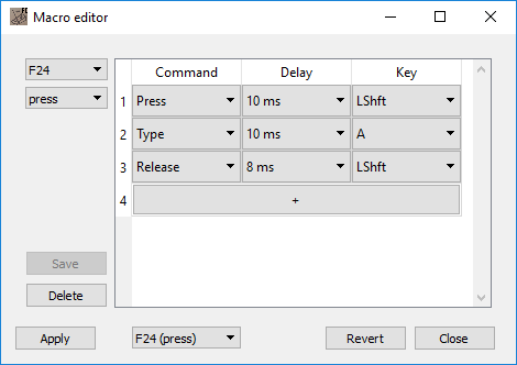

Posted: 29 Mar 2018, 06:32
by DMA
Feature parity!
So I kept my part of the promise, finally.
Re: [Progress]CommonSense controller - better capsense.
Posted: 29 Mar 2018, 06:48
by Techno Trousers
Macros! Congratulations and thanks for all your hard work. I hope to have a need for a few CommonSense controllers one of these days.

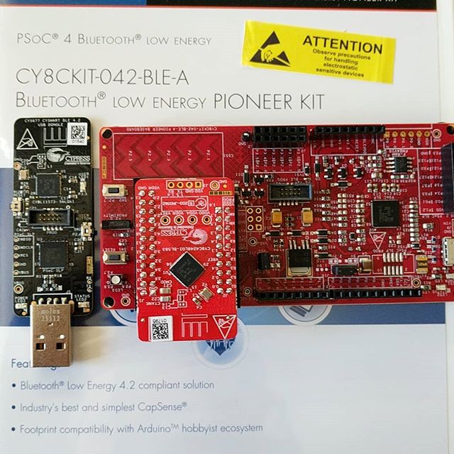

Posted: 05 Apr 2018, 04:34
by DMA
https://www.instagram.com/p/BhLAcDchf-k/
First BLE model F in the world.
It's typing gibberish because it's an XTant layout and profile soldered to F122 PCB.
But it has 18 KRO. Over BLE. Which is, I'm reasonably confident, is also first in the world.
Posted: 05 Apr 2018, 04:52
by Techno Trousers
Awesome! I'm starting to think perhaps I am interested in a Blootoof capacitive BS keyboard after all.

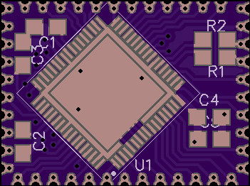

Posted: 18 Apr 2018, 07:25
by DMA
18x13.5mm castellated module for soldering to breakout PCB.
Posted: 19 Apr 2018, 21:49
by wcass
Nice. Smaller than 1U. It could fit in that space between Esc and F1.
I will see if I can draft a matrix up.
What layout would you like to see? 104, SSK, or something else?
