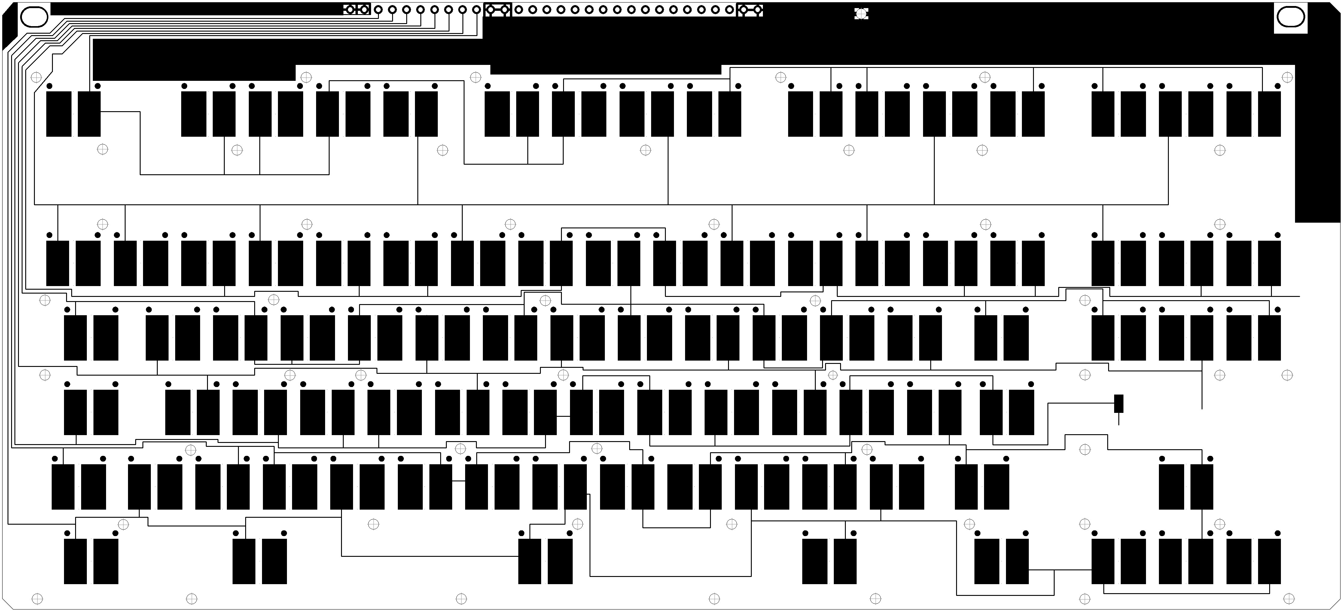

What thickness PCB are you planning on using?
I didn't see any rivet holes in your final design.
Left Alt looks like it is not connected top-side.

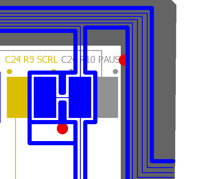

1) I plan to print the pcb before placing the order to ensure that they are in the correct place.
2) I plan to drill the holes when I receive the PCB, using the back plate as template. This will ensure that they are exactly in the right place.
They are painted in the drawing below
EDIT: what you see is a screen-dump.
There is no flipper on top. It is just one of the space barrels.
0.8mm.
I have considered them in the design. but they are not painted in the version that I have posted for two reasons:I didn't see any rivet holes in your final design.
If you are talking about this (in red)Left Alt looks like it is not connected top-side.

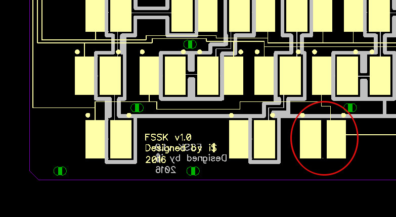

Regarding the picture above, the rows-columns puzzle did not allow to give the non-used barrel a bottom column.
So instead of deleting it, I just left it unused.
Column 3 could have another row, it only has 7 out of 8. But the unused one is in the third row (green 6). It will mean to redesign all of it to gain nothing as the barrel will be empty.

I plan to use a professional printer with a "painted ruler" along the complete printout, both dimensions, to control the calibration.
I remember the small hole that you have mentioned. I did not think that I could use this as a calibration unit. I will.Use the holes on the membranes as a guide on how they should be on the PCB. The hole near the semicolon is uniformly round and small; all of the others are wider. That hole near the semicolon anchors the PCB position left/right/front/back. Other holes on the home row are wider but close to the same height allowing some wiggle room left and right, but not front/back. Off of the home row, holes need to be taller to compensate for mounting the PCB into a curve.
My membrane is well wornTo check hole/pad alignment; use a well worn "top" membrane. You will see that each flipper makes 3 marks; two from the "ears" and one for the "beak". The "ears" need to be on top of the two dots above each key. Try to NOT route any top traces length-wise too near the dots or the "ears" might make it register as a down key.
The real problem is to avoid routing close to the ears. I have tried but the traces won't fit.
The holes that I have painted are over-dimensioned. I used a conservative approach. I used an Unicomp replacement membrane that I have, which has been checked to be compatible with the original M. The holes in the membrane are much bigger than the originals. The paper check that we will do today may help to reduce them, and perhaps improve the routing over the "ears".
I was also afraid of having two top traces too close. After porting the design to Diptrace, I realised that it can be done.
Also, I am keeping the top traces outside the bottom perimeter between ground lines at the same time that the crossing is still perpendicular. Additional, one has to find the right combination of rows and columns, which makes the design even more interesting
All those contains are difficult to maintain. I do not know how may times I have changed the row/columns allocations. And each time, one have to mirror the top contact and re-draw the bottom layer. A nightmare. In one of these processes I missed the L-ALT contact that you mentioned, probably using the "line square" function. This is why I appreciate so much another set of eyes looking at the PCB.
I planned to cable the ground of the xwhatsit controller to the back plate, as in the original setup. This will link the ground of the PCB to the back plate through the controller.Consider using the two holes at the top of the back plate (no membrane there) to ground the back plate vs leaving it to "float".
I also planned to check with the paper copy if there is an option to ground the PCB directly as you said.
I was already aligned with you
The connector worries me a lot. It must be mounted on top of the back plate. Thus the soldering may be short-circuited with the metal contact with the back plate. There is not option to leave the connection floating. My solution was to use the original membrane under the PCB. On the one hand, it will raise the plate and help with the isolation (isolation tape), on the other it will soft the sandwich contact that otherwise will be just rigid.The connection for the controller, will there be lumps of wire and solder sandwiched between PCB and back plate? I think i would use FFC and 3 connectors or Z conductive tape - depending on available space.

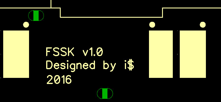

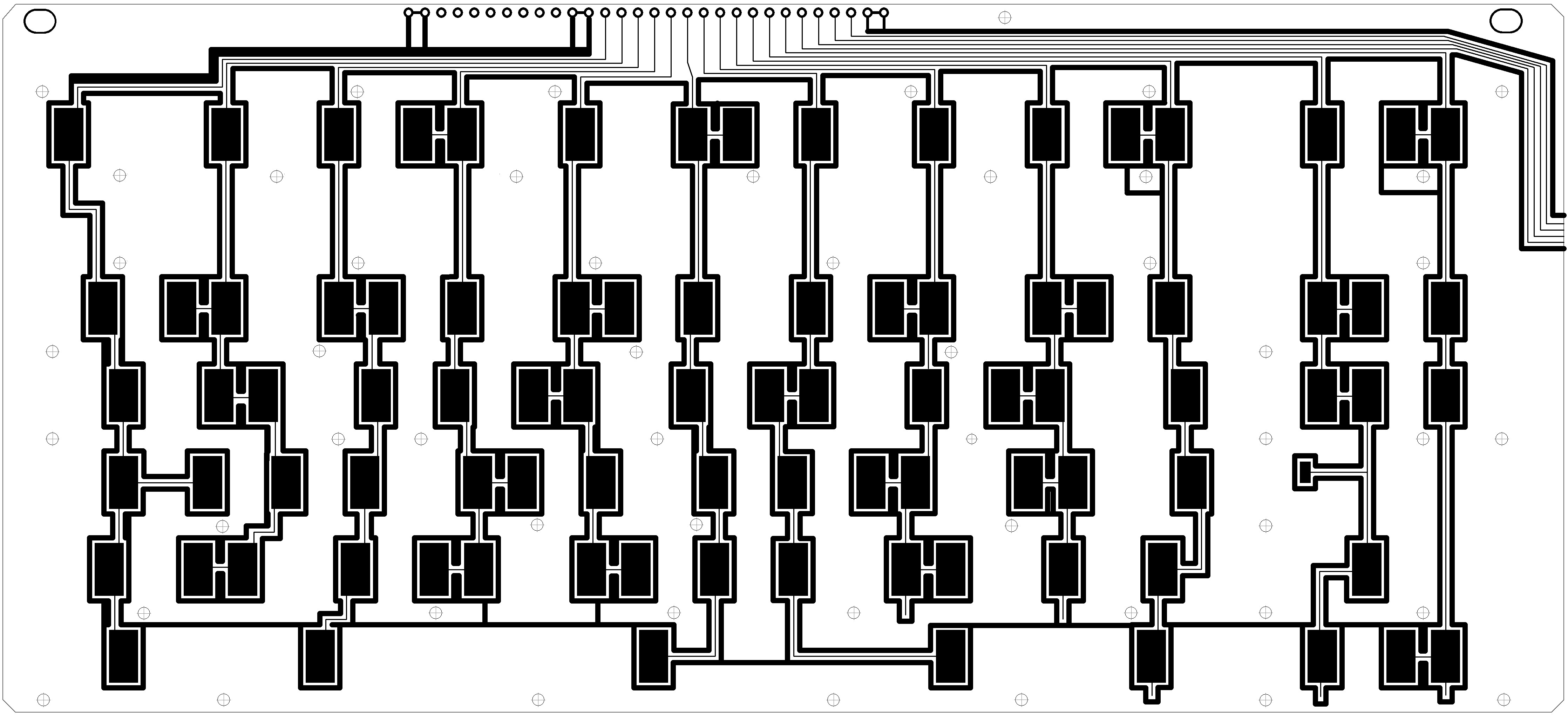

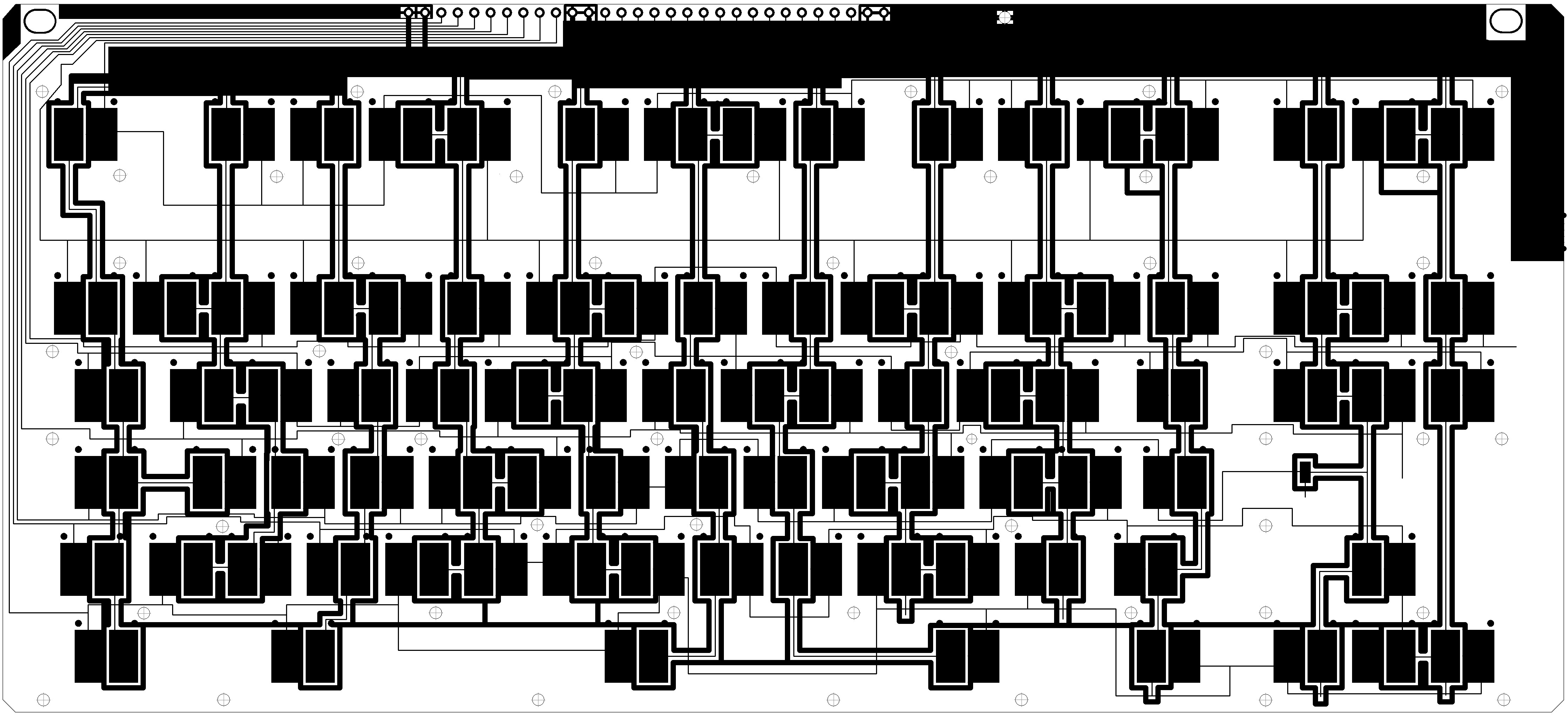

all,
Attached the version of today for checking and, if no errors found, production.
The changes include what was agreed yesterday, holes, and mounting holes in the case (they were missing).
Here the Gerber files:
Here the Diptrace file:
And following the Deltacad file:
EDIT- updated version 0.41 tested holes and quote requeted.
I am eager to read your comments, errors, corrections ... whatever.
