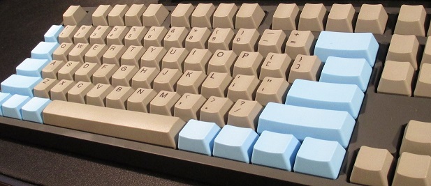

Score one point for the Novatouch -- it has a normal switch in the Left Control position, so that is is possible to install a silencing ring on all of the keys.
After making all the modifications to the Novatouch (installing silencing rings, lubing the stabilizers, putting foam pads under the spacebar, and installing Ducky dye-sub PBT OEM profile keycaps), I am amazed by how good this keyboard sounds and feels. The transformation from the original is stunning, and if I didn't know I was typing on a CM Novatouch, just judging by the sound and feel, I could swear I was typing on a silenced Realforce 87U all-45g.
Novatouch with Ducky PBT Keycaps in OEM Profile:
This is my second Novatouch makeover, and I found the results on the second one even better than the first. For example, the second NT has no clicking keys. The model numbers of the two boards are the same, but the S/N of the first one is SGK5000GKCT1US1142000109, whereas the S/N of the second one is SGK5000GKCT1US1150101259. I assume that the higher number corresponds to a later production, and perhaps some improvements were incorporated.
