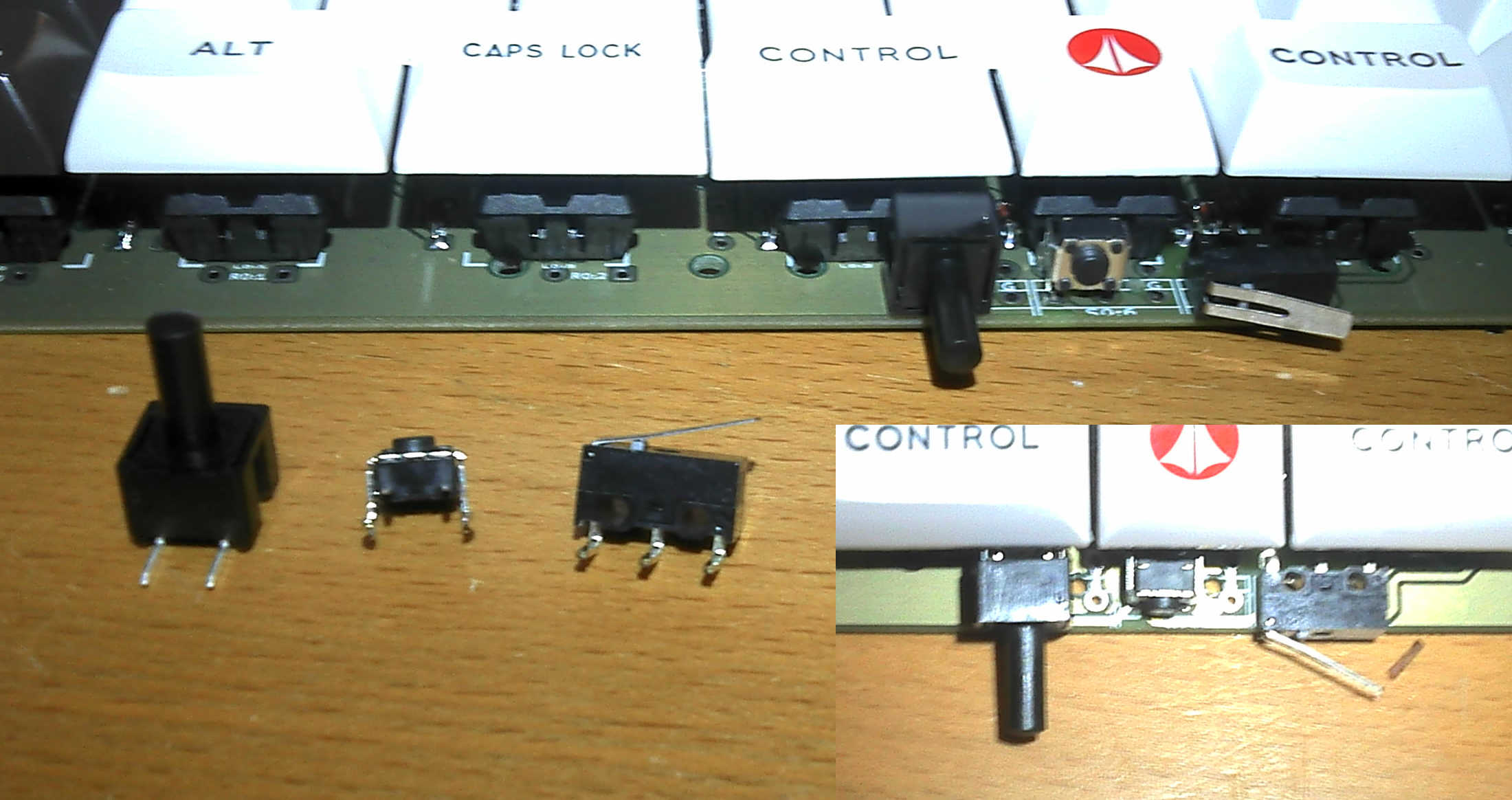

Posted: 20 Dec 2014, 16:20
by suka
Here are three alternatives for the mouse buttons I found at a local shop:
Left one mounts well, but cap will not clear the housing when pressed completely. Plus it feels cheap...
Middle one is the standard type I thought of earlier, needs to be bent a little to fit the PCB and also have some of the back mount stabilizers trimmed off to fit in front of the switches.
Right is a microswitch by Cherry that sits firm and nicely but needs to have its left leg cut off in the v0.0 pcb version. Feels best and should be easy to interface with the lever, but it also protudes over the edge.
So for now I think I'll go with the middle one...
(Conrad PartIds: 707759 1.29€ / 704849 0.45€ / 704083 2.09€ if you're interested)
Posted: 20 Dec 2014, 16:50
by 7bit
How much further back, could that 3rd switch be mounted?
Also:
Align the holes in the PCB with those in the switch?
:o
Posted: 20 Dec 2014, 17:08
by suka
Too late to check since it's already mounted now :-) But there is not really any more space between its pins and the first MX casing to utilize.
The left and right ones show above fit perfectly, the middle one I now used everywhere needs to have the contact pins bent to the front but that works easy enough. And only the middle location needs some metal removed on the switch back, the others can be mounted right in the gaps between any MX switch cases.

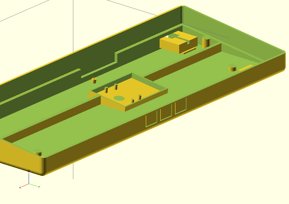

Posted: 23 Dec 2014, 12:47
by suka
The latest case iteration is complete: it now features additional supports, reset button access, mouse button cutouts, a trackpoint area, rubber feet cavities as well a customizable cable/usb connector outlet and is still fully modular, so different case heights, switch layouts or rotations of the PCB are simple to incorporate.
Still missing:
- optional covers at the sides for layout options without the caps filling the whole rectangular area
- modular mouse button assembly
- modular usb/cable assembly
- separate led mounts
- and of course all the cosmetic stuff like bevels, logos and whatnot everybody comes up when prototyping
I hope to get an actual sample early next year to confirm my measurements and provide a base for more decorative case options. Pricing should be in the 50-60€ range if 3D-printed.
Posted: 23 Dec 2014, 13:11
by matt3o
3d printed?
you sure just €50?
Posted: 23 Dec 2014, 13:12
by suka
That's what the shapeways quote is! Was amazed myself, to be honest...
Posted: 23 Dec 2014, 13:27
by Muirium
That's for the usual white material? How good is that stuff for painting, etc. for a finish?
Just out of curiosity, I wonder how much a metal one would cost. Or if that's as bad as I think, then CNCed wood.
Oh yeah: still nothing in the mail. Tomorrow's the last chance this year, most likely!
Posted: 23 Dec 2014, 13:46
by matt3o
the "white material" can be sanded and painted. Just give a good base of primer first. It can be both an enamel or acrylic based primer (I believe Americans call it "gesso", to be added to the Italian words weirdly used in English).
If the 3d print is too rough you can also use some spray filler first.
Re: HyperMicro madness
Posted: 23 Dec 2014, 13:52
by suka
Muirium wrote:That's for the usual white material? How good is that stuff for painting, etc. for a finish?
Yes, standard white or black material. Normally a little rough, but as Matt3o pointed out it can be post-processed quite nicely.
Steel varieties were around 280€ <cough>
Posted: 23 Dec 2014, 14:02
by Muirium
Bugger!
3D print material is okay but not great. Definitely lighter than I like in a case. But better than no case at all, of course. I'll keep a close eye on your progress.
