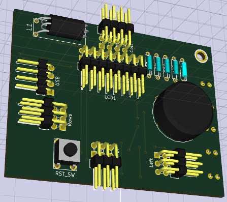

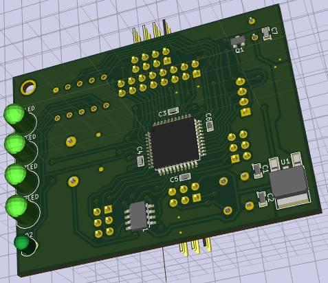

  • electronics is done (maybe I'll add one power filtering capacitor on the left side; it looks like it is not needed but at least a footprint can be added to the PCB)
  • v0.6 firmware ported to v0.7 electronics

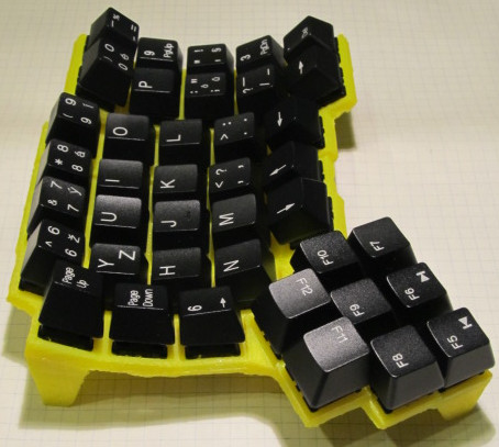

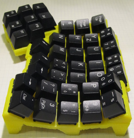

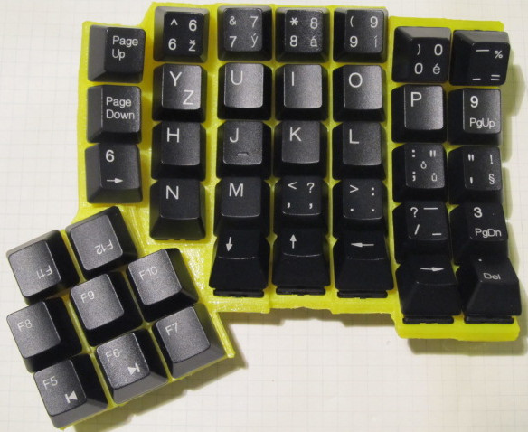

  • keywell shape is fixed; there are these changes to keywell compared to v0.6:
    • smaller key spacing by 0.7 mm (it is 18.8 mm now)
    • steeper bottom and top rows
    • more stager on pinkie columns
    • the two top pinkie keys moved nearer
    • make it work better with DSA keycaps
As a result the case is about 2 mm taller, 5 mm narrower and the top two pinkie keys are about 5 mm nearer than they were in v0.6.
It still looks like it will be available by this midyear.

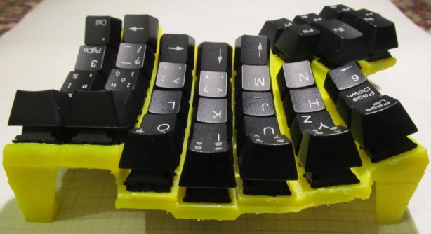

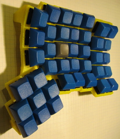

Some pictures of the test switch plate are below. Every time I change the plate shape I print mock-ups like these to check it out. And the renderings of the right hand side PCB. I do not have the real PCB at hand now.

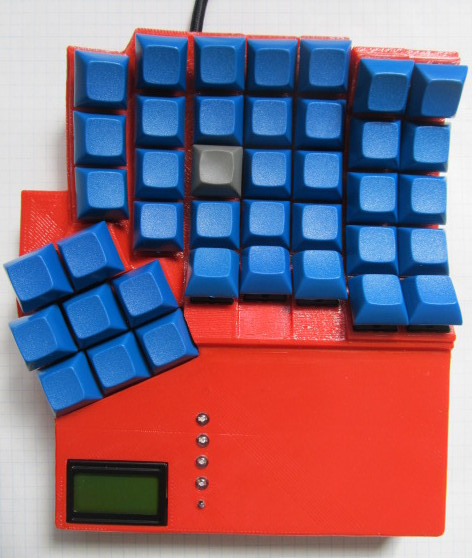

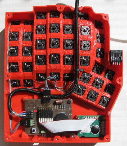

And kko made some progress with his very first Katy v0.7.
Here are the pictures of an unfinished right hand side of the keybaord.

Yes, controller in v0.7 is ATxmega128a4u. The future versions (if there will be any done by me) may use a different controller. The minimum keyboard functionality and on-the-fly remap work now. One can do custom layout even now. All of it needs more testing so maybe some problem will appear but so far so good.

Do you think this board here: https://www.mattairtech.com/index.php/d ... db-x4.html would be an OK starting point?
I'm just a little bit concerned about doing the soldering after having a look at the chip in your pics. While I'm reasonably OK with the idea of a simple solder job - With the chip package I'd certainly be a teensy bit concerned about creating un-intentional bridges.

kiltannen wrote: Do you think this board here: https://www.mattairtech.com/index.php/d ... db-x4.html would be an OK starting point?
It is one of the best breakout boards I have seen because it is very configurable. Almost everything can be disconnected using jumpers and that is what you would need to do if you would decide to use it. The only thing you would use from it is the power source circuit, the reset button, and the USB connector. Everything else would need to be disabled and pulled out either to Katy's PCB or your own. Probably your own ... since Katy's PCB does not have pulled out ATXmega pins outside and connecting wires to the ATXmega chip pads does not really solve your problem of avoiding soldering to such small pads. You could take Katy's kicad files and modify circuit/PCB for your needs.
The only other problem with the breakout board is that it uses two 10µF capacitors around LDO (power converter chip). Provided that the LDO is not some special kind (I doubt it would be) then it breaks USB specification which does not allow more than 10µF filtering capacitor in the power circuit at start up. It is not a big deal though. If it will ever cause a problem then likely it will only happen when connected to a hub (the hub or some other device connected to it will reset) and you would need to disconnect and reconnect again.
That being said, I think you just should try to solder the chip in. Really, it is easy to do when you have a factory produced PCB with solder resist, and an iron with temperature control. And depending how old you are you may need a magnifying glass :-) Just do not skimp with flux, set iron to around 280°C, stay on one pin/pad only a few seconds, and it will go fine. There is a lot of videos no youtube how to solder a TQFP package either a pin by pin or with a single drag over one side. The point is that you can easily see whether the chip pins are shorted or not. The solder will be repelled by the areas between pins because of solder resist on PCB and the flux. So the difference between shorted pins and separated pins is very visible. If you still would not be sure then the chip has ESD protection so you can solder it as the first component and use an ohm meter to check whether you do not have any shorts. I think it is almost impossible the ohm meter would put the chip in danger. I did it often there was never a problem with it.
I can build a few PCBs for people in EU. I do not know about people outside EU since ATXmega contains AES hardware and exporting it needs some additional paper work which I do not have a clue about. I bet people in all the countries which have good relations with USA can buy it locally. It does not seem that it would be enough interest to do lager scale production (which would amortize paperwork, delegating PCB production to some factory etc.).
Actually a few days ago we did some additional work on the LUFA update and we found that its footprint lowered so it fits on ATmega32u4 again now (even with the LCD and the interpreter). Still going back to ATmega is not our plan since ATXmega is easier to work with, cheaper, and has more GPIOs in a package with the same pin count.

I asked the support guys if they can supply with headers on:
support@mattair.net wrote:I don't normally install headers, so that the user can decide which side to mount them on. If you would like them soldered, I can do that (no charge). I also have angled headers in stock, if you need.
Seems like this would solve 90% of soldering? Keeping the 128 chip would give me the ability (technically) to add some code to support software control of the LEDs I plan to install on the keyswitches. I think that might be beyond my appetite for work though... :? I will probably just go with a physical switch mounted in the case.

Ok, I'll try to get it out as soon as possible. Maybe in parts and not all at once. So that you can look at it.
Unfortunately, as for as the case, I want to print one more copy before the release. KKO's v0.7 is working as a keyboard with remap. Macros, LEDs, photo sensor are still not enabled there. And there is a small change in the case which was not in KKO's version. I need to 3d print it here and check it before I release it.
Anyway, you want to do significant changes to the PCB (better connection to a separate ATXmega breakout board *) and possibly the schematic too (if you want software controlled back-light). So you are probably interested in the kicad files first anyway. Hopefully the next weekend (i.e. in about 14 days) I'll try to get at least that out. I want a few small improvements and more descriptive silkscreen.
* Without that it does not make sense to use a separate ATXmega breakout board because you would not avoid soldering of some tiny stuff when connecting the breakout board to the PCB. It would be easier to solder an ATXmega chip directly than connecting tiny wires to the TQFP pads. My opinion about that is: Who cares, even if you solder it incorrectly and damage the chip. It's only about 3.5€. No bid deal. The only other reason why to use an ATXmega on a separate breakout board is that it already has some boot loader loaded. So there is no need for a PDI programmer.

vvp wrote: you want to do significant changes to the PCB (better connection to a separate ATXmega breakout board *) * Without that it does not make sense to use a separate ATXmega breakout board because you would not avoid soldering of some tiny stuff when connecting the breakout board to the PCB. <snip> The only other reason why to use an ATXmega on a separate breakout board is that it already has some boot loader loaded.
SO - the guy with the ATXMega board has offered to solder on header pins - even offering my choice of angled pins. And yes - definately getting a board with a bootloader is attractive to me... That gives me the chance to maybe not use/ modify your PCB at all - but just put some components together on some kind of breadboard, I am thinking like this: http://img.dxcdn.com/productimages/sku_140968_1.jpg or maybe this: http://img.dxcdn.com/productimages/sku_140784_1.jpg. I should be OK to solder headers onto those breadboards myself & the other few components you have on your board. That also saves me trying to figure out how to etch, and while etching is cool - it is also an extra manufacturing step I think I'd rather not put effort into.
SO having said that - what are the dimensions of your PCB? I think I can get the breadboard on it's way if I pick something fairly close to your PCB in size. That outfit (http://www.dx.com) tend to take around 5-8 weeks to land anything in NZ so ordering sooner rather than later would be a good idea. I am also thinking I should get the LCD on it's way from them, do you have a specific one in mind? Or maybe a form factor I should look for?

Right, you can use a universal board only and wire components with a magnet wire. I actually did this on my first PCB for the left side (katy v0.6). You can find a picture of it earlier in this thread.
Right hand side PCB dimensions are 50.292 x 66.040 mm. Left hand side PCB dimensions are 25.400 x 46.355 mm. You can look at the pictures of the internals of KKO's right hand side (v0.7) and my left hand side (v0.6) to get an idea how much space is around the PCBs. But you probably want to wait with ordering since you should be able to order it all from one shop and you can save on shipping charges. The LCD used is FDCC0802C-FLYYBW-51LK. But again you want to order together with other parts. I got all the parts for PCBs from one shop (farnell).
