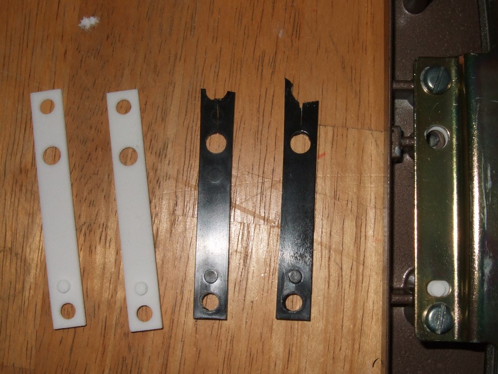

Posted: 13 Jun 2014, 22:38
by wcass
I got these made at Shapeways. The 3D model was made by Monster-Toys.
Posted: 13 Jun 2014, 22:53

What are these objects made at Shapeways?

Posted: 14 Jun 2014, 00:32
by JBert
Hypersphere wrote:What are these objects made at Shapeways?
Looks like some kind of mounting guide between the case and the keyboard assembly?
Posted: 14 Jun 2014, 01:19
by rindorbrot
Yes, those are some plastic spacers for in between the internal assembly and the case.
Most of them break while opening the Kishsavers, that's why we need replacements!
Posted: 14 Jun 2014, 01:21
by Muirium
Yup. The metal on the right of the picture is a Kishsaver's internal backplate, which has lips on the sides like other Model Fs (so I gather, I haven't opened other models) where it attaches to the case. The brown metal is the inside of the Kishsaver's outer top shell. I think Wcass has painted his. Mine is an unpainted grey, as I remember, beneath the outer beige.
As for the component, my Kishsaver is missing those entirely, but holds together tight and good without them. But I don't doubt they can be quite useful, for alignment. One of the four I proxied needed opened up to move the internals slightly to the left as the right column of keys were binding with the case. Standard Model F stuff.
Posted: 14 Jun 2014, 02:42
by wcass
Yep, those are plastic spacers. Most of the KS owners i hear from report that these are damaged. The two black pieces of plastic in the picture are my originals - the tops are completely broken off and both are split between the top two holes. The two white ones are copies and there are copies mounted in the Kishsaver (only one shown).
I think IBM put them in there for some good reason (Parak believes these help prevent damage to the barrels and PCB), so I'm all for replacing when damaged. They are just slightly over 1cc each, so only about $1.50 each plus handling and postage.
They fit fine, but I can't speak for durability yet. I'm still in and out of the case, so will have lots of opportunity to check them for wear over the next month or so. I'll let you know.
