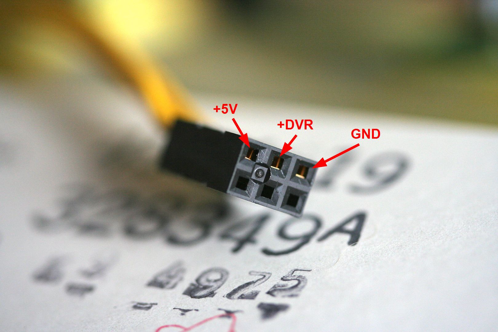

if your 6 pin header on the right is a standard 6 pin AVR ISP header and if MOSI is not use for something else ....

Thanks for tracing them through! Wonder what DVR stands for?
Nope it's not an ISP header; the boards use the ATmega32U2, so come from the factory preloaded with a DFU bootloader, so I've never bothered to put an ISP header on them.
The pinout I have is as follows:

So the problem is the +5V and GND need to be diagonally opposite. I don't want to risk using a GPIO as +5V or GND, as it may suck more current then the GPIO wants to source/sink. So I think a pin swap (move GND to the next row) on the connector is probably the easiest; those pins can normally be popped out of the sockets with a couple of jewellers screwdrivers or similar. Either that or bridge the GND pin on the controllers to the next row.

it could be OVR - not sure. too small to know for sure.
i've never had a problem moving a pin or three. a good picture of where they need to go is all we need.

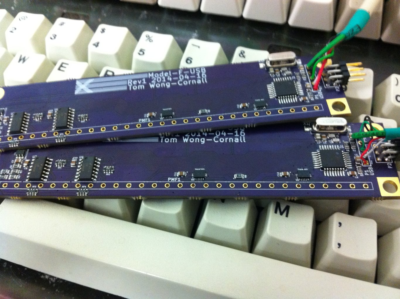

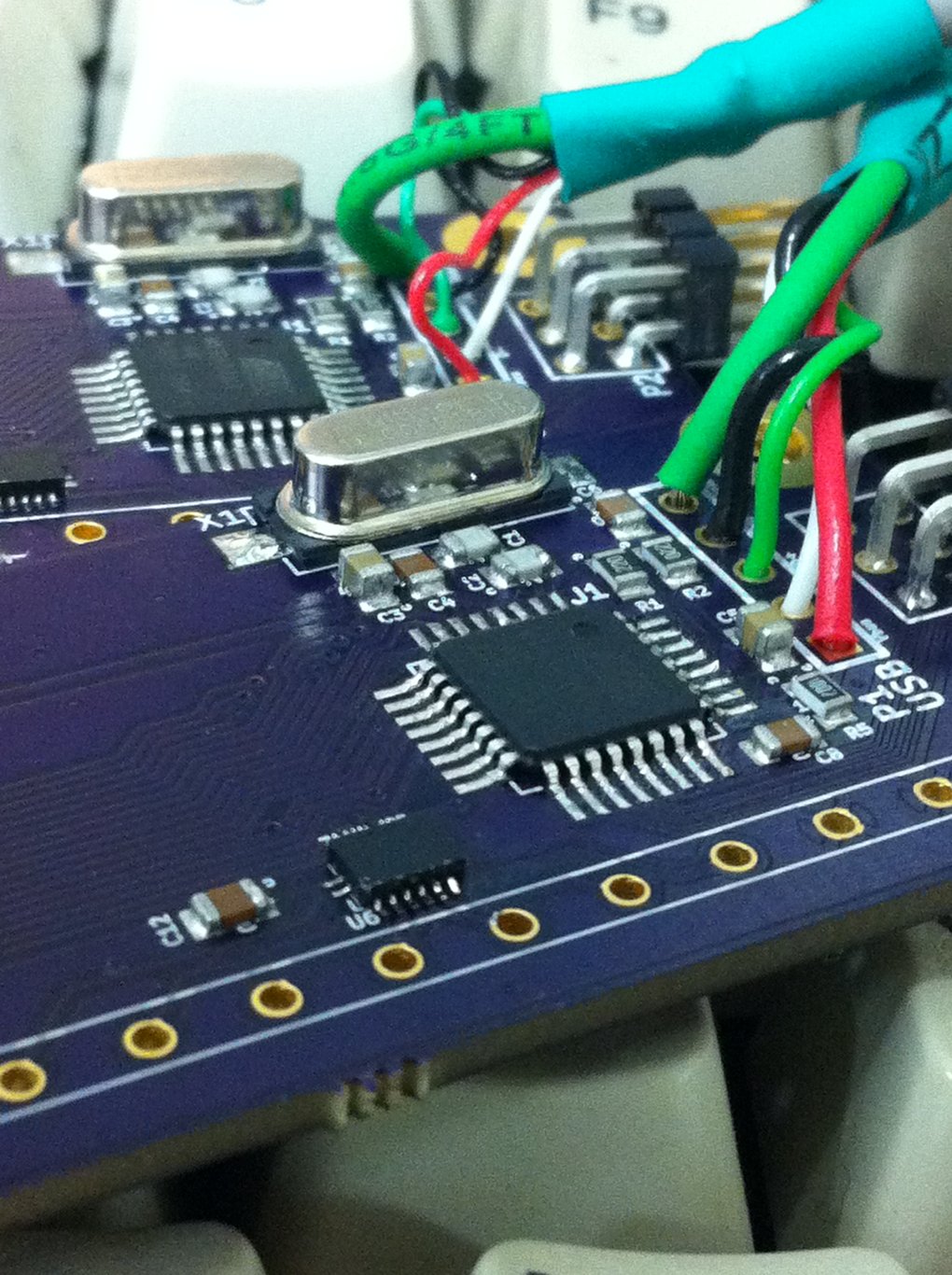

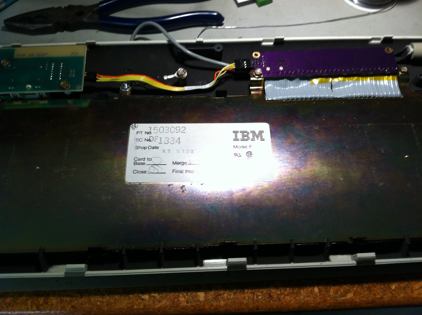

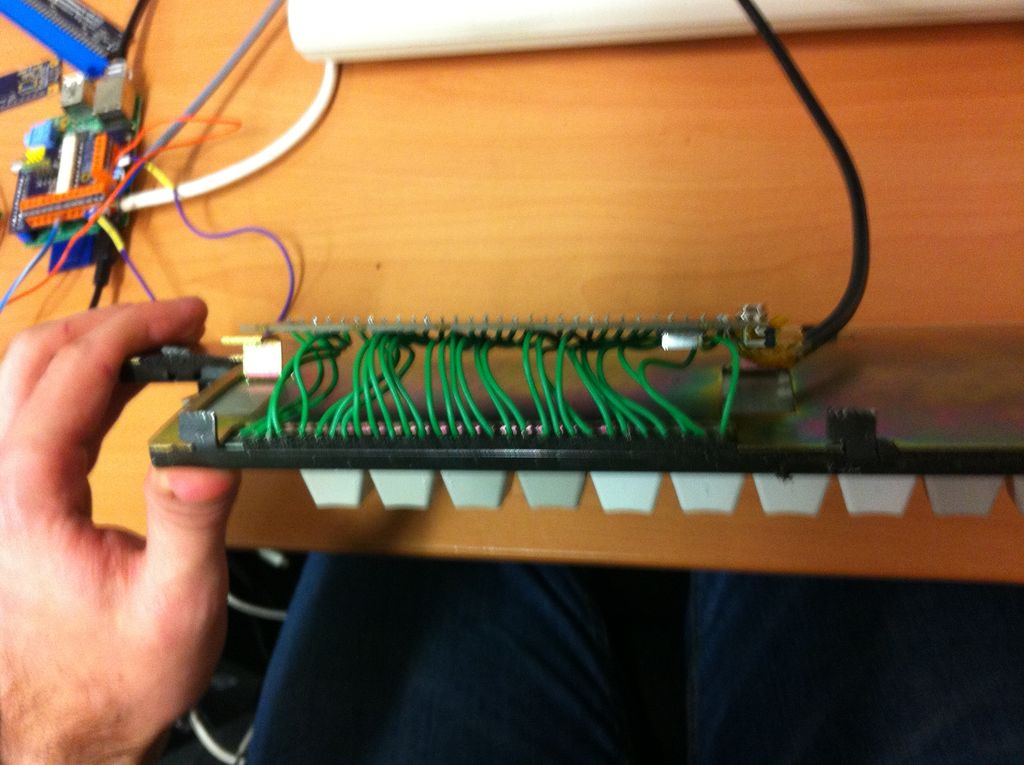

Well finally managed to find some time to add enough smarts to the software (util and firmware) to handle variable-sized keyboards of different sorts (everything was hard-coded before).
I soldered one up, then attached it to my 122-key terminal.
It works! (This post typed on it as proof :) )
Pretty well too. There's a couple of tweaks to make, mostly resistor values; the key-capacitors don't drain fast enough after each pulse, I was getting situations where the key in the same column but next row was getting wiped out if both were pressed. I think this is down to a) my key-drain resistor divider being too high-impedence to drain a whole 8 rows as fast as 4 rows were draining, and b) the capacitance of each key is higher in the Model F compared to the beamspring, making it easier to sense. For now, to fix the problem, I've just increased a delay value inside the code to wait between pulsing each column; in the beamspring it was about 10us, for now it's closer to 50us. This means our 650Hz scan rate drops down to about 500Hz. I'll try tweaking the resistor values to see if I can get this back down.
The auto-calibrate part of the firmware needs to be fixed as well, as its logic is backwards for a Model F (pressed keys produce higher voltages than unpressed keys, the reverse of beamsprings).

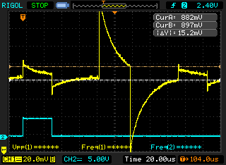

Here's a picture of a scan (don't worry about the blue line, that's just a single column being strobed):
You can see the nice big jump when you hold a key down. Very easy to measure.

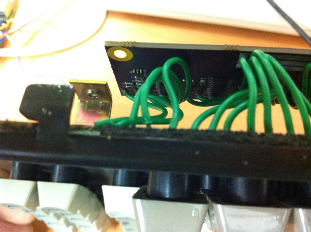

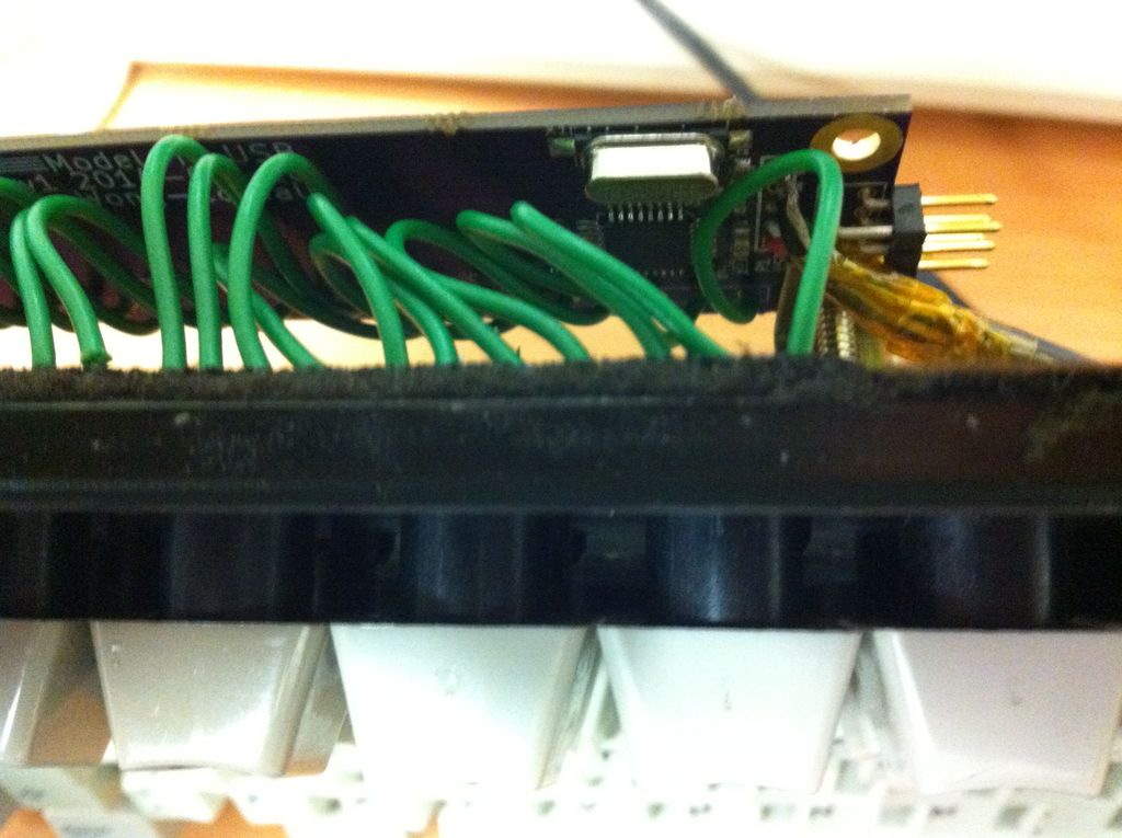

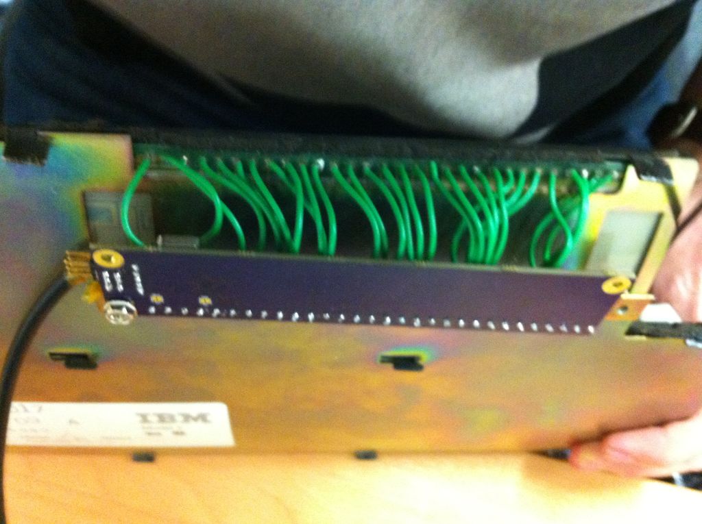

And some crap pics of it fitted to my 122-key terminal. Apologies for a) the green wires (long ago when I was first playing around with the board I accidentally snapped the brittle single-core ribbon cable) and b) the crap photos from my crap phone.
photo 1.JPG (148.92 KiB) Viewed 7707 times
photo 2.JPG (100.53 KiB) Viewed 7707 times
photo 3.JPG (113.96 KiB) Viewed 7707 times
photo 4.JPG (106.54 KiB) Viewed 7707 times
photo 5.JPG (109.86 KiB) Viewed 7707 times
Looking at those pics now I'm surprised it works with all the crazy green wires everywhere. I suppose the Model F just has high enough thresholds (bigger capacitors) that it's much easier to sense.

Nice! And beeper header sighted! Wcass is right: this is indeed the pinout:

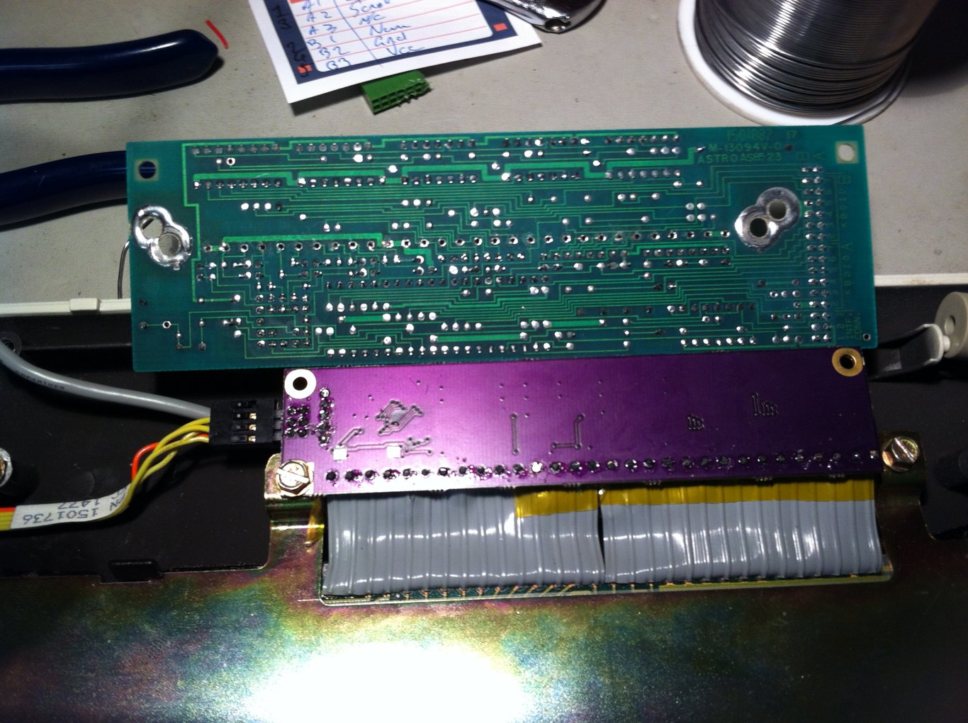

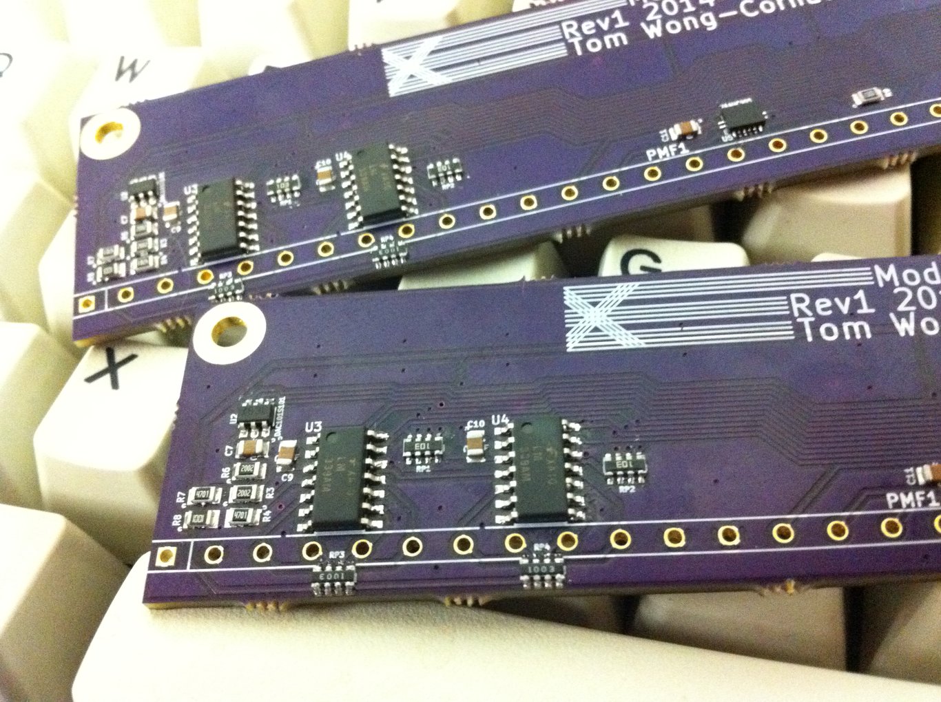

All right, fresh boards. One for my PC-AT, one to go in the post to Murium for Kishsaver testing. All gone!
photo 1.JPG (275.73 KiB) Viewed 7542 times
Analogue (row sense) end:
photo 2.JPG (303.74 KiB) Viewed 7542 times
µC end:
photo 3.JPG (291.97 KiB) Viewed 7542 times

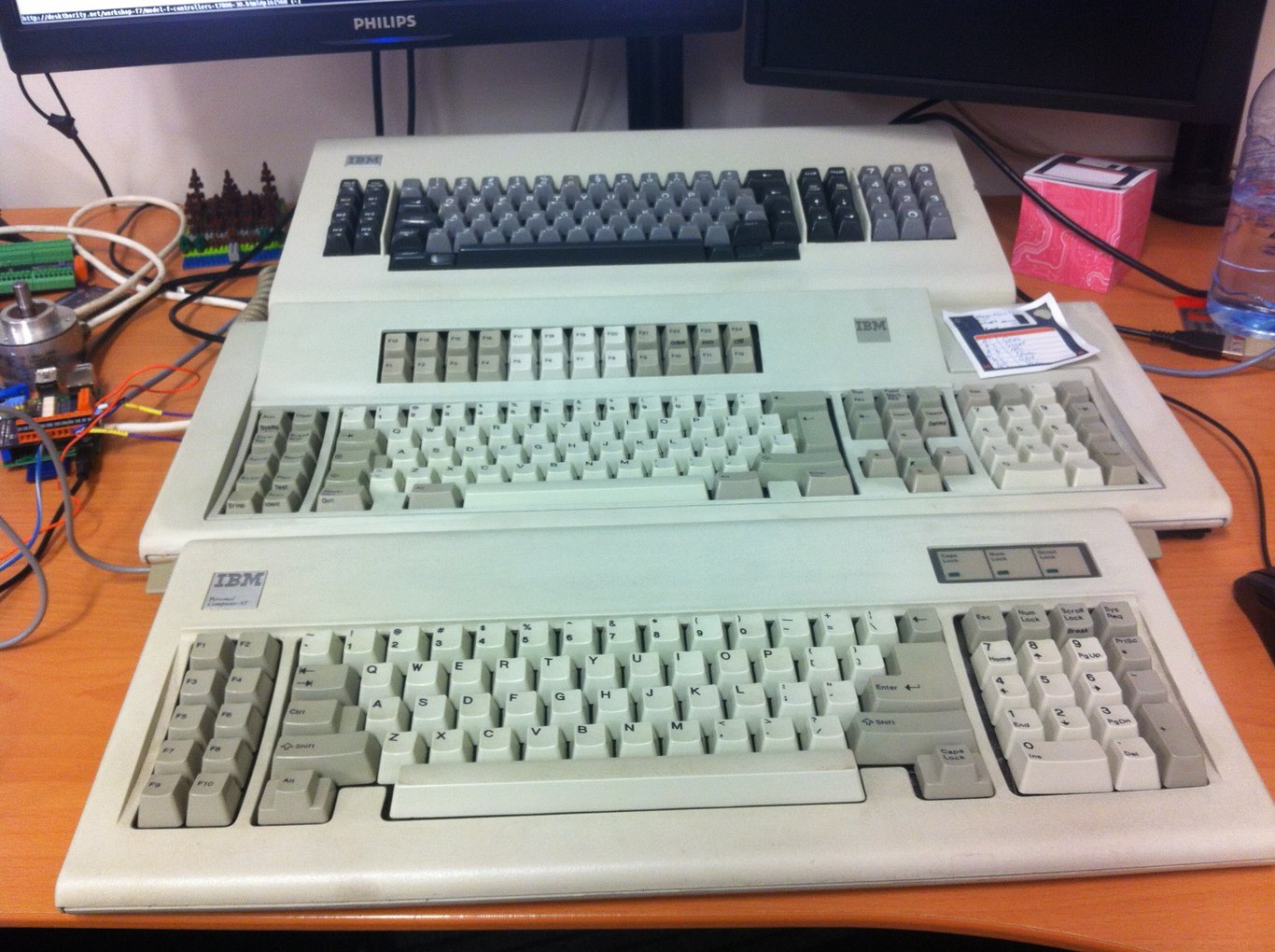

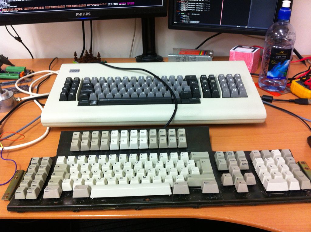

Now fitted inside my PC-AT (typing on it now, man I need to fix that heavy spacebar, it's ridiculous).
Holy balls, never ever want to desolder/solder one of those ribbon cables again. Need to find a better method for testing these when I start making them for other people. Who ever EVER thought through-hole technology was a good idea?! IBM had already used surface-mount in the 60s (with the Apollo landing guidance computer), why didn't they stick with a good thing!
Melted the ribbon cable a bit, hence the kapton tape (just in case):
Close-up showing comparison with old controller, and pin-swapped ribbon cable connector for LEDs (they work by the way; quite amusing to tell the expansion header that it's to operate in "Beamspring Solenoid" mode and watch the Caps-Lock LED blink away for every keypress):
Oh yeah and my current desk. All running off USB with ibm-capsense-usb controllers of some description (that's my new name for the project, can't call it "beamspring-usb-5251" anymore—maybe I should set up a combined thread once I hit v1.0). I didn't bring the other beamspring (5251) in from the next room, as my desk is rather full.

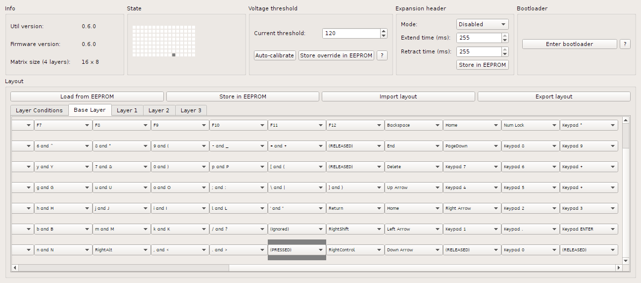

The GUI util is still under a bit of development, finished adding the column-skip feature to avoid shorts on things like Kishsavers (my boards unfortunately cannot autodetect which columns are live and dead, as I use serial-to-parallel shift registers for my column drives, instead of GPIO, so I can't set them as inputs with pullups to check). Also need to add the extra stuff (expansion port, column skips) to the import/export file format.
Should be done in the next day or two, then I'll round up a Windows machine and a Mac OS X machine and get the utils compiled for a proper release.
