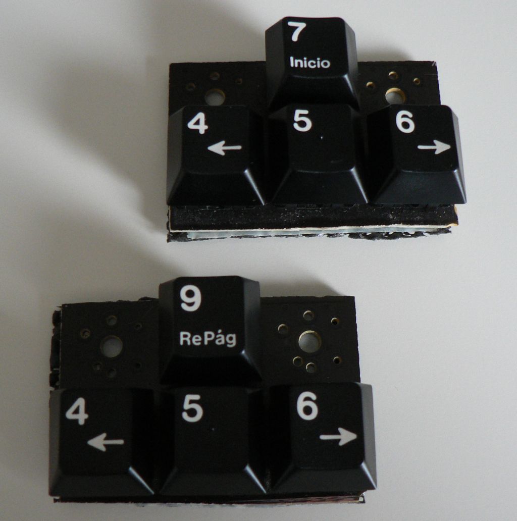

2 addon boards.jpg (105.05 KiB) Viewed 21593 times
i have got 2 more boards adding to the package. before your post sixty i put double shots (Hispanic) on it :mrgreen:
one PCB is with the original red from Mr. Interface the other one is a little addon. ;)
