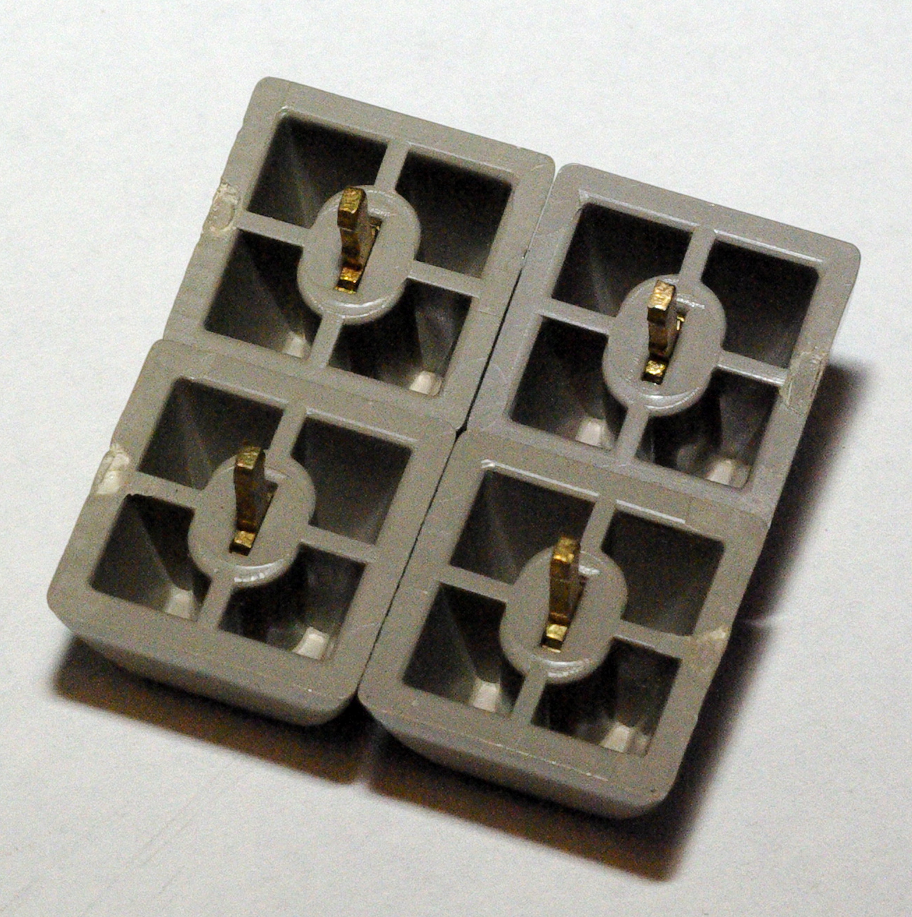

Now I can see the point of the metal bit in the keycap:
It looks like it's a keycap adapter! Two of the earliest keyboard makers were Micro Switch and IBM. The metal bit (and the slider it fits into) allows Micro Switch keyboards to use IBM "Selectric-style" keycaps. (...as keycaps of that shape were called at the time - other keycaps were UNIVAC-style or round Burroughs or Teletype style)
It doesn't seem to have been around for long, just 1968(?)-1970.

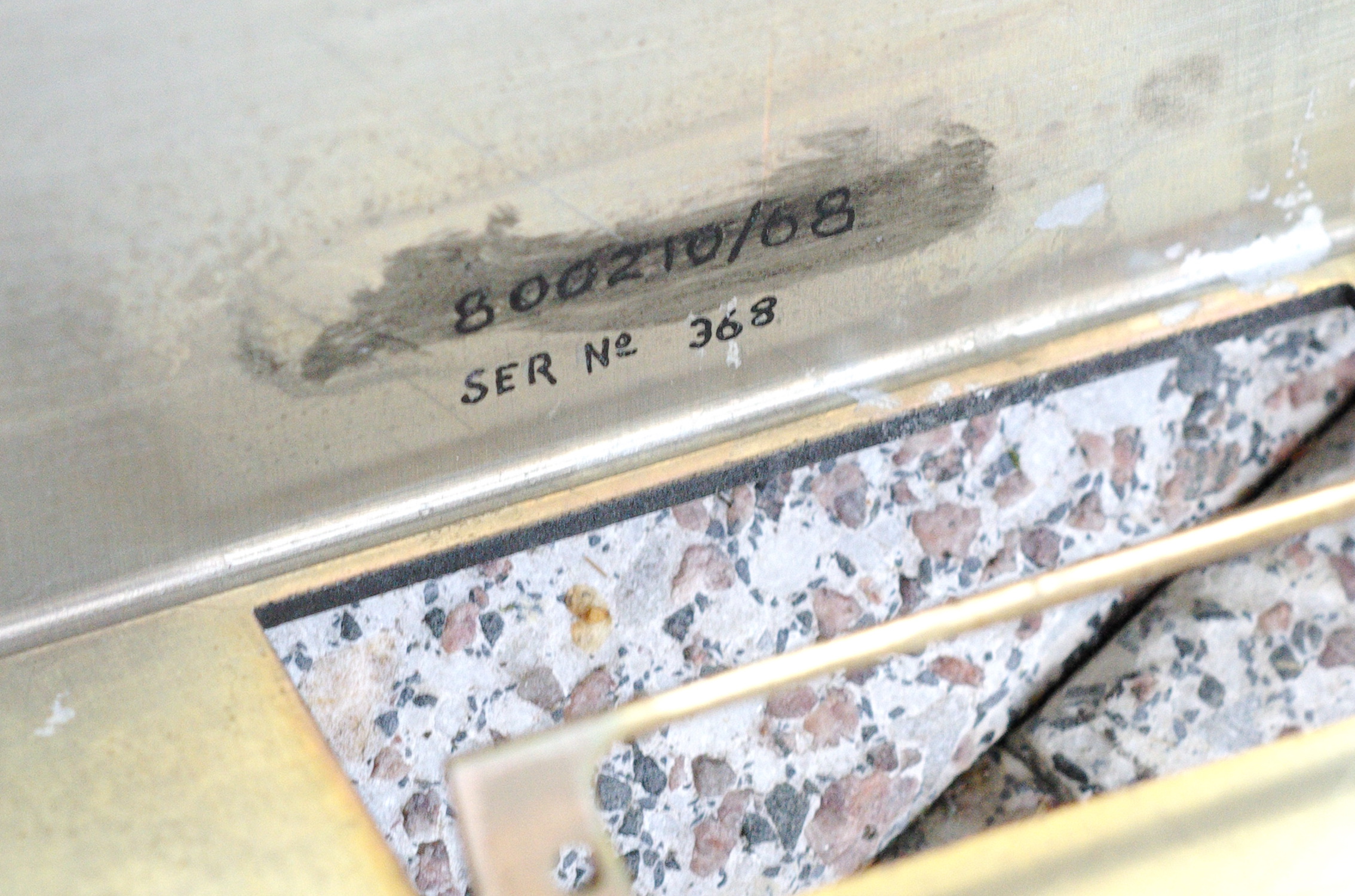

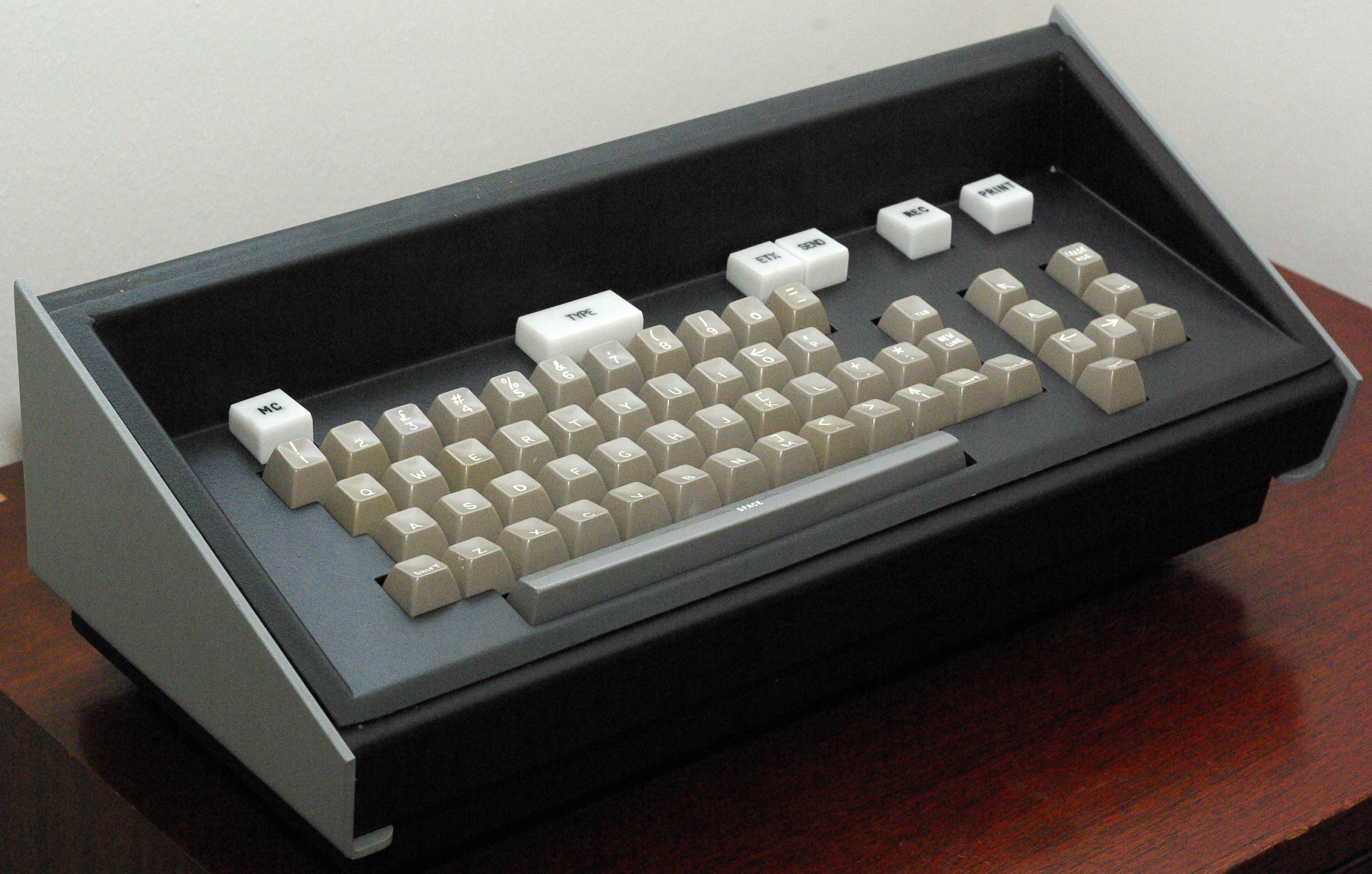

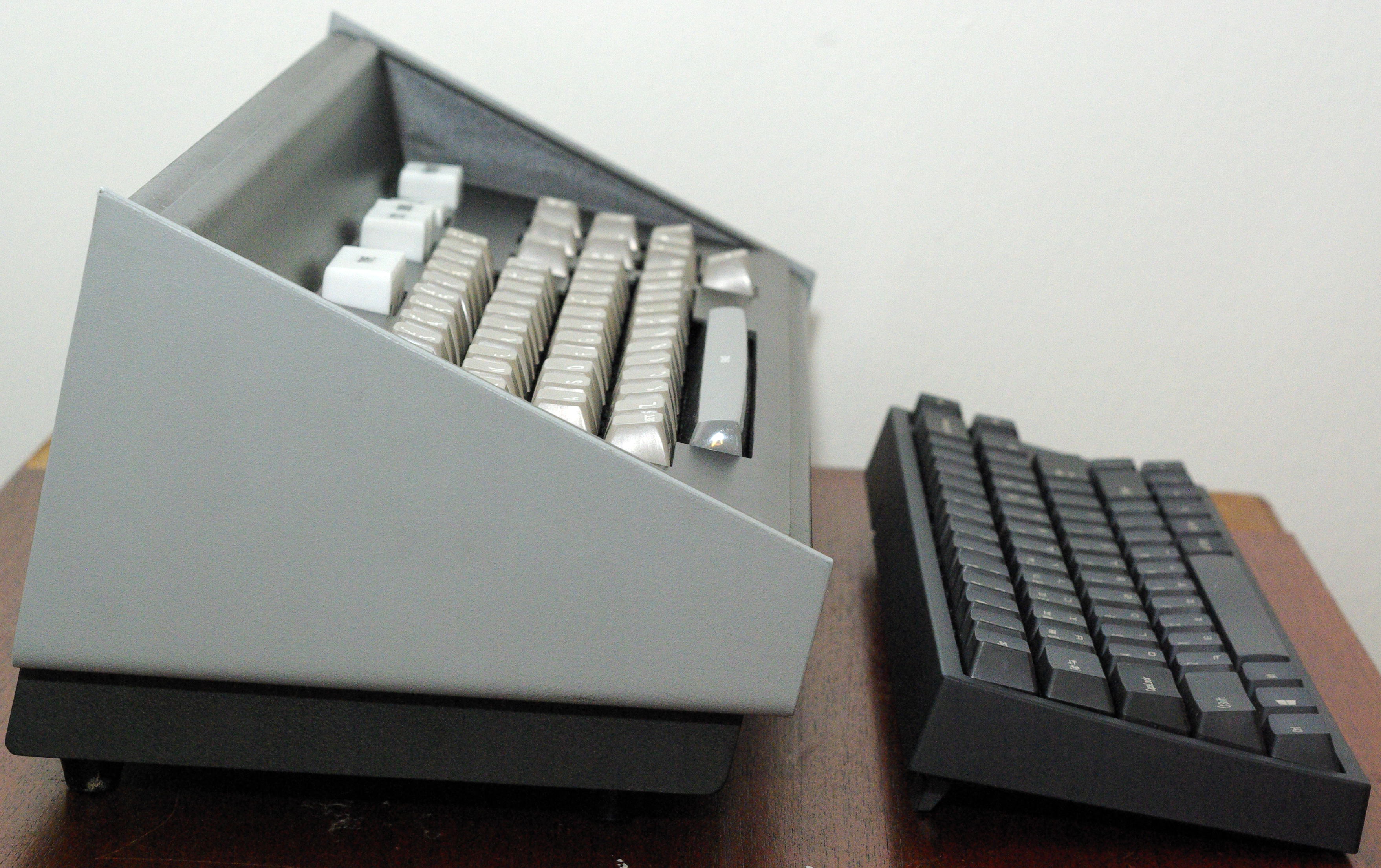

I'd like to continue here with pyrelink's permission. I think Engicoder found this a couple of weeks ago, I thought this was too interesting to pass up so I bought it. The seller has no information on it, apparently they got it from some decedent's estate.
The case is metal all around. The case is quite bulky with the enclosure at the top and measures 42cm across, 20cm in depth, 8cm tall at the front and 16cm tall at the back and weighs 3154 gram. Looks insane next to my FC660C.

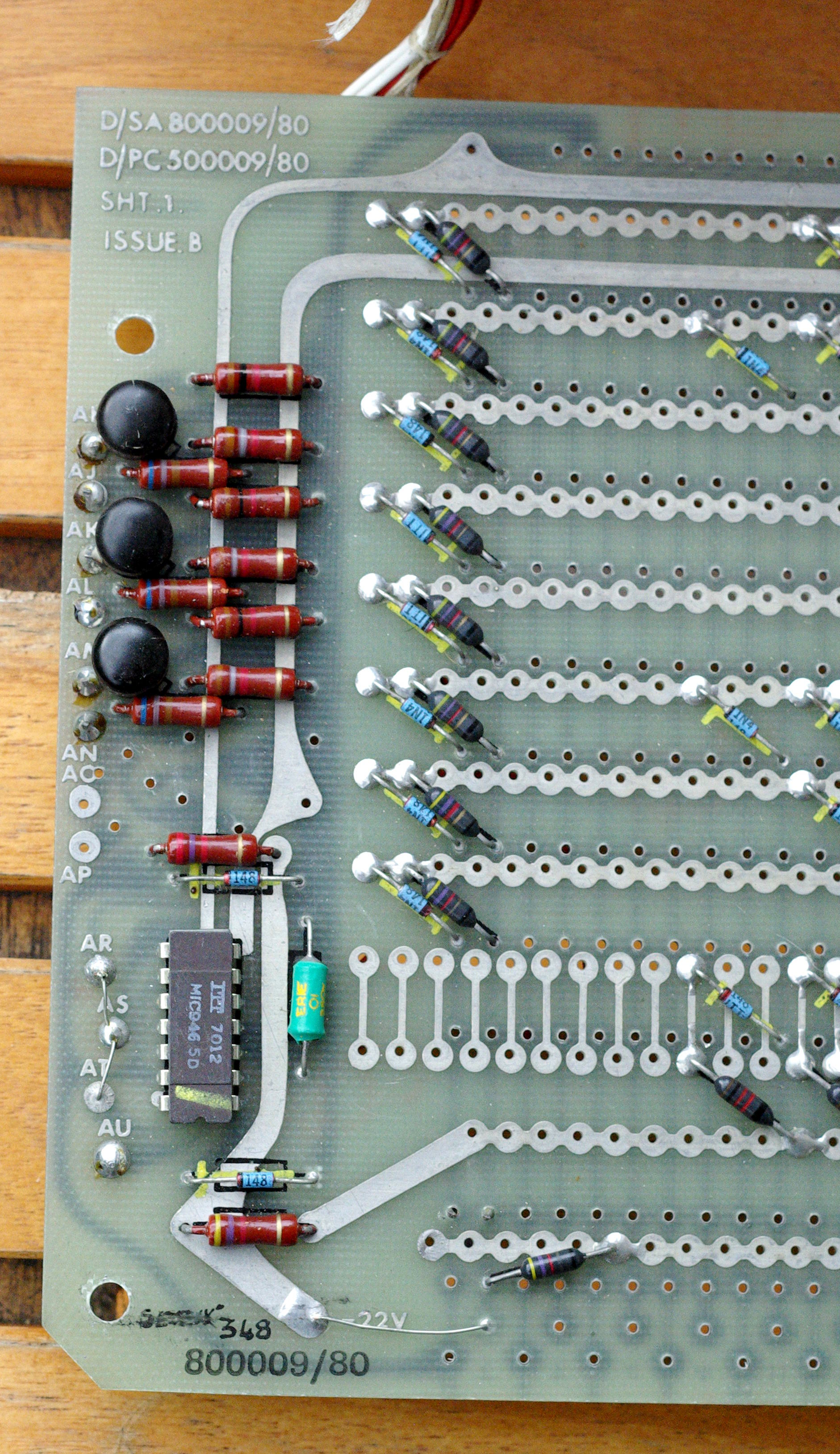

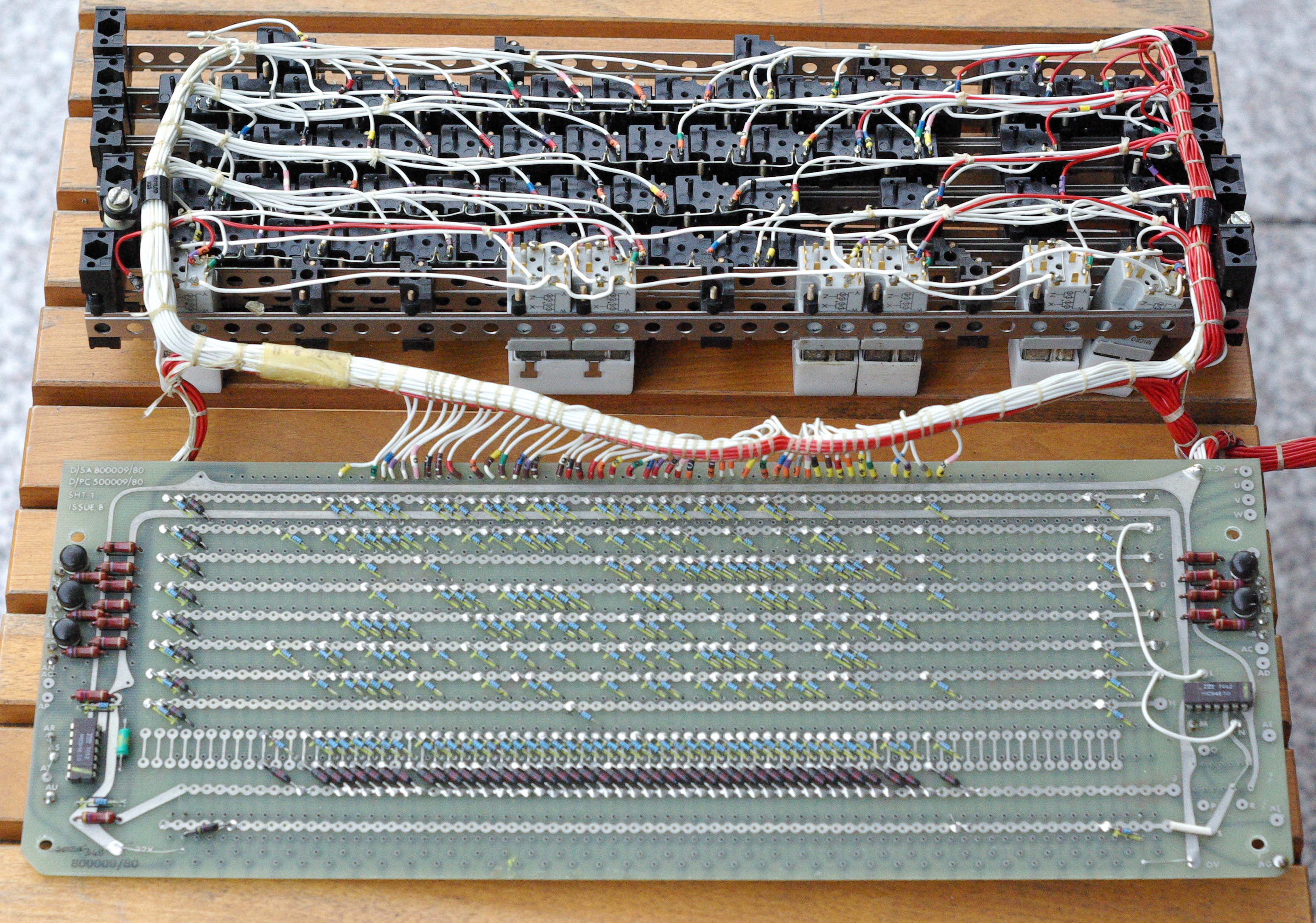

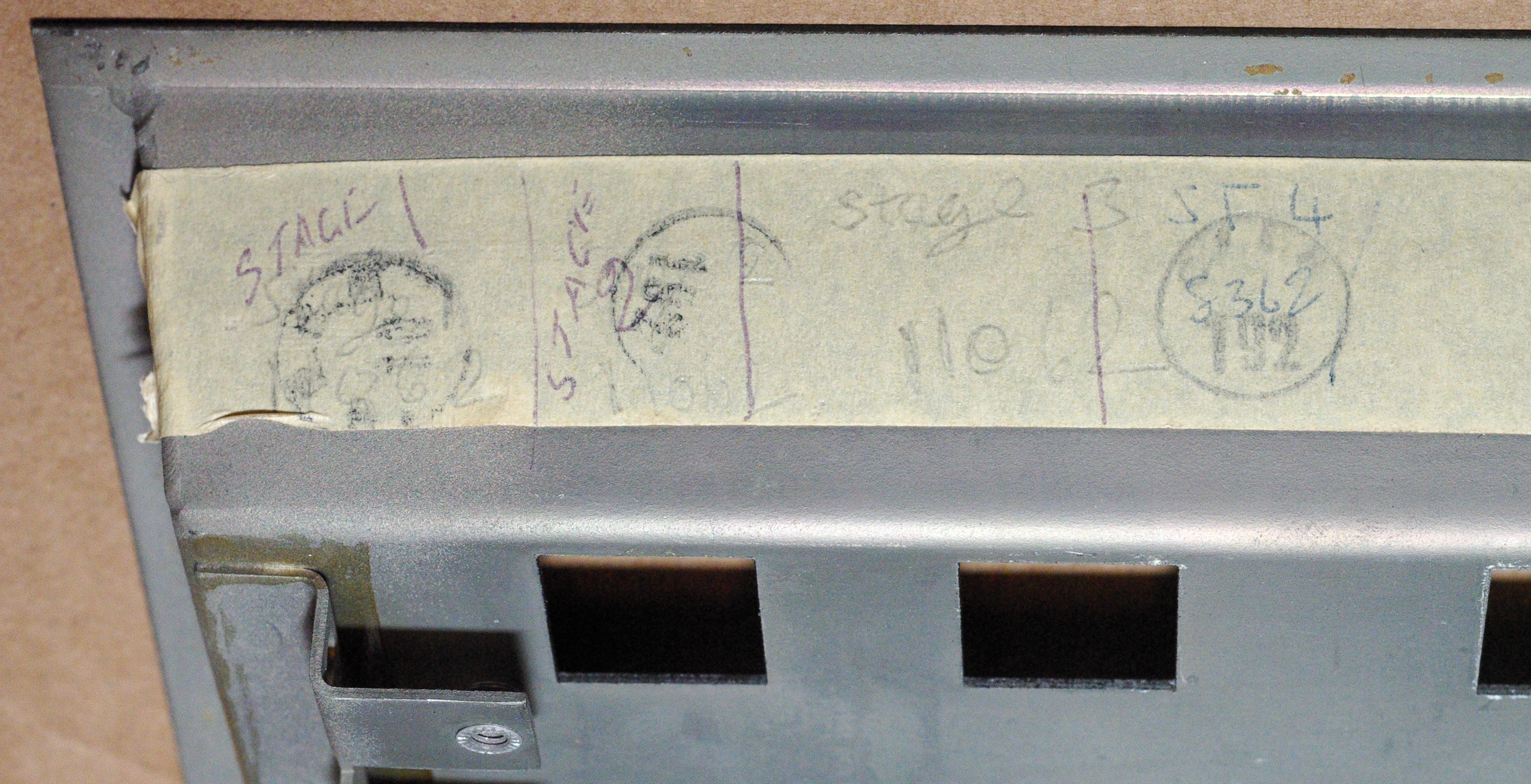

The most disappointing thing is that I do not know who manufactured this, not sure if we'll find out. There are some serial numbers on the PCB. There are some handwritten notes and stamp markings on a piece of tape inside the top part of the case. There are two numbers handwritten inside the bottom part of the case reading "368" and "800210/68"

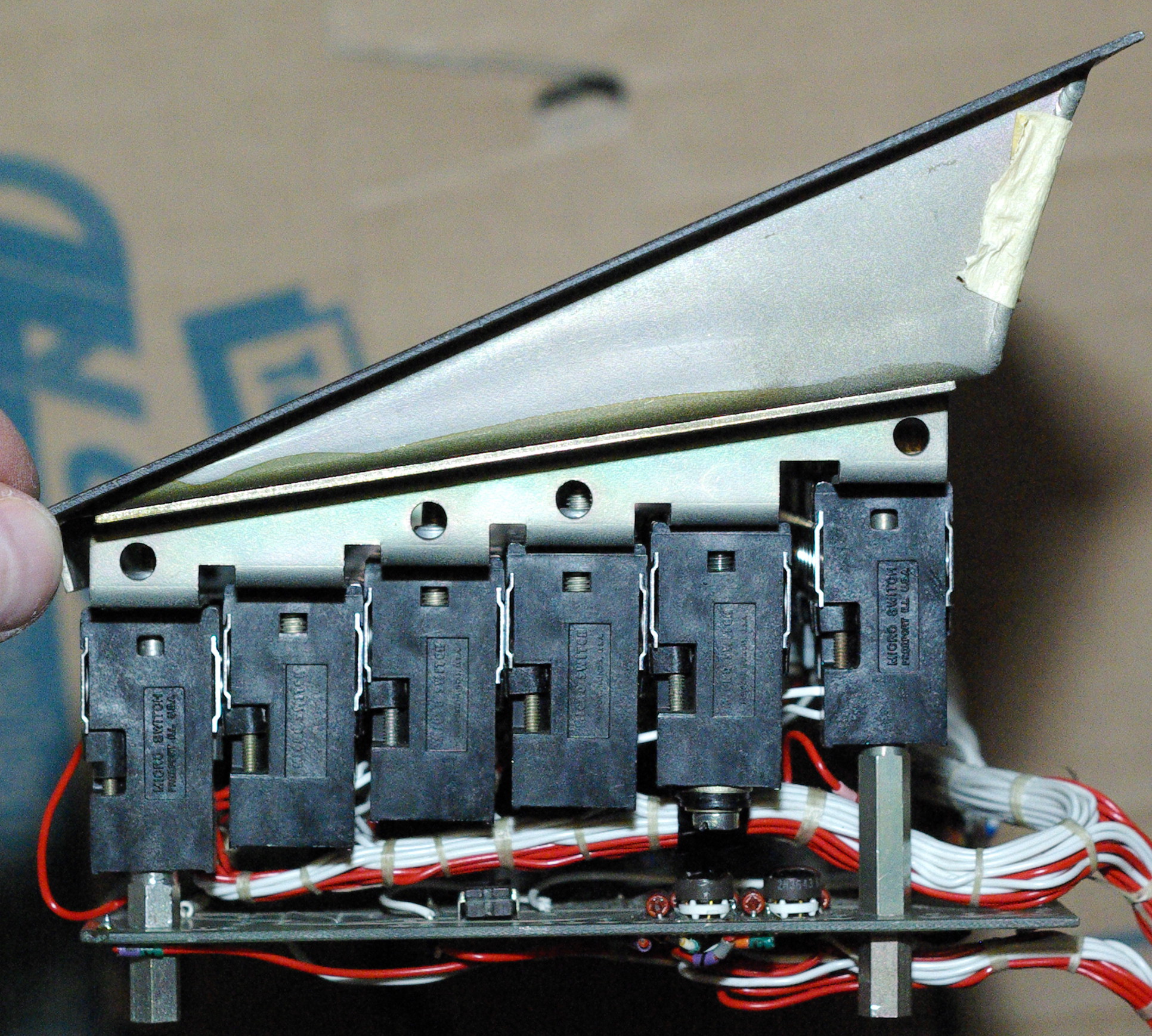

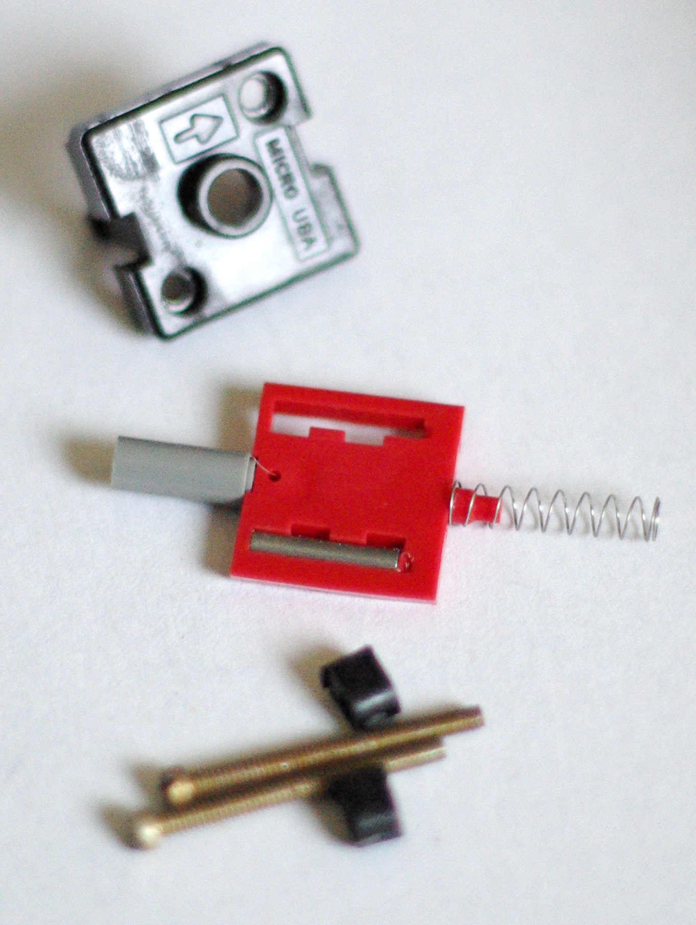

The switch housings are screwed to metal rows which are in turn screwed to these steps inside the top part of the case with long screws. Hand wired, but in a professional way.

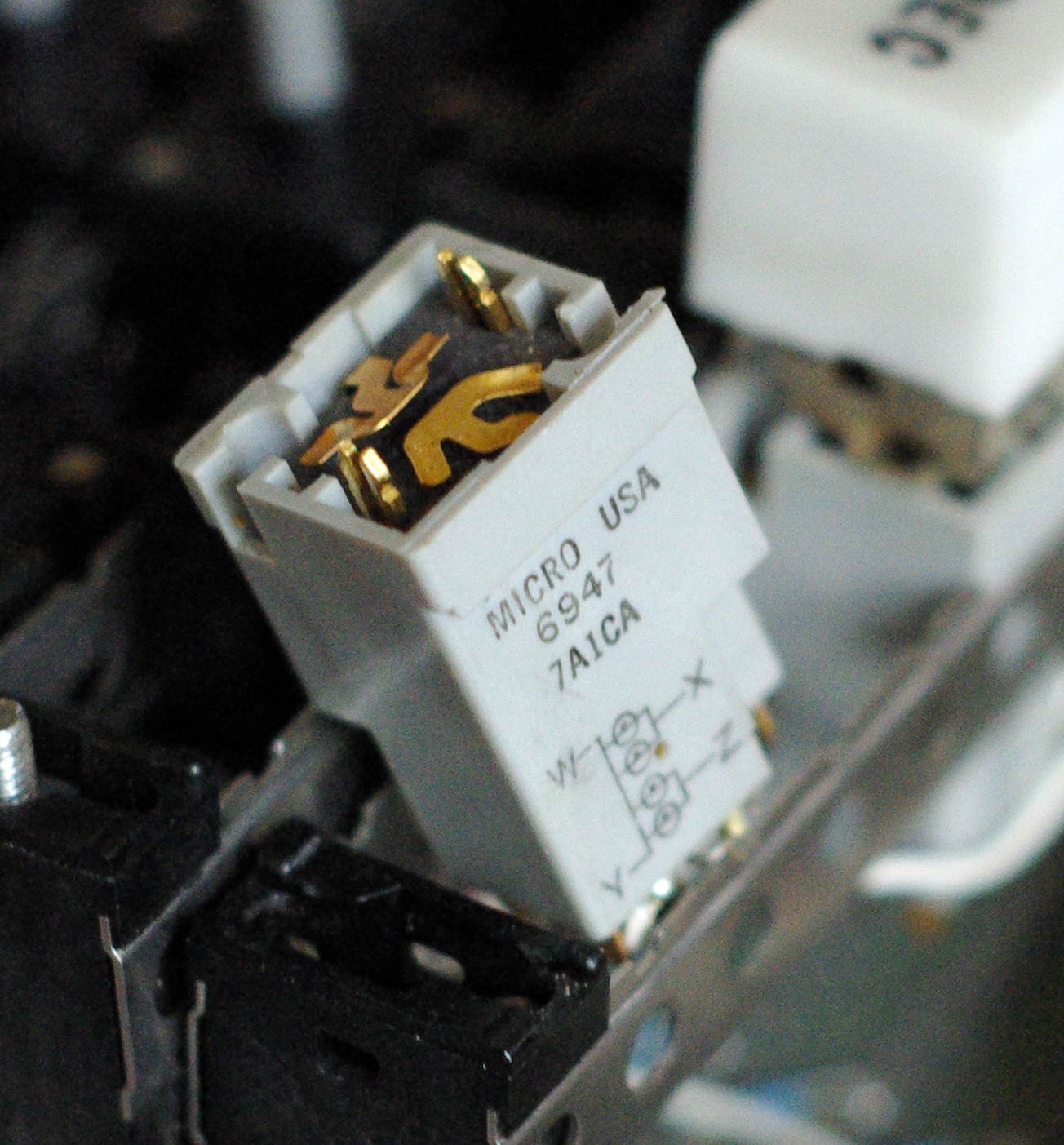

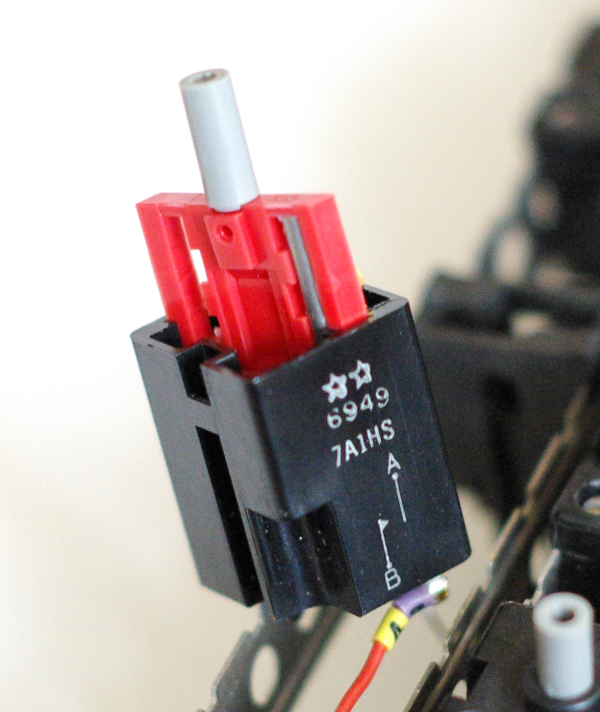

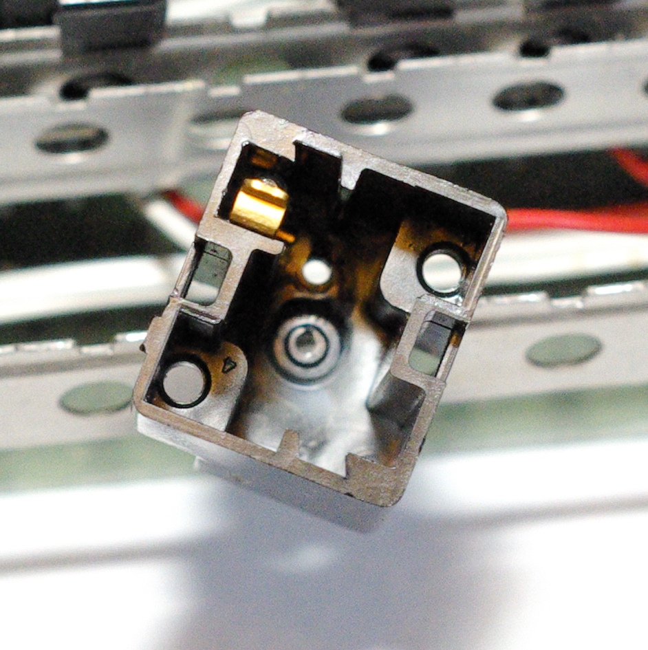

The top of the switch housing reads "MICRO USA". These are the same switches as in pyrelink's keyboard, Micro Switch magnetic reed switches. The switch housing very conveniently opens via two small screws at the top, the red slider sits at an angle across in the switch housing, the little metal bit inside the red slider being the magnetic contact.As pyrelink noted there are different markings on the side of the switch housings,I can read "6949 7A1HS" and "6950 7A1HS". Both switches feel the same to me.The switch is linear,very smooth and uniform in feel, impressive if you consider the age (which I do not know but estimate to be early 1970's or late 1960's). On a subjective "best feeling vintage switch that I own" scale this switch is number two behind Micro Switch dual magnet hall effect.

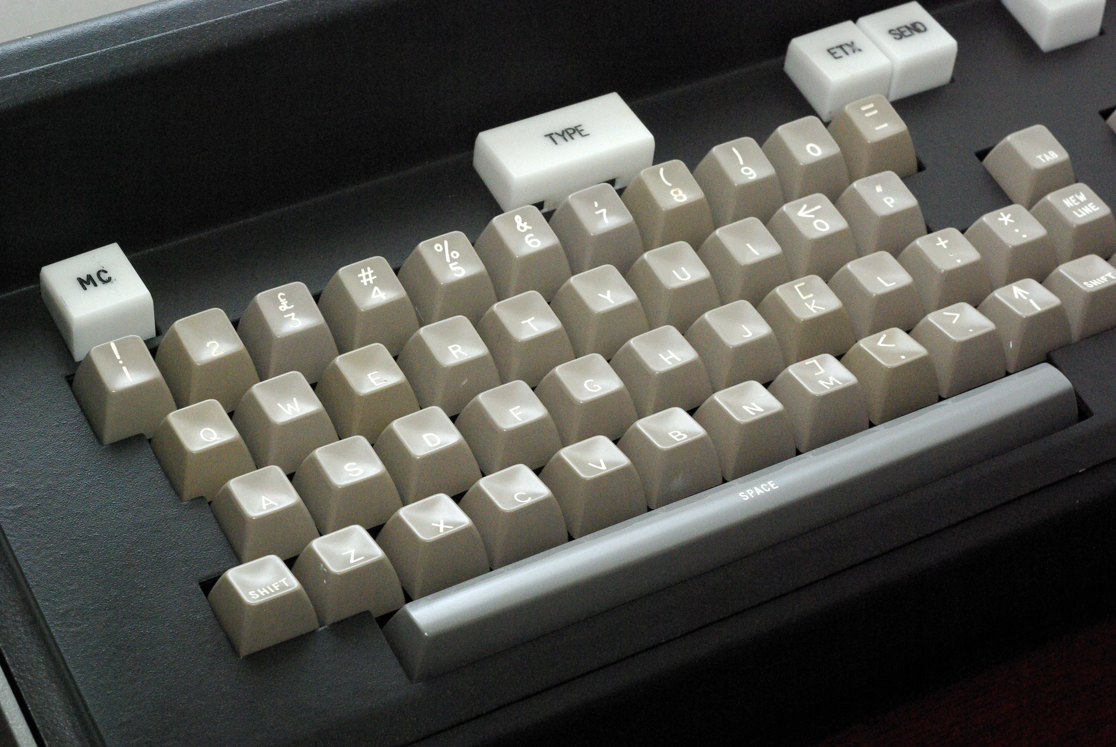

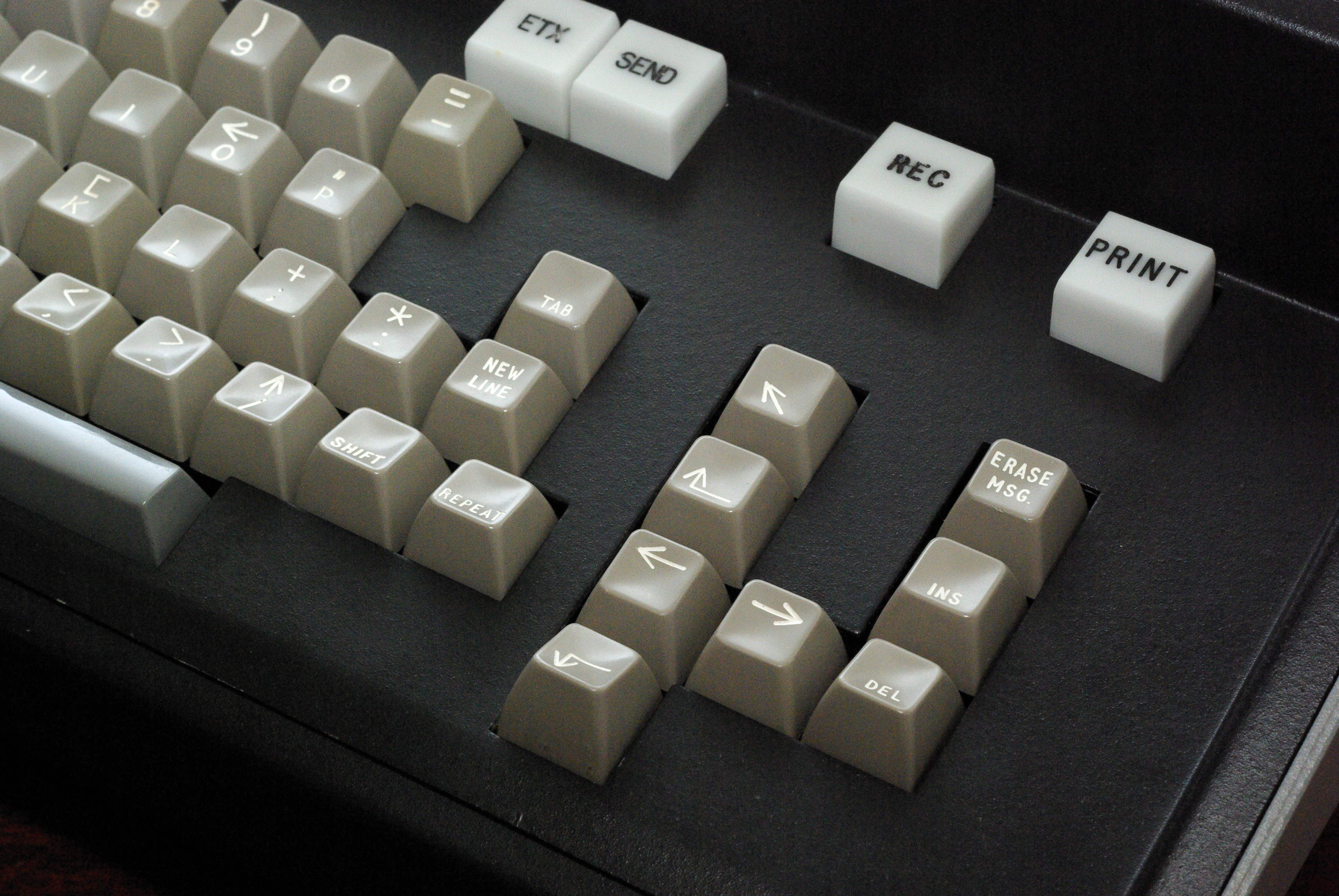

All the keycaps are engraved thick sphericals . There are visible imperfections on the engravings. The metal bit that goes into the slider does not come off on mine like it does on pyrelink's keycaps . These keycaps do not resemble my other Micro Switch keycaps at all.All single unit keys,"space" on the spacebar, also engraved. No return or enter key present,"New Line" instead."Tab" on the right hand side.There is no key stabilization, the spacebar is stabilized by two switches eight units apart instead.

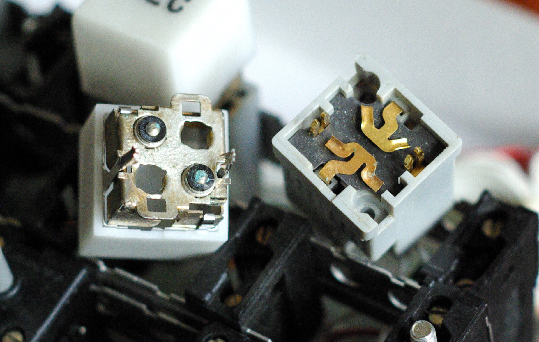

The top row large function switches are very different. They are clicky, quite loud and it looks like it may be a type of leaf contact mechanism.I can read the marking "MICRO USA 6947 7A1CA" on the side of the switch housing, the other side shows an electrical schematic.

Now that is an awesome looking keyboard. Clicky versions of that switch?! I am having a hard time figuring out how those switches click so more pictures of them would be appreciated. Did this board require an insane amount of cleaning to look as nice as it does or did it look pretty great to begin with? If I had to make an obvious guess, it would seem that someone else manufactured the keycaps with this specific switch in mind. The PCB and markings look very similar to a Honeywell Micro Switch board. Too bad there isn't a date code. Would be nice to know where this one fits into the timeline.
21 Nov 2015, 16:40
Thanks, only the large function keys in the top row are clicky. The Micro Switch magnetic reed switches are linear. The keyboard was quite filthy on the outside, suprisingly clean on the inside. Yes I agree, I also think that someone else manufactured the keycaps. mr_a500 should take a look at this, he might be able to tell us more.

pyrelink wrote: Too bad their isn't a date code. Would be nice to know where this one fits into the timeline.
The key switches are from 69 probably 47th week (6947 is a date code). There is also an IC on the board with a date code of 7012 which would be 1970 12th week. It all points to 1970. My Univac keyboard has different switches and are marked "7110" (10th week of 1970) so they re very close.
pyrelink
21 Nov 2015, 17:11
Oh wow, I didn't even realize that it was a date code on the switches as well. That would make sense as my keyboards' switches are 7030 and the date code on the keyboard is 7035.

Well I'm glad you guys enjoy it. ;) That's some good information snuci, thanks. If it's from 1970 then it's my oldest keyboard by far. But what about the shape of the case snuci? You think it may have been for some terminal?
snuci
Vintage computer guy
21 Nov 2015, 18:01
seebart wrote: But what about the shape of the case snuci? You think it may have been for some terminal?
I'm not sure. It may be for a paper based terminal (as opposed to a CRT terminal) or a teletype device but it is definitely something paper based due to the "Print" key. It has a ETX or "End of Text" key that was used to tell the remote computer it communicated with that it has completed sending the message. Looks like the device could record a message as well.
It is interesting but because it's from the early 70's it is just before most CRT terminals.

I had a photo of this exact teletype (or very close), but I've lost it somehow. Snuci is right. It's from 1970. (keycaps probably not Micro Switch)

Nice ad. I still find Micro Switch Hall Effect slightly smoother than Micro Switch Reed switches. To me what's at least as interesting as the switch on this one is the unusual shape of the case and the fact that all the keycaps are engraved.
mr_a500
30 Dec 2015, 23:07
Sadly, I have never had Micro Switch reed switches to compare. I have four 1974 Micro Switch keyboards, but nothing earlier.
30 Dec 2015, 23:12
Oh don't get me wrong, they feel very nice to type on. Strange that the metal adapter bit in the keycap does not come off on mine. Also these keycaps look very different from all of my other Micro Switch caps. I'm wondering if this even is a Micro Switch keyboard, apart from the switches we don't know.
mr_a500
30 Dec 2015, 23:17
As I said, your keycaps are probably not Micro Switch - probably some European supplier.
30 Dec 2015, 23:20
Right, I did buy it in the UK after all, but the seller could not tell me anything about it. Certainly the most unusual vinatge keyboard in my collection. Also the oldest.
