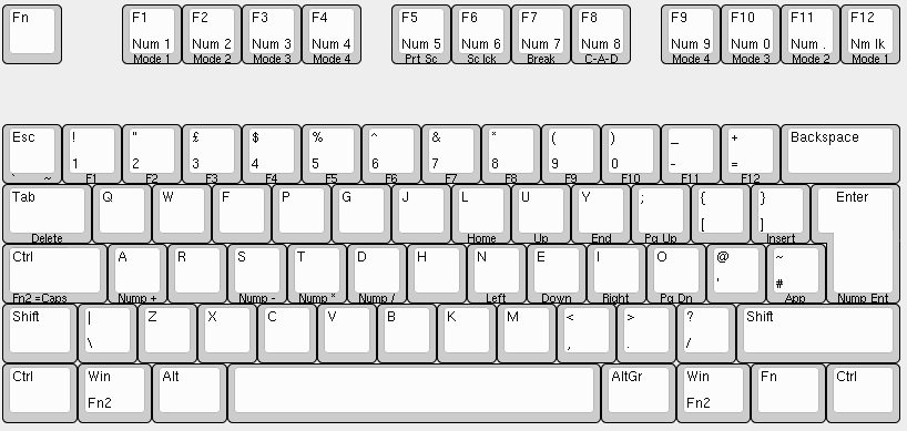

I like the width of the 60% keyboards, but they just don't have enough buttons to be practical for a programmer.
I therefore prefer to tack the F-keys to the top, seeing how my desk has no lack of vertical space: Mind you the 1u gap between numbers and F-keys is there mostly because I'm used to it, but also because it provides a resting spot for your fingers when you don't want to press F-any yet. I can only wonder how much metal / weight it would add though...
EDIT: Mode 1-4 is for hardware QWERTY to Colemak, Fn lock, F-key lock, etc. Also note that the F-keys have 3 legends, the small print is for Fn, the larger print is for Fn2. And yes, I sometimes use software which requires the numpad keys.
EDIT 2: Seems I forgot to add a HHKB Fn key on the right shift. I take it not everyone would like my palm-technique to press the bottom-right Fn key.

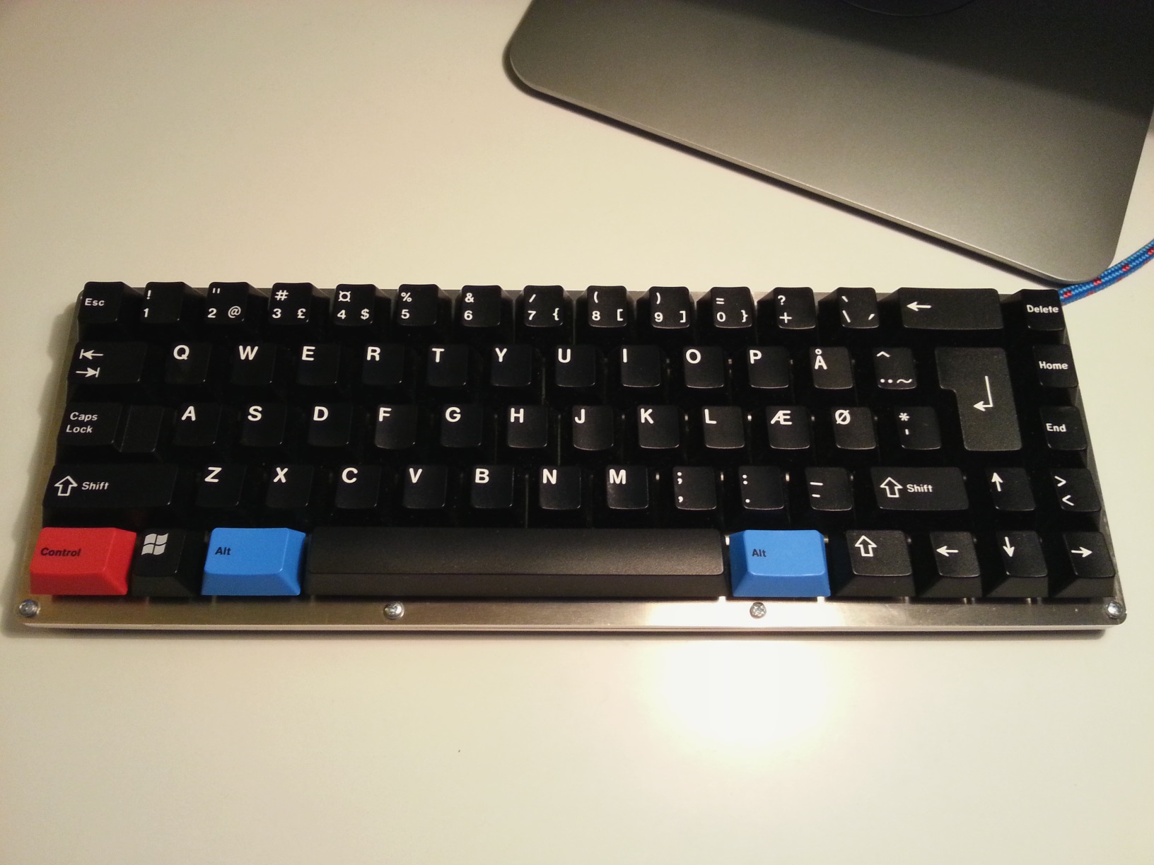

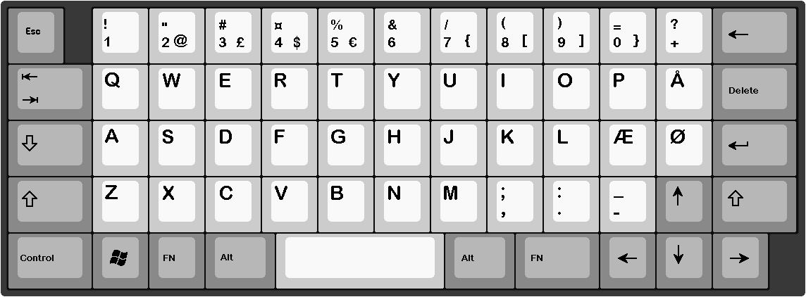

I've been fiddling with some ideas lately (yes, I am also still working on getting my keyboard finished from the last laser cutting gb
Here is what I had cut last time: If It had to accomondate a more standardized set of keycaps, I would go for something like the below. Bottomrow could be changed to 1.5 units instead and a 7u spacebar, but that depends on what key sets people would want to use. But what I really I want to try out next is a matrix layout: This was inspired by some of the more compact keyboards people have gotten into lately. I liked the idea of getting rid of the less used keys in the Nordic layout, and just adding them to the FN layer instead. That's also why I have moved the right ALT (which should have read Alt Gr) as far to the middle as possible along with the FN key, as it should make it easier to press them with the right thumb.

Because sometimes less is morematt3o wrote:why not filling the 3 missing keys to the right?Broadmonkey wrote:
But also, this way if you take a key cap set from a standard keyboard (eg. G8x-3000) you will be able to use it without any additional keys, and everything will be in the right profile. You can not do that if you fill out the three keys!

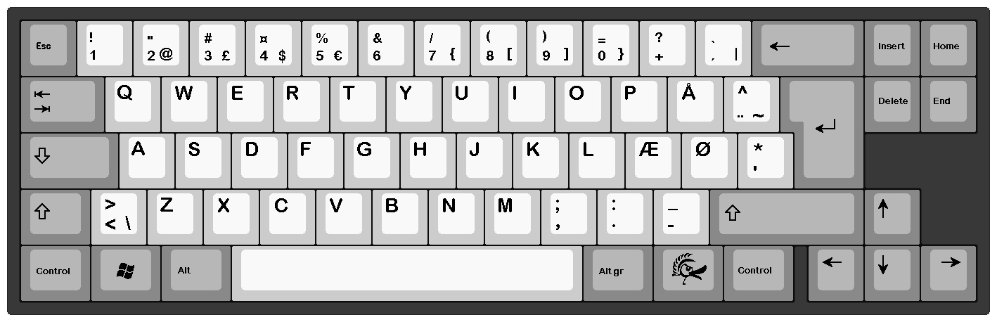

another iteration of the small pupil.

Nice with the longer space bar, to have 2 keys on the top right to P and another key to L and M (damn, note to myself: maybe add spacebars in size 7 in round 5 GB).
I would definitely want to handwire a board for myself, and have to decide which size it will be - today i thought it will be a 40%. Or it could also be a bigger 60% board with F-keys.
In this group build here it will be one layout which will be made?

this last one could be the Matt-4
(working title)
- Muirium
- µ
- DT Pro Member: µ
Move Del to the right of Backspace and that's a handsome board. But whatever are you using function keys on a Mac for? That's my platform, too, and I only use them for media control and Exposé.
