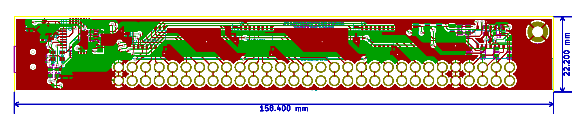

I'm a bit worried about the way the connector is mounted. On the 3278, the spot where the edge connector is just happens to be the shallowest point on the case - only 4 cm from the bottom of the case to the cover. It looks roughly 2.5 cm from the bottom of the case to the top of the connector, so if that PCB overhang is much more than 1 cm, it might not fit. Isn't there an edge connector that mounts sideways? (like the original board)
Yeah that's my worry about the connector. There's a guy on GH with a 3278 and a 5251. He's building one---if it fits his 3278 then that's great, otherwise it will go on his 5251.
The particular connector spacing (3.96mm) isn't terribly common these days and there's really only that one connector I could find. In the worst case a simple right-angle adapter could be made up from another strip of PCB and some right-angle header pins (although the corresponding holes would need to be shrunk as header pins aren't normally 2mm diameter).
Thanks for the dimensions. Depending on how I interpret them it sounds like it may work. Total board height is 22.2mm. From the top of the keyboard PCB itself to the top of the controller board it will be 16.1mm (assuming 1.6mm PCB). The edge connector is 16mm deep, and won't plug fully onto the keyboard PCB, so it will stick maybe 20mm or so into the back of the case.
webwit wrote:Hmm, would it work with this 5251 66-key variant?
Almost certainly; you'd just program a different keymap into it.

I still don't know 100% if it will fit in a 3278. I've found some new connectors, which have proper 1mm PCB pins on them instead of 2mm lugs, which will allow me to slim down the board a couple of mm more, and make it easier to make a right-angle adapter if necessary.
If anybody with a 3278 could help me get absolute dimensions (maybe cut something out of cardboard...?) as in the post above then that would be really cool.

Hm.... I'm not sure if it will fit 'at an angle' :
I'll make a model tomorrow to check if there is clearance enough ..
Posted: 14 Jul 2013, 04:36
by xwhatsit
Thanks Peter, those photos are handy. It'll definitely fit rotated at 90°, but that would need a right-angle edge connector (as IBM initially used) but I cannot find one anywhere. It'd need an adapter board with some right-angle pin headers, which is a pain as it's more expensive (for another (smaller) PCB, and the hard-to-source (but not impossible) 3.96mm right-angle pin headers).
I'm more worried if it'll stand upright (as I mount it in my 5251 and 3727, as you can see in the photos on the first page). It's a skinny board but maybe not skinny enough.
The new batch of PCBs I just ordered is modified for a 1mm-diameter-pin edge connector (which I've been able to find, yay: http://www.ebay.com.au/itm/140887820225), so in theory if somebody had a 3278 and didn't mind desoldering the original connector off the original controller you could do that I think. I wanted to avoid doing that as desoldering is no fun and you're having to modify something I'd consider original and historic.
Posted: 14 Jul 2013, 13:05
by bhtooefr
The other thing is, it looks like there's clearance to mount it upside down?
Posted: 14 Jul 2013, 13:58
by Peter
bhtooefr wrote:The other thing is, it looks like there's clearance to mount it upside down?
No, there is only about 0.9mm from the plate to the bottom of the PCB,
but you could make a cut-out in the plate I guess, probably 'better' than de-soldering the old connector
in regards to preserving this old relic-board ..
My modeling showed that there isn't enough clearance, but it's very close and the model was just
an approximation, not exact, also it didn't take into account that the connector moves the board 20 mm backwards,
so maybe it does fit after all .. Any news on how it worked for that guy on GH ??

No word from GH guy, I don't know if he's built it yet.
Ahhh that sucks. I keep scratching my head about a horizontal mount solution. No luck in finding a right-angle connector. Why IBM used 3.96mm pitch... it's very unusual (at least in this day and age, maybe it was very common back in the 70s?).
The only solution I can still see is an adapter board, using something like http://nz.element14.com/molex/26-48-124 ... dp/9732217 to mate to the main board. It just adds about 50% to the cost of the parts, that's all (the PCB still ends up having a large surface area and the pin headers are reasonably pricey because of the unusual size).
If you think it's really a no-go then I'll design an adapter board and figure out pricing for that.

Hmmmm...
Pretty damned rough, but might work! Designing the PCB with some nice big flat pads to bond to would make things easier.
I have the solder lug version with me now. The pins bend over pretty easily, there is some clearance but with enough solder it would work (and I think it would be robust). It wouldn't look particularly pretty though, mountains of solder!
When I get the pin version I'll check it out. The pins are round, so there will be less clearance in theory so that's great. However they still might need bending and that wouldn't work so well and there'd be less surface area.

Just (finally?) did some pseudoaccurate measurements, and it seems that it just barely won't fit in a 3278, by about 2mm. There's ~10mm of clearance to the top of the case from the original edge connector, as determined by compressing some tinfoil on top of it. I think that it's not too big of a deal, as it's obviously possible to shim the case top to be higher with some washers or somesuch...

@Parak: cool, thanks for that. I've just received my `PCB-mount' version of the connector. It's basically identical to the solder-lug version but the pins are skinnier, so that won't help for surface mounting. I still think surface-mounting is definitely possible, and the nice thing is that it would mean you could use either the PCB-mount or solder-lug connector on the same PCB. That's handy because I have 2 solder-lug connectors left but at least from OSH Park you have to order in multiples of 3 boards :P
I didn't think about shimming the case. It might look a bit ugly though—isn't the seam on the case visible on the sides halfway up, like the 5251/3727s?
I think some sort of jig or set of shims or something whiel soldering would be necessary to make surface-mounting the connector not look like arse. I'll have a play around tomorrow on my lunchbreak. If the pins are 3.96mm apart, let's say 3.8mm inside dimension taking into account pin/lug thickness, and the PCB is 1.6mm thick, that means 1.1mm either side to space out to keep it centered while soldering. I'm sure something can be found—if not, the nice thing about working at a rollformer manufacturer means there's plenty of 1.2mm steel coil sitting around :)

xwhatsit wrote:I didn't think about shimming the case. It might look a bit ugly though—isn't the seam on the case visible on the sides halfway up, like the 5251/3727s?
I thought about shimming the case, but I assumed it would look too awkward. I just checked and if it's only 2mm, it won't look as bad as I thought. Even 5mm is tolerable. The keys sink in a bit and you can see some of the bottom of the case from the side, but I could still live with that. (...hell, I'd probably even go caseless if I could actually use this keyboard)
Damn, it's a shame they don't make a right angled version of that connector. I've searched. You can get it in 4 different colours, but you can't get it right angled.
