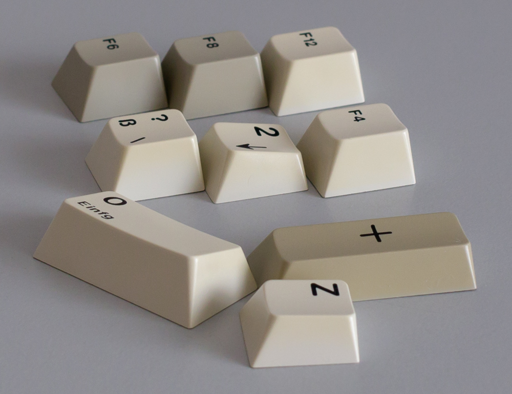

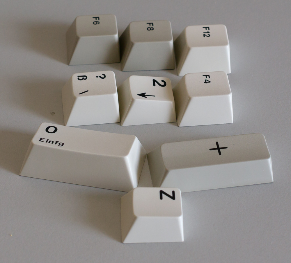

Posted: 07 Jun 2013, 15:20
by Jmneuv
Retr0bright is good for you!
.. after 2 mornings (~4 hours) in the plastic bottle in direct sunlight (and the rest of the first days in the shade).
First day removed the yellowing, 2nd was for good measure.
- P1040434.jpg (228.39 KiB) Viewed 7020 times
- P1040442.jpg (256.4 KiB) Viewed 7020 times
Posted: 07 Jun 2013, 15:30
by Muirium
Always amazing to see it in action.
But does it last?
Posted: 07 Jun 2013, 15:44
by Jmneuv
Of course this will not be tried.
Caps remain in a box while i continue using my RD.
