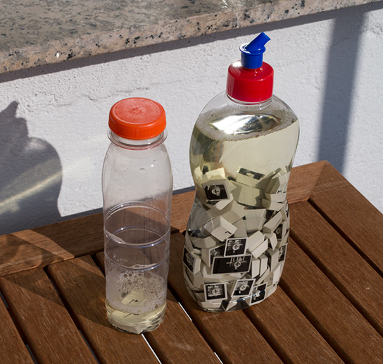

Finally my attempt is underway.
Managed to get my oxi powder solution clear this time by doing 2 things:
.used distilled water at ~80°C (we have a fair amount of lime in the tap water)
.ground the powder finer on a piece of paper with a tool handle (just a quick pass)
this also helped to dissolve it pretty much instantly
(was too stingy to buy liquid vanish)
- P1040439.jpg (170.05 KiB) Viewed 7052 times

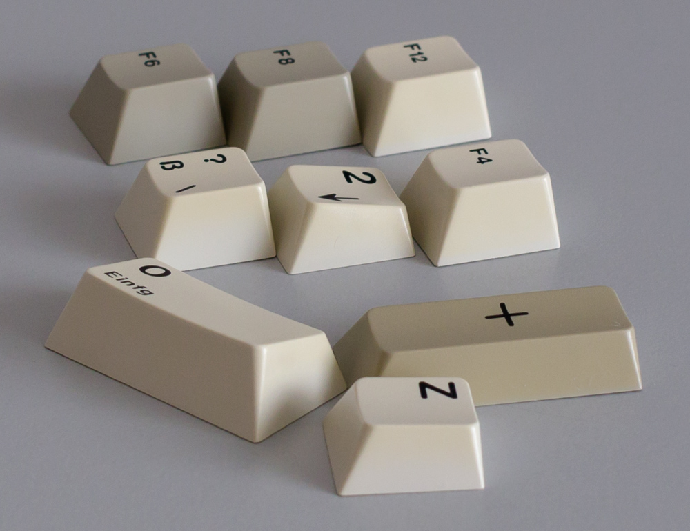

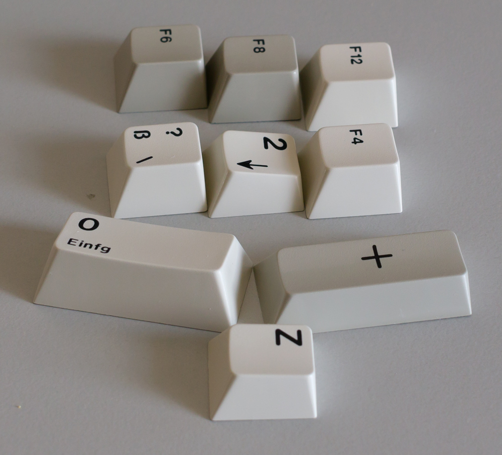

I'm also running an experiment. I retrobrighted a set of caps last year and photographed with reference white. Time to check the current status.

I took back the keycaps I retrobrighted last year. If it's sunny tomorrow I'll take the same reference pictures. At first sight I wouldn't say they re-yellowed much (if at all).

Good sign. There's definitely a lot of variables at play. Especially whether the treated plastic has been kept out of UV light, and heat. I'd keep your experiment running for several years if it's not inconvenient, to get a sequence of pictures.

I believe it's all down to how much they are yellowed to begin with, but anyway I'll keep the experiment going for the years to come. I have no use for those keys (they are the spares I won't use from an ALPS set).Muirium wrote:Good sign. There's definitely a lot of variables at play. Especially whether the treated plastic has been kept out of UV light, and heat. I'd keep your experiment running for several years if it's not inconvenient, to get a sequence of pictures.
