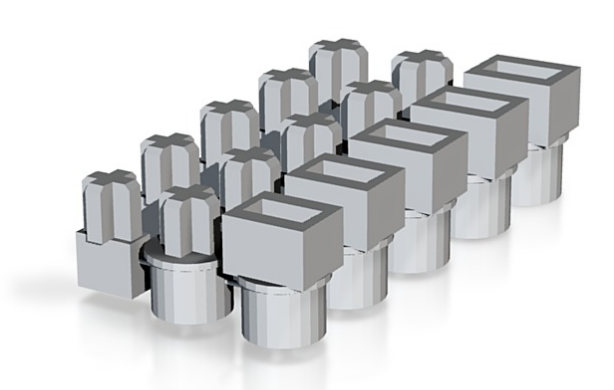

Posted: 22 Aug 2014, 01:08
by Mrinterface
Schermafbeelding 2014-08-22 om 01.00.58.png (139.21 KiB) Viewed 11866 times
Kudos for the person who guesses the reason for the cherry to cherry mount....
Posted: 22 Aug 2014, 01:15
by Muirium
For 7bit's all important Hyper7's top rows?
Or maybe you don't mean MX to MX, but one of Cherry's other mounts.
Am I right in guessing the other two are: Topre to MX caps, and Topre to Alps caps adapters?
Posted: 22 Aug 2014, 03:12
by rklm
Are the Cherry to Cherry adapters for keyboards with both kinds of switches, to make them all the same profile?
Also, WHEN?!
These would make the world a significantly better place... for a few at least!
Posted: 22 Aug 2014, 08:15
by Kurk
Cherry-to-Cherry: off-center caps lock?
Posted: 22 Aug 2014, 15:03
by Muirium
Or a spin on that idea: off centre for G81 mods to fit on MX keyboards? That's be pretty handy. Although I wonder how stable it feels.
Posted: 22 Aug 2014, 15:30
by Nuum
Maybe the Cherry to Cherry mount is for keyboards with mixed switches (Alps and Cherry MX) to keep them all on the same height when using a Cherry MX Keyset?
Posted: 22 Aug 2014, 15:34
by 7bit
These are for Cherry stabilisers to be used with Cherry keys when using the extenders for the Alps switches.
The use of extenders for the Hyper7 is not necessary, because the keyboard will look like this from the side:
Image :o
Posted: 22 Aug 2014, 19:50
by Mrinterface
The MX to MX-alike adapters are for my vintage home-made Memotech MTX Keyboard replacement... :-)
Also -> if I'm not mistaken, BBC Micro keyboard keycaps can then also be fitted to either Cherry MX or Alps. I will check when I get the adapters....

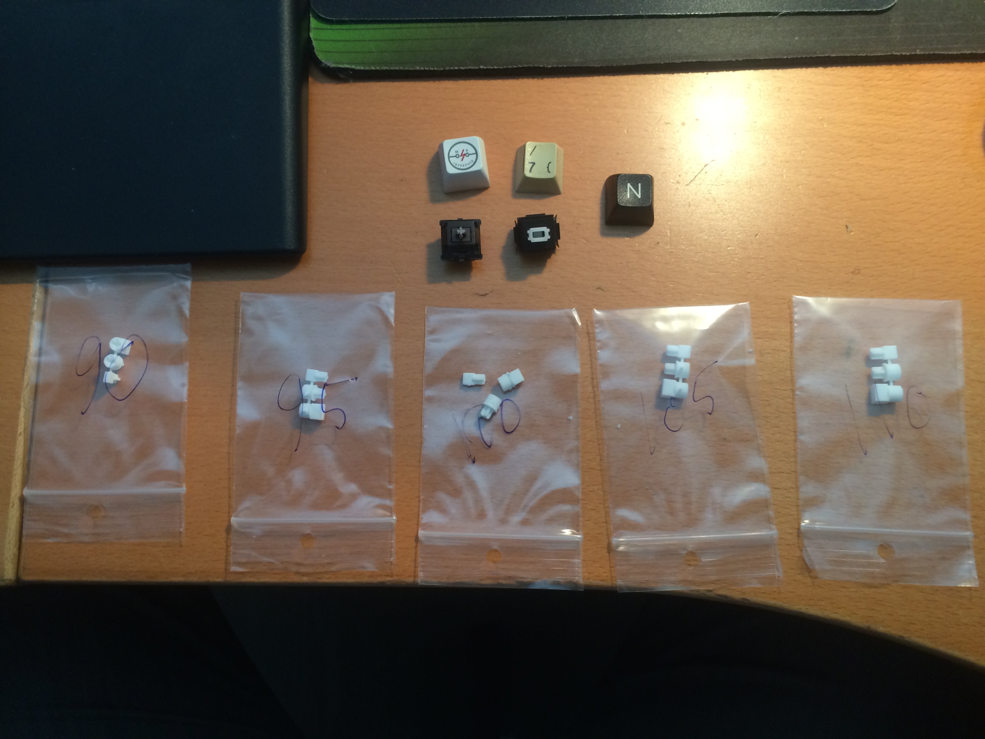

When is it ready? I'll have the adapters shipped from Shapeways next week. I designed the adapters in slightly varying sizes to check what the best fit would be. Then I'll create separate adapter grids you can order at Shapeways. I think I'll create grids with 120 adapters so you guys would have some spares :-)

Let the games begin!!!!!

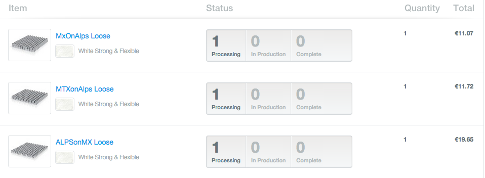

by Mrinterface
Schermafbeelding 2014-08-28 om 16.56.58.png (75.31 KiB) Viewed 11595 times
Ordered them as 'loose' parts, so unconnected adapters...
Now we have to wait another week before shapeways delivers :-)
