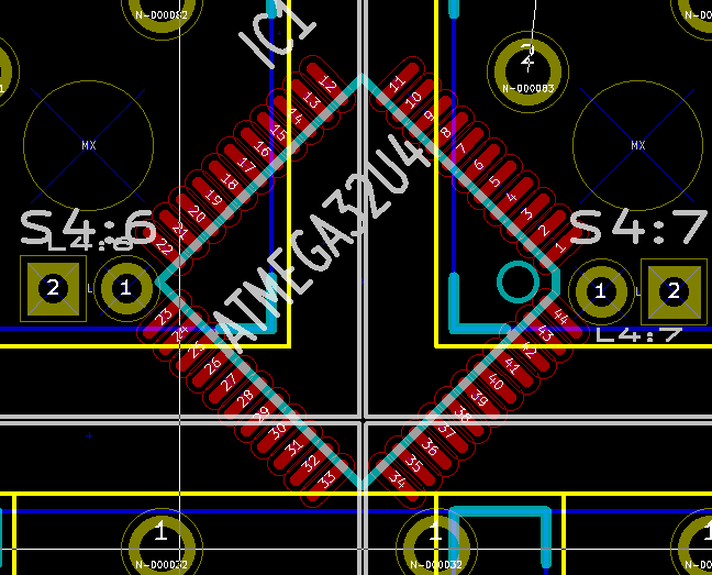

Once I finished the PCB-layout, you more experienced people can take a look if everything is OK. Then comes the prototype ...
ATMega32U4 is on the GH60, so if it works for them I don't see why it should not work on the HyperMini. The alternative is you solder wires to pads spread accross the PCB.
bpiphany
- Location: Stockhom, Sweden
- Main keyboard: Symmetric Stagger Board
- Main mouse: Kinzu
- Favorite switch: Topre
The ATmega32u2 does make a perfectly fine keyboard controller. I don't know if it is capable of acting as a mouse at the same time though. That is a question for someone more experienced in the AVR controllers. The ATmega32u4 is the most common choice for keyboards so far, much due to the Teensy being one of course. The TQFP44 package is really one of the simpler SMD jobs you are going to get. But it is big, the QFN-packages are a lot smaller, and really only for re-flow soldering.
It's not too hard getting a matrix of push buttons hooked up to a controller working (hey I did it...). The only issues I've ever heard of is EMI, and that should probably be handled by the firmware anyway.
But don't expect anyone to just sign off on your PCB design. It takes time to get into it properly, the kind of time you spend to draw the damned thing to start with =D Better to ask someone on the schematics in that case.

I understand next to nothing ...
Why should something which works on the GH60-PCB not work here?
The LED pads can be made just holes, so they don't get into the way at all.
Pin 34 should be far away enough to not interfere with the soldering pad of the switch below.

If it's the controller you are talking about, the GH60 is using the TQFP44. The crystal is going to be more of a pain to solder. There are larger SMD crystals with leads, and there are through hole crystals as well. They are all a lot larger than the lead-less ones.
The GH60 schematic should work fine.
The measurements for the TQFP package is at the bottom of the ATmega32u4 datasheet, this is where you usually find component physical specifications. http://www.atmel.com/Images/doc7766.pdf
You just need to do it right.. but you can specify several track widths in KiCAD under the design rules dialogue. And also different via dimensions. Once you have more of them you can switch between them while drawing traces, by right clicking.

Thanks for clearing this up.bpiphany wrote:If it's the controller you are talking about, the GH60 is using the TQFP44. The crystal is going to be more of a pain to solder. There are larger SMD crystals with leads, and there are through hole crystals as well. They are all a lot larger than the lead-less ones.
Just for better understanding:
The ATmega32u4 as on the GH60 is only on the backside, so tracks can go above, right?
This is exactly what does not work. I can add endless many to the list, but can only coose the Default one.bpiphany wrote: You just need to do it right.. but you can specify several track widths in KiCAD under the design rules dialogue. And also different via dimensions. Once you have more of them you can switch between them while drawing traces, by right clicking.

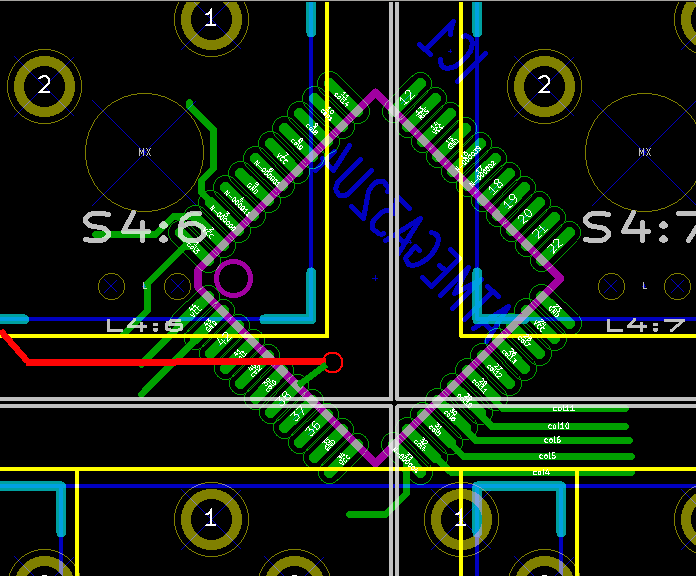

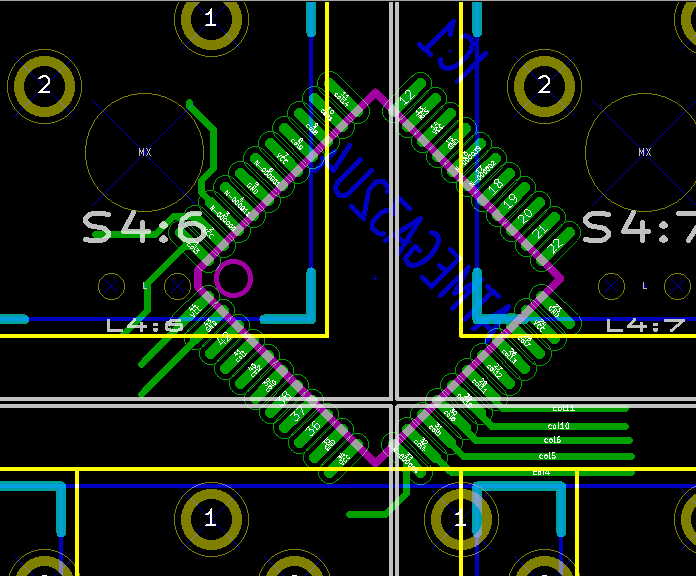

Just realised the controller must be on the underside.
Also, I must turn it by -90 degrees, because the USB-pins should point to the top.
I also need to sort the columns. The GH60 is quite messy, or is that on purpose?
Does anybody know if I can put vias directly under the pins?

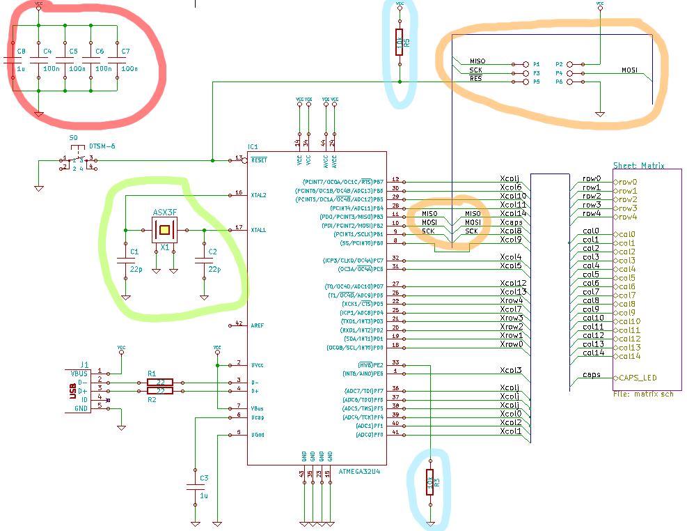

I've stolen komar007's scheme file of the controller.
I've added some more column and row-positions.
Can someone explain what the marked components are for?
Especially the stuff marked in orange I do not understand.
- komar_scheme_questions.png (60.99 KiB) Viewed 12575 times

red - power supply decoupling capacitors. The large one can go almost anywhere between the socket and the CPU. The smaller ones should be one per power supply pin on the CPU, positioned as close as possible to the pin.
green - crystal oscillator.
blue - resistors to a) hold reset high unless the switch is pressed, and b) to hold PE2 low. See the datasheet for Reset option.
orange - Programming connection. You can omit this if you have a bootloader already on the chip.

What does your mapping of matrix rows and columns to keys look like? And theirs? Did they use the autorouter?7bit wrote:Just realised the controller must be on the underside.
Why put vias under pins? You could put a small track towards the middle of the chip instead.
You should also think about adding a ground plane, at least under the chip.

Thanks for clearing things up!Soarer wrote:...
What I still do not understand is where the power supply decoupling capacitors are connected to (ie which pins).
Programming connection: These are only active in programming mode and can therefore be the same as row/column connections, right?

I think these connections where just convenient to the controller placement. Just found it strange that adjacent rows or columns where not connected to adjacent pins.Soarer wrote:What does your mapping of matrix rows and columns to keys look like? And theirs? Did they use the autorouter?
So it is possible to have a green track going from the pin above (remember the controller is on the underside) the controller. Great!Soarer wrote:Why put vias under pins? You could put a small track towards the middle of the chip instead.
What is a ground plane?Soarer wrote:You should also think about adding a ground plane, at least under the chip.

They are all connected between Vcc (+5V) and ground, but one per Vcc pin on the chip, close to each pin and with a short, direct PCB trace to the pin. TBH, I think 4 is overkill.7bit wrote:What I still do not understand is where the power supply decoupling capacitors are connected to (ie which pins).
I suppose they could, I never really thought about it. If you're happy to just use the DFU bootloader that's pre-installed on the chips though, you don't need them at all.7bit wrote:Programming connection: These are only active in programming mode and can therefore be the same as row/column connections, right?
- Soarer
- Location: UK
- Favorite switch: F
Oh, you mean the mapping of rows and columns to pins. Hmm. I dunno! The pins don't have a lot of logical order to them anyway (ports are split around the chip in many cases).7bit wrote:I think these connections where just convenient to the controller placement. Just found it strange that adjacent rows or columns where not connected to adjacent pins.Soarer wrote:What does your mapping of matrix rows and columns to keys look like? And theirs? Did they use the autorouter?
Something like this... could be even closer to the pin's pad, I just used paint...7bit wrote:So it is possible to have a green track going from the pin above (remember the controller is on the underside) the controller. Great!
- 7bit
- Location: Berlin, DE
- Favorite switch: MX Lock
- DT Pro Member: 0001
I think it is better to have them, because the thing will be dead if the controller forgets about the bootloader.Soarer wrote:I suppose they could, I never really thought about it. If you're happy to just use the DFU bootloader that's pre-installed on the chips though, you don't need them at all.
