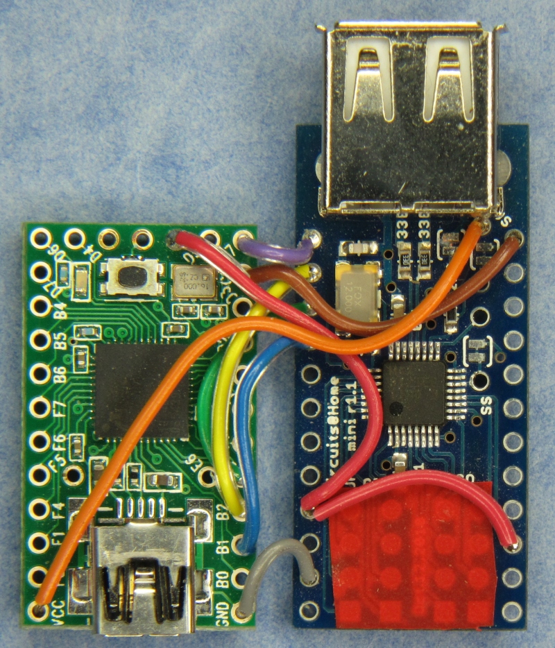

Posted: 31 Oct 2012, 03:26
by Soarer
Right, got it working... simply a config setting in tmk_keyboard/protocol/usb_hid/USB_Host_Shield_2.0/avrpins.h: needed to uncomment #define BOARD_TEENSY to get it working with the Teensy 2.0 + Mini shield combo.
Posted: 31 Oct 2012, 07:45
by fossala
Soarer wrote:Right, got it working... simply a config setting in tmk_keyboard/protocol/usb_hid/USB_Host_Shield_2.0/avrpins.h: needed to uncomment #define BOARD_TEENSY to get it working with the Teensy 2.0 + Mini shield combo.
Got any pictures, pictures are always good.
Posted: 31 Oct 2012, 13:45
by Soarer
The next step will be to fold it over and use header pins in some of the spare holes to hold it together.
