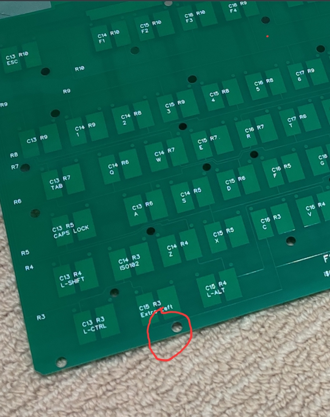

DMA wrote: 19 Nov 2022, 17:05 Since we're editing PCBs - please add vias between floating pads and the pads under them - one small via, somewhere in top 3mm of the pad.
I guarantee you this will result in way better signal when key is pressed, without affecting the resting state - which, in turn, will virtually guarantee lack of xwhatsit-specific problems with sensing.
I have been told by multiple people who are far smarter than me to not use VIAs on thin, curved PCBs, so I hope you understand my reluctance. I could try this out in the future, as I will definitely be designing more capacitive PCBs, but for now I want to try to limit the scope of this project: the more innovations I try to include, the longer it will get pushed out.
The FSSK PCB is a known working PCB, and although I'm sure it can be improved, I don't think now is the time, at least not for me.
I understand that you know way more about electrical engineering than I do and I really appreciate your feedback; please don't take this as an insult.
Icarium wrote: 19 Nov 2022, 17:43 Maybe this question is kind of off topic but if you're redoing the plate and PCB why not add more keys to the bottom row? :)
Adding keys requires means redoing the matrix and routing, which I am not comfortable doing on diptrace. The FSSK PCB I am using is actually the FEXT v1.00B, which is a fullsize PCB that has been designed so that the numpad does not share any columns with the rest of the board and can literally just be deleted.

taylorswiftttttt wrote: 20 Nov 2022, 06:14 Unfortunately the 74AHC595D,118 shift register used in the SMD Model F Controller is out of stock on JLCPCB's in-house parts inventory.
I can serve as a PCBA shop if you send me the parts, PCBs and a stencil (although with no QFN parts stencil isn't really required, I can just hand-solder it all). Will even do initial programming. May even be cheaper - depending on parts costs.
taylorswiftttttt wrote: 20 Nov 2022, 06:14 I have been told by multiple people who are far smarter than me to not use VIAs on thin, curved PCBs, so I hope you understand my reluctance. I could try this out in the future, as I will definitely be designing more capacitive PCBs, but for now I want to try to limit the scope of this project: the more innovations I try to include, the longer it will get pushed out.
The curvature is pretty small, so risk is virtually zero - but ok, I semi-understand. You are driving that part, after all. Double-check, however, that you don't touch any traces with your edits - xwhatsit (at least the exemplar I had my hands on) _severely_ overdrives the columns, and column traces locations and lengths _are_ pretty critical. Same goes for extra keys - unlike the vias, it's a _real_ minefield for xwhatsit-based designs.
taylorswiftttttt wrote: 20 Nov 2022, 06:14 I understand that you know way more about electrical engineering than I do
I don't. But I have 3 F122 PCBs in my garage with pretty interesting modifications. So the vias advice comes from practice - it boosts the readout about 6x, which boosts the SNR about 6x.
taylorswiftttttt wrote: 20 Nov 2022, 06:14 please don't take this as an insult.
None taken - you're driving this, it's your authority.

DMA wrote: 20 Nov 2022, 06:54 The curvature is pretty small, so risk is virtually zero - but ok, I semi-understand. You are driving that part, after all. Double-check, however, that you don't touch any traces with your edits - xwhatsit (at least the exemplar I had my hands on) _severely_ overdrives the columns, and column traces locations and lengths _are_ pretty critical. Same goes for extra keys - unlike the vias, it's a _real_ minefield for xwhatsit-based designs.
I will have to try this out the next time I order capacitive PCBs.

The wire I ordered from digikey came in a couple days ago. It was a failure. It has too many strands per wire and they won't fit in the holes. Ribbon cable with fewer strands per wire may fit in the holes. However, ribbon cable like that may not work anyway, because the PCB sits flat against the back plate and the wire has to be soldered in a way that doesn't lift the PCB up too much to avoid over-stressing the PCB. Then, because of the tight clearances in the top of the SSK case, it has to make a very sharp bend downwards.
I used a 40-pin IDE cable for my SSK. It is also not ideal but it works.
At this point, I think I'd like to forget about including wire and let you guys connect the controllers however you see fit.

by dcopellino
Great update for a great project. This MF things and their derivatives are becoming more and more popular here on DT even though it's already been several years since it was introduced by i$.
My 2 cents advice, regarding my previous experience with jlcpcb, is this: pay attention to the circuit path highlighted here in the attached pic.
Mine was interrupted by the hole, and I had to patch it up
Re: [IC] FSSK Metal Plate | Plates & Foam Ordered
Posted: 21 Jan 2023, 17:41
by Muirium
Good point. Looks like an accident waiting to happen.
I see the affected key is the “extra” pad, between Control and Alt on an OG SSK. Does a flaw in that trace disable that one spot or does it take out other (actually populated) keys on the matrix?
