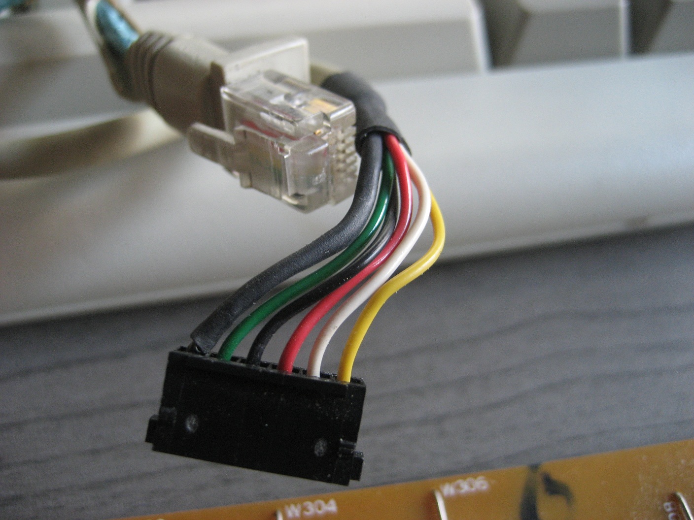

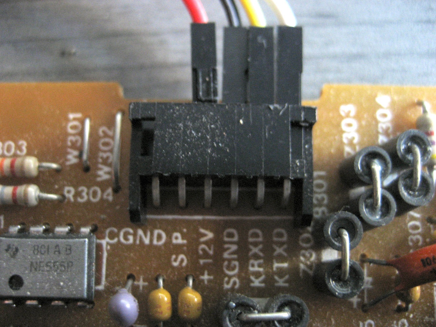

dirge wrote:You're much better at this type of thing so would you offer some advice on how I could start getting this http://keyboardporn.com/mx-switch/wyse-wy60-terminal/ converted?
Just need to know how to start, have breadboard, teensy2, female connector for the WYSE. I'll try not to be a massive pain in the arse :)
I'm going to assume for now that its signalling is something like the two shown on kbdbabel...
It will be quite hard work, I think. The problem is that it runs pretty quickly, so the code on the Teensy would have to keep up. Responding to an interrupt reliably within 17uS is actually quite a challenge, since every other interrupt routine has to finish within that time (mainly this is the USB interrupts). That can only happen reliably if they are written to not block other interrupts. That said, it's not impossible.
It would be far easier to replace the controller though!

Thanks mate, that helps a lot.
Working on the key matrix, following sixty's instructions. I'll take my mess out of your thread now, but I do plan to make one of your converters too :)

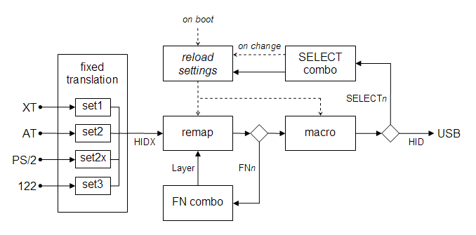

I have made CapsLock an FN1 key, but now I was wondering if I could make some key on the Fn layer into a caps lock toggle.
Is it possible to write a macro which is activated using Fn + LSHIFT + RSHIFT?

Not without remapping one of the shifts in the Fn layer to something which would just be used to trigger the macro. So, for example, remap Fn + RSHIFT to EXSEL, and then macro on LSHIFT + EXSEL. Not ideal perhaps, because then you've lost your Fn + RSHIFT, and you have to press the shifts in the right order.
I would either do it just as a remap (Fn + single key), or have it as a macro in the base layer as LSHIFT + RSHIFT (actually, that would be all layers where you didn't remap the shifts). In the latter case, it helps to also add a second macro that is on RSHIFT + LSHIFT, so that it doesn't matter which order you press them in.
In case it helps understand it, the macro stuff happens distinctly after the remapping stuff, and the layers are part of remapping...
Macro triggering is complex enough already, so I'm reluctant to add more to it by combining those blocks!

Ah, that's a handy chart. I've been experimentally building some other macros to counter an Fn remap so I figured it would work like that.

I use the double-shift myself, in the base layer, and find it feels quite logical. But, indeed, Fn + NumLk would also make good sense :)
There is some logic behind the way it works at the moment - in effect layers just give you a bigger virtual keyboard, and then you can define which keys of that bigger keyboard trigger macros. I admit though, it does fail on modifiers, as in your example.
I could add a bunch more fake HID codes, perhaps called MACRO_1 etc, that you'd use to remap to if you just wanted the keys to trigger macros, so config files remain readable. (You'd still have to write the macro trigger etc). Although it's not really any different to using some of the strange (and unrecognised by Windows) codes such as EXSEL, it would make more codes available for such use. And/or I could allow numeric codes to be used. Either would only need changes to scas (and scdis); the converter itself would already handle them just fine. Still doesn't cope with your example though :lol:
