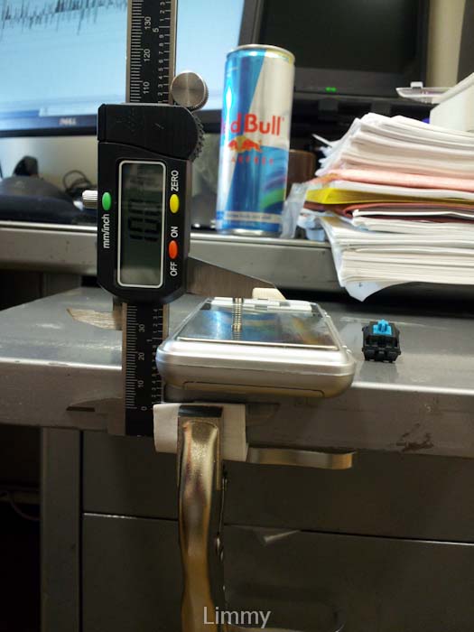

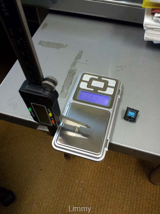

I just bought a digital caliper for $10 shipped from ebay. I will use "clamping a pocket scale" method to measure the forces of springs at different lengths and some switches when they are near bottomed out.
I have clear, blue, brown, red springs so I will see if I get comparable measurement with Soarer's.

When I measured the tactile bump of a clear switch, 65g was enough to push the switch over the tactile bump while 62.5g was not. So, I don't think the tactile bump part of the force chart is wrong. When I put on 90g, the switch bottomed out, while putting on 87.5g and tapping the weights and listening for a gap seemed to suggest there is more room. Fairly close to the force chart, probably actual measurements are slightly lower than what force chart is suggesting.

Putting weight on keys is not going to reveal the spring constant. You would have to have more sophisticated instruments to measure them. That is why I tried this. Oh wait, you might want to use Google translate on this because you don't have access.
Measuring peak force is no where close to describing feel. What it is measuring is a point on a force chart. Force chart could have different slopes, so even in the linear switches it is not enough. It is a pity measurement tools used to create force charts are very expensive. It would describe so much (although not all) about differences on mods and everything.

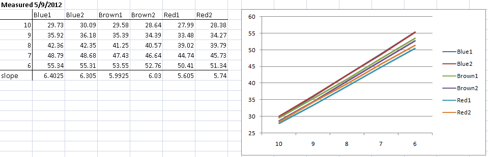

I heard of observer error, but there is no room for observer error in my measurements if you are suggesting them. Your use of psychology is excessive in my opinion and it would cloud your judgements in the long run. It may describe small interesting human behavior, but in my opinion psychology itself is never the fundamental driver.
It is pretty surprising you didn't see the measurements and the charts in the posts. This is my last post today responding to one of many of your off topic posts.
Here is the chart that is posted in the two links I posted. In the chart, x-axis and y-axis represent the length of compressed spring and reading on the scale respectively.

I dunno, this looks like random +/-2g measurement and standard manufacturing deviance error stuff in your chart above. Testing at least 10 of each would have made it more persuasive.
Plus, nobody has complained swapping springs about differences.

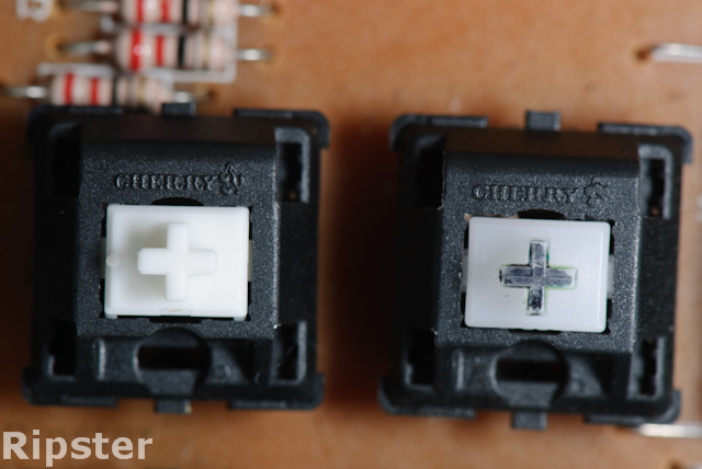

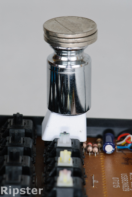

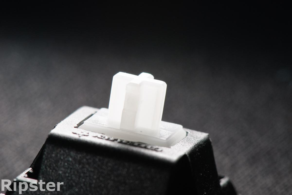

I think I can safely say you can skip the WHITE.
I have no idea what Cherry Corp was designing that switch for but it ain't no Clicky Green.
Pics stolen from somebody or other
Look for upcoming pics with Watermark saying Ripster. Quality MUCH better.

Limmy tested those springs OUTSIDE the switch.

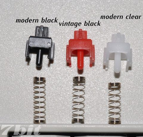

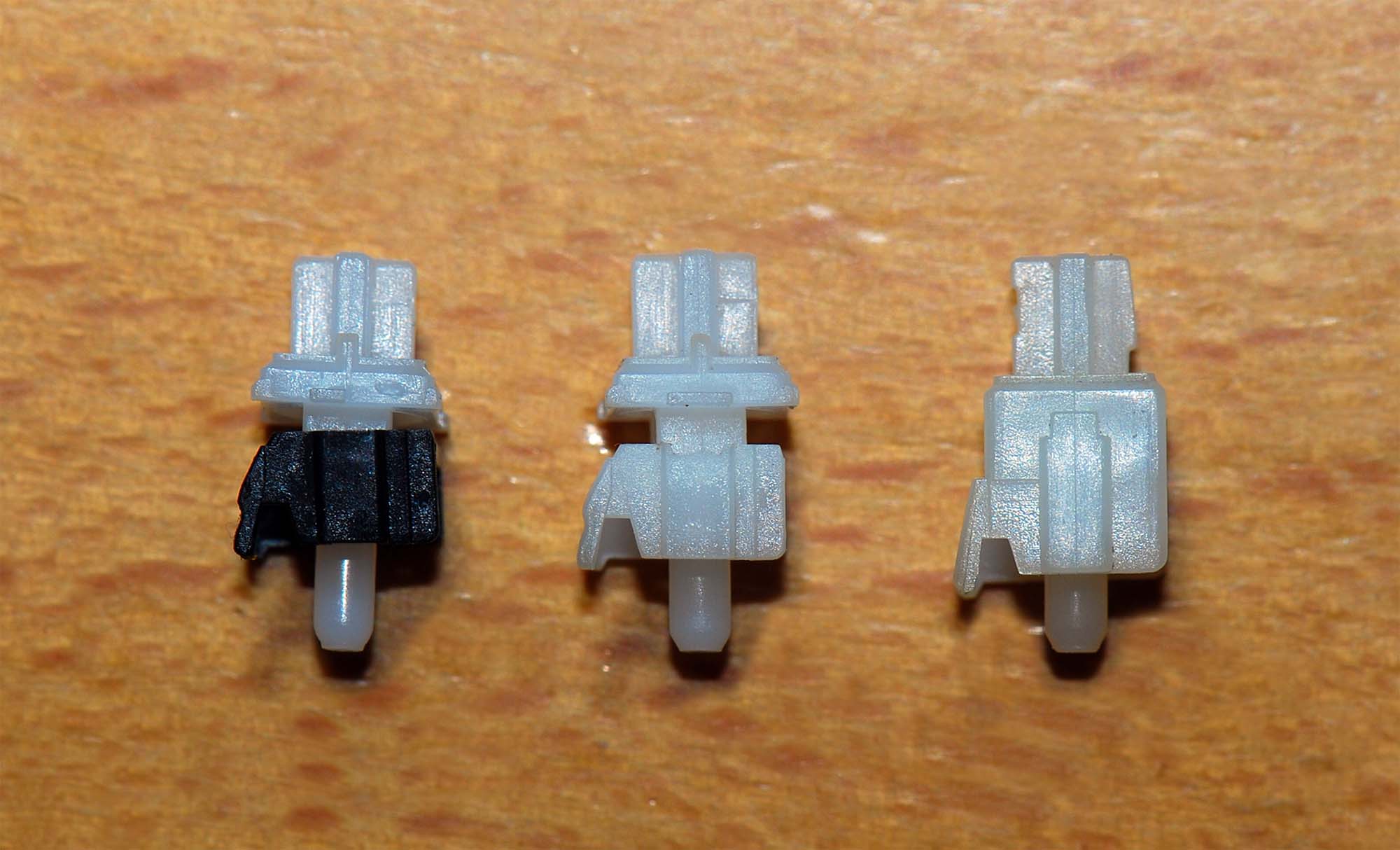

OK, I was wrong about the clears vs. blacks. But both in a black switch behave the same, but look totally different:
edit:
both in black: the same
both in clear: the black sping is heavier against the clear sping, then clicks down. Shortly afterwards, the black sping clicks down and both are the same towards the end.
(The red stem is just for making it more colorful
I actually compared modern black spring with modern clear spring )
edit:
- CherryMX_spring_comparison.jpg (99.87 KiB) Viewed 5607 times

The Vintage BLACK spring (why is it under a RED switch?) has less coils. GENERALLY that means it's stiffer for a fixed wire diameter.
The one far right is visibly thicker. Measuring spring diameters is a PITA btw...
There's a formula I got somewhere....
- 7bit
- Location: Berlin, DE
- Favorite switch: MX Lock
- DT Pro Member: 0001
It was in a red switch because I've swapped red springs into a vintage black keyboard.ripster wrote:The Vintage BLACK spring (why is it under a RED switch?) has less coils. GENERALLY that means it's stiffer for a fixed wire diameter.
Again: The black spring wins the "who can stay longer non-clicked"-game and then both are the same again.
This is something the Ripometer and Webwitometer methods can't show!
For this, you must apply the 7bitometer method!

I just take 2 switches and press them against each other. So I've got a direct comparision. No need to think about temperature, altitude, air pressure, coin-weight inacurracy etc.ripster wrote:We're starting to get too many meters here. You forget the LimmySpringatron.
BTW: I've found out that those 2 clear switches which I tested behave a bit different, so maybe this test should be done with more than one switch of each type ...

Measurement error and oberver effect are totally different things, ripster.ripster wrote:You have heard of Observer Error?
Anyhoo know you know why I was ragging on Limmy about measurement error.
No, I tried two springs of the same kind.7bit wrote:You tested these springs in one and the same switch, yes?
I am well aware of the measurement errors, so I measured a spring twice to see if the two measurements are close. I wrote down the numbers in first try, and in second try I see if they match. They matched quite nicely, so I wouldn't worry too much about measurement errors.

OK, I got an idea. How about we agree that IF there are differences they are in the 2 to 3g range?
And therefore well within McRip Effect territory?

All the vintage black I have had were slightly lighter feeling than current. Spring had less coil but seemed to be lighter gauge and appeared like it was made of some other metal, was a dull grey tone. I also noticed the legs on the stem were slightly less pronounced, which is what I think makes them seem lighter. I noticed something similar on very old blue, which had a black plastic clicker instead of the clear ones now. Spring on those was also different looking more like brass.
Both were from 'new old stock' board.
Also I lied about white, I did have some linear with white stem but they seemed to be identical to blacks otherwise.
Not sure if I still have any of those or not.
