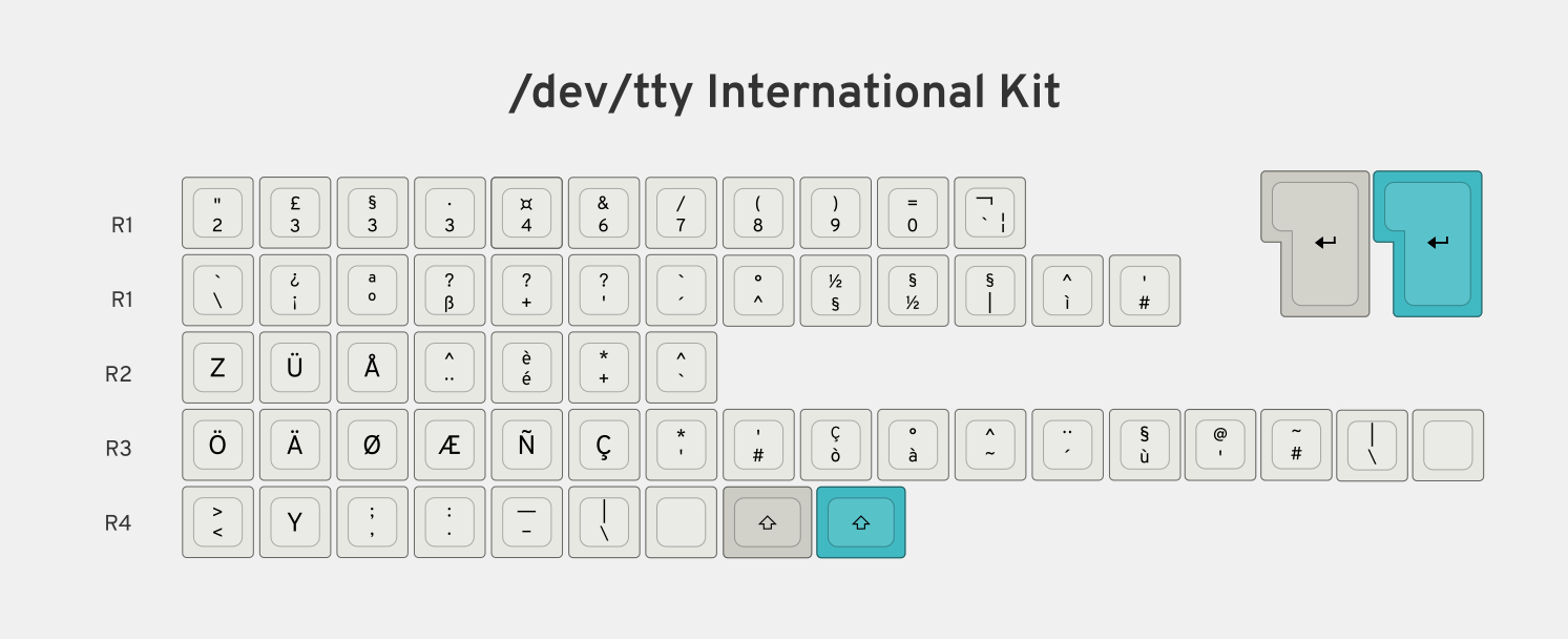

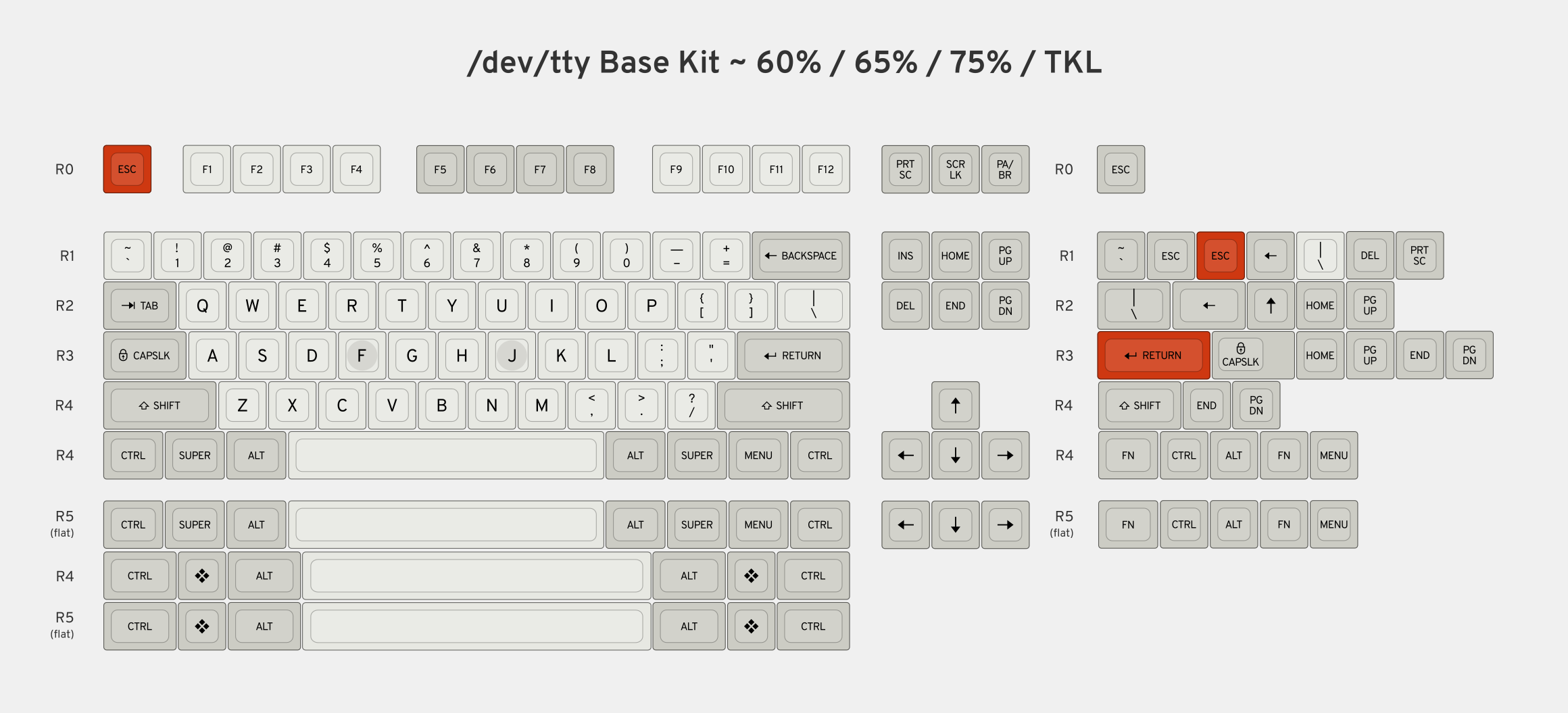

As promised, I checked out again the international kit; those are the problems I found (assuming support for German (DE), Danish (DK), Spanish (Spain) (ES), Swedish/Finnish (SE+FI), Italian (IT), Norwegian (NO) and English (UK) (UK); Spanish (Latin America), both Portuguese layouts, and other national layouts are off):
(*) With that said, given the intentional omission of tertiary legends, the Portuguese (Portugal) layout is only two keycaps shy of being fully supported: R1 «» and R3 ºª.
HTH!
- R1: 3£ shows up twice.
- R1: In 3· , the middot is a bit too low and looks like a normal dot.
- R1: #' is used in the German layout IF the Backspace is split and the movable key is moved up from R3 to R1. This, and the \| key (for English (USA)), are the only movable keys given this option. Why not #~, '*, Ç, etcetera?
- R1: \| (used in the Italian layout) seems to be missing, but IS present in the base kit.
- R3: ~^ (dead key for tilde and circumflex accents) is used only in the Portuguese layouts, but neither is supported. (*)
- Numpad comma (used in all of the supported layouts except English (UK)) is missing.
- Don't forget the AltGr keys!
HTH!
- matt3o
- -[°_°]-
- Location: Italy
- Main keyboard: WhiteFox
- Main mouse: Anywhere MX
- DT Pro Member: 0030
thanks for your report, I'll have a look at it.

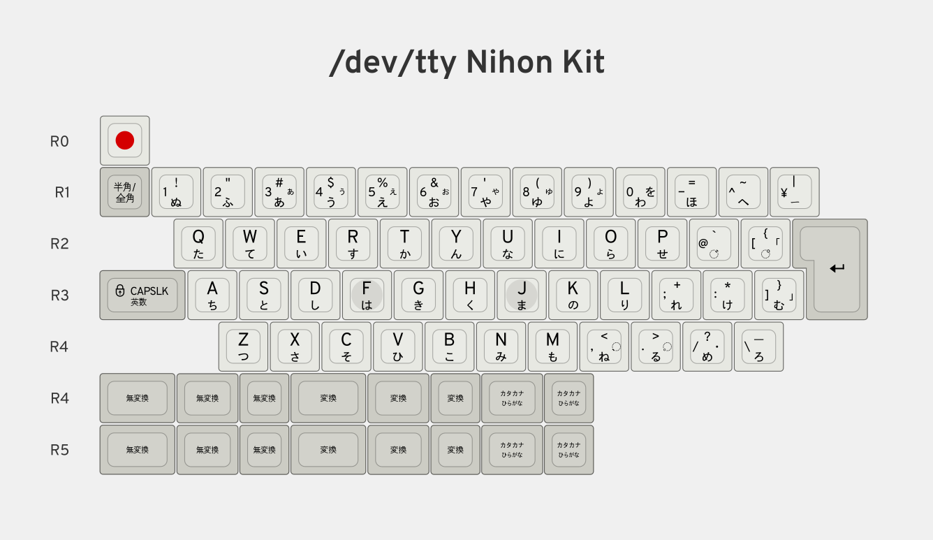

I've added two more kits. I'm still working on the japanese one, hope some nihonjin could chime in. Also the blanks are WIP

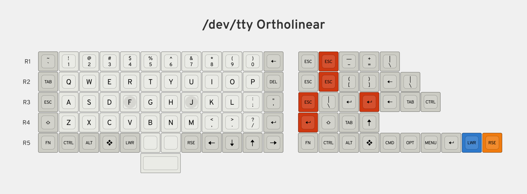

No ergodox support would be too bad imo. What about just adding the necessary blank 1.5u & 2u keys to the ortho kit? There are ortho boards like the boardwalk that use those 1.5u keys too.matt3o wrote: 06 Jan 2020, 16:20 Of course everything will be also available in teal mods. I had not a single request for ergodox over the past year or so... so I guess that ship has sailed. I still miss a few keys, the spacebars and some extras (being APL or the secondary legends or whatever)

Judging by the number of people in the first drop that accidentally bought only the alpha kit and no mods, that's a good idea.matt3o wrote: 08 Jan 2020, 10:49 Drop prefers to merge kits as much as possible. I understand that because of: 1) they have a vast majority of noob customers; 2) less prone to fulfillment errors.
On the other hand, there are probably a couple hundred people that still have only the alpha kit and no mods, and some of them would presumably still like to buy just a mod kit!
I really like the WASD Keyboards media key placement on TKL and fullsize layouts, though I haven't seen it implemented on other boards.

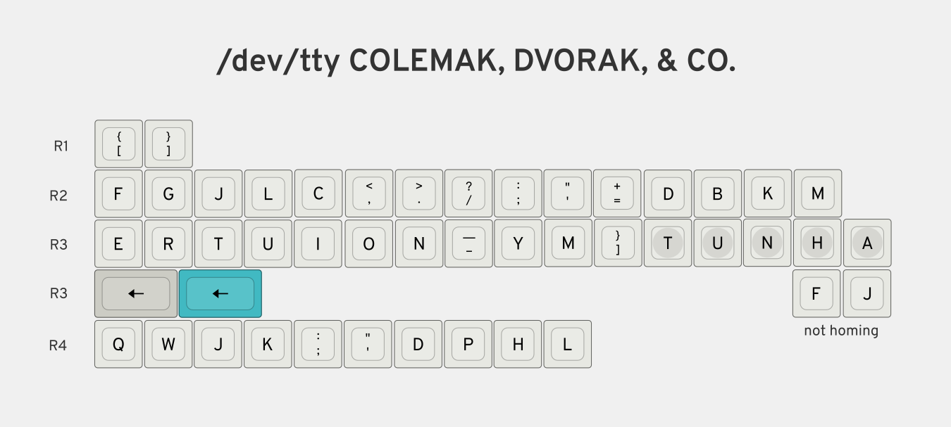

okay I've updated most of the kits, there's still some work to do in the international and japanese kits, possibly the blanks too.
let me know what you think.

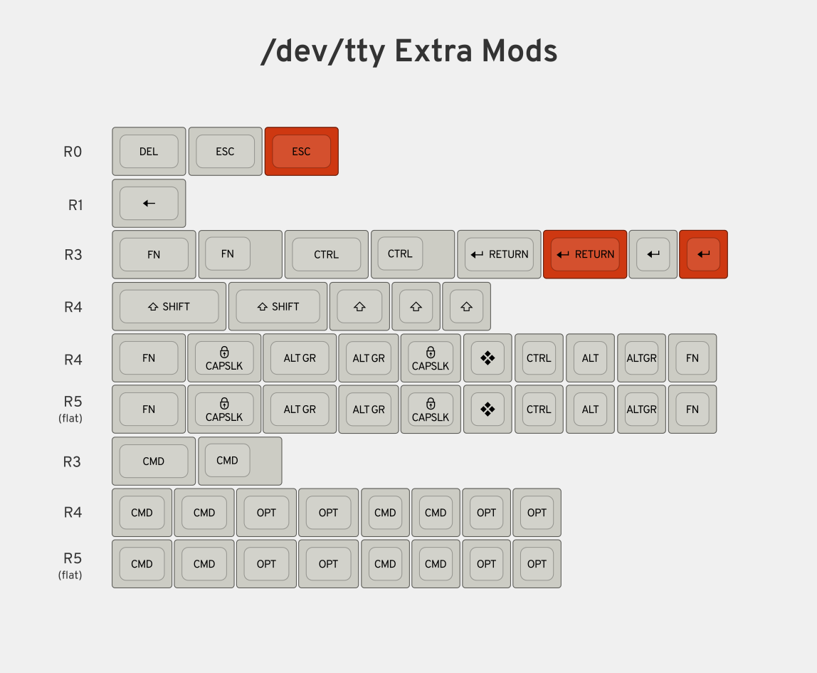

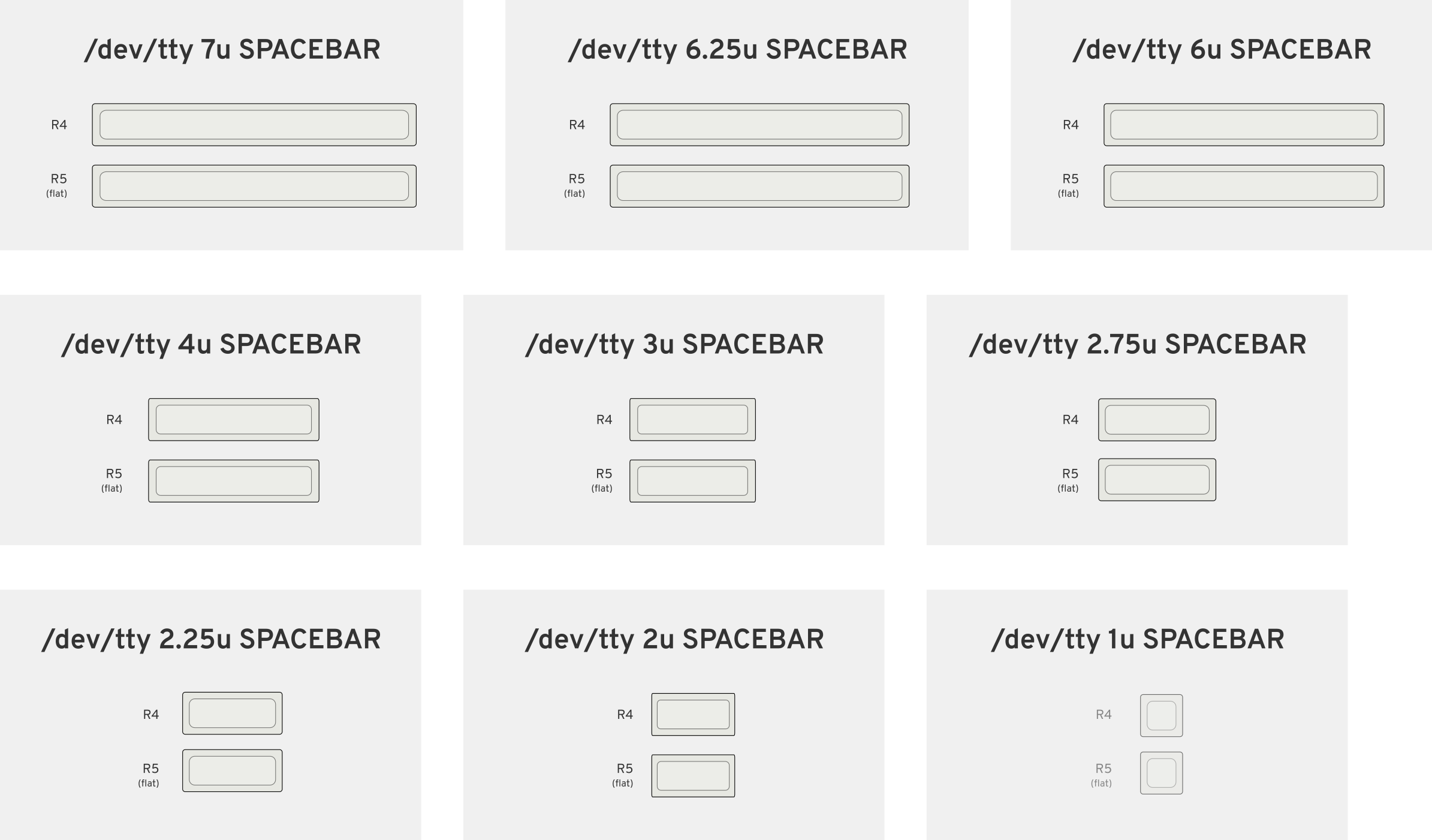

I'd love to see a 1.25u space bar, and have the option of space bar mods, like on a HiPro or even an AT101. I never understood why keys meant to be hit with your thumb should not be convex.
If this isn't clear, this means that I'd love for all the bottom row keys to be space bars of various widths. You're pretty close with a 2u and a 1u space bar. Just add 1.25u space bar and you're there for most boards. You'd cover even more boards with a 1.5u as well. I'd do blanks if necessary.

we'll get there eventually, it's just that I can't add too many new keys in just one drop. I've added quite a few this time.XMIT wrote: 19 Jan 2020, 13:51 I'd love to see a 1.25u space bar, and have the option of space bar mods, like on a HiPro or even an AT101. I never understood why keys meant to be hit with your thumb should not be convex
- AJM
- Main keyboard: Geonworks W1-AT
- Favorite switch: Lichicx Lucy
- DT Pro Member: 0231
True, but a Triumph blank kit would be sooooooo much easier to produce than these Japanese or side printed kits, wouldn't it?
@XMIT:
I absolutely agree concerning a convex bottom row. Interesting suggestion with the 1.25u space bars, although the mods would look a bit weird in white.

That's the core ability underneath all my job skills, and I'm damn good at it. Thank you very much.
- depletedvespene
- Location: Chile
- Main mouse: Logitech G700s
- DT Pro Member: 0224
BTW, what about Hangul?

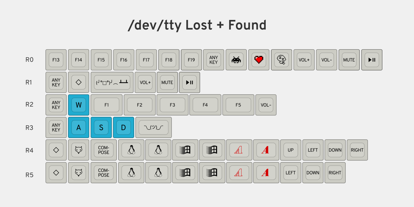

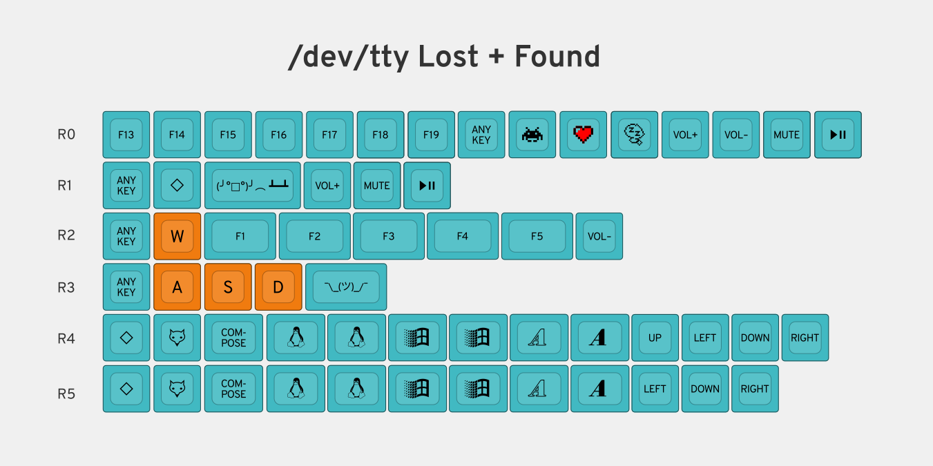

In the Lost+Found kit, will the heart key actually be printed in red? That looks pretty cool compared to the 8-bit black and white version from /dev/tty0.
Did you give any thought to doing a commemorative /dev/tty2 key like the blue/dev/tty0 key you did for the very first run?

unfortunately red-on-teal doesn't work, so I'll probably have to revert to 1-bit colors.Techno Trousers wrote: 29 Jan 2020, 02:38 In the Lost+Found kit, will the heart key actually be printed in red? That looks pretty cool compared to the 8-bit black and white version from /dev/tty0.
of course there's a special /dev/tty2 keyTechno Trousers wrote: 29 Jan 2020, 02:38 Did you give any thought to doing a commemorative /dev/tty2 key like the blue/dev/tty0 key you did for the very first run?

I'll still say there should be an ergo kit for dev/tty2. The ergo kit sold over 100 kits (143 in dev/tty1's case) in all of the MT3 group buys since. I know there are people who would miss having that support.

Does red on beige work? Or maybe you have to do the legend printing the same for both colors of modifier?matt3o wrote: 29 Jan 2020, 09:50 unfortunately red-on-teal doesn't work, so I'll probably have to revert to 1-bit colors.

only the teal color heart needs to be 1-bit. On beige it still works.

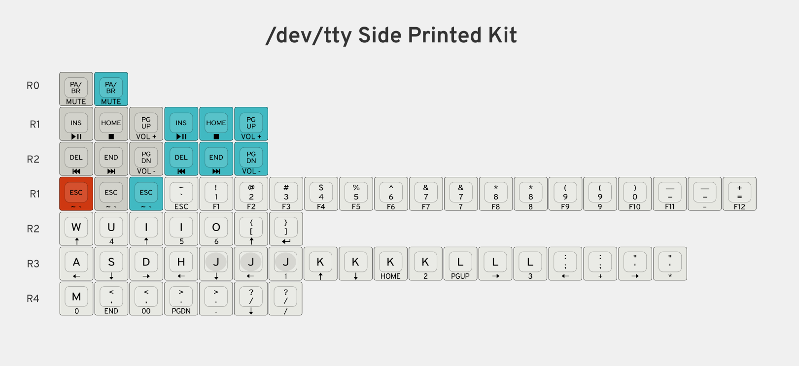

Having "Meta" and "Hyper" modifiers keycap legends would be absolutely lovely makes sense for retro fanboys and GNU Linux /// GNU Emacs users ("Hyper" key in some environments is considered to be a separate modifier key and not a combination of other modifier keys).
Also adding "F20" ... "F24" to the "Lost + Found" would make this subset "more complete" (?) again for retro /// battleship keyboard fans who may need to go with two rows of function keys ("F1" to "F12" and "F13" to "F24"). It is only four keys extra that would close the loop for some. The very same crowd would also appreciate the addition of R0: "Fn" key (however I understand that from the perspective of keycap set design this one is a bit of an overkill).
Another thing, R0: "NumLock" that would allow for customizations like (fully populated nav/num-pad)
https://imgur.com/GdVAdR0.
Having this fully populated nav/num-pad in the "side printed" subset would be too nice to be true
https://imgur.com/GdVAdR0. Having this fully populated nav/num-pad in the "side printed" subset would be too nice to be true

Also for the "Side Printed" kit, the "PRT SC" key is often combined with the "SysRq"
https://nl.wikipedia.org/wiki/SysRq#/me ... k-edit.jpg
