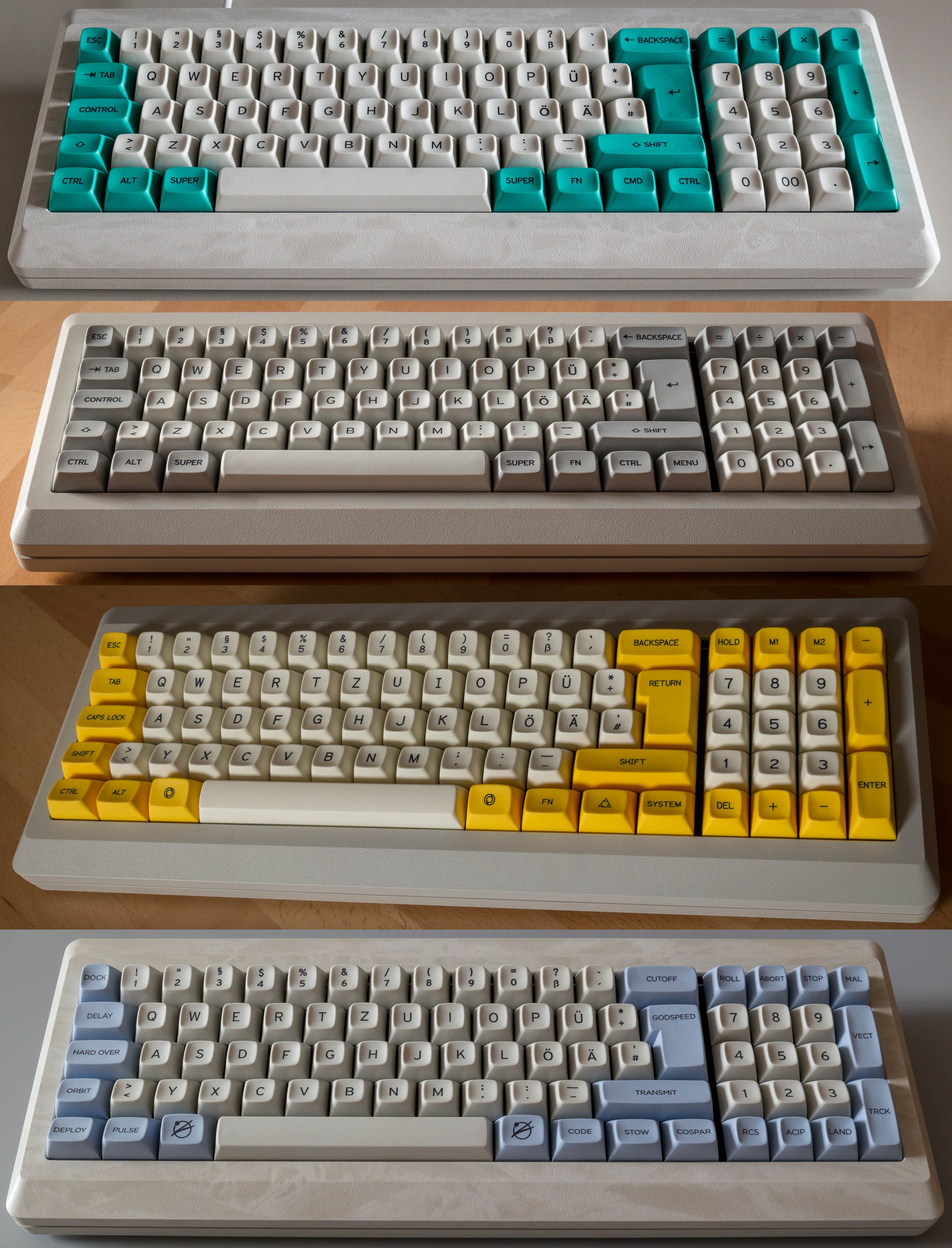

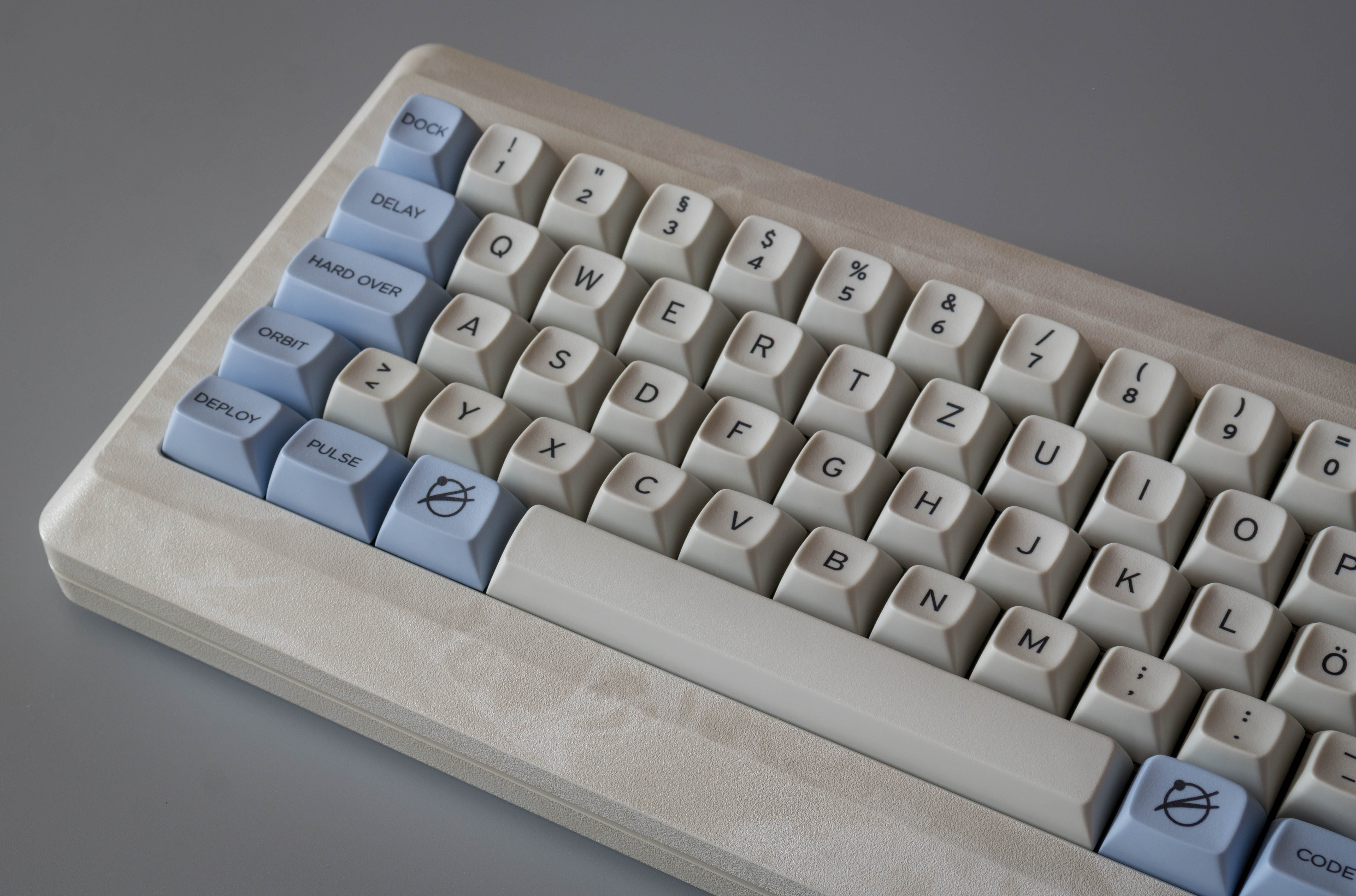

After trying out the MT3 Godspeed set, I thought I might post a picture with all used MT3 colourways, so far. The alphas on the last one are /dev/tty, though, not Godspeed, because their yellow/brownish colour just didn't work with my "marbled" case.

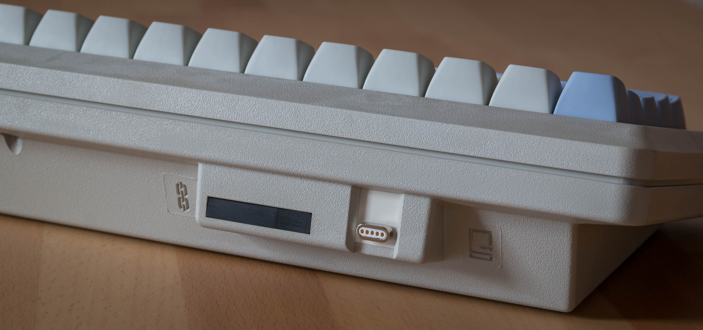

On this occasion I also changed the fixed (to the case) cable to a magnetic one (like I had already done on the "evenly retrobrited" case). This time with a neat little white plastic trim.
I love these magnetic cables. So easy to use and you don't have to worry about wearing out connectors or to damage them - should you yank on the cable by accident.
The only problem I encountered so far: Why in the name of all that's holy are there no WHITE USB cables with magnetic connectors - anywhere?? The best I could find are silver textile ones (which look a bit cheap).

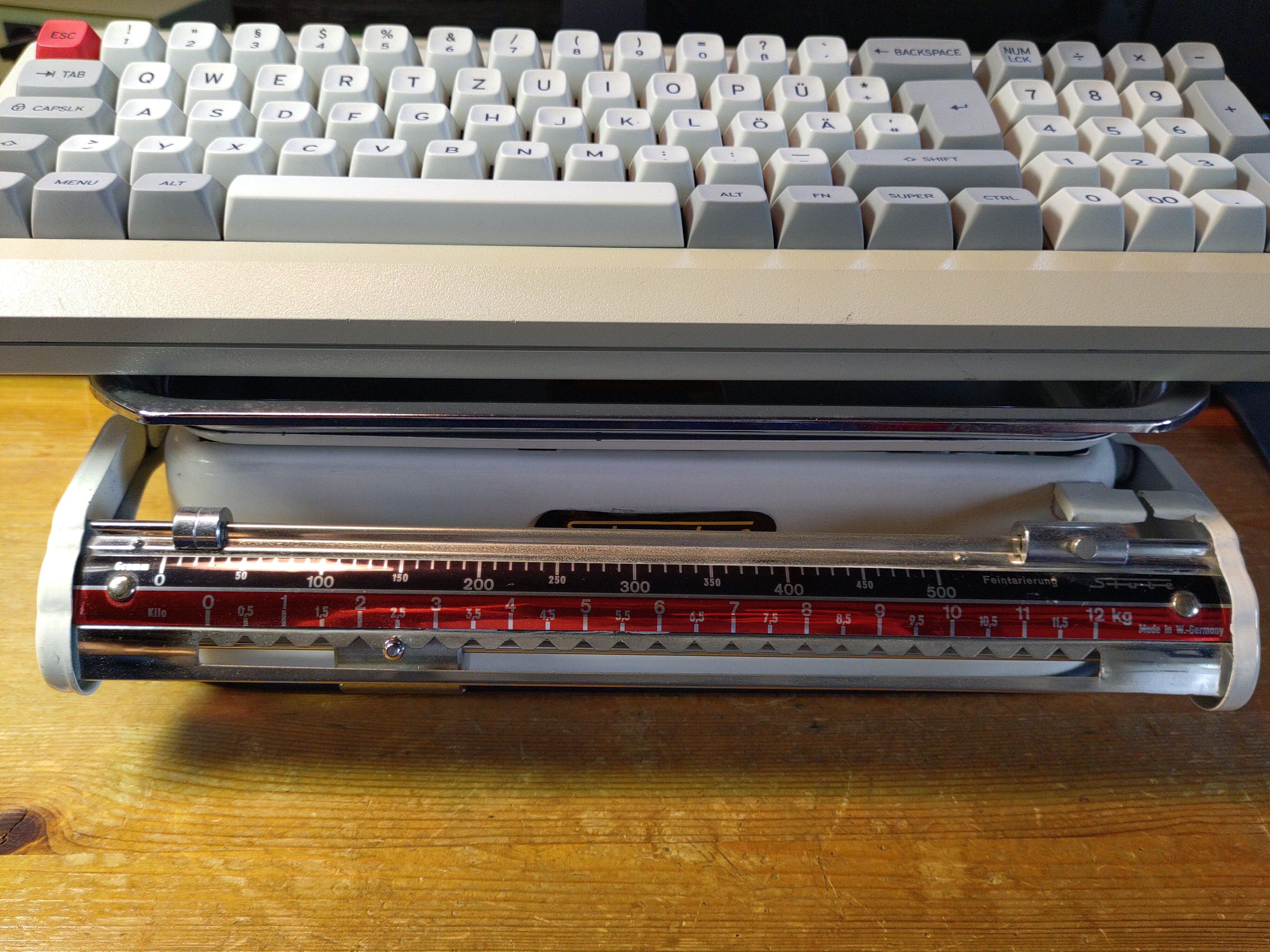

So, finally my own AJM-Vibe is about to be finished. I took a slightly different approach in regards to the plate that carries the keyboard inside of the housing. I didn't use a wooden/composite board, but rather had a steel one lasercut. I've attached the step file, in case anyone needs it. Oh boy, and what a massive slab of metal it is: The whole thing wheighs in at just above 2,5 kg
Going to spraypaint or blue the thing + give the case a day in the retrobrighting tub. I'm also looking forward to test the sound once I have it assembled.

Amazing board, especially with that MT3 German keycap set. Really love that profile - makes you feel like your finger tips are being massaged while typing. My jealousy is immeasurableTNT wrote: 21 Apr 2022, 21:28 So, finally my own AJM-Vibe is about to be finished. I took a slightly different approach in regards to the plate that carries the keyboard inside of the housing. I didn't use a wooden/composite board, but rather had a steel one lasercut. I've attached the step file, in case anyone needs it. Oh boy, and what a massive slab of metal it is: The whole thing wheighs in at just above 2,5 kg

I have a friend who owns a very decent 3D printer but, unfortunately, don't know anyone with a laser cutting machineAJM wrote: 21 Apr 2022, 21:49 Impressive!![]()
Do you have a friend that made that plate or can one order such things easily - in which case: How much did it cost?
There are several online services (including ones who also offer powdercoating
- TNT
- DT Pro Member: 0250
I actually recommend doing that. At least with MT3-caps, the ones on the right and left sides will always rub against the case or get stuck. Especially those corner keys are a bitch...TNT wrote: 21 Apr 2022, 22:51 I think I could've saved some money with ordering a smaller sheet thickness and making up for it with some washers.
It seems to be beneficial for the Vibe to be recessed in the case a little more. You might get around beveling/chamfering the two side borders of the upper case that way. As AJM wrote, it's not visible from the top, but still, less work and fewer chances of damaging the case by messing up.
Love the weight and the sound tho, and you might be able to achieve sameish results even with a thinner plate by using a different metal (Tungsten, Gold, Uranium, etc.

love that magnetic usb c cable idea !AJM wrote: 12 Jul 2020, 14:37
