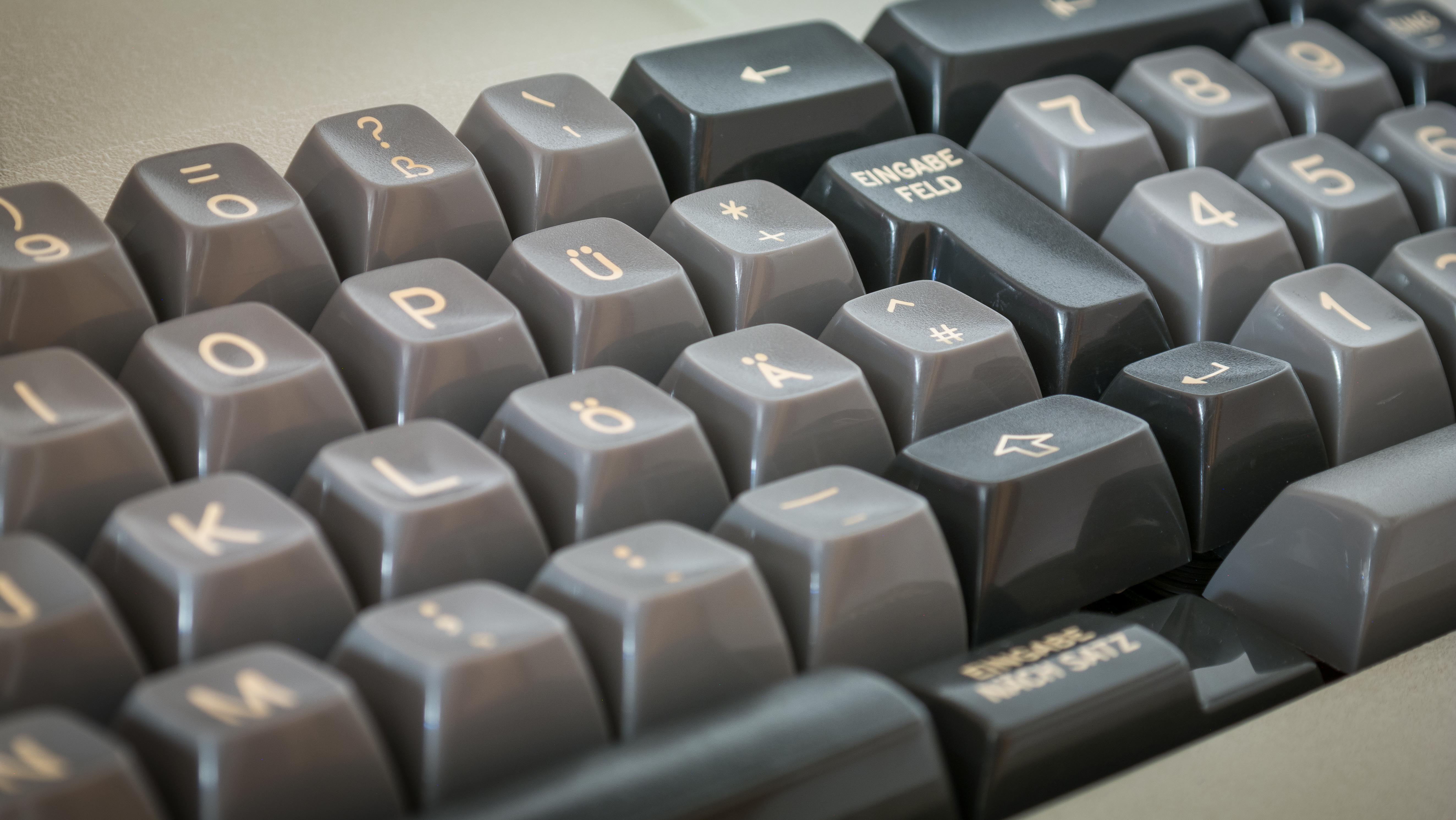

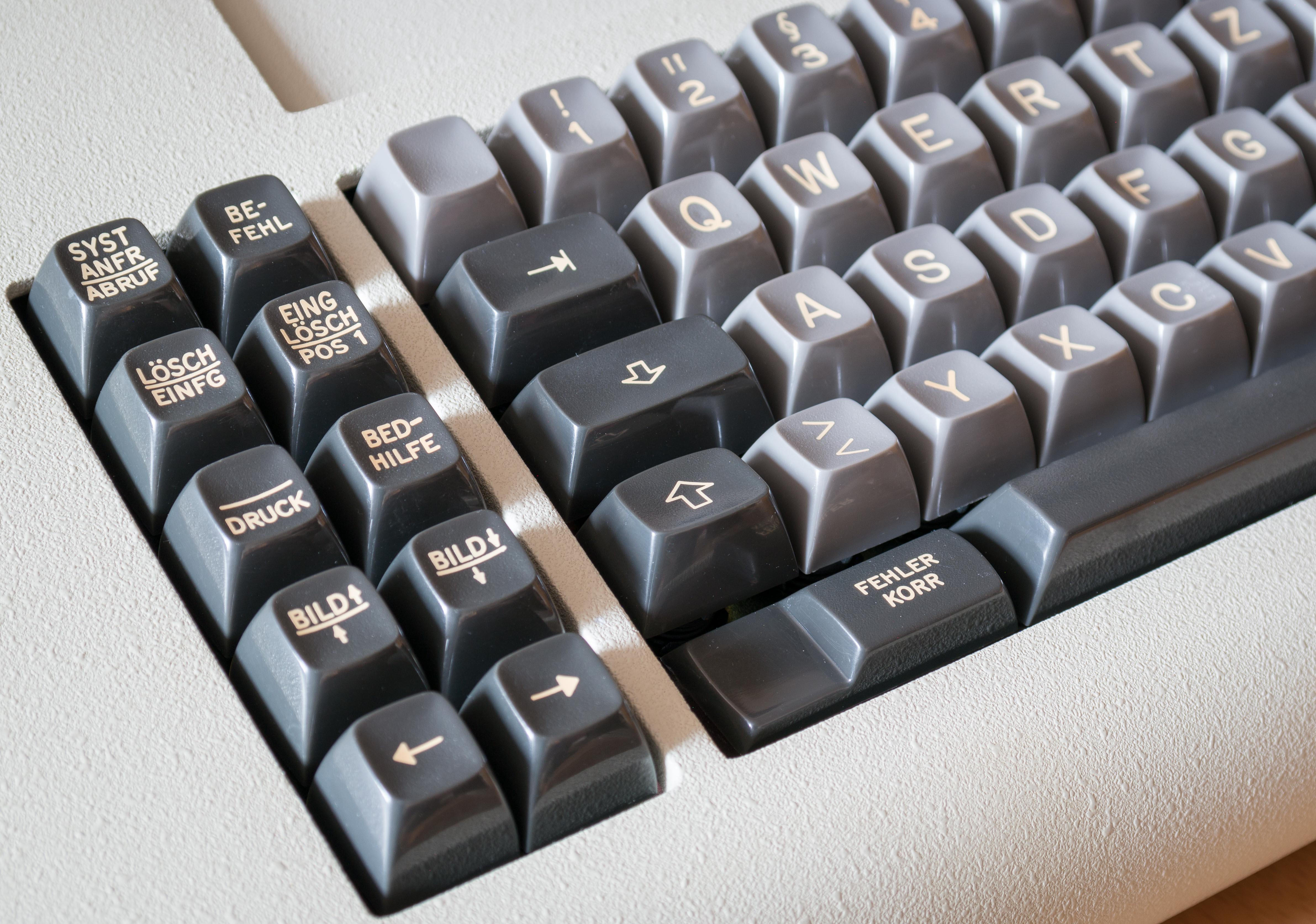

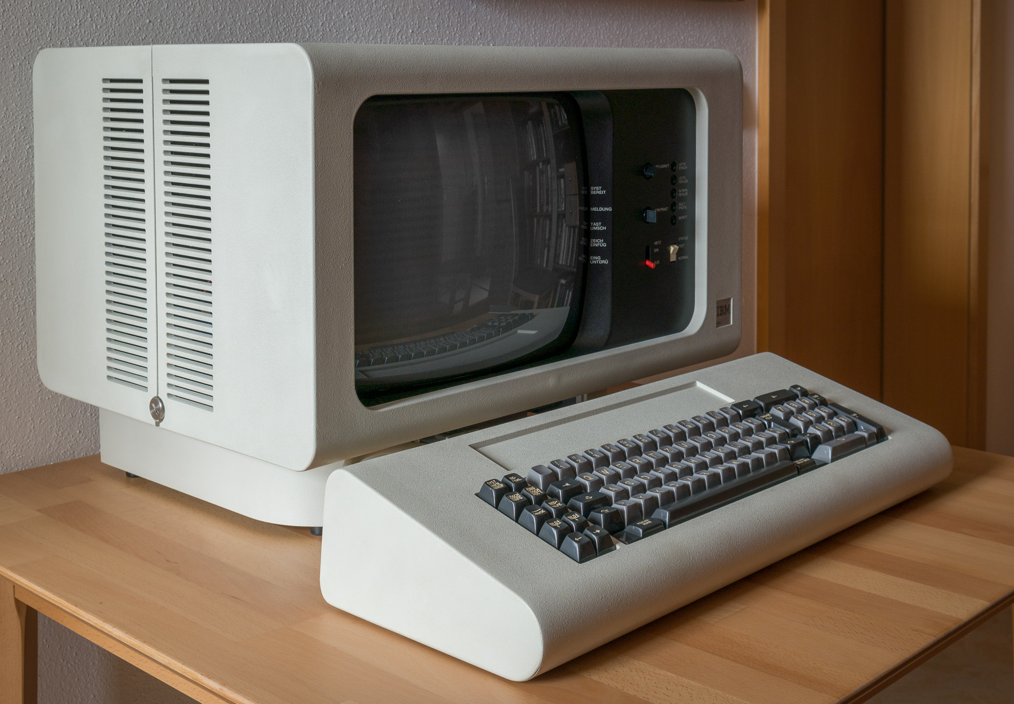

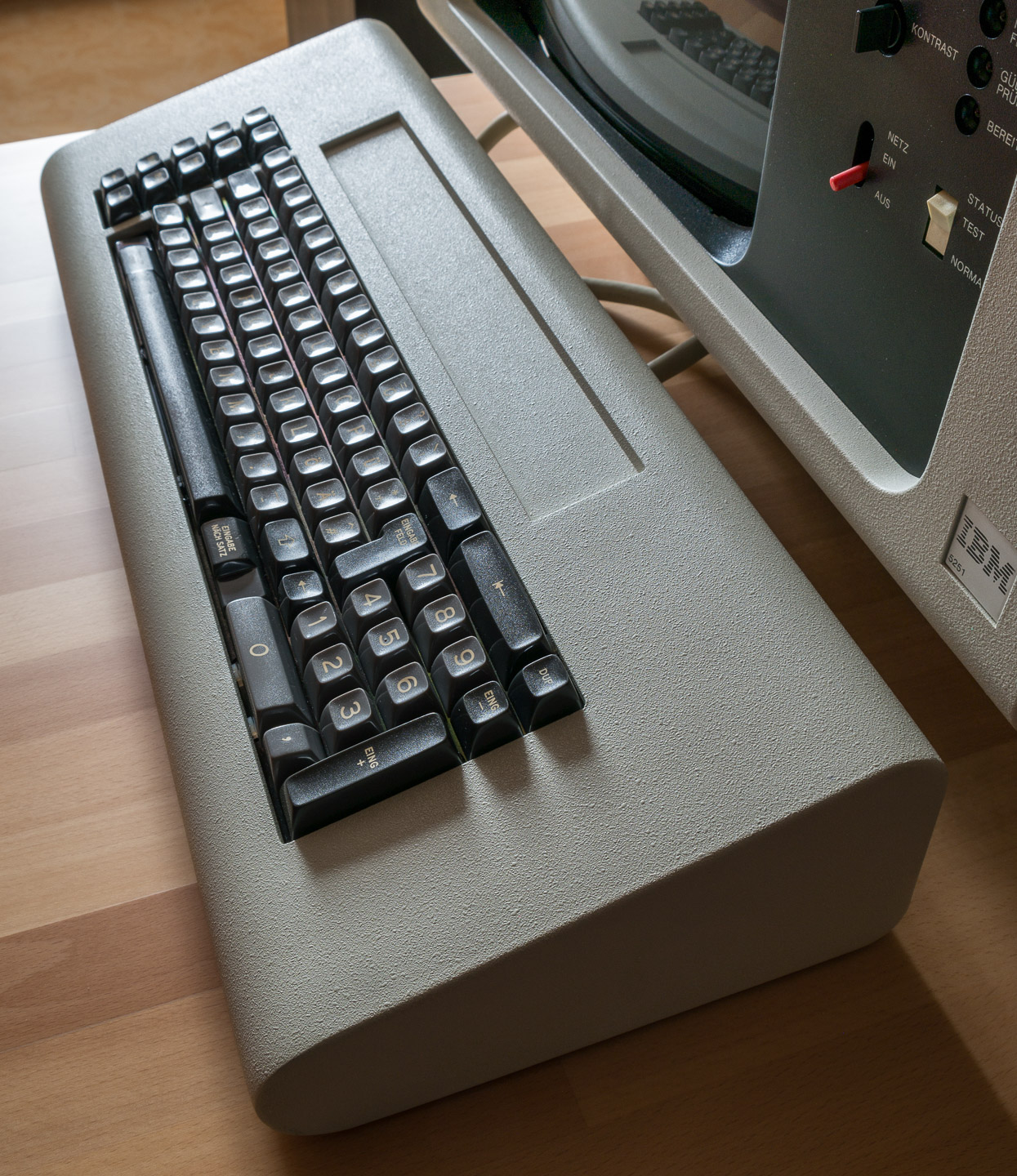

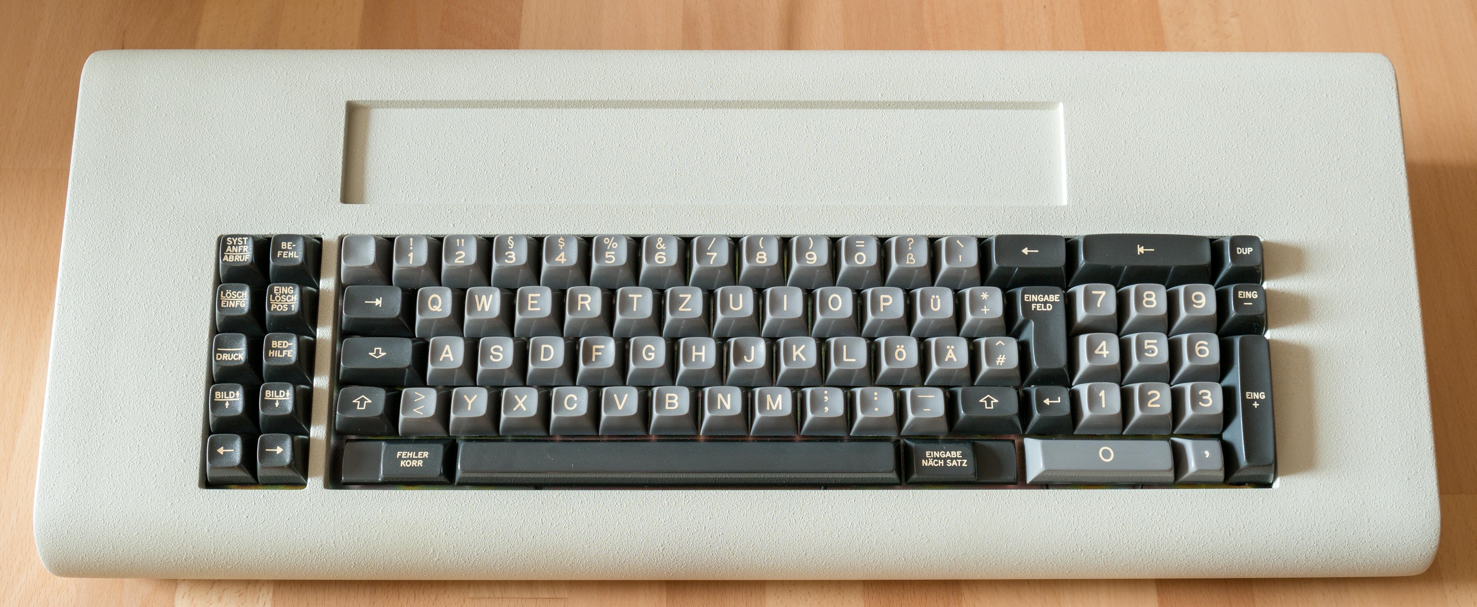

And to finish my thread off - a few pictures with a new set of German keycaps, which I got through swapping with a well-known forum member.
They're a bit yellowed, but I simply call them ivory-coloured = problem solved. :mrgreen:

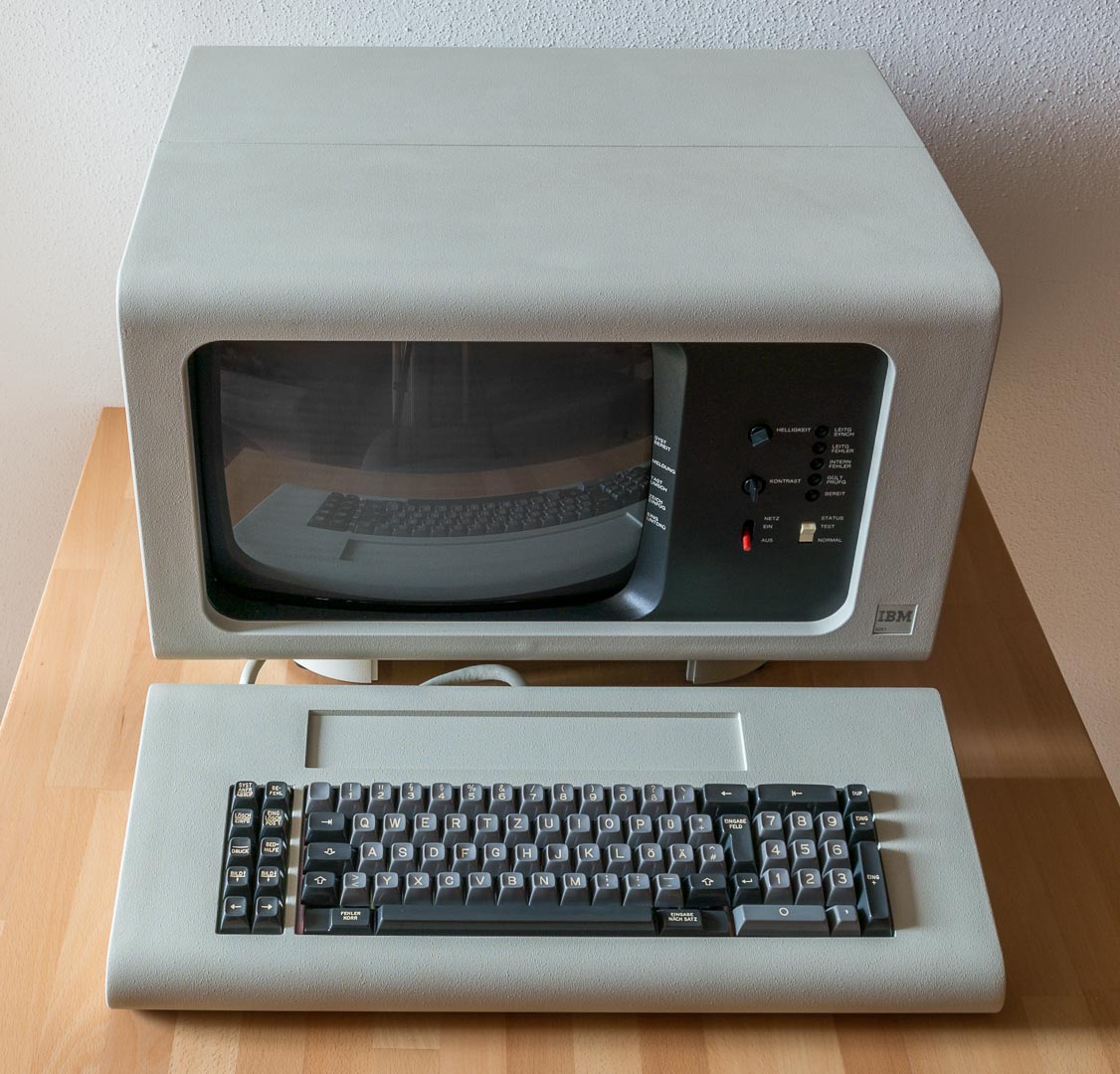

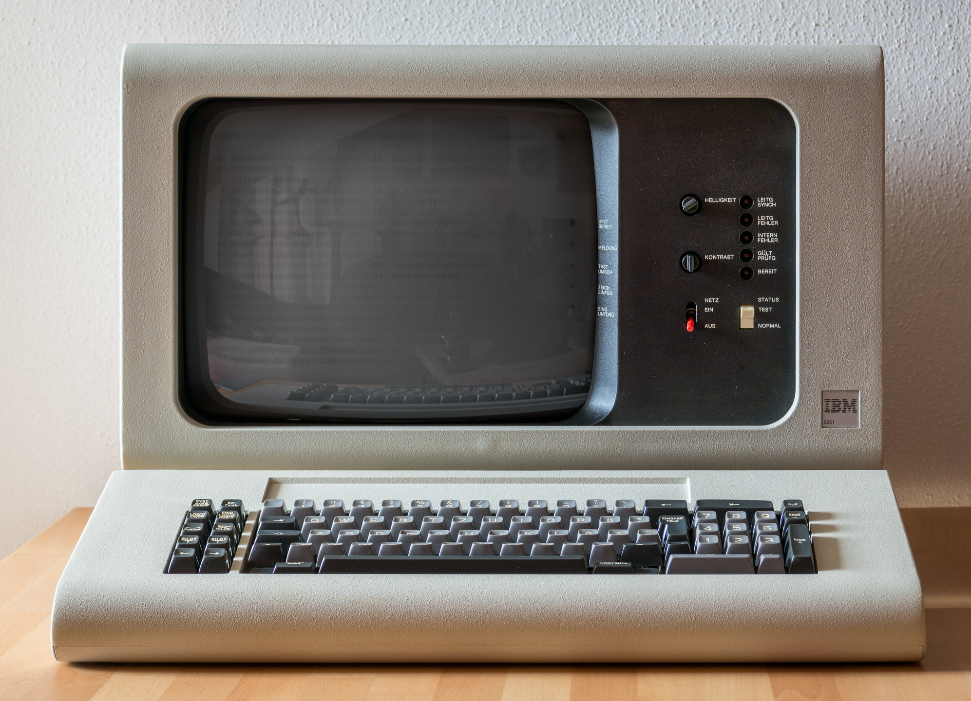

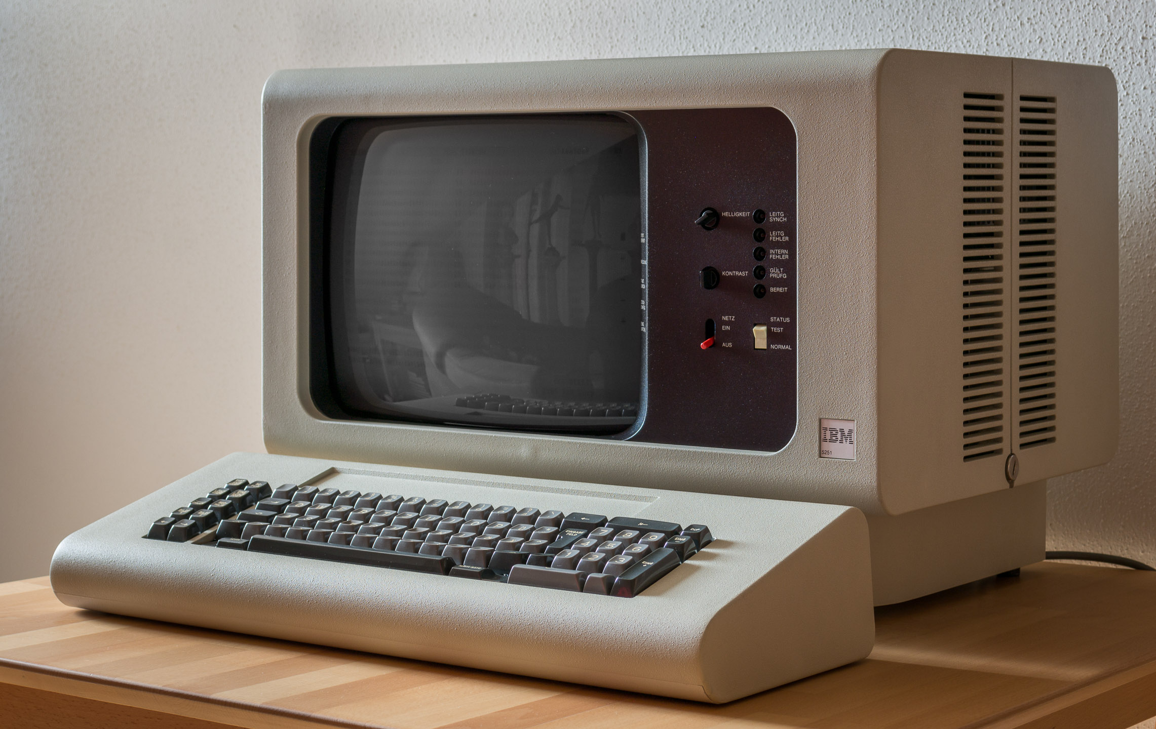

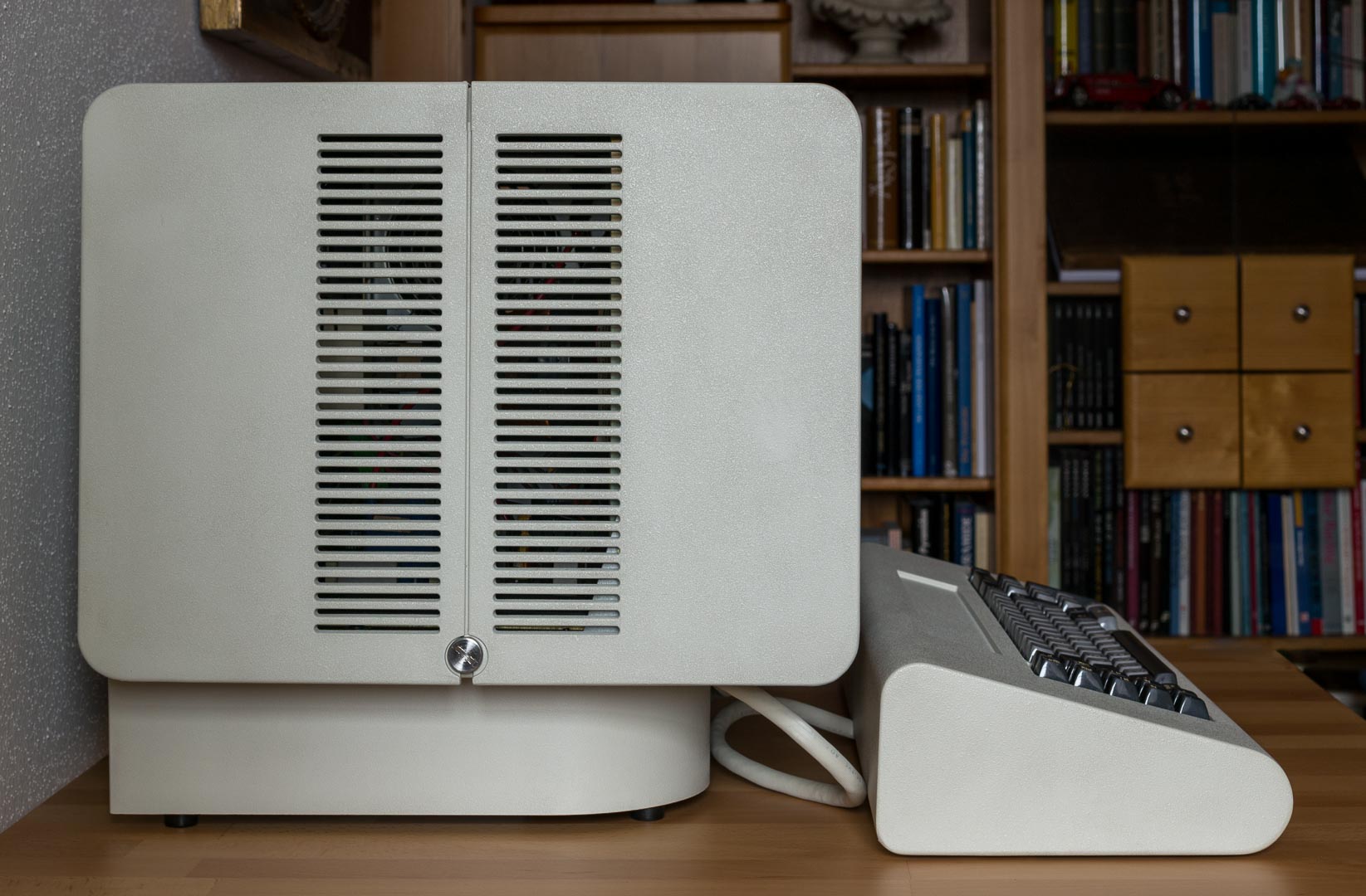

08 Sep 2019, 19:05
As I wrote at the end of my initial post - The 5251 keyboard looks a bit bloated in front of a 27" Apple Display.
In front of a 13" inch display it's fine though - provided you choose the original terminal ;) :
And if you like that kind of thing - here is also a little typing demo. (Copyright for the channel name belongs to vometia :mrgreen: )
