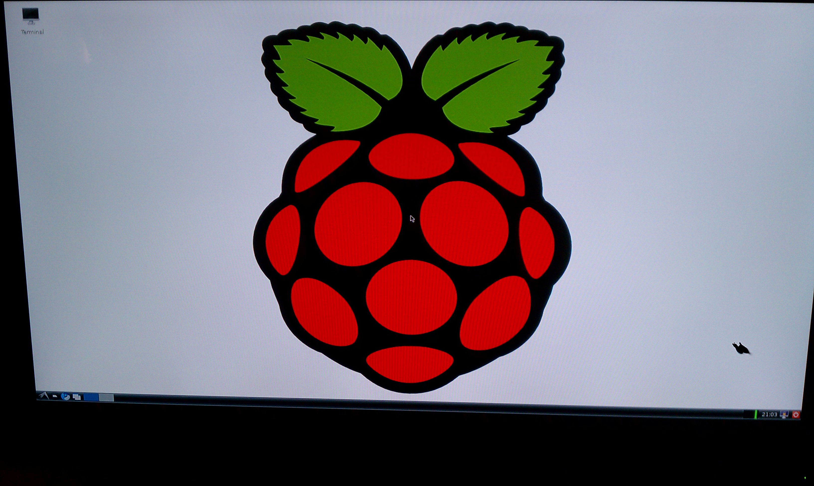

Well, it works! I was going to take a photo, but the camera battery's dead. Preparing a bootable SD card was no problem (I chose the Debian install but the Pi downloads page has others), it powers just fine from a Belkin 1A USB wall charger, and the KBC Poker looks quite happy sitting alongside it too. I need to change the layout if I'm keeping the Poker with it, which looks like it can be done from command line, so I'll give that a go later (Pi expects UK keyboard entry by default).
startx gives a windowed interface, which is a little sluggish by contemporary standards, but better than the struggling networked PCs at work...

Typing this using my Raspi... screen resolution too blocky, but will sort shortly - can select HDMI mode in command line, apparently. Yay!

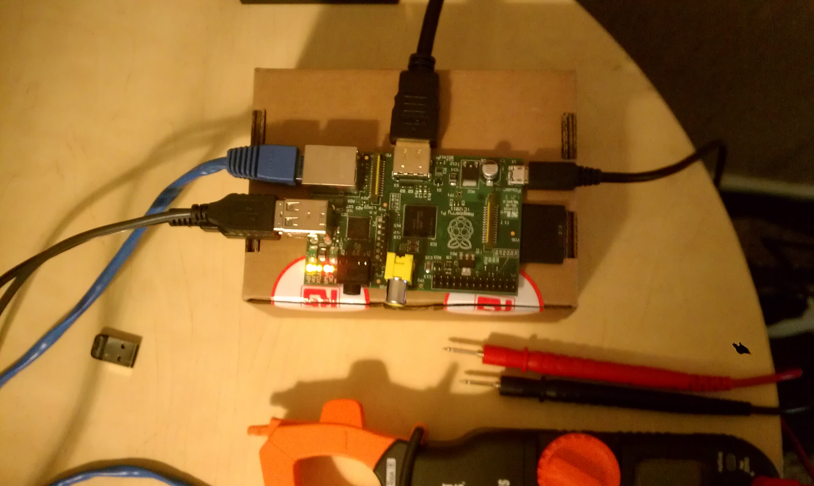

Here are some pics...I also have to comment on how silly it is that they are locking all threads about the Ripster over at GH. They don't even want to talk about it!

It's definitely slower by contemporary standards. Even though it boots up and seems ok I would suggest testing the power supply while your Pi is in use using this method: http://elinux.org/RPi_Hardware#Power Scroll down to where it says "How Can I tell if the power supply is inadequate?" I'm using a USB charger for HTC rated at 5v 1A and it really only puts out 4.76v and 700-800mA when I test it using this method.
I had a BT dongle plugged in plus the Ethernet and it got VERY slow. Rebooted and it went ape shit. Unplugged the BT and it was fine.

smknjoe wrote:I'm using a USB charger for HTC rated at 5v 1A and it really only puts out 4.76v and 700-800mA when I test it using this method.
From what I read, 4.76V would be within tolerance (+/- 5%) and that current measurement means the Pi is only drawing 700-800mA as that is all it requires. If you add something hungry onto the Pi, it would draw more current. So it looks like you're OK.

Still messing with the HMDI modes, so screen dimensions are a bit here & there. :D

Snap! You beat me to it. Try turning overscan on http://elinux.org/R-Pi_Troubleshooting#Display Nevermind that. It doesn't look like an overscan/underscan problem. Continue on...

That's with nothing plugged in but power. It actually drops down to 4.73 and peaks at 4.76 and the Pi is actually pulling about 300mA. Depending on which combination of KB, mouse, USB hub (powered), and Ethernet it bricks on me or is solid as rock. I think lots of people are going to run into power problems whether they relize it or not. I'm going to have to get a new PS myself as all of mine are these HTC chargers.

The reason for the different displays is that I was trying out the various modes - if you don't have one already, create a /boot/config.txt file containing something like
hdmi_group=1
hdmi_mode=1
as default, then once you're running, type
/opt/vc/bin/tvservice -m CEA
to see what your screen supports.
Change the config.txt file accordingly. Ignore me if you know all this. 8-)

I've been using a Cyberpower USB hub to power and expand my Pi(s). Can't remember what my measurements showed exactly, but they were between 4.8-5.15v. Much better than what my HTC chargers were putting out.
