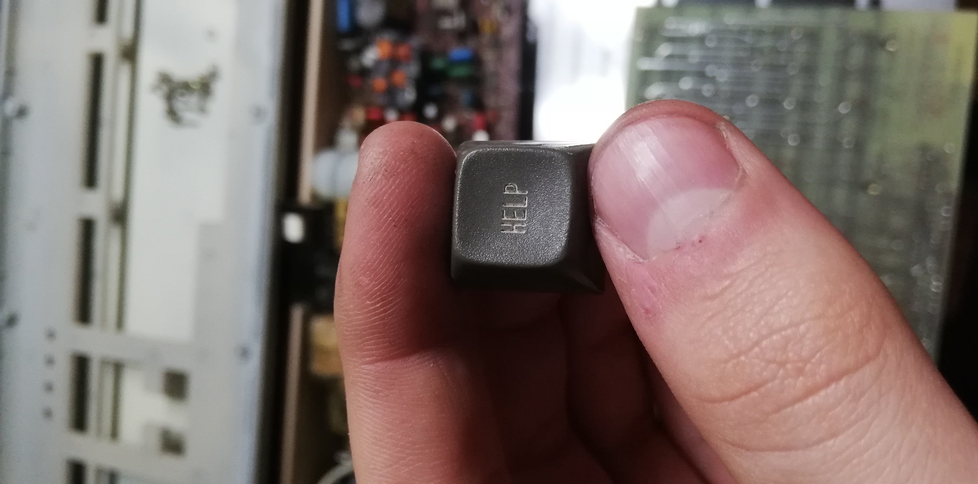

That would be awesome, but we will have to wait, because I can not read the text from this photo, when I have the keyboard in my hands, I could give you more info.Slom wrote:if you tell me whats is written on the retention tab on the right side of the switch in this picture, I might be able to tell you more about the pins.petrdolezal wrote: So these switches have two pins to power them and two output signal pins, so one output pin has to be 0V and the other is what? I mean is the output signal analog or digital? If it was digital, then the second output pin would just send the input voltage when a key is pressed, but if it is analog, than the voltage would be dependent on the way you pressed the key, it would be like a potentiometer. I do not know what to search on the internet, I found no info on this.

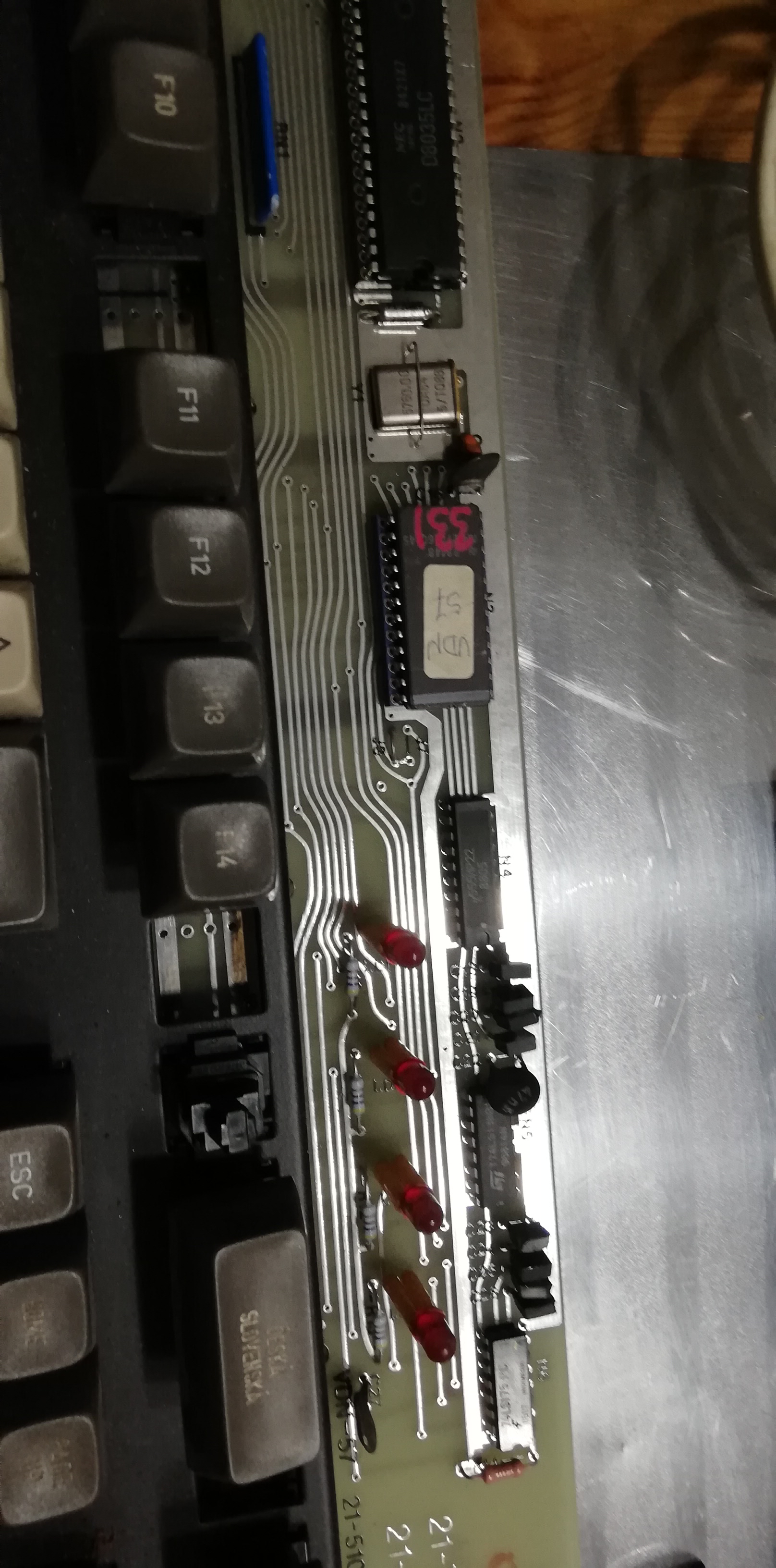

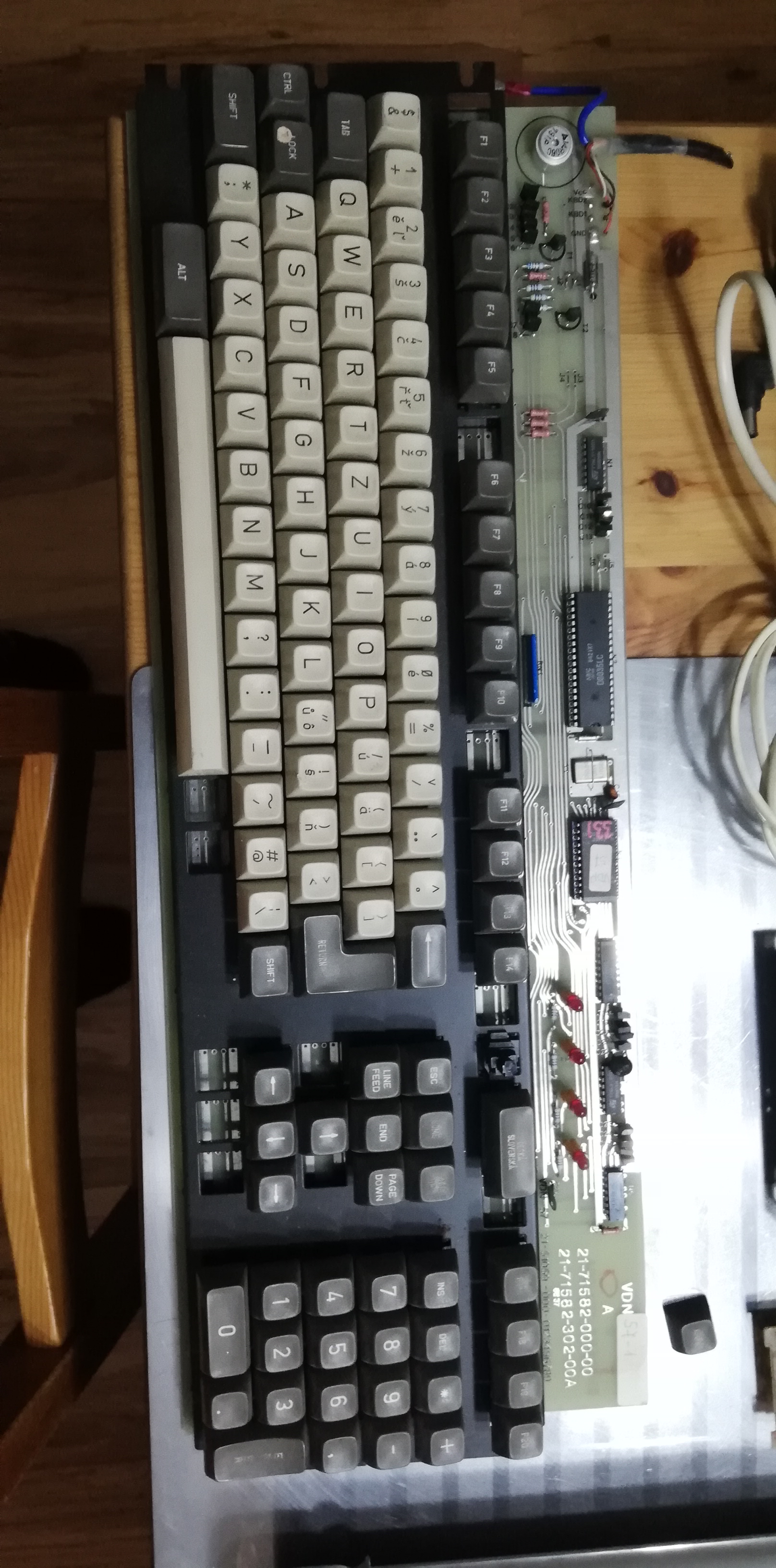

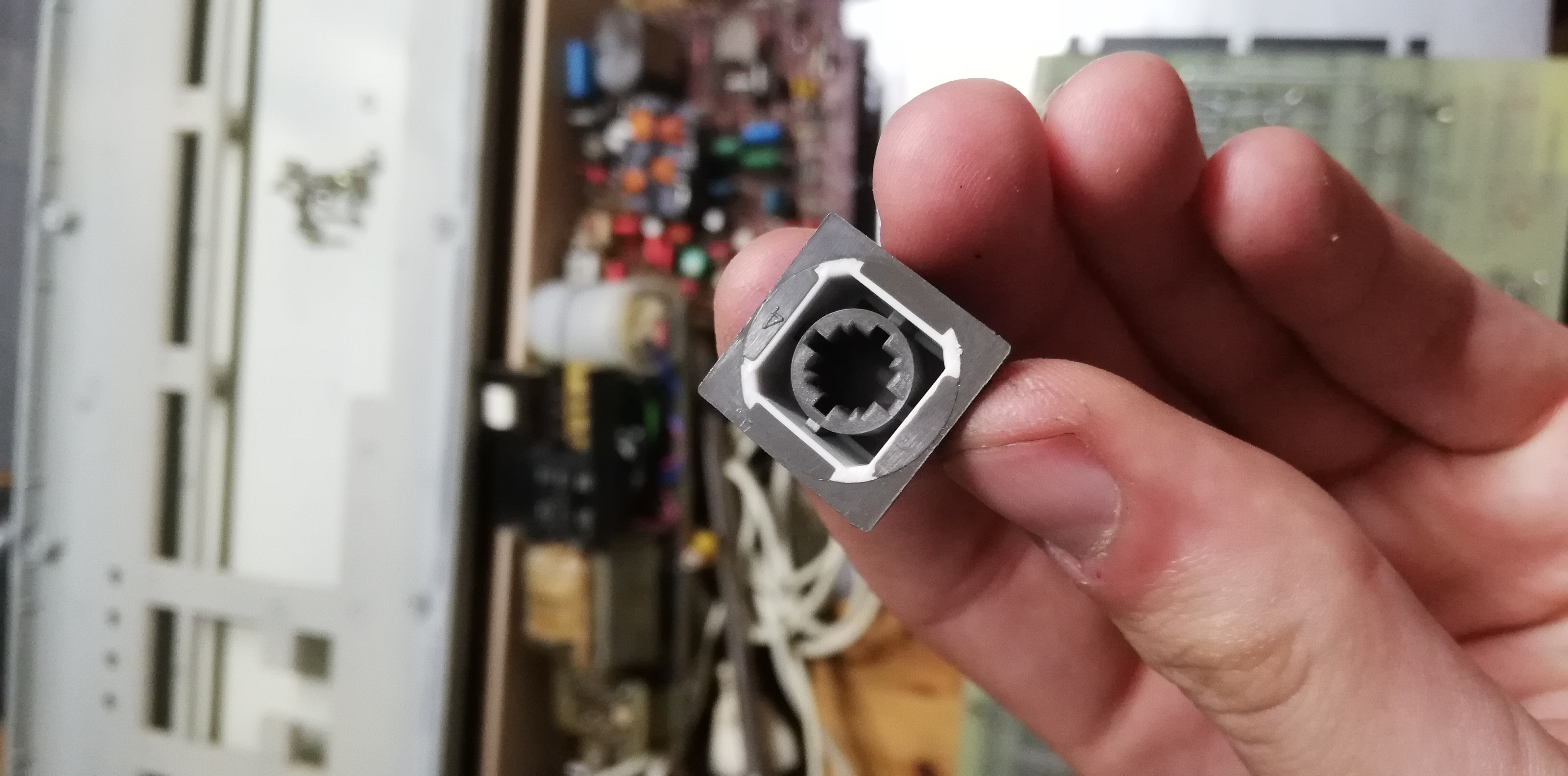

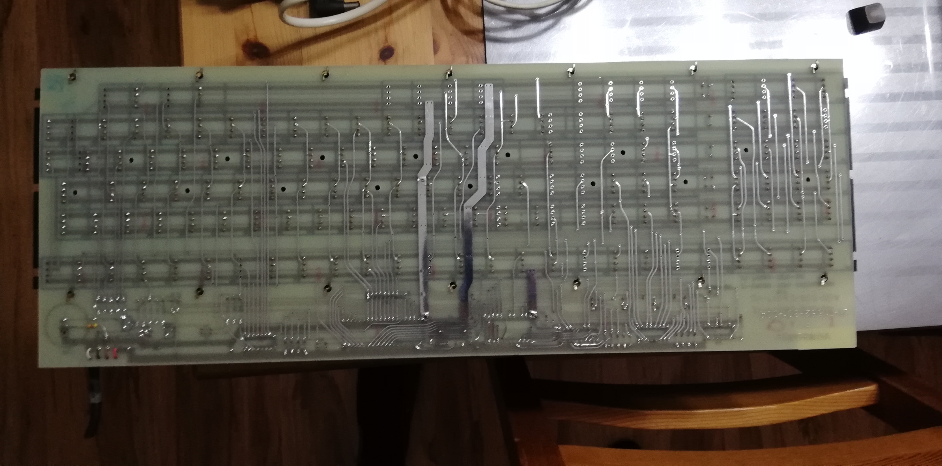

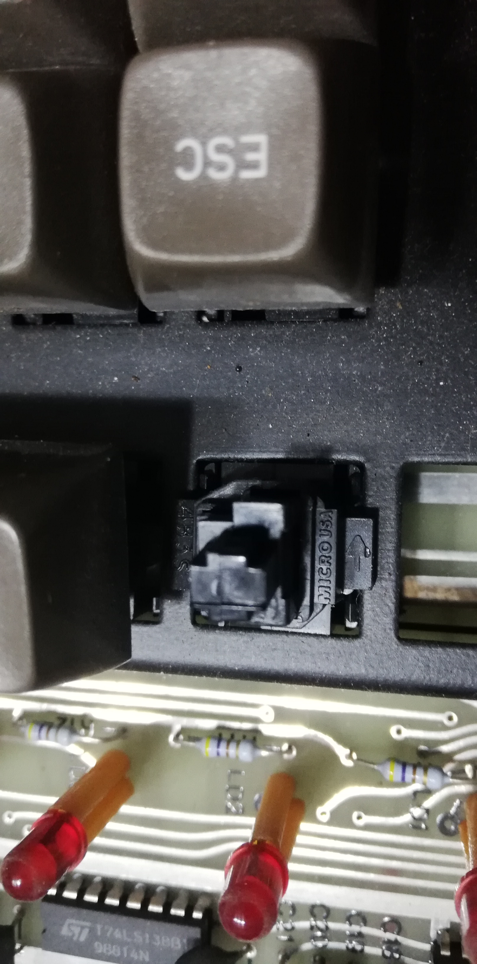

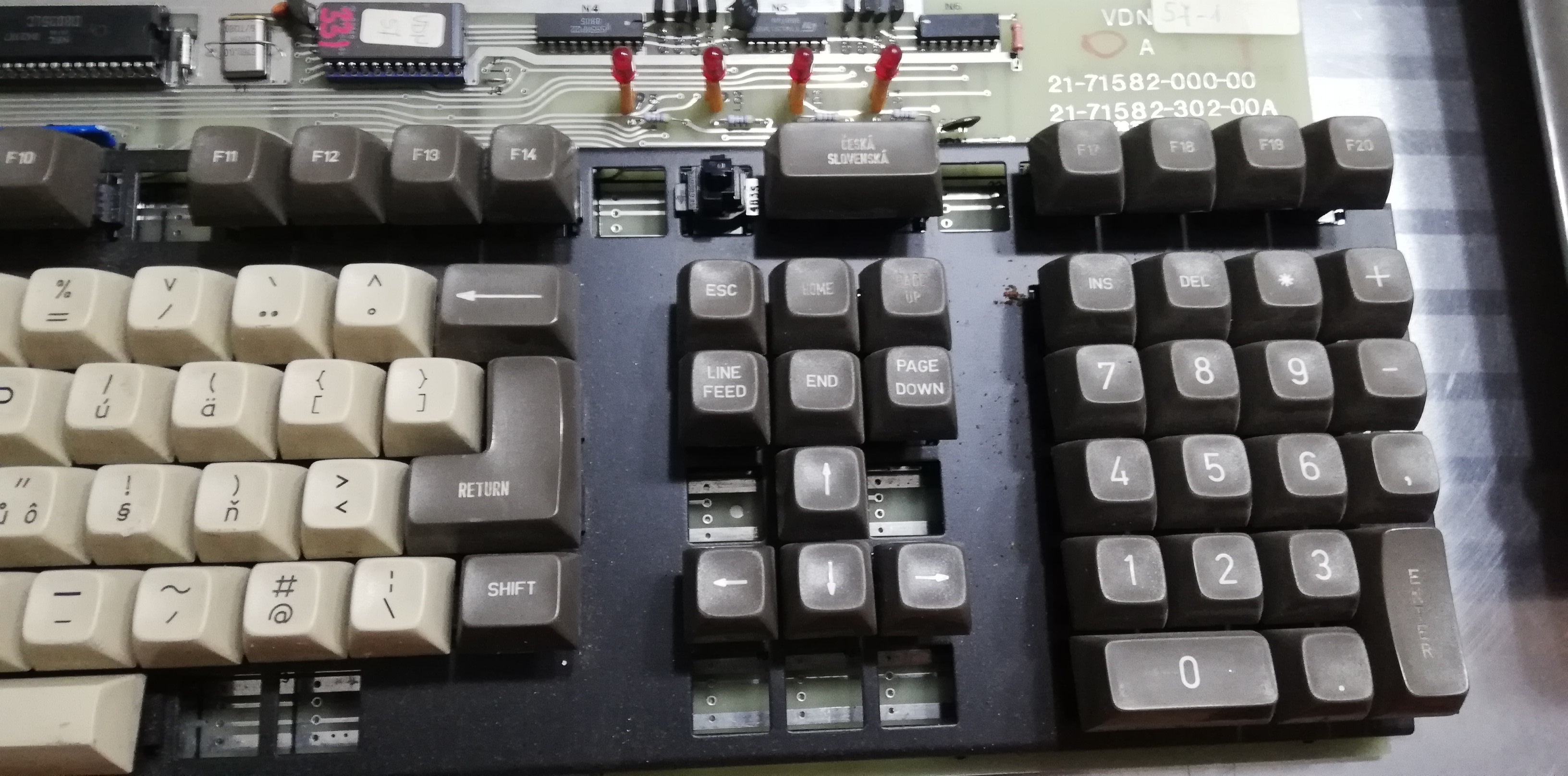

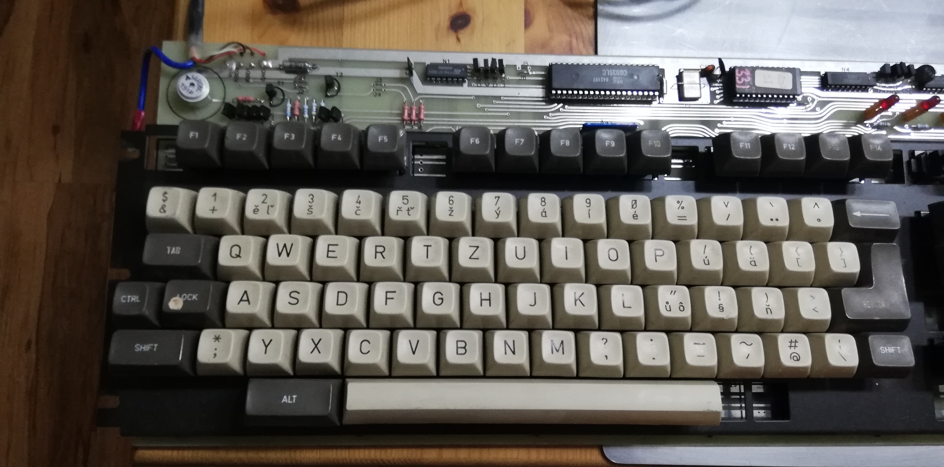

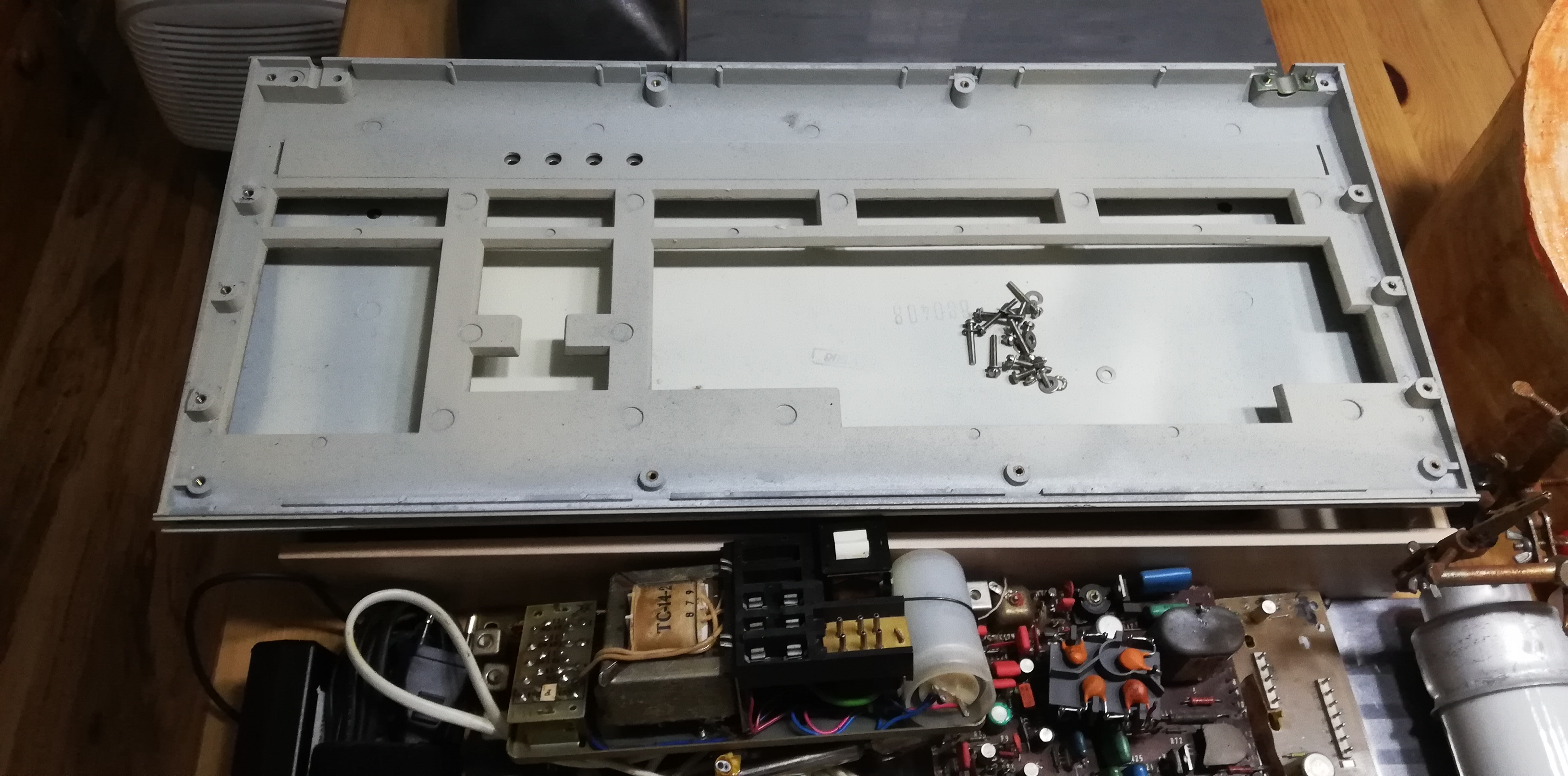

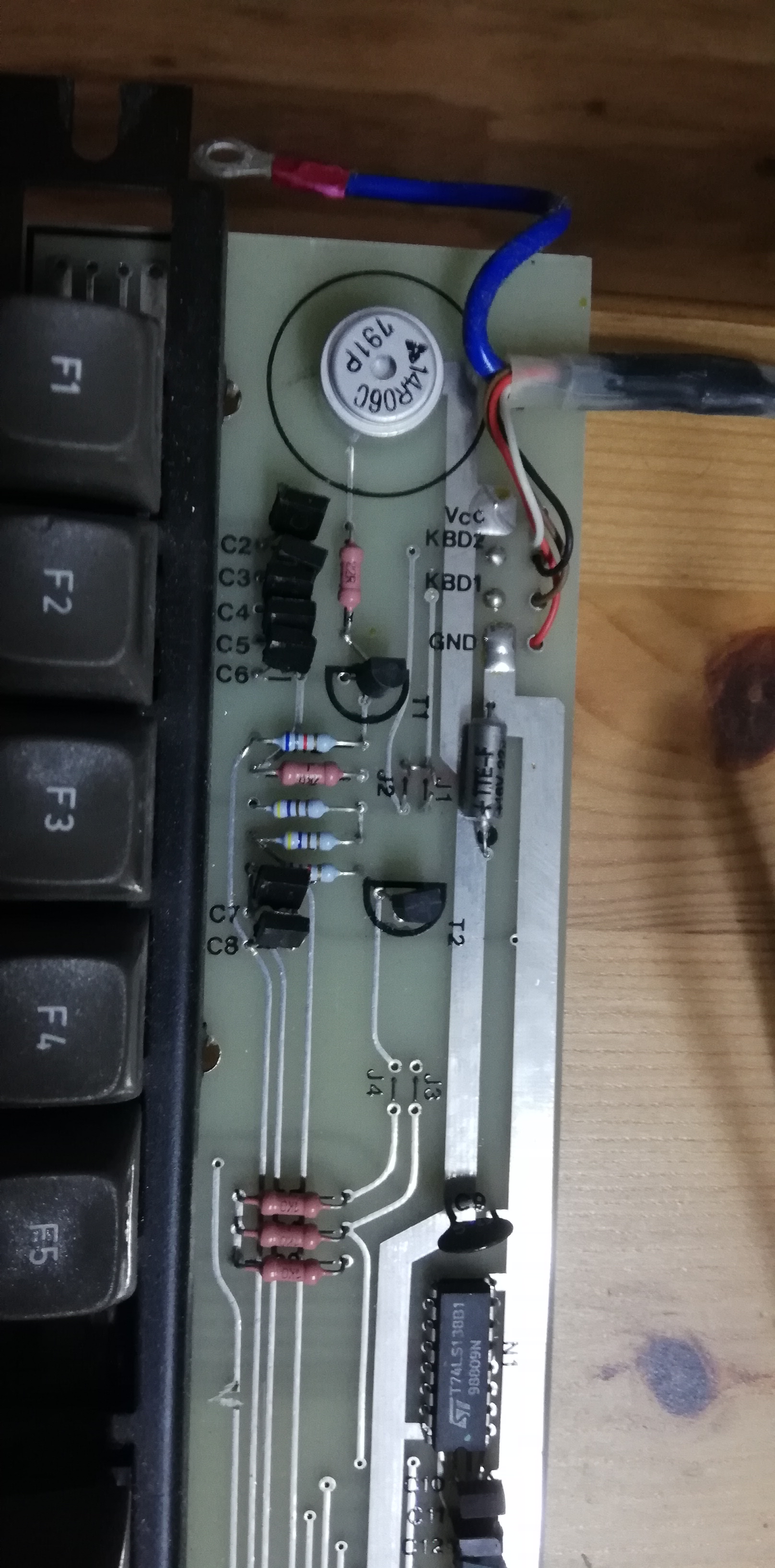

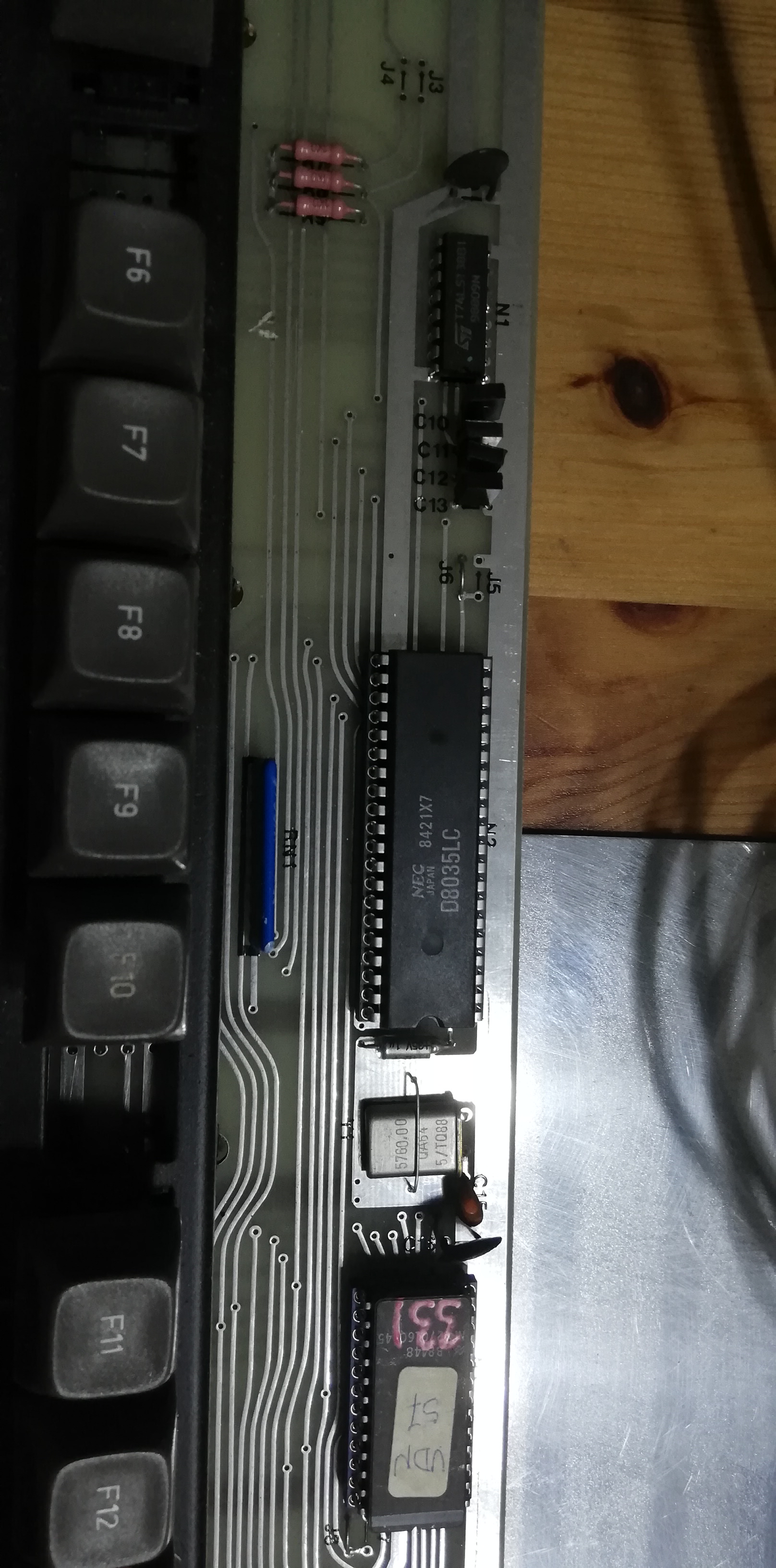

So I have the keyboard, I will post more pictures

This thing looks so cool! Hope you can convert it.
Slom
- Location: land of the rusty beamsprings
So the switches are 4B3S, these are so called "scan modules" , congrats. These support a "normal" matrix with n-key rollover. Depending on the pcb, you might have hit gold with this one.
The pins of the switches are VCC, OUT, IN, GND
Put IN low to enable the switch. If the switch is enabled, OUT will go low when the switch is pressed. You might need pullups on OUT.
You dont need any diodes
And the switches need no debouncing
Here are the two conversions with this switch type that I know of.
workshop-f7/man-vs-microswitch-converti ... 19688.html
workshop-f7/converting-a-ti-silent-keyb ... 18283.html

alordi
- Location: Russia
Oh!
This is definitely Hungarian Videoton keyboard.
It was connected to terminal (VDN-52500, VDX-52600) or VT-16 PC.
I have almost the same keyboards from VDX-52600 but with RAFI switches and Russian key caps. The case is the same, board and layout are very close.
VDN-52500 uses the same switches but has another board, layout and case.
I didn’t see real VT-16, but it was based on VDN terminal and must have PC layout.
I will be very appreciate if you can read the keyboard’s ROM and send the file to me!
