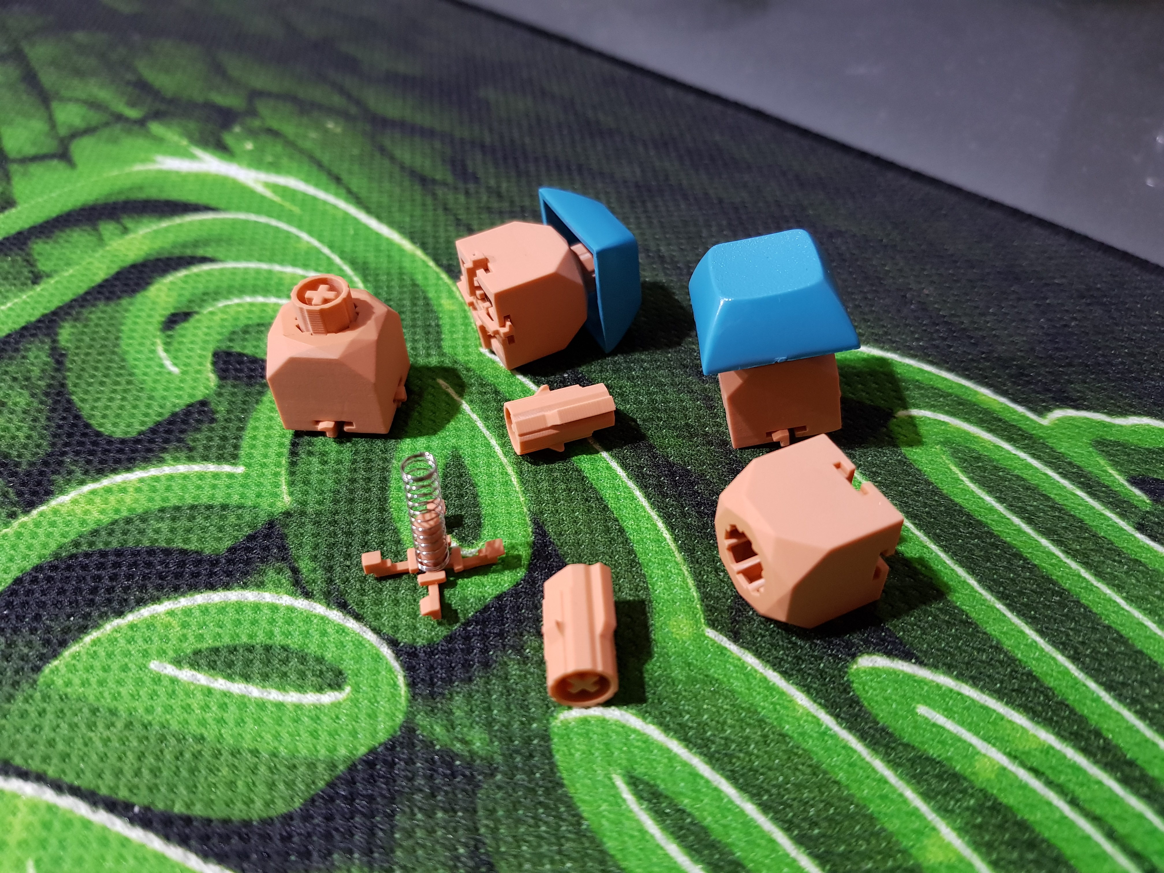

This switch prints very easily.
The slider is really too tight inside the box, I had to use a ton of lubricant and still doesn't move freely. The stem cross is too bold too and doesn't quite fit the keycap. I also feel that the circle ridge around the stem is a bit too tight.
If you wanted to do a stable switch, you totally got it :D

Wow, thank you for printing it out so quickly :D
And interesting results... not only that the slider is way tight, but the stem as well... which means I have some adjustment to do now that the printed objects don't need to go through a polishing process like my previous SLS prototype, which apparently took out quite a bit of material on the surface, making everything a little smaller. Also with your printer, I don't have the 0.7mm minimum thickness requirement anymore, so I can make the circle ridge around the stem thinner.
Alright great! This is exactly the data I need, I'll go make the adjustments and will upload a new set of stls as soon as I can. Thanks again @matt3o, this helps me a lot :D

matt3o wrote: This switch prints very easily.
I've uploaded a new slider with the adjustments to hopefully fix the issues you described. Do you mind help me out once more with printing the new slider and see if it's better? Thank you in advance :)
Here's the link to the new slider (same link as before actually):
https://github.com/mustcode/switch/blob ... slider.stl

sorry a bit busy, I will be printing the new slider in the coming days
Posted: 14 Mar 2018, 22:02
by mustcode
Please take your time, you are helping me out even when you have plenty of projects of your own. I won't be complaining whatsoever :)
Posted: 11 Apr 2018, 17:56
by mustcode
A quick update :)
I found a place on 3dhubs with pretty good printers so I was able to test the current design a bit more. I printed this prototype with EnvisionTec RC31 with 32nm layers, and result is not bad at all. The previous issues that matt3o found were fixed. I can mount keycaps properly and the fit is pretty good, the switch works properly even without lube and wobble amount is acceptable.
However, smoothness was not as good as I'd hope (considering the high quality of the print) so I wanted to make some more adjustments to reduce friction while trying to maintain stability.
Sorry to those of who are interested in the project as I'm taking this way slow... Each round of prototype is not cheap and takes quite a long time, so I need to make sure to think things through and don't make stupid mistakes, which cost a lot of time and money :oops:
Posted: 11 Apr 2018, 19:22
by codemonkeymike
So i have been thinking about the problem of switch stability for a while. I think the switch that got it right was the beamspring for two reasons, upward force being applied which is fully stabilized on the PCB and the force from the spring which is about 3x the diameter of a cherry spring. This spring adds a bunch of stability as well. So if I where to start from scratch I would start with a large spring and try to creat some additional force via plate spring which limits the horizontal movement of the stem.
Posted: 23 May 2018, 19:49
by codemonkeymike
What if you design the swich for a thicker PCB, something like .125" (3.175mm). That could provide some additional stability, maybe as stable as an aluminium plate.
