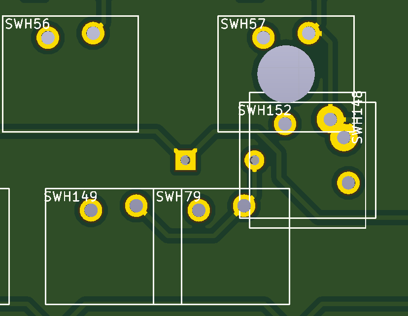

Okay the PCB is laid out except for the LEDs as I still have no idea how QMK controls the lock lights...Anyone know? Besides that I have finished the entire PCB and will upload pictures once the LEDs are done.
Also, Polecat can you check the dimensions on the Gen 1, Hole 1 again? According to your Gen 1 pcb picture, hole 1 is above the up arrow and the soldered screw is above the right arrow key. But the dimensions put hole 1 just past the right arrow key, and then the soldered screw inside the numpad 4 key. Unless I am understanding you reference point wrong. How I understand it is you use the center as the point midway between the two enter pins horizontally and then used the lower pin vertically, am I correct?

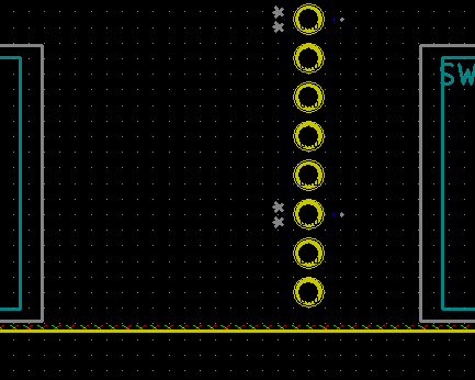

Polecat, quick question. How would you recommend doing the break-away section? Currently I just have 0.039 in holes spaced .078 in center to center along the entire height of the PCB. I have never done a break-away section before, and especially not one that needs to be somewhat strong on the break-away.
EDIT: Can you also measure the spacing between the numpad and nav cluster for the Gen1? I measured it on the gen3 and it is an odd 1.09375 inch spacing and wanted to see if by chance it is different on the older ones.
I at one point had long slots and the same holes separating the slots, but went to all holes to add more material between the PCB halves. Do you think this would be fine, too strong, or too weak? I found an article about sizing for break-away tabs, and the hole sizing is almost the same, just tighter spacing.
Finished routing everything and even found an error on the gen3 PCB where the LEDs are spaced incorrectly. The spacing on the opening on the top cover are equal but on the PCB they weren't and one of the LEDs is bent a tad to fit in the cutout. Kinda funny actually.
Also I was throwing the idea around of making a small break-away section above the left side function keys, and under the badge door for the boards that have it) to put the reset switch to program the teensy. Sound like a good idea or skip it?
Posted: 02 Mar 2018, 05:46
by Hak Foo
You might look at how the GH-122 did it-- it was designed with breakaway parts.

Hmm, so they only did holes at the at the ends of the cut...So I assume you would need to score the pcb and then snap it. I could do something similar.
I measure 1-1/8 inch center to center between the right nav column and the left numpad column on Gen1, 2, and 3. All the same in any case.
My opinion is that the "breakaway" section should be cut with a fine toothed saw or shear. The original PC board material from the '80s was a phenolic material, but most modern PC boards are made from fiberglass and resin, which is much stronger and would probably not break cleanly, even with a row of holes or slots. Even after scoring the fiberglass material might not break where it's supposed to, and I would hate to see someone ruin a brand new board trying. I would suggest a printed line with no traces too close, and let folks cut the board if used for a 101 version. That would also make it stronger on non-101 models.

EDIT: Managed to get both rotated and non-rotated ISO enter on the board, traces look kinda funky, but was much easier than I expected actually.
Updated the ISO enter again, was off a tad on placement, treated it as 1U instead of 1.25U like I should have.
Posted: 04 Mar 2018, 02:56
by Polecat
BlindAssassin111 wrote:
Yeah, the first thing that came to mind when I read ISO was the weird boards with the split backspace. I thought that was the standard, but apparently not.
Now something I need to figure out is what orientation for the ISO enter? rotated or non-rotated or both? Hard to know as SP alps caps are non-rotated, where as older sets generally are rotated, and supporting both would be hard for trace layout reasons.
Quick peek shows my Focus FK-2002 has the rotated switch. That's a likely key cap donor since (we think) Focus and Northgate were made by the same manufacturer. The PC board has pads for rotated and non-rotated, presumably for the BAE on the FK-2001 version. Note the extra pads for the small right shift key with the 1U switch next to it. The left shift is done the same way.
Edit - just saw your reply with the ISO Enter added, you managed that more quickly than I could take two photos. Must be getting old.
