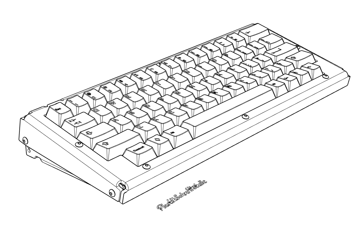

PlastikSchnittstelle wrote: PCB mount?
maybe I'm missing something here, but I don't think PCB mount will be possible?
Damn man you really know how to trigger me.
Very nice drawing, you're really gifted. Can't wait for this to proceed.
Posted: 22 Nov 2017, 18:26
by PlastikSchnittstelle
Thank you very much
But let me clarify something regarding the style of this drawing.
It is kind of a standard or at least very popular style used in product design (maybe in architecture as well). It is mostly used in earlier concept phase of the design process. a few years back the standard procedure was to export the model from CAD and into illustrator and there deal with the line weights. today that's easier, this is more or less just a screengrab directly from CAD using a slightly modified display mode.
so long story short: this is not a very special style I came up with, it's a pretty standard type of visualization used in product design.

Posted: 22 Nov 2017, 22:54
since wodan likes the drawing style so much, here is one more:
- SKB60L-YAS.jpg (320.32 KiB) Viewed 16929 times
Posted: 22 Nov 2017, 22:59
by Myoth
PlastikSchnittstelle wrote: since wodan likes the drawing style so much, here is one more:
Wodan won't like it ... it's not ISO !! HERESY !!
