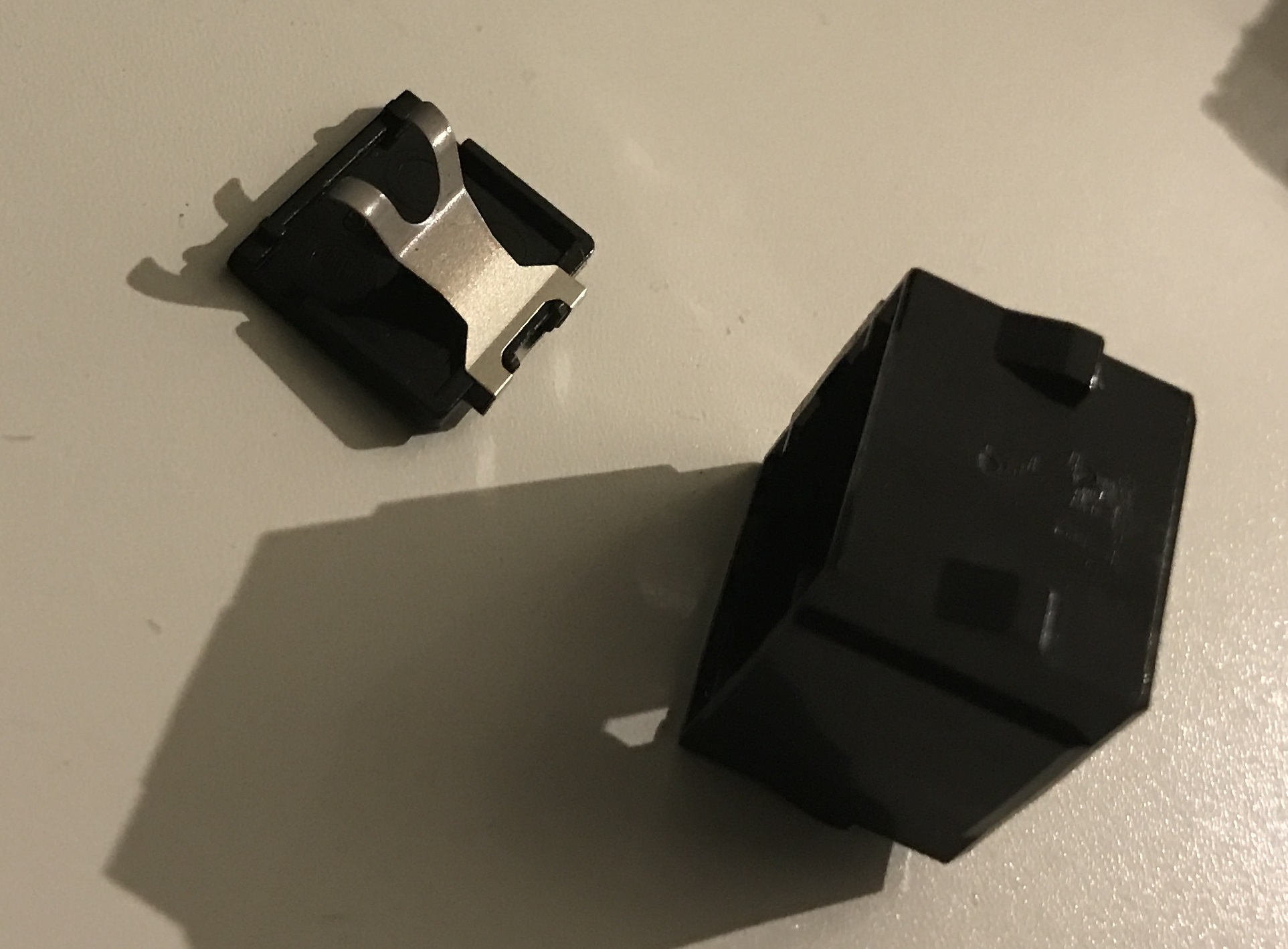

Posted: 30 Oct 2017, 08:40
by //gainsborough
can the tactile leaf be removed or is it part of the top housing molding? The teeth on the leaf kinda look like the shape of the neon green alps tactile leaves. It's hard to tell from that angle though.
Very cool find regardless! it'd be very interesting if they could fit in normal alps plates! You could build yourself one very unique custom!

by JP!
//gainsborough wrote: can the tactile leaf be removed or is it part of the top housing molding? The teeth on the leaf kinda look like the shape of the neon green alps tactile leaves. It's hard to tell from that angle though.
The one from the top housing is removable. A custom build would be interesting, not a lot of choices for keys though :lol:

Posted: 30 Oct 2017, 09:30
by Daniel Beardsmore
seebart wrote: … I doubt the swtich is Alps Electric until proven in detail. …
The entrails mould marks never lie …
It's too bad that the other code isn't present, the one that gives you the series name. Those codes are frustratingly rare, and only Canon keyboards consistently used them.
Looking at the ICs, that would be 19_5, and 1985 would fit according to [wiki]Alps keyboard codes[/wiki]. So it's very early on in the SKCM lifetime.
Why the spring inside the slider though?

So the best conclusion I can draw about the secondary smaller spring is that this spring along with the white plastic leg serve to provide a tiny bit more force once the actuation point is reached. This effect is quite nuanced. Note that the base where the large spring sits is raised in the center which is where the plastic leg would fit. I believe this design helps slow the descent, possibly preventing the slider from fully bottoming out or at least reducing unwanted sound if the slider bottoms out. Any travel distance past the actuation point is quite short. Once the actuation point is reached and you force it to bottom out, any additional noise is practically unnoticeable. Comparing this to a unmodified Cherry MX Blue for example, once the actuation point is reached you can easily produce more noise if you are a heavy handed typist who slams the keys so they bottom out.
